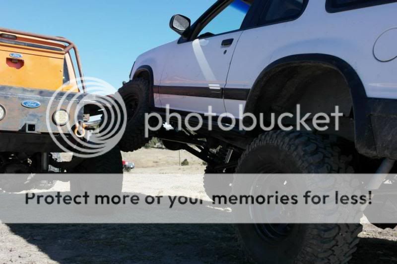

Took the truck on a 40 mile trip. Did great went straight down the road. Not a fan of the KM1s they are so loud.... When we got back took the truck back down to the gulch in the snow storm beat on it some more. Then heading back to house I hit a jump about 30 mph truck took it no problem. Bracket kit is working great.

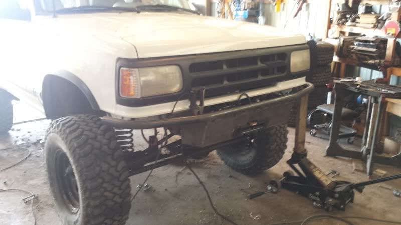

Bumper almost done....

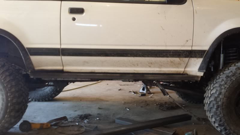

Cut in slider/rocker...
Project Double R...
Testing the new rocker...
Project Double R...
Step on Pass side...

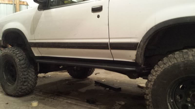

Driver side all done. No more ugly rust. I cut it out and made it beast mode... :D
Project Double R...
Looks awesome!! You do some nice fab work.
Looks good stang. I need to ship my b2 out there and have you finish it for me.
I am real pleased how this old truck turned out. I love it. I can't wait to wheel it.

i want to see a video of the jump!!!!
what is the limiting factor in the suspension? the shocks? the coils?
Shocks just like Double R. 7000MT have built in bump stops top and bottom of stroke. They work like a dream.
