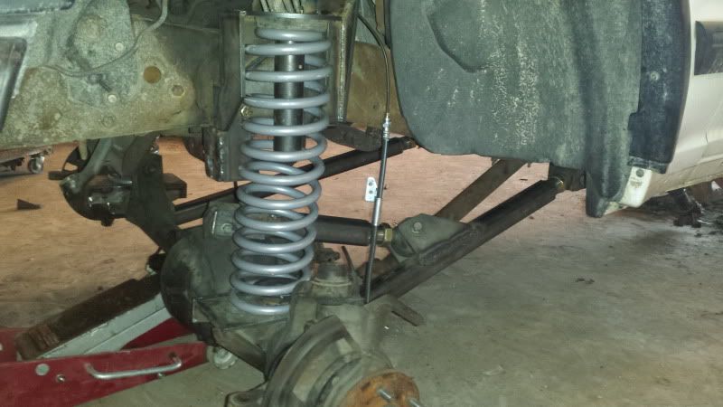

Coil perch relocation brackets...

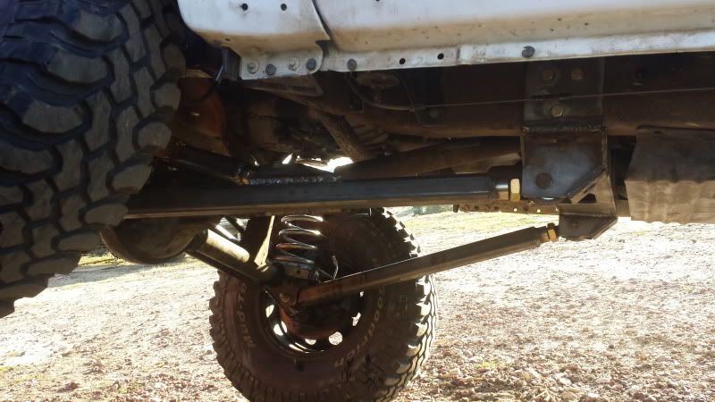

Arms in just have to figure out a track bar...

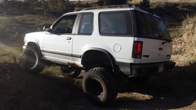

Once I get the shocks in I will road test it this weekend. Thing is a beast!

No cause the coil relocation brackets have the track bar bracket built in. Probably going to offer a sleeve kit instead of a truss. People can PM for details.
