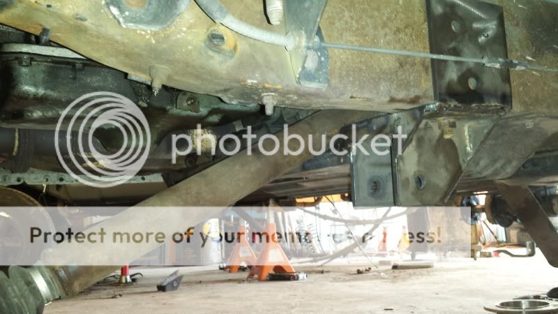

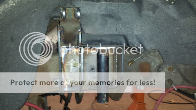

Driver side! Boom! :D
Project Double R...

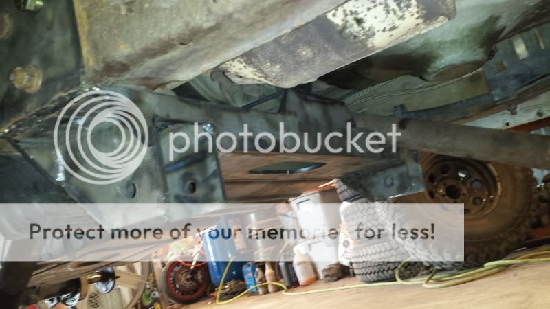

Just have to tweak a couple bolt holes!

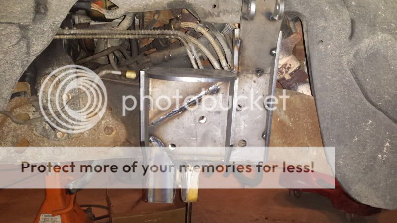

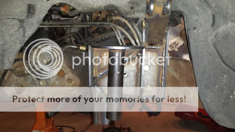

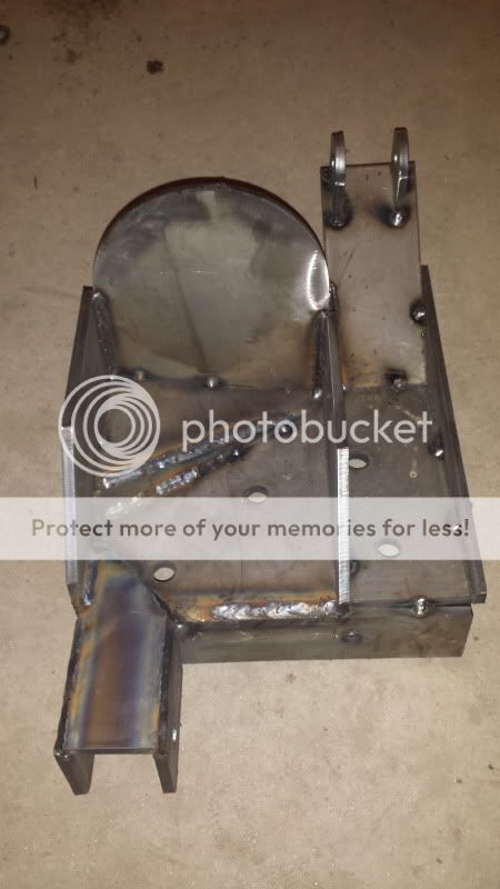

So the driver side bucket has a built in trac bar mount it looks like?
Correct. Should make life easier for a lot of guys.
Do you think it is strong enough? I have seen a lot of guys tear theirs off etc. and had to add a lot of bracing to it
Most of the guys I seen tear there's off applied it to weak metal. Double R, TNT, 2.0, Bronco BIIue, Southern Cut, and other Ranger I built all have there TB mount in the exact same place all attached to the factory coil bucket. No one has an issue. This one is as strong if not stronger. I have had a little practice with this. ;)

PM me what all parts your going to offer and I will let you know what I need. This is going to be so nice and take out all the guess work. Not only that I have been skeptical on doing the sas due to trackbar mount ripping off, but if you have had experience with it, and the pictures suggest you do, then this was an easy decision.
Only one hole was off!
Project Double R...

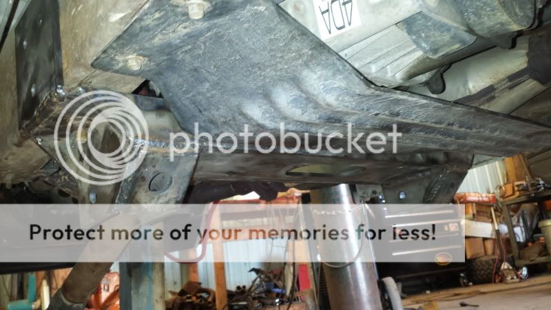

Pass side bucket...
Project Double R...

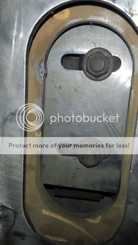

Clearancing the crossmember for the front shaft...
Project Double R...

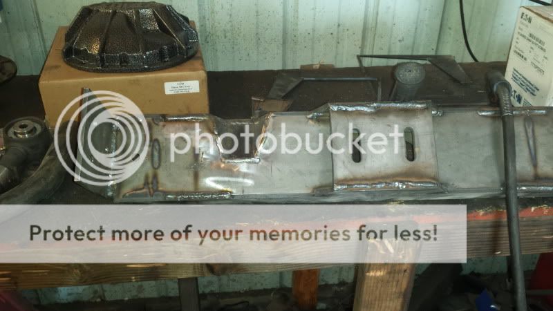

All bolted in. Just have to drill a few new holes for the added supports.

Transmission mount holes...
