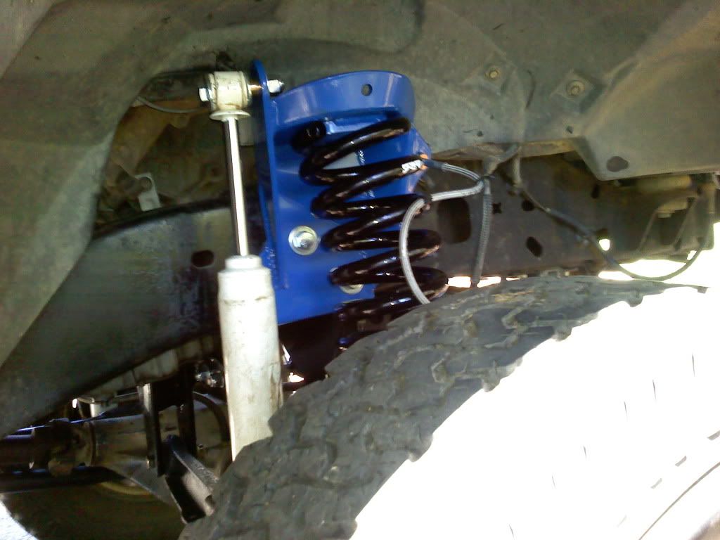

Do you have any other pictures of the upper shock mount on those JD coil buckets?
And what did you use for extended brake lines?

For brake lines I used Skyjacker's epoxy coated braided steel extended lines from autopartswarehouse.com and then extended them with rubber lines mentioned here in the tech library because they weren't long enough I felt.
Upper shock mounts:

thanks for the pics i appreciate it
No problem man.
