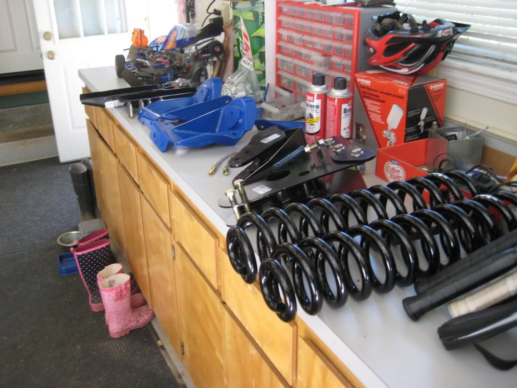

I know, I can't hardly wait myself, for one being that every night I trip over steel parts in the dark at some point. :icon_rofl: Not this week and not the next but the following is when I have planned to get all this on....reminds me I gotta pick up some pipestands from work...And locktite, and spray paint...
I don't recall ever seein a truck here on TRS with SJ brackets and Duff Coil buckets...I hope there isn't any clearance issues. I foresee a possible one on the passenger side coil bucket where the SJ bracket will mount up against the bottom of the frame rail.

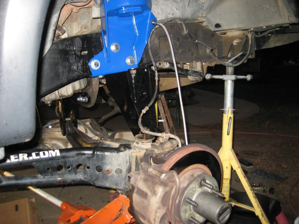

I swear the hardest part is getting the beam pivot bolts back into the drop brackets. I quit for the night after I smashed my finger with a 2lb sledge and used every cuss word in the book, including ones that didn't exist before I smashed my finger.

Install last pivot bolt on passenger beam, install coils, measure for Bilsteins, install old Rancho shocks temporarily, bleed brakes and wash everything off. BTW, rivets suck, I can't imagine drilling them out.

Today I didn't get much done, other than find out Skyjacker sent me two different brakelines that don't match. And the fact they are only marginally longer than my stock ones :annoyed: In my angst tho I remembered the Tech Library's article on extended rubber lines and ran myself to Autozone. Picked up one of each and now I can use both of Skyjacker's lines with two short extensions, giving me plenty of brakeline length.

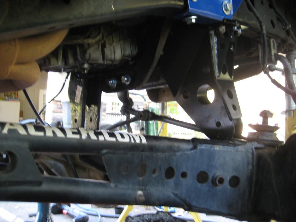

i bet it's from running 6 inch drop brackets with 8 inch coils
mmmmm maybe :icon_twisted:
Alignment went good. Used the stock 1.25 degree bushing on one side, and a new 2.5 degree bushing on the other. Still has a little positive camber on both sides, but thats what I wanted for when the springs settle a little in the coming months. All in all it drives just as good as before.
No alignment horror story here...
From my understanding skyjacker uses the same bracket for 4-8" lift. The that's why there is 2 holes in each bracket. The 6" actually aligns better in the 4" hole and the 8" actually aligns better in the 6" hole. But I could be wrong.

I believe you to be correct, especially with the heavier, super cab V6 variants. And it works even better in my case because of my heavy nose.
