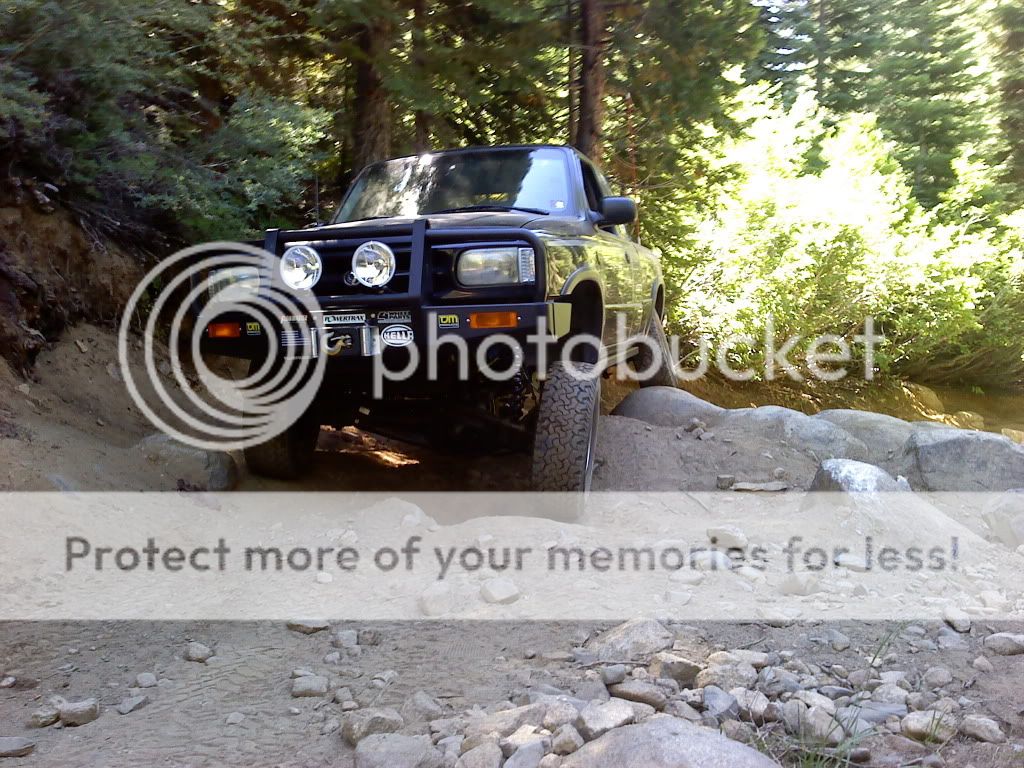

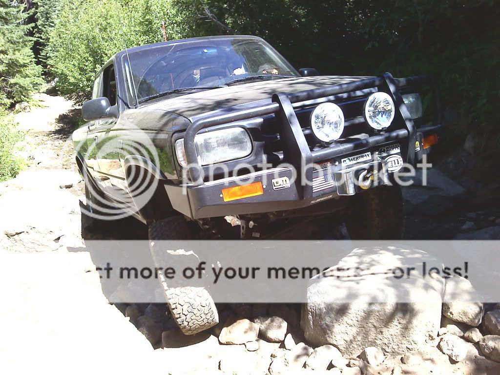

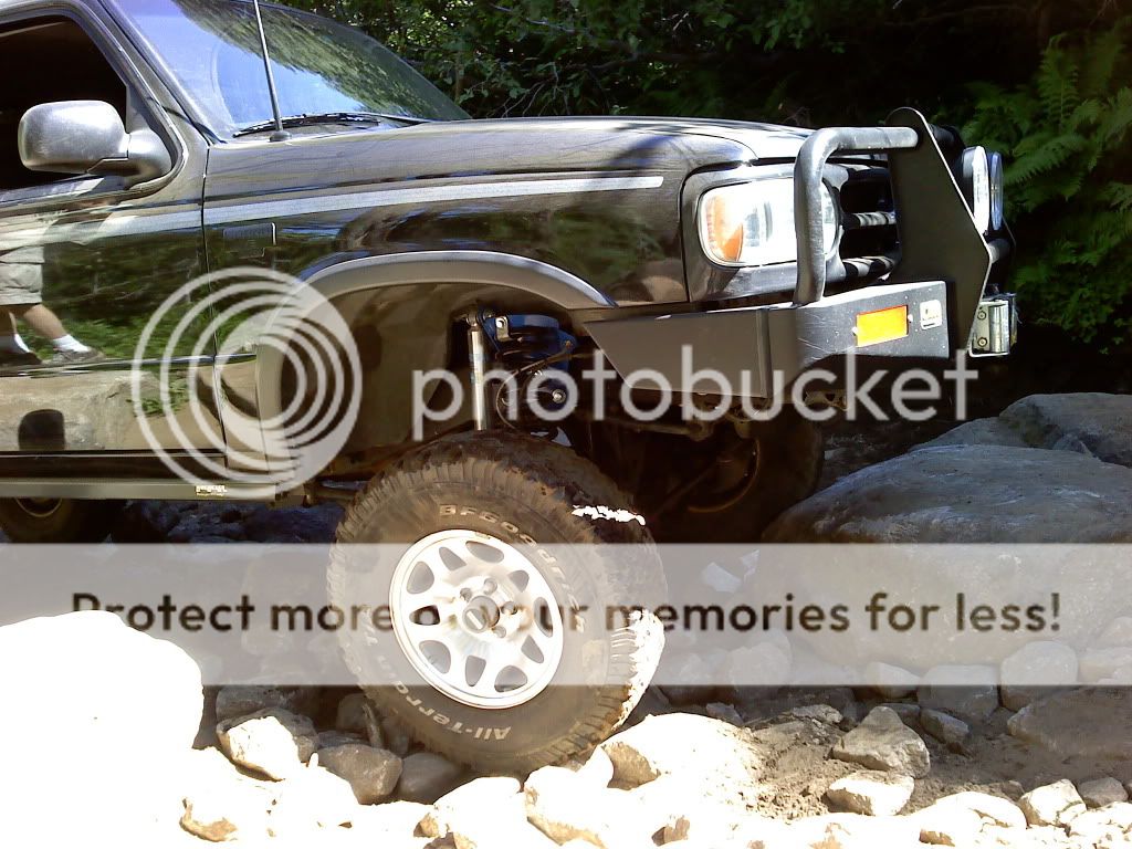

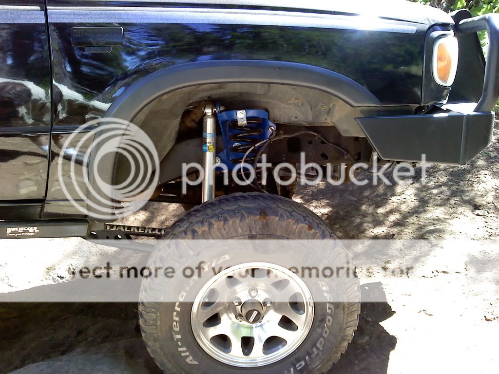

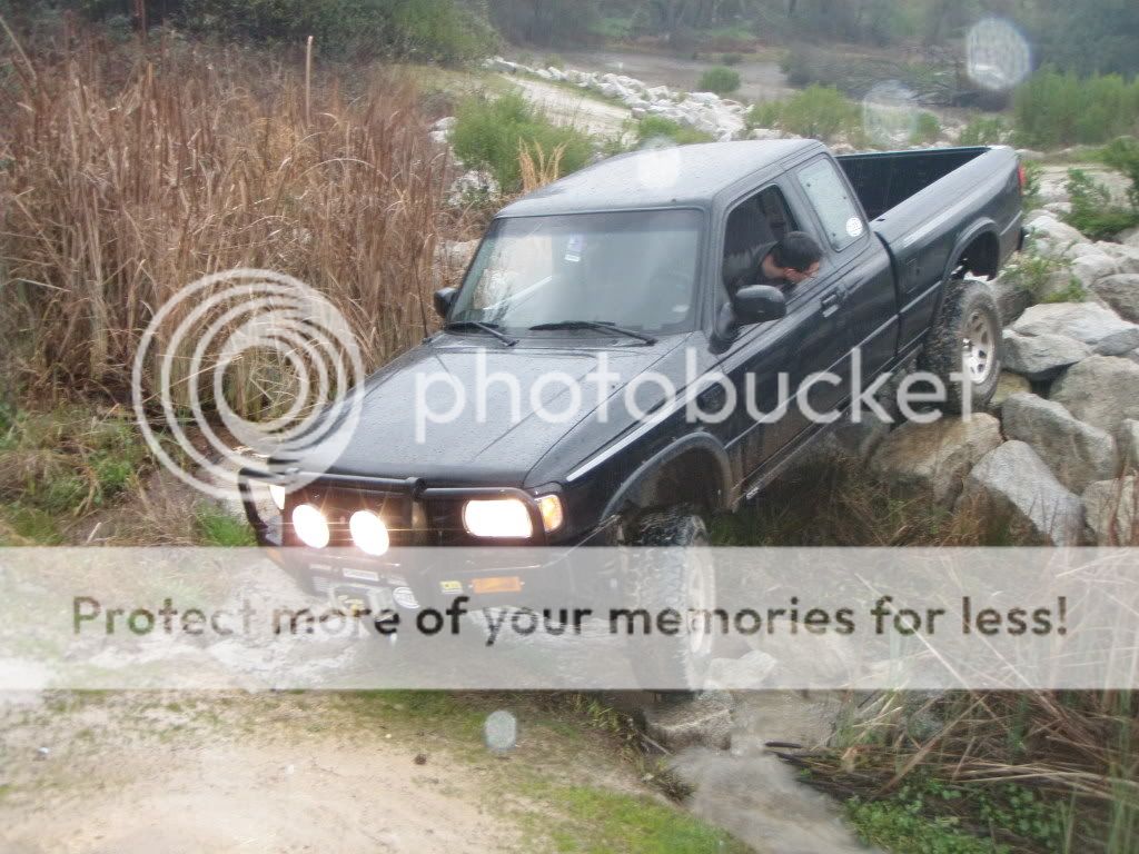

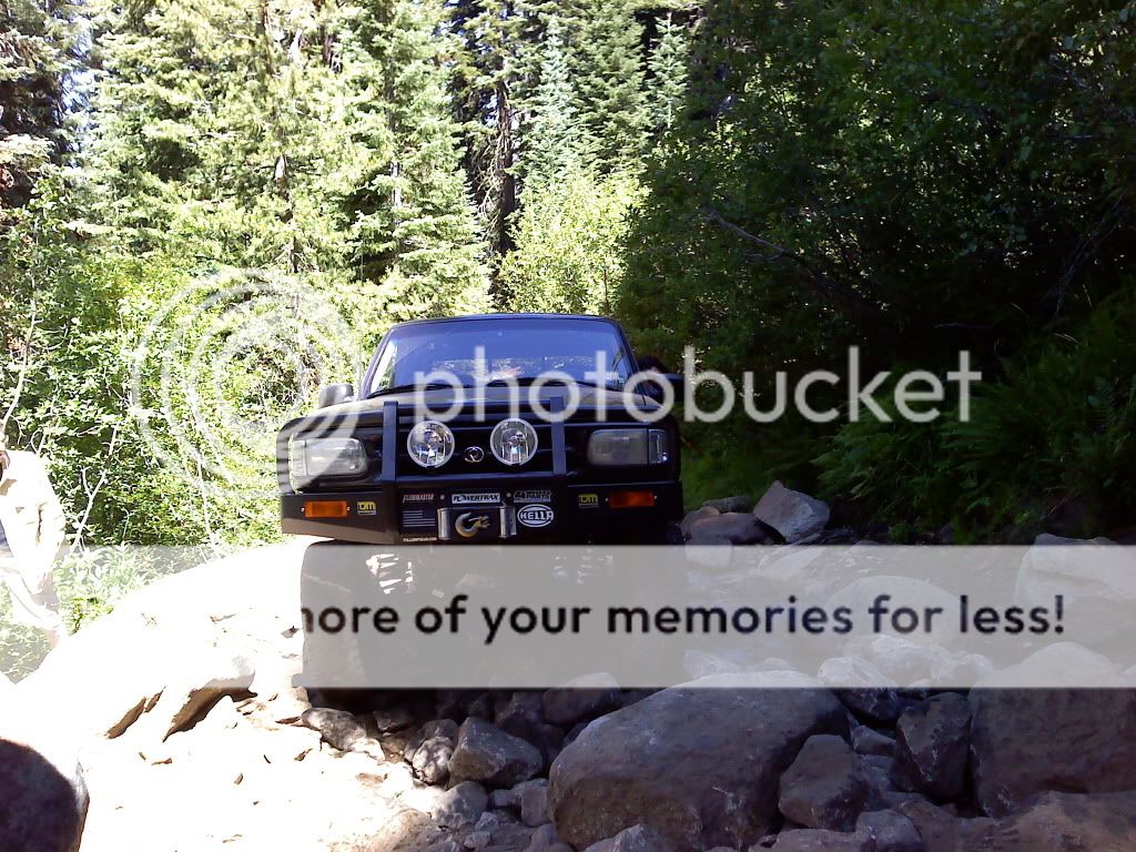

Got front Bilsteins on, and went wheelin today. Here are some pics. I really like the 170/60 valving on the front shocks....rides awesome [prolly best the front axle has ever ridden]. Didn't air down as it was only a short one way trail with highway to and from it [~5mi]. Kept my 40psi and did ok just really bumpy but not too bad, our sandwiches survived if that says anything. All new Skyjacker/James Duff/Bilstein suspension setup is a vast improvement over the last. Tomorrow is the boring stuff: wash, oil change, tire rotation and checking all nuts/bolts for proper torque figures.
