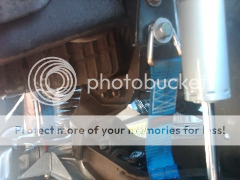

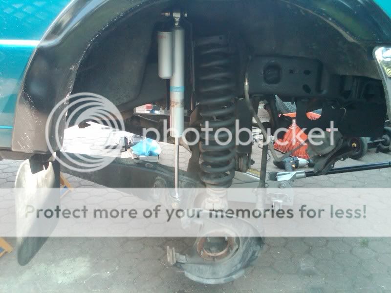

Yeah you need tires bad....what is the axle gearing in your truck as is? I LOVE my 4 56s and 33's. I got my 12" 5150's on the front of my rig....brake lines were about an inch short, so I fabbed up some limit straps. Anyways, point of the message....the Bilsteins are TITS. Could instantly tell the difference...I highly recommend them.
this first ones before I bolted up the limit straps.

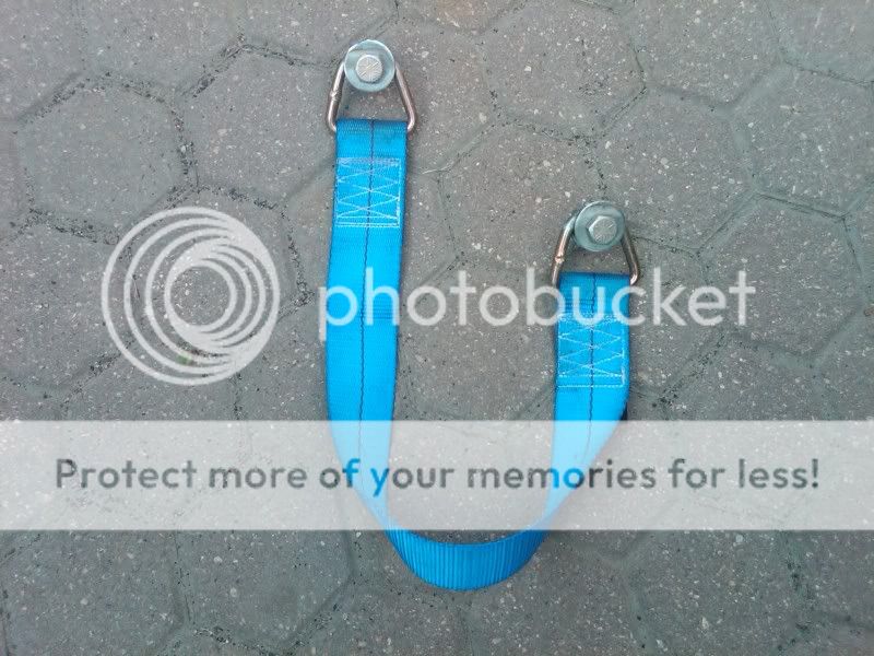

Hey Nathan what did you use for limit straps?
Haha I'll keep that in mind. But me thinks NC is a little far for a road trip....tha'd be like 8 or tanks of fuel? :bawling:
Hey, I used a set of tie down straps....
http://www.princessauto.com/towing/loading/fastening/tie-down/8020704-2-x-2-ft-axle-strap
I welded a grade 8 washer on each side of it, (this is before I cut and sewed it.)
Project 4x4 Commuter Mazda
Then measured the length I needed, and cut and re-sewed it to the proper length.
Cost me all of 15$ :D

So i measured for shocks just now and Bilstein's 11" travel 5150 is what i want to get and would work perfectly, but it only comes valved at 170/60 which is less than the typical 255/70. Is there any downside to running a single shock that was meant for running duals? For some reason Bilstein doesn't offer a 255/70 valved 11" travel 5150.....WHY!
I don't really want to settle on an 11" travel 5125's but maybe I should if it means I'll get the correct valving (255/70).
Even better!
Just get the 12" 255/70 valved 5150 like I did. That inch wont make that much of a difference.
Its worth the ride....the single 170/60 isnt quite enough.
My upper shock mount tho isn't as tall as yours, and with the 12" travel 5150 I'd only have 3.25" of up travel. Not near enough as I use every bit of 5" as it is now. I don't wanna limit my up travel if I can help it. Thats why the 11.5" travel 5150 that is 16.5" collapsed and 27.99" extended would work perfectly. But 170/60 valving might not be enough :bawling:
Screw it I'll save myself some money and get the 5125's then they will match the rears.
I have the parts from James Duff to make it duals, and I still could maybe someday. I just ordered 11" travel 5125's.....255/70.
