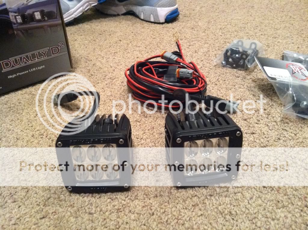

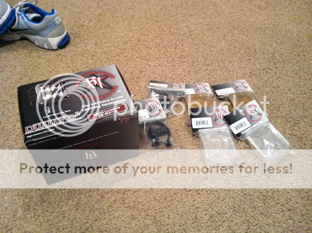

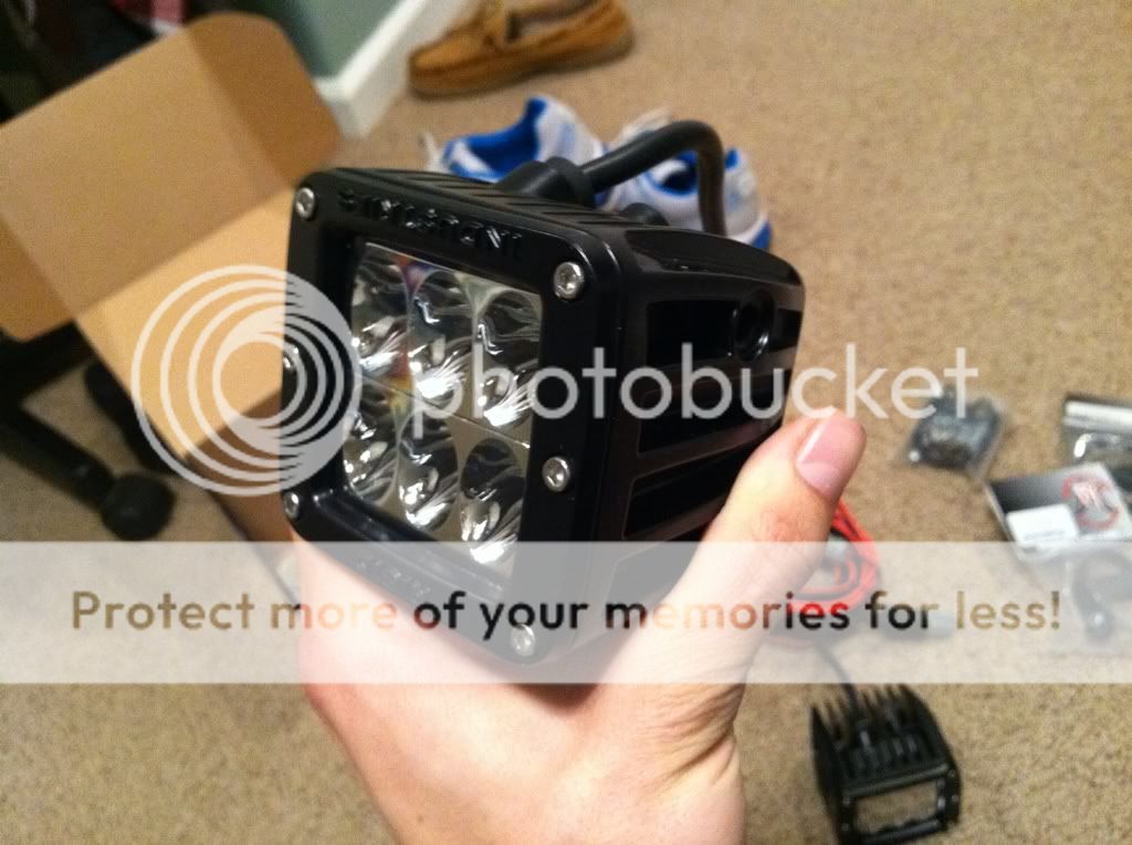

Lookie what showed up today:
Nice!! How much?
And u def got to get us a night pic of one on
Nice!! How much?
I will :headbang:
I got them for $324 shipped. Usually they are about $380 direct from Rigid Industries...I had a coupon. Obviously the covers and tube mounts were extra....expensive stuff, but the light output is nothing short of amazing....I probably will never go back to bulb based lights if I can help it.
if you ever go LED lighting... you won't go back. most don't even want HIDs after having LEDs... i can't blame them. but the ddm tuning kit for my hella's was the best i could afford lol
