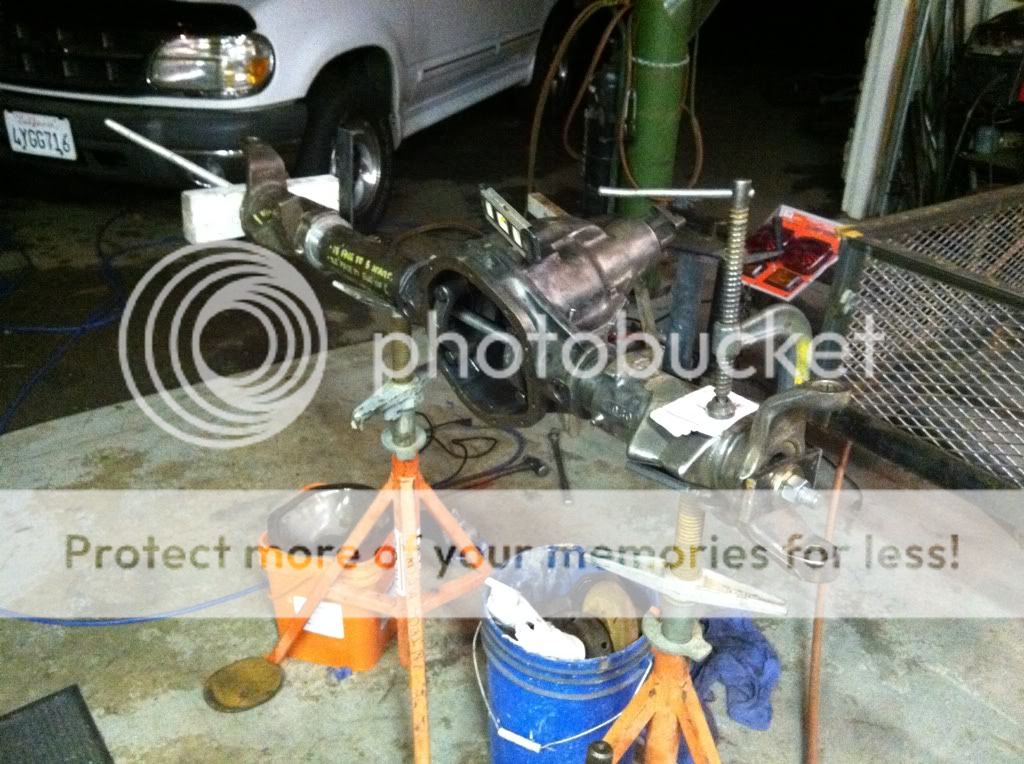

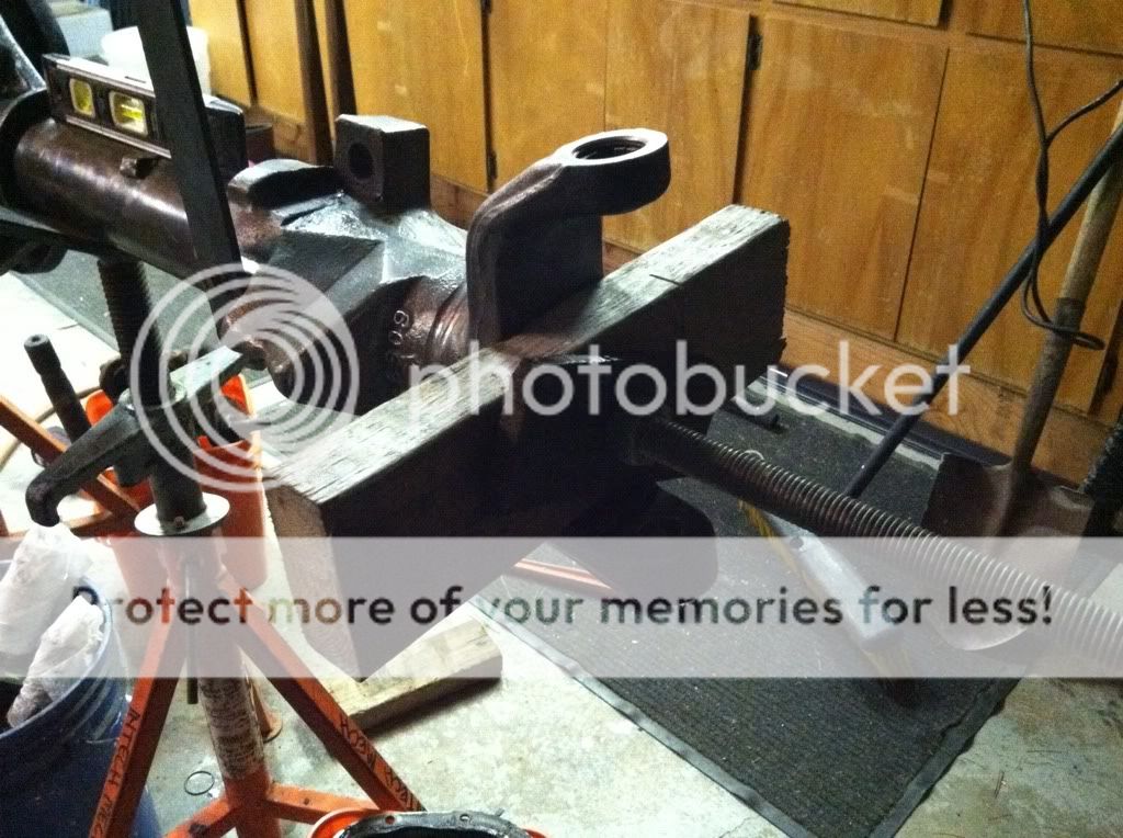

Well, the wedge is on.
I used a new method that I haven't seen anybody else use yet. Super fast, and super easy. I used a 8' long section of 3/4" all thread and a couple nuts, a couple plates, and some 2x4 lumber. Sucked it on with the impact in about 1 min 32 seconds first try...just needs weldment :icon_welder:
No fiddling with heat, no messing around with a 100 ton press, no stressing that the castor angle was gonna be screwy, and no busted knuckles beatin' it on with a sledge. :icon_thumby:

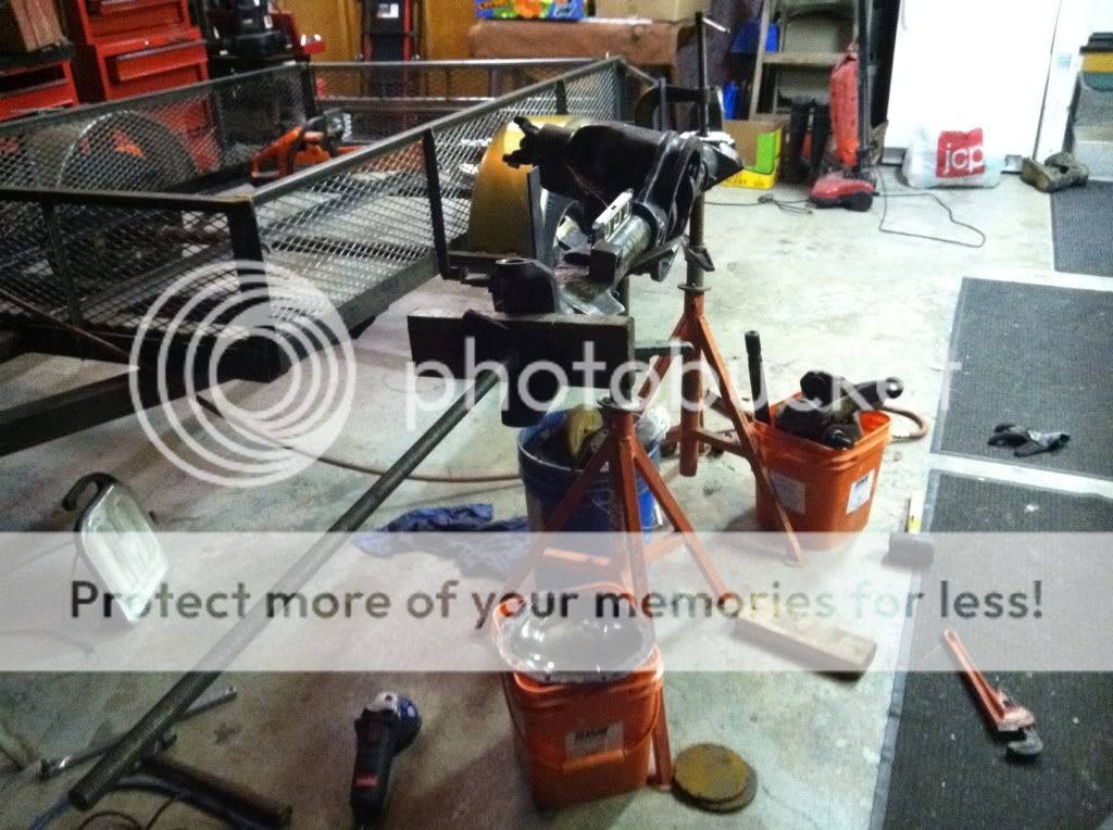

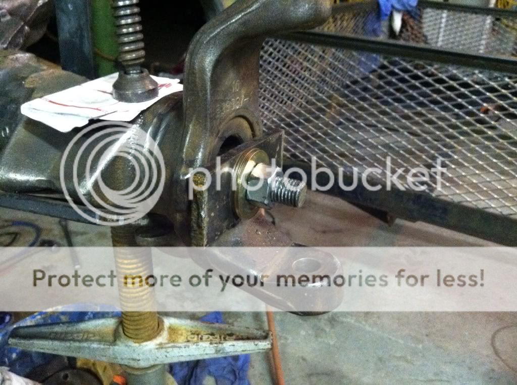

No that the wedge is on, this is the part of the SAS that starts costing a lot of money. From here on out, things get expensive. For now I am broke, so parts and progress will be slow (just like I have always said). At this moment in time I am on track to have it geared/locked by summer time....close to fully built in the fall...and tenatively seeing the swap done after Christmas.

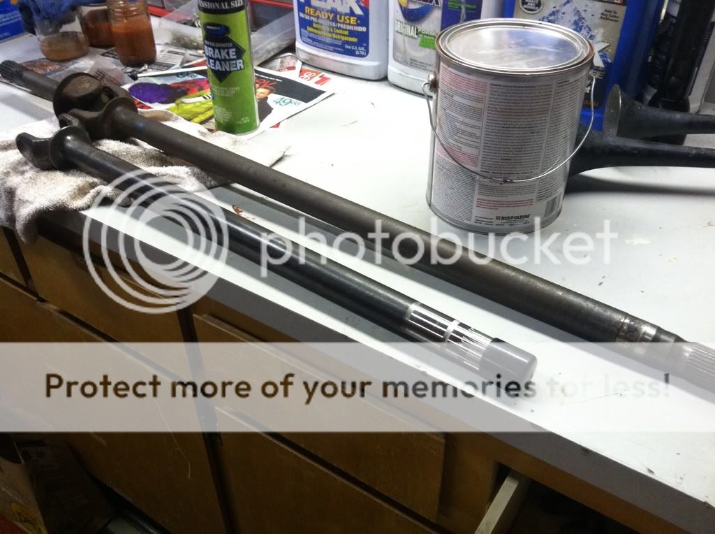

First things first though.....an EB shaft for it this week for the passenger side....keep the stocker and get it splined for later as a spare.

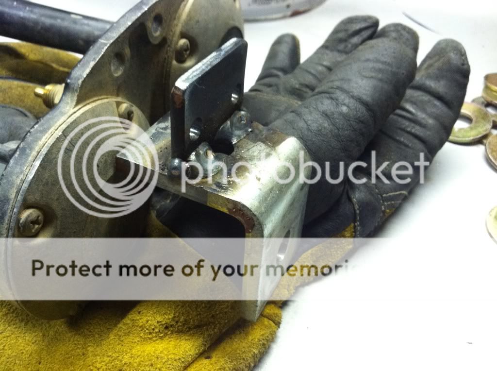

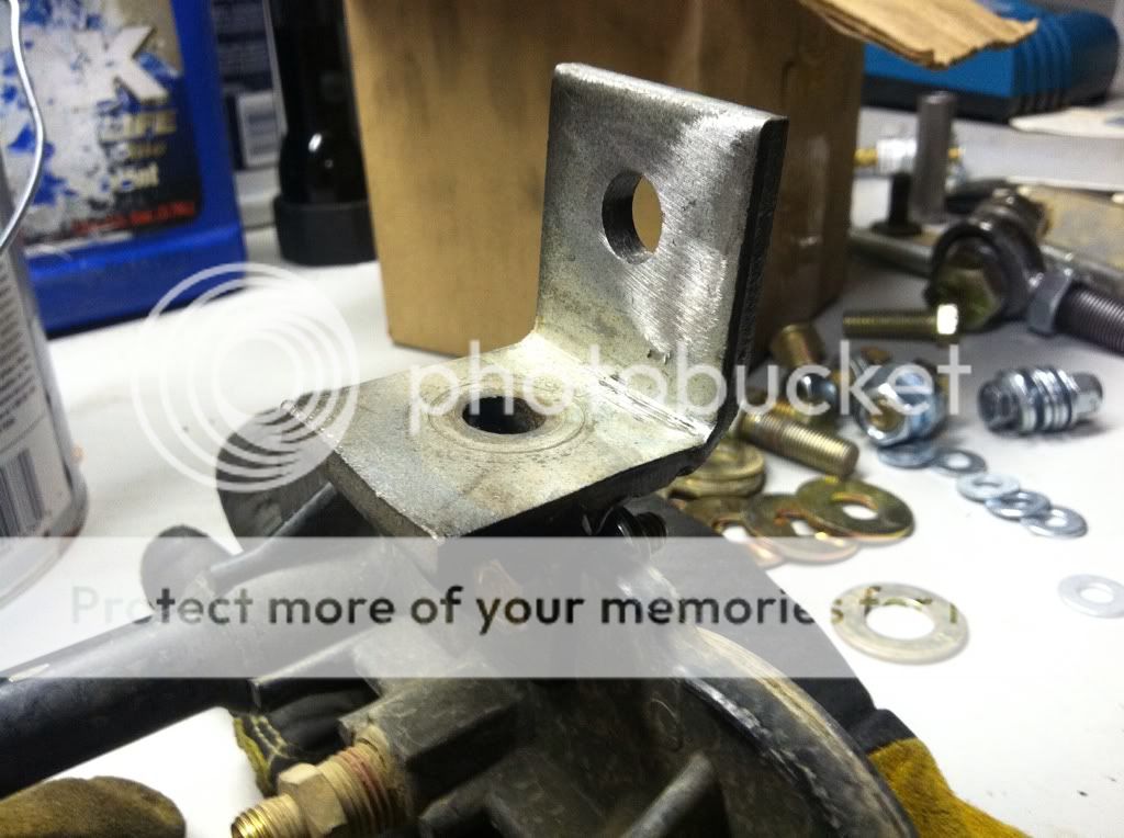

From there who knows...I might just sit on it and save some money up for a long while before I do anything again to it (maybe drill out the knuckles for OTK steering....and balljoints....that way I could at least get the knuckles on and a tie rod fabbed up).
Ya id def get the knuckles drilled and tapped for future, especially since they are torn apart right now. And youd want new ball joints in there anyways so it keeps you from removing them twice. Good idea with the all thread. Did you sand the tube so it would slide in there easier?
oh and if you got time you should flap disk the pumpin to remove the rough factory cast edges for a better look when you paint it
Yeah I sanded both the tube and the wedge, not very much though.
Hagan, got the axle shaft today. Thanks again for the deal :icon_thumby:

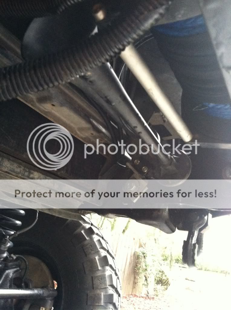

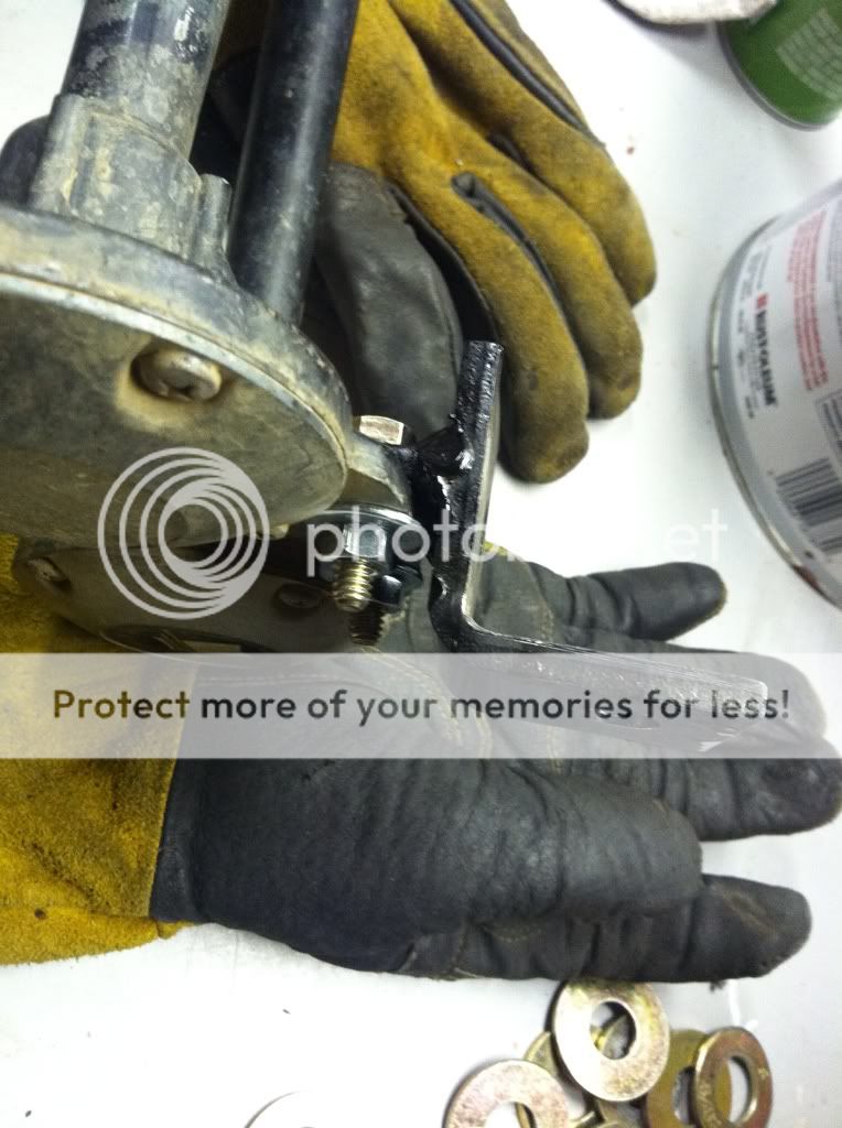

Made a mount for my air horn. Will get a final install pic up tomorrow.
Project 4x4 Commuter Mazda

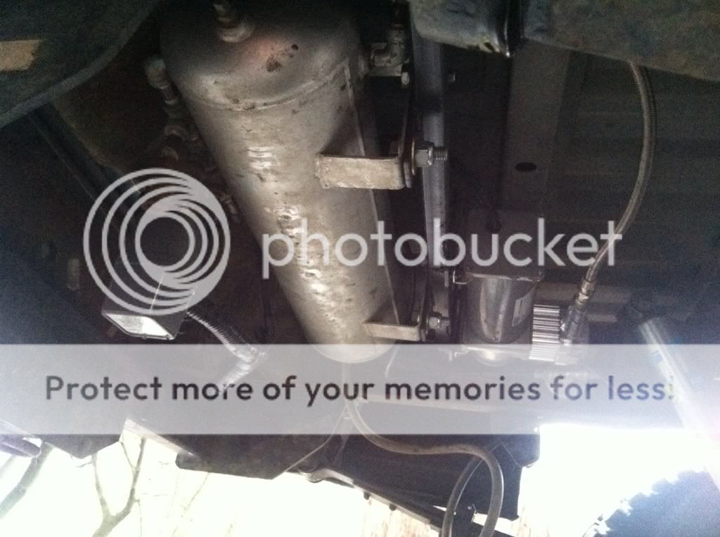

Not sure if I got a final, installed and operation picture up of my air setup:
Horn installed:

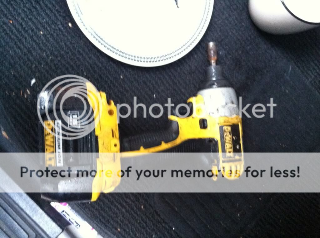

And a surprise goody I found in the street today...perfectly functional with a fully charged battery. Just has some minor road rash and cosmetic flaws...topped off my lug nut torque's nicely :headbang: :beer::beer: We use these at work (and Makita's) so if it or the battery dies I may have a shot at a trade or at least some credit towards a brand new one...Haven't decided if I am gonna keep it...might give it to dad or to a friend since I already have an 18V makita impact.
