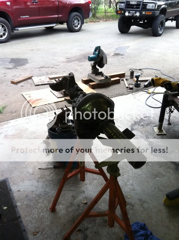

After some math, I figure out where I am going to cut the tube. Just need to verify that my cutoff saw cuts fairly square :icon_thumby:

Meh if its not exactly square its not gonna kill anything, theres plenty of slop to acount for it

I would cut it as square as possible. You want it to fit square into the cast section.

It will be cut square enough, since the cut end goes in the tube, if for some reason it ended up a bit crooked it wouldn't be that huge of a deal since it is a press fit and can only go in concentric with the wedge....plus with weldment on it no one would ever know. I am more concerned with cutting it the correct length, as to not be a headache later on (shaft to long and needing grinding, or shaft too short and not getting enough spline engagement). Both situations would only happen though with an error of more than 3/16" I believe...I am confident that it will be withing +/-16" or better when I am through with it. Again, this isn't rocket science here :D Worst case scenario I'd have a custom shaft made or have the stocker cut and splined the correct length.
Cutting it off was super fast...no wasted time grinding the weld down and looking for the seam, and the more time required to beat or pull it off with a machine. Cut and done, then about 15 min of grinding on the face of the wedge. I only spend and hour on it that evening.

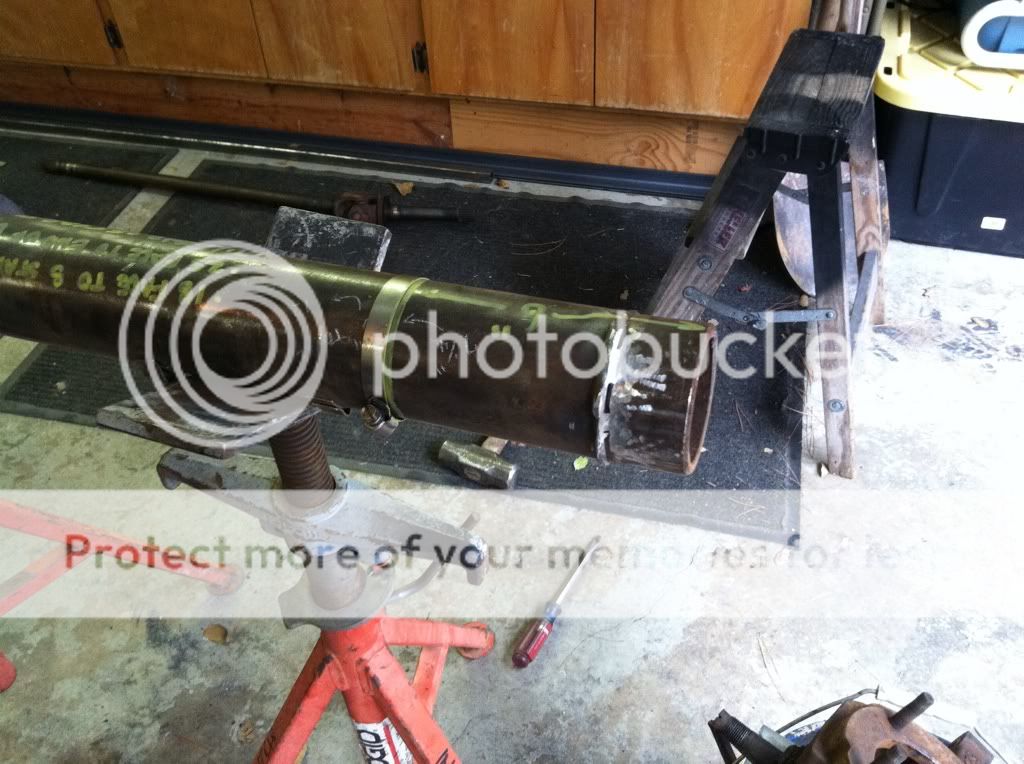

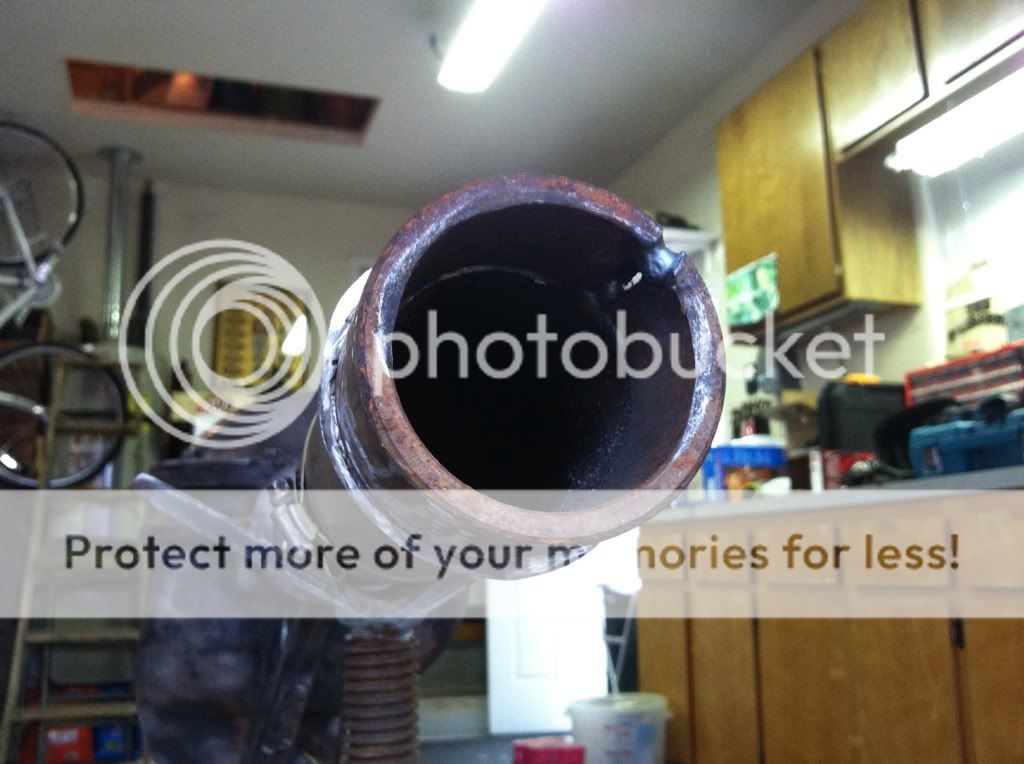

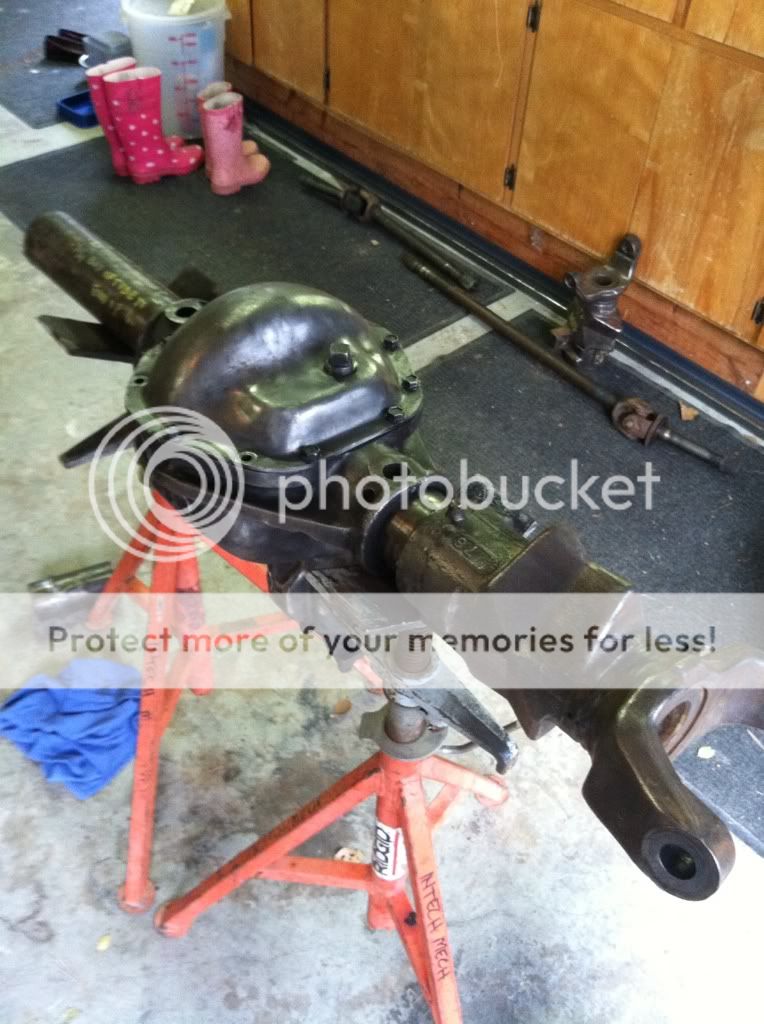

Took the piece of tube that I cut off, smashed it with a c-clamp, tack welded it to itself (so it would slip inside the wedge with no resistance)...then tack welded it to the tube, so that I could double check my math:
After marking where I think I should cut it (11.75" from the face of the housing) I measured from the end of the tube to my marked line and wouldn't you know it, exactly 6" shorter is where my line ended up (actuall 5.875 since I ground some, and the width of the bandsaw blade):
Then proceeded to hack it off:
Measurments came out to withing +/- 1/32"....more than good enough for the girls I go out with :D

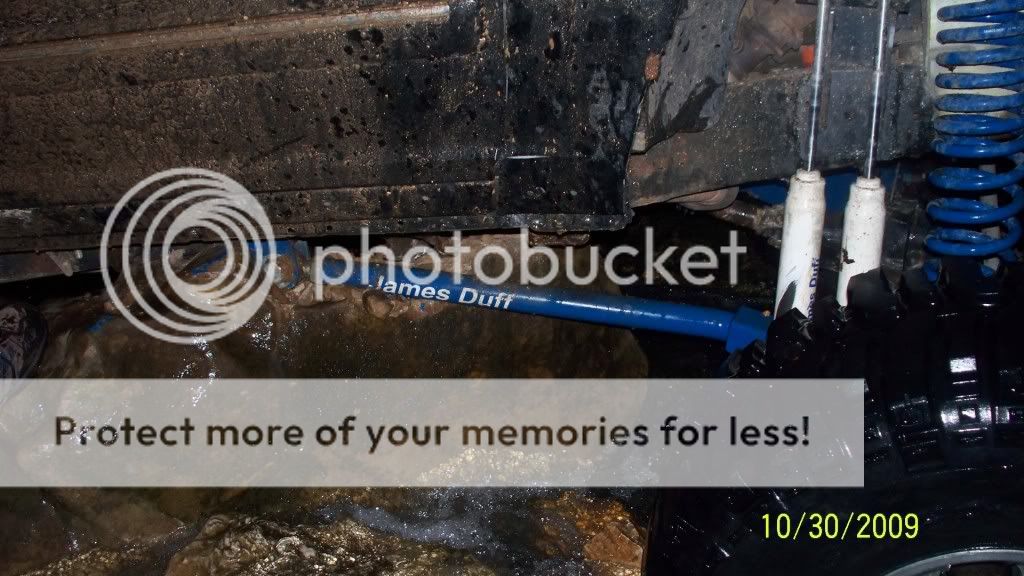

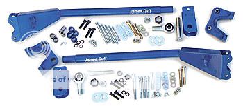

The duff arms are nice but I think they are about $900. Way too pricey for me. I just got done building my arms for around $240. The heims were $125 from Ruffstuff and I got a 20' stick of 2x2 .25" square tubing for $84. And I got square tubing adapter for $30. They turned out pretty nice in my opinion. And now I have a lot of square tubing left.

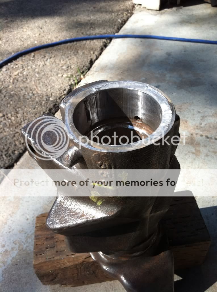

Used my flapper disc die grinder and cleaned up the inside of the wedge:

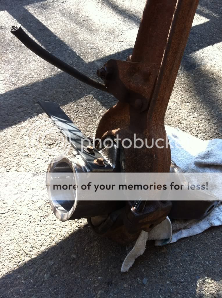

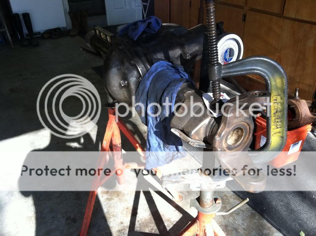

Bolted some flat bar on for my angle finder, and mounted the radius arm to aid in adjusting the C angle relationship to match the other side:
Got the wedge started, it will go on no problem now with heat and a sledge:
Hagan, James Duffs arms are $750 or so shipped… yeah still a lot of money but they are pure beef and eye candy. I really like the way they look.
