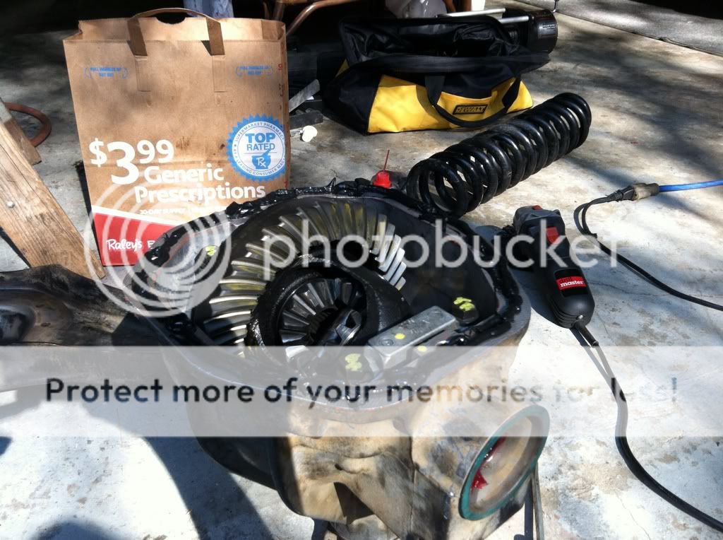

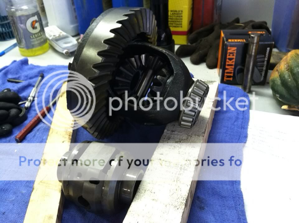

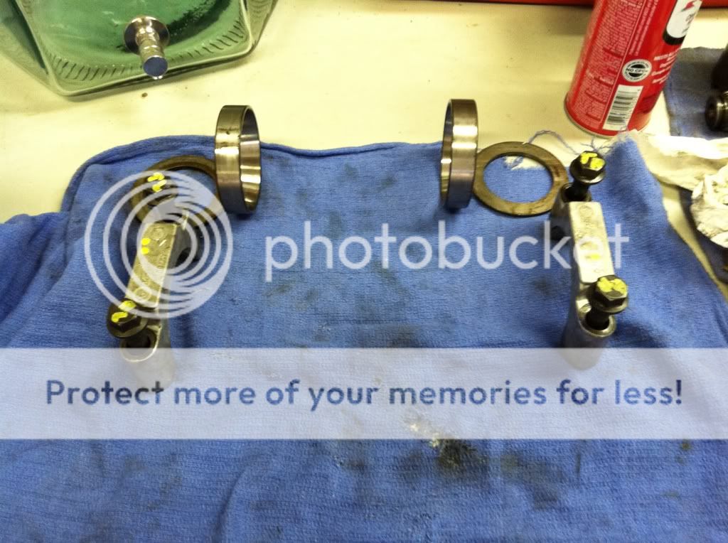

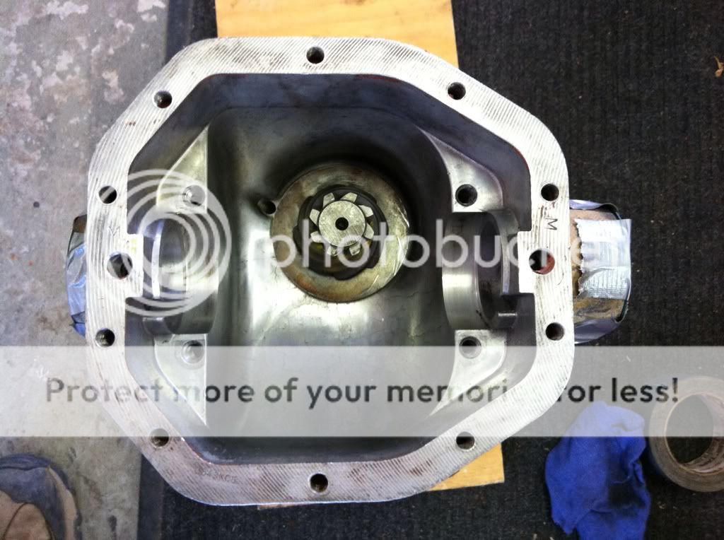

Got the diff in, the locker out, the driver's u-joint cleaned up and tacked, and all back together. Tomorrow I will tear down the passenger side, to get the passenger axle shafts back into the diff.

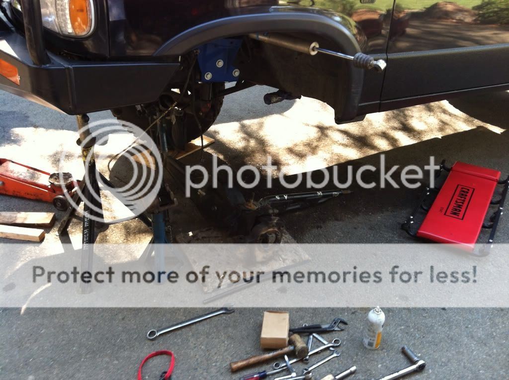

So I finally got around to putting the passenger side axle shaft in, and dialed that in today. Means I have 4wd :)

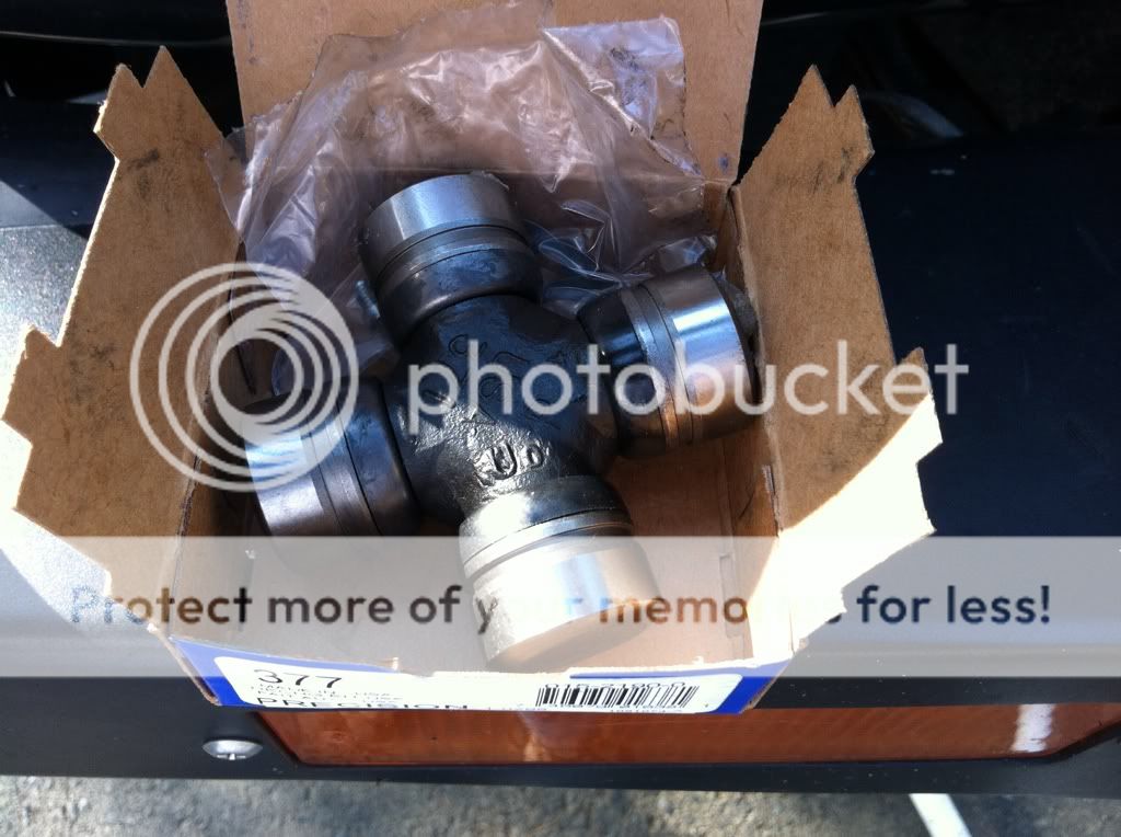

While it was apart I replaced that u-joint with a Napa "Super Strength" u-joint that has a zerk fitting. I am pretty pissed that my expensive Spicer 5-760x's only lasted one year (I claim it is because they are non-geaseable in nature).
The old u-joint was dried up and in pretty bad shape.

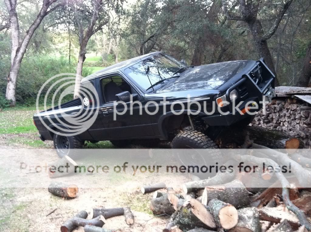

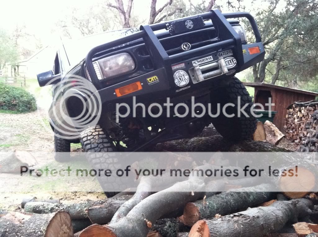

Yard wheeling, testing new ratio and lack of front locker:
Not too bad actually for a pavement pounder:

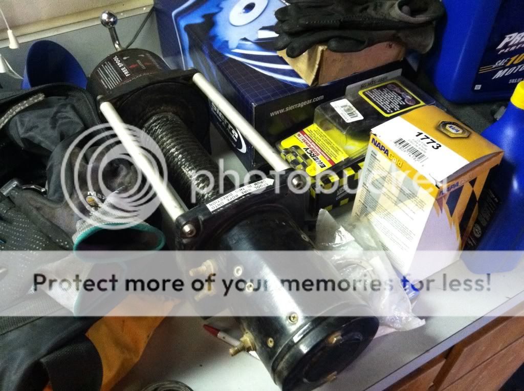

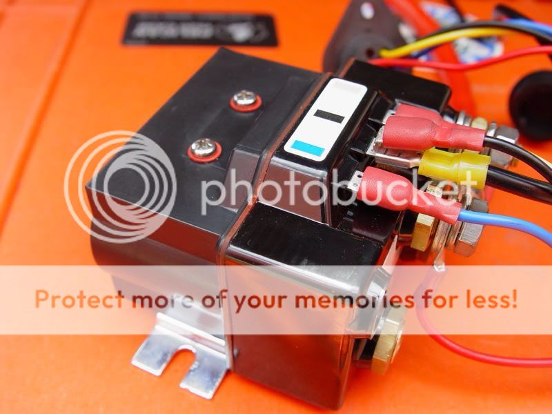

Ordered a Superwinch, Albright waterproof heavy duty winch solenoid to replace the crappy Smittybilt one (I have been through 2 now):
