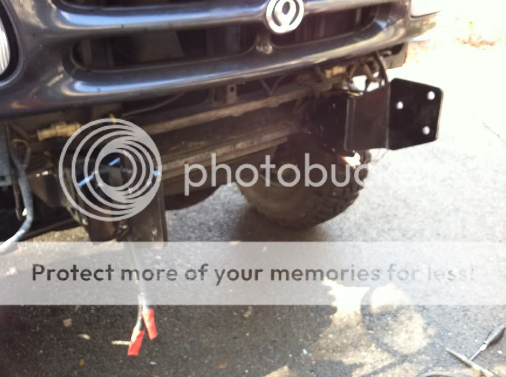

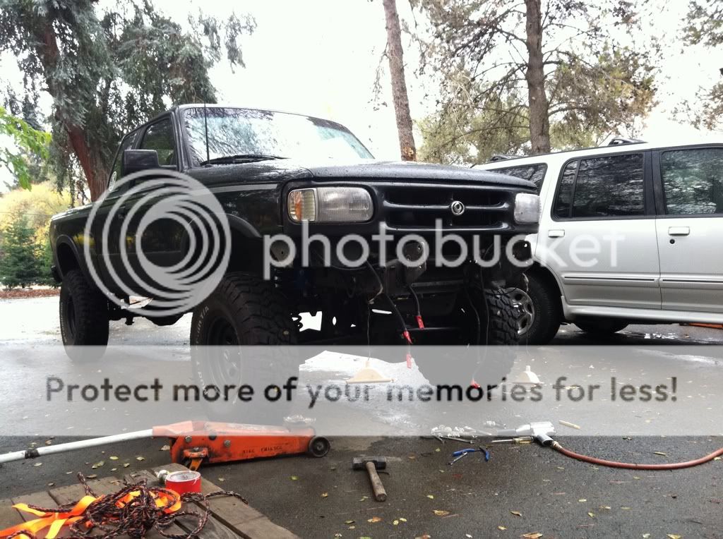

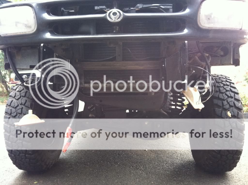

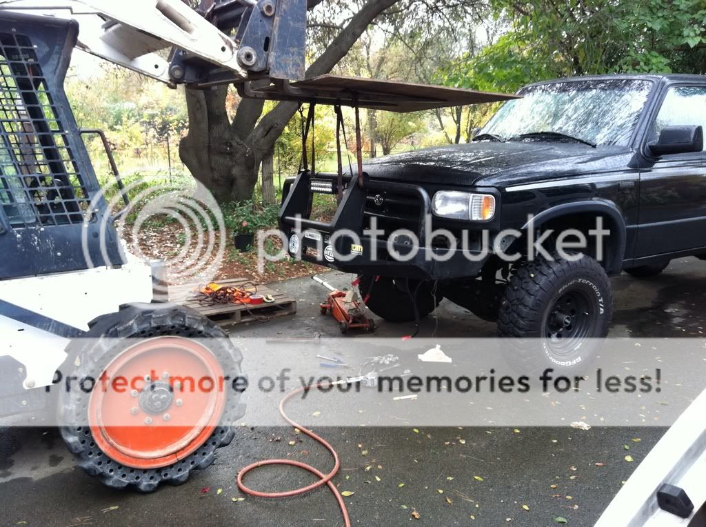

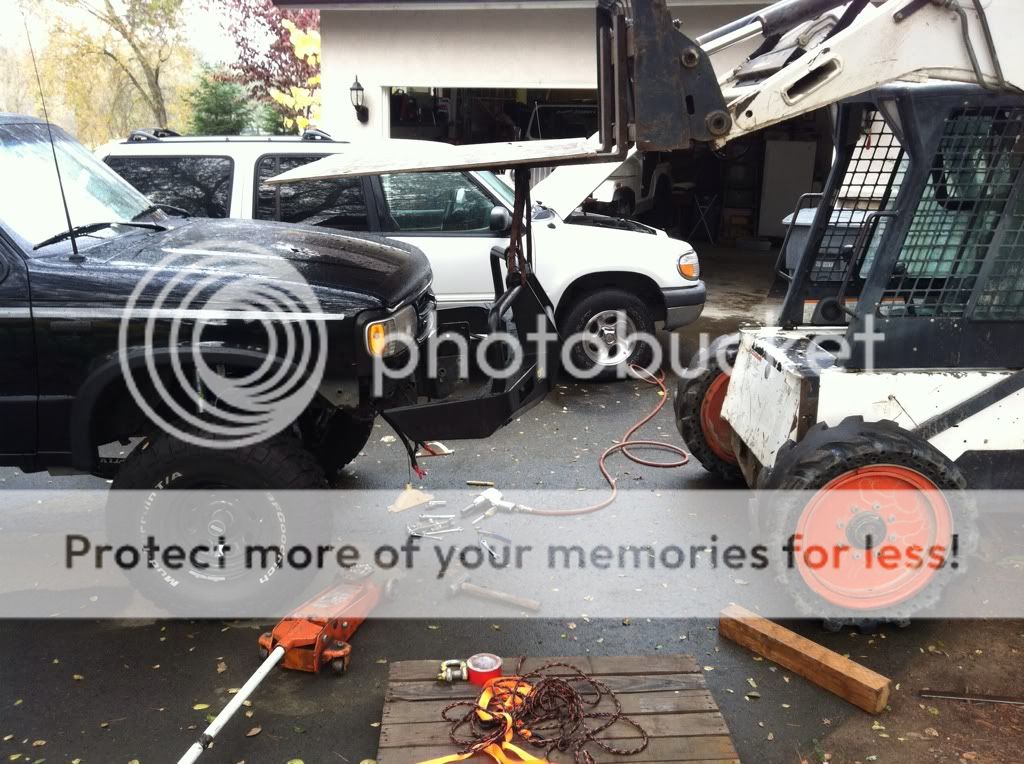

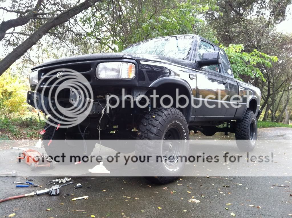

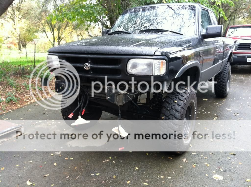

Got the bumper lined up perfect and then proceeded to take the winch/bumper off so I can box up the brackets & frame tomorrow! :icon_welder: Notice the plywood umbrella, since it was sprinkling...Also note the positive camber and the upward angle on the tierods after removing about 190lbs off the front end.

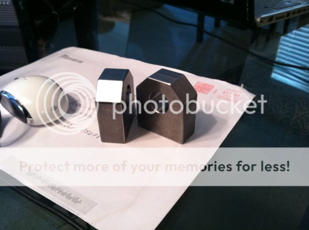

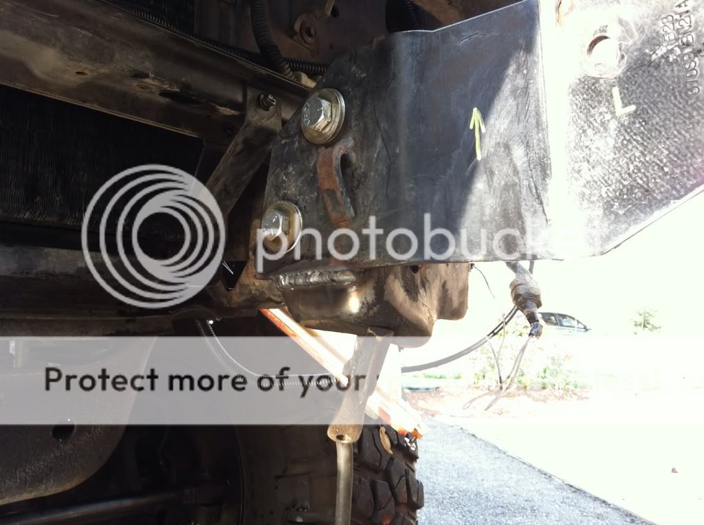

Hopefully my shackle mounts get here in time for me to weld them on?

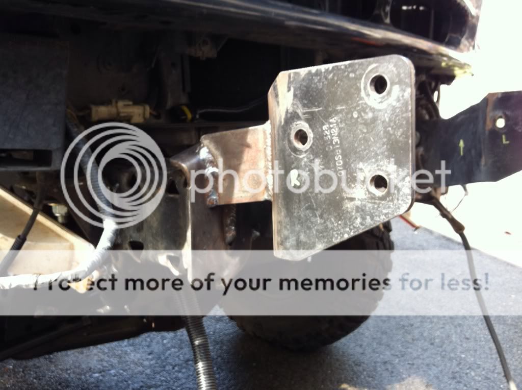

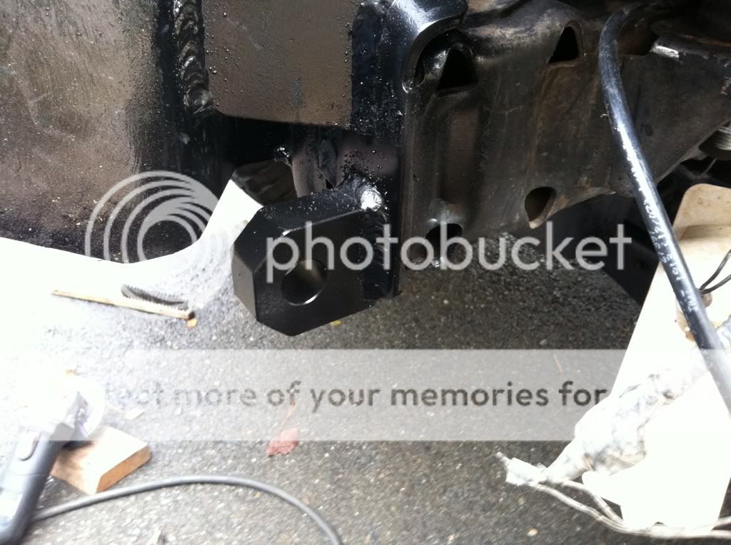

D-loop mounts:
Project 4x4 Commuter Mazda

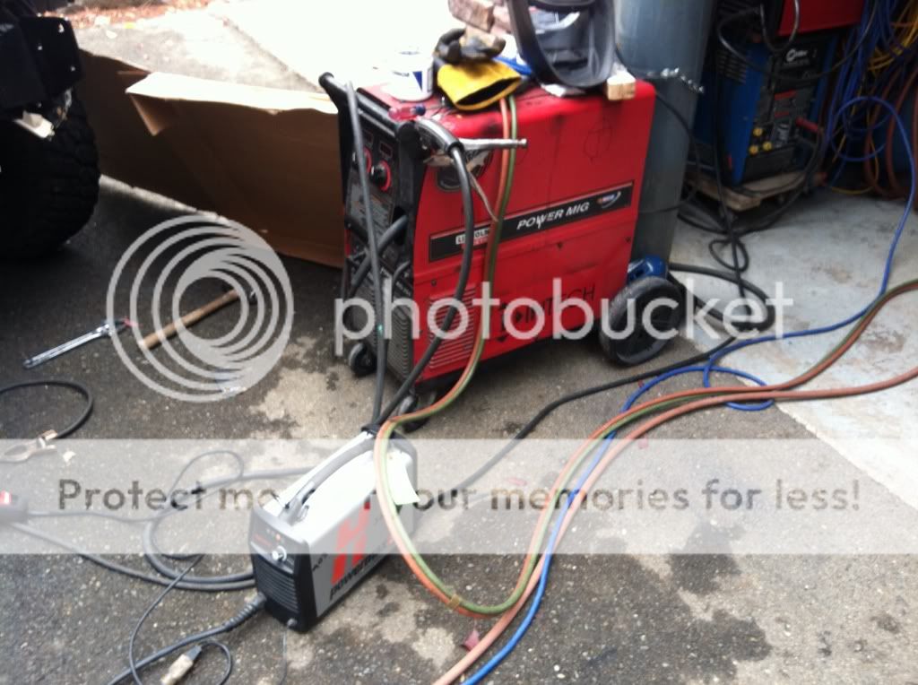

Tools of the trade:

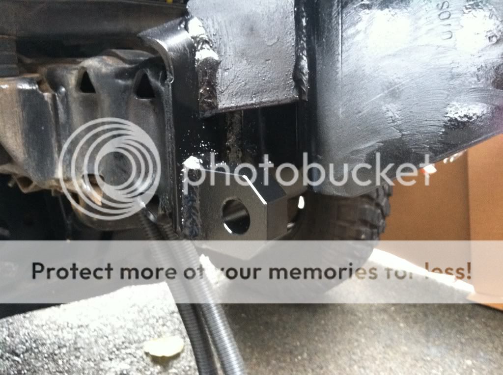

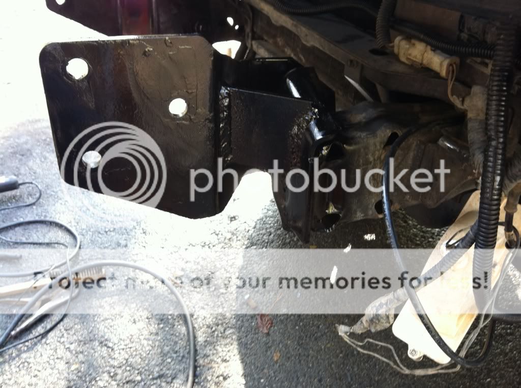

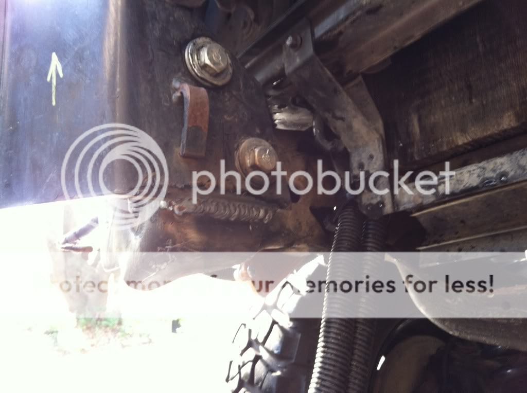

Half of my list is done. The other half consists of cutting that gawd awful looking cross member out beneath the radiator and welding in a new hihg clearance one....and welding some brackets for my new steering damper. But that's all for today...
so the clevis mounts are gonna be under the bumper instead of thru it???
Yeah the bumper is only 1/8" so I didn't want to weld to that cuz it would be flimsy. Then I would be pulling on the thin bumper, which is pulling on the mounts, which is pulling on the frame....too much of a chain, and a chain is only as good as the weakest link. Too many failure points.
I much rather have it welded to the frame.....Keeping it simple. Only one place for it to fail...and I know it won't fail where I welded it but somewhere along a seam that the factory welded....but I hope to never get that far!
