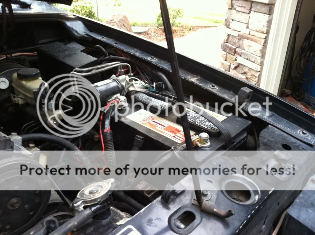

New battery:
Project 4x4 Commuter Mazda

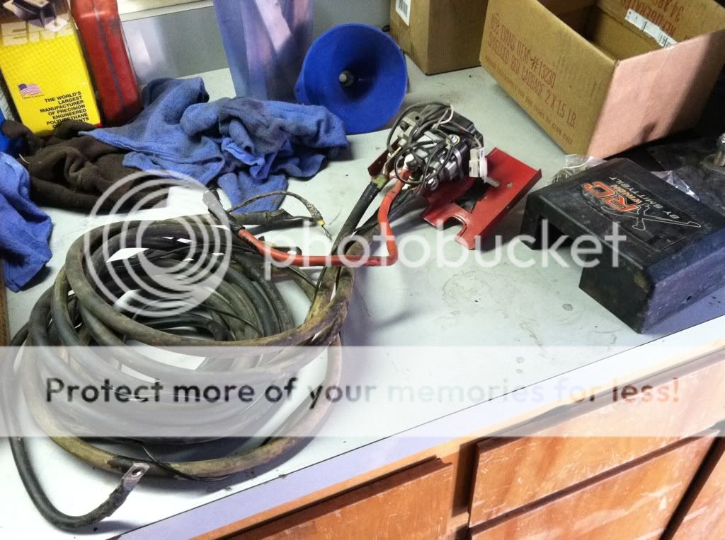

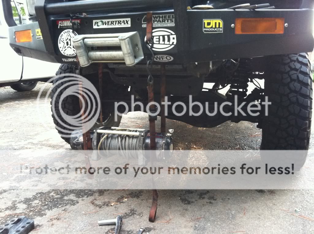

Taking my winch off:

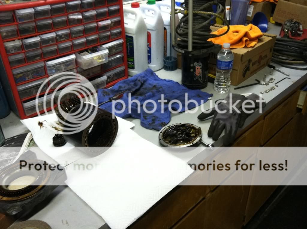

Dismantled and fix my winch. The selector handle was jammed up with rust:
