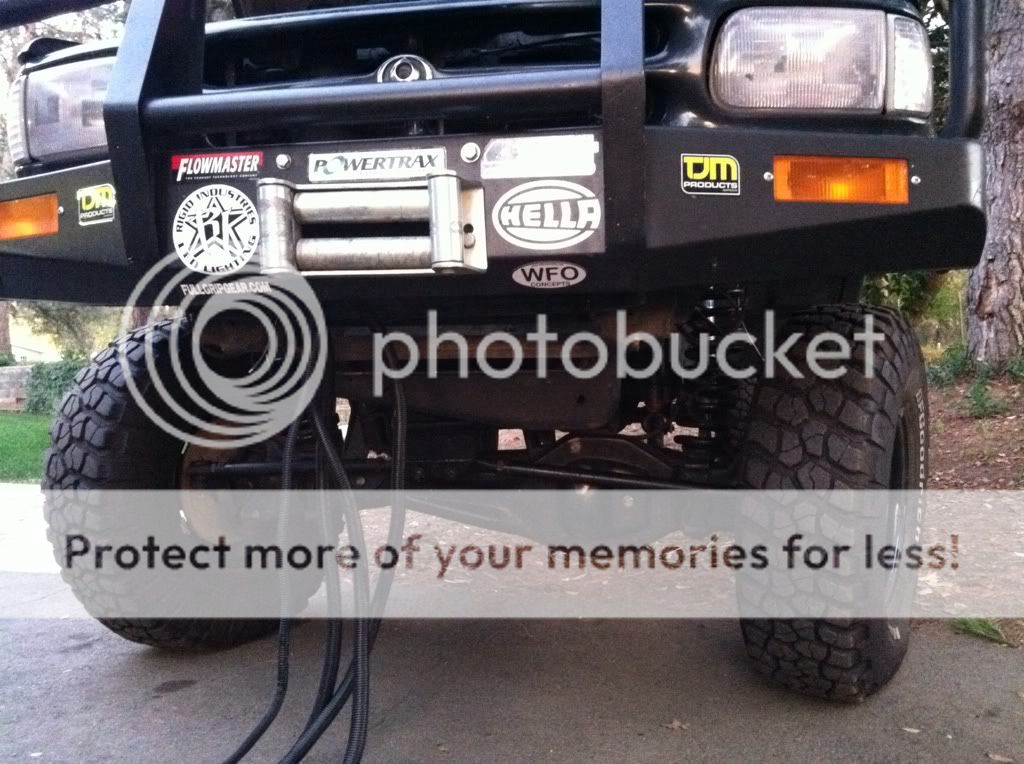

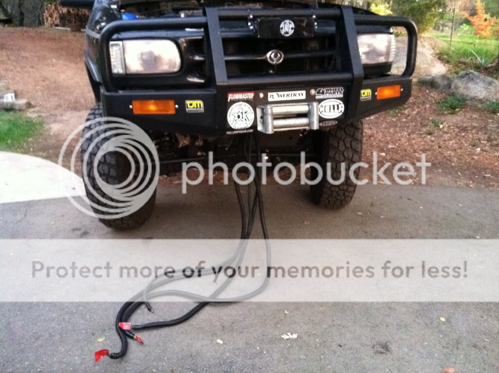

Got the winch in:

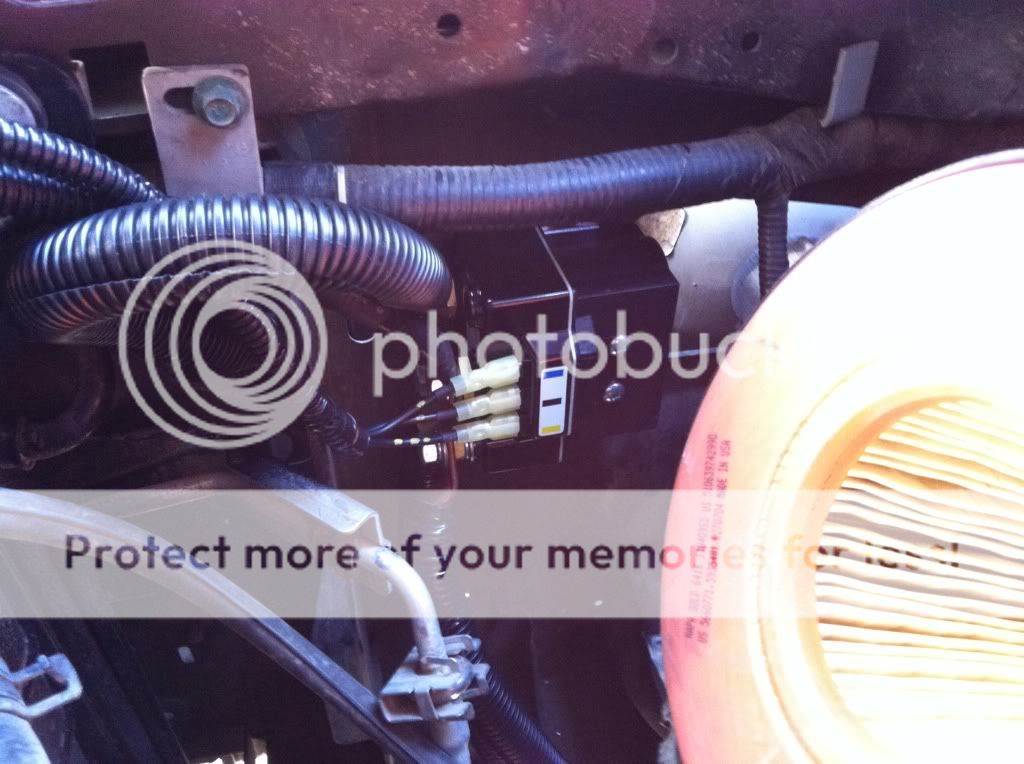

I'll get some pics up of where I mounted the solenoid tomorrow hopefully.

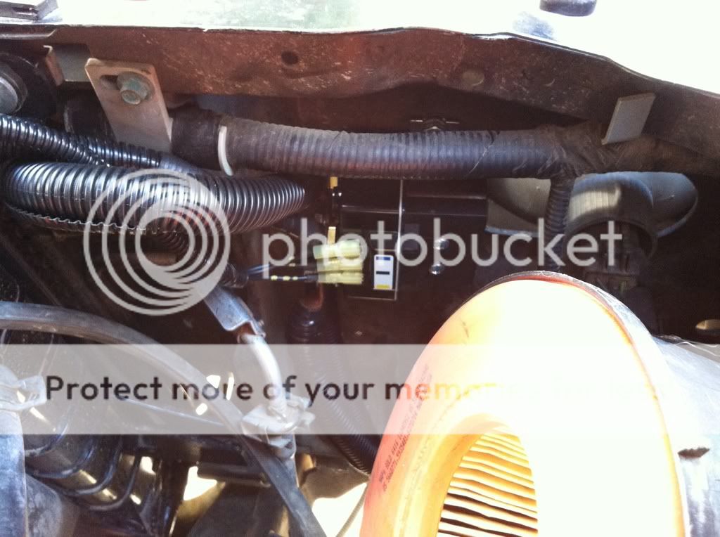

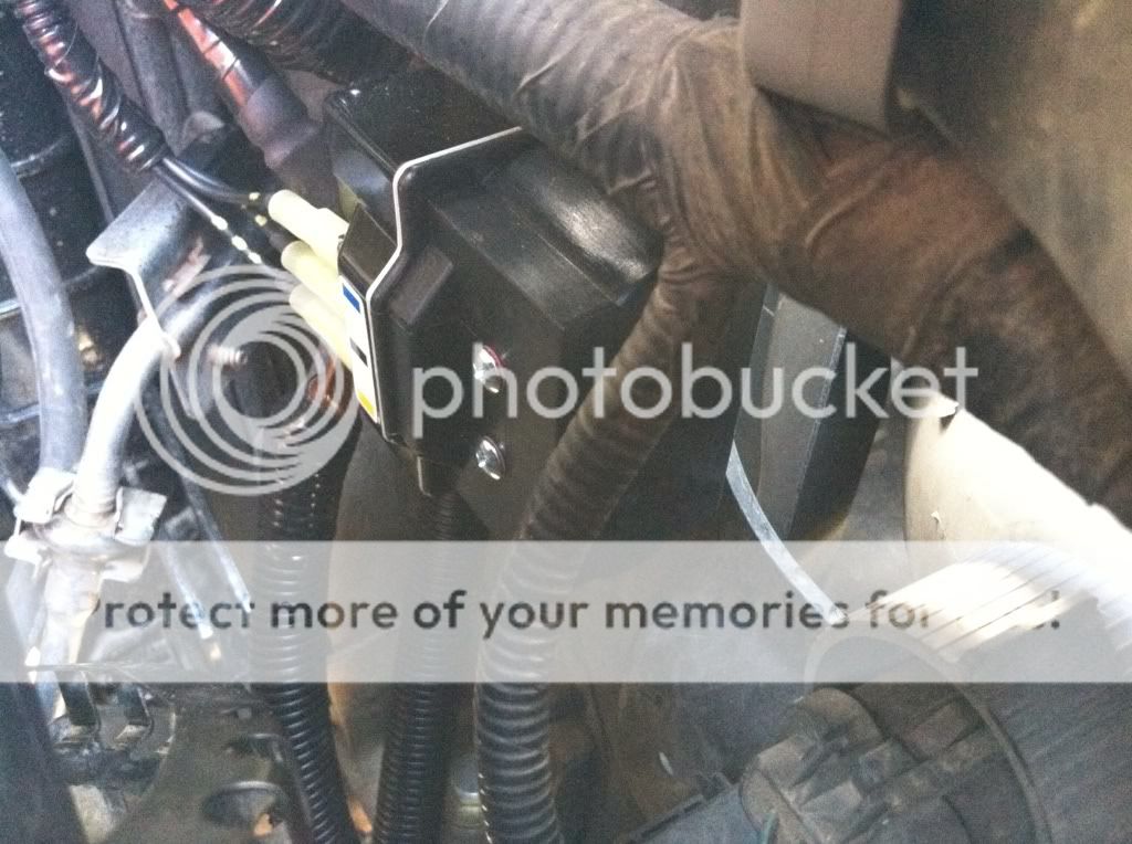

I got the solenoid mounted, wired and all the 1ga cables ran as well as the controller wires. What a pain. I hate wiring.

Much easier to wire this solenoid up versus the Smittybilt one which was excessively complicated.

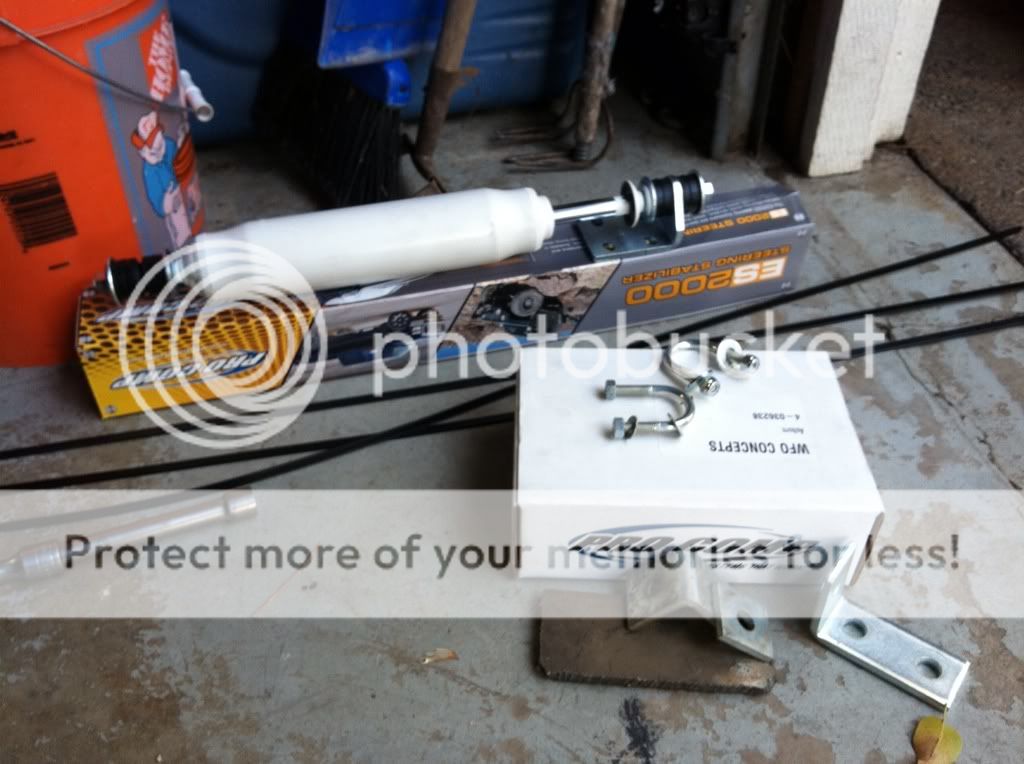

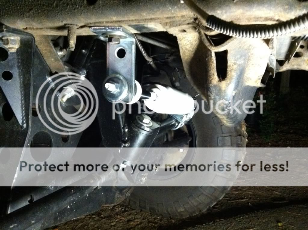

Steering damper from WFO, gonna try and put it on this weekend:

I shoulda had you come wiring all my winch crap. 2 day project.

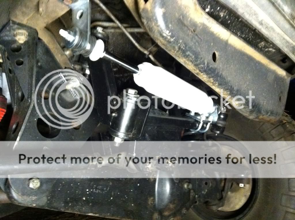

Damper:

Its a tight fit, but it all clears lock to lock. And since it is mounted to the centerlink, I don't have to worry about clearance issues as the suspension cycles. :icon_thumby:
I wanna tack weld the bracket to the frame, to inhibit bracket rotation around the bold. And I want to weld a small triangular gusset to the same bracket, to help stiffen it up a bit (long lever arm).
Other than that, works like a charm.
