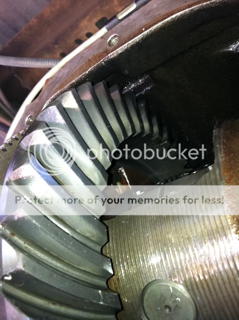

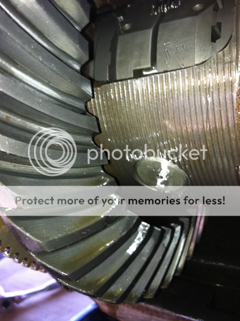

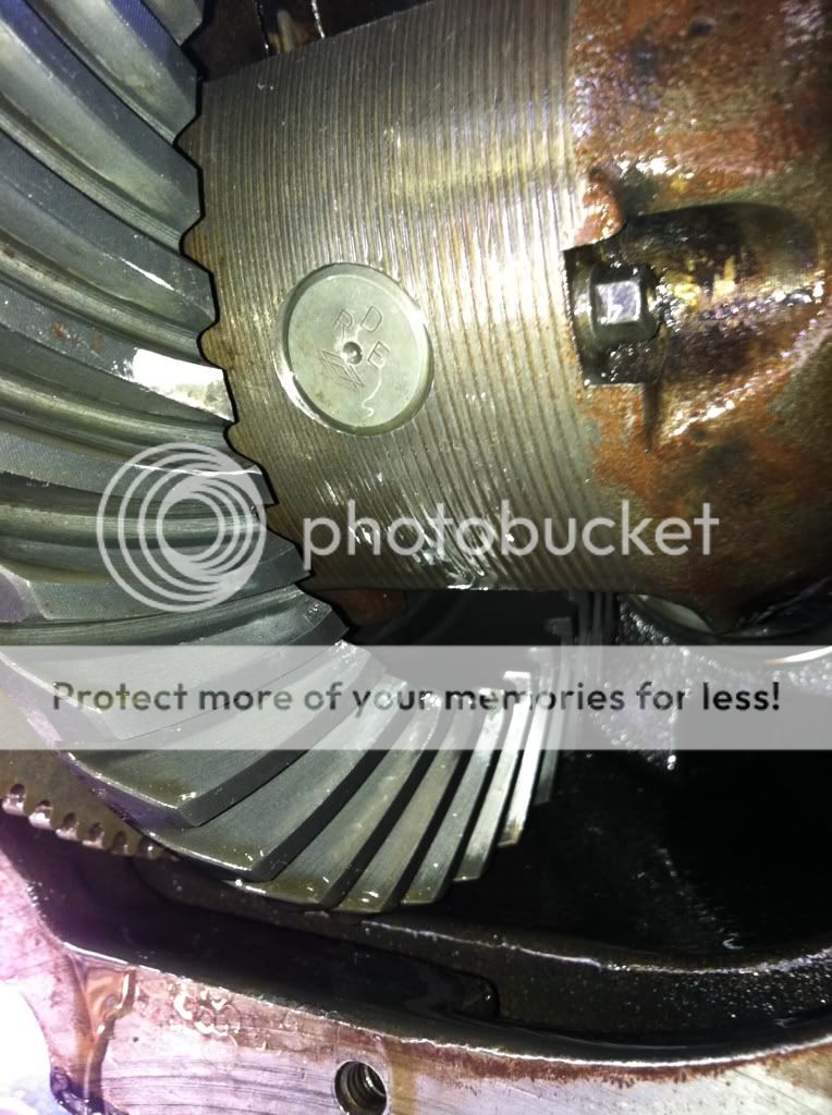

600 miles of wear, and fluid change:

I guess the pattern looks ok? No shavings or flakes at the bottom...Still whines though pretty good @ 55mph, maybe the pinion bearing?

Wear looks good.
