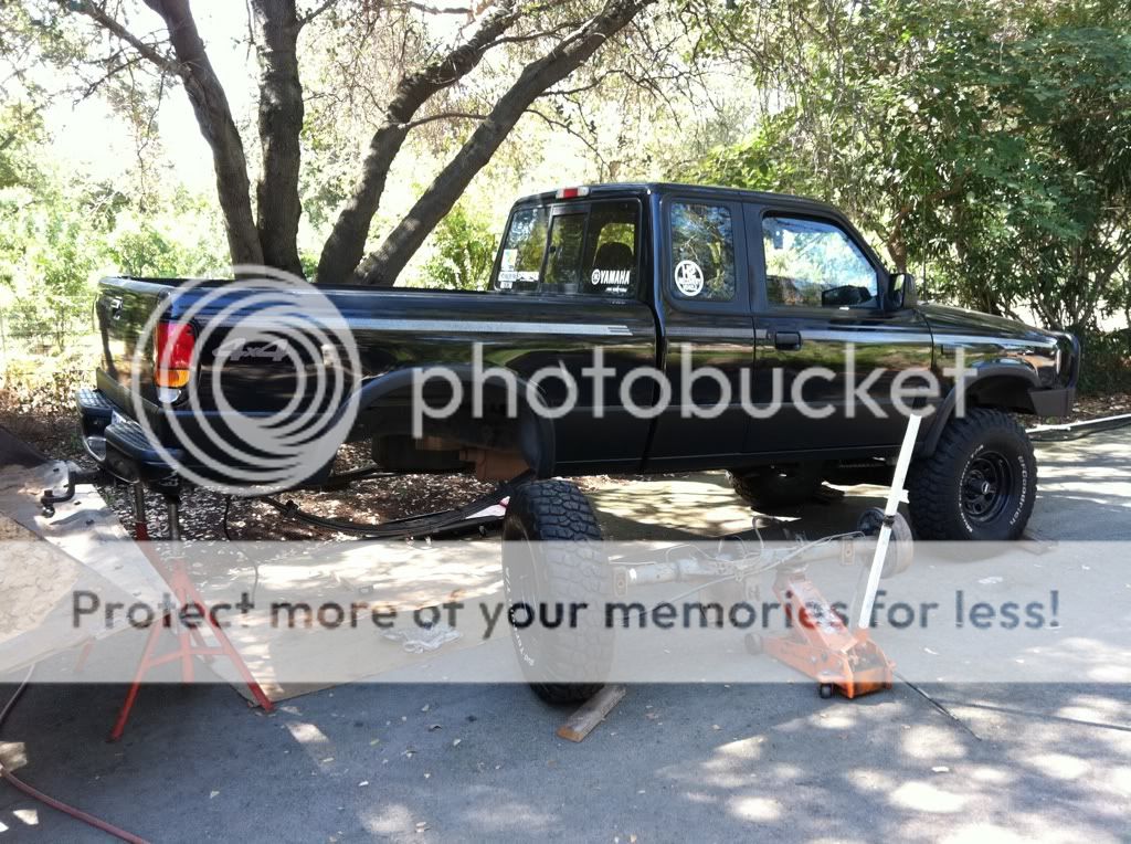

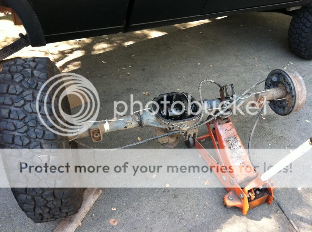

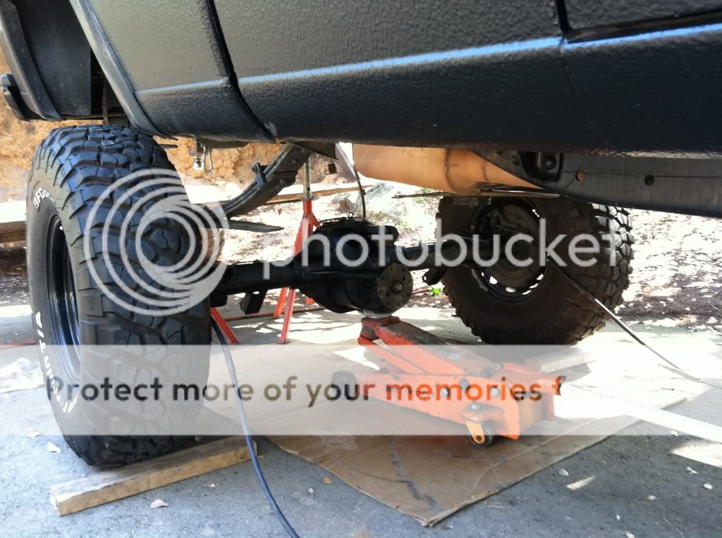

Going to try and tackle the 8.8 swap this weekend :headbang: Hello 4.88's!

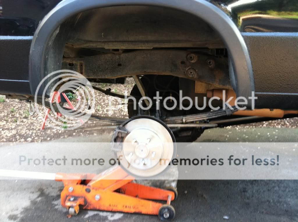

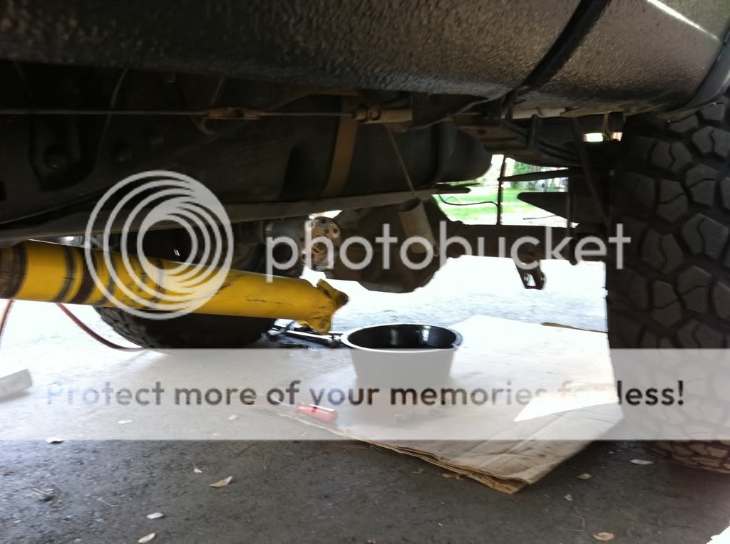

8.8 swap is commenced:
No hiccups yet...

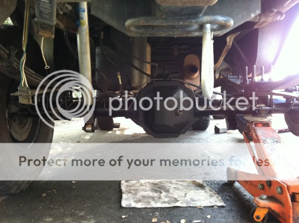

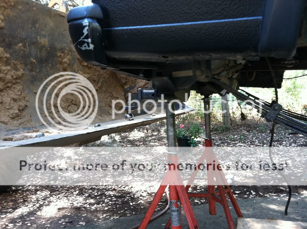

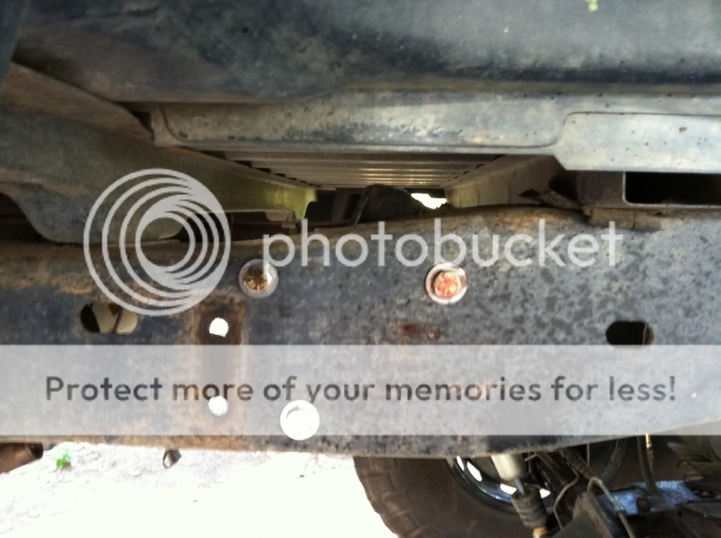

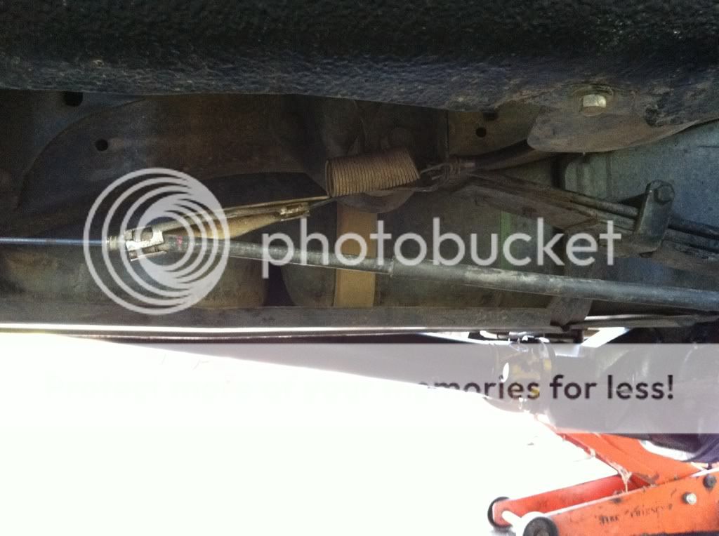

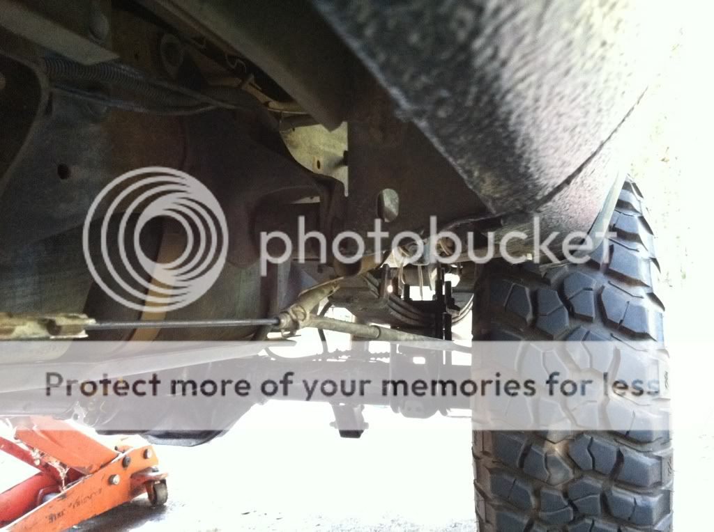

Can't get the right side parking cable to get tight. Left side tightens up great.

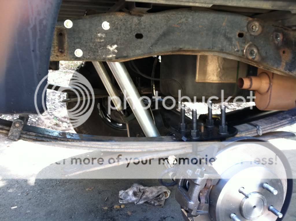

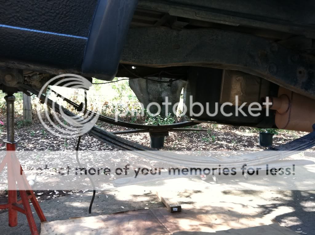

Lost some lift height, the RuffStuff ubolts were not long enought to reuse the stock blocks. Net loss is 3/4".

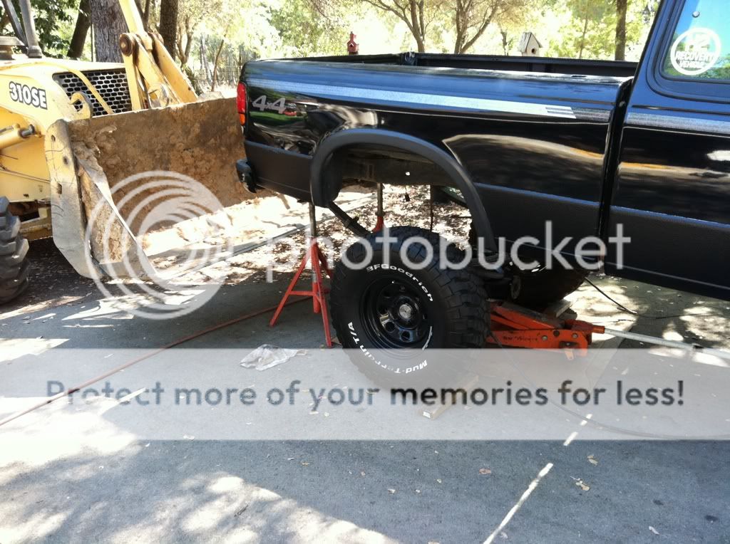

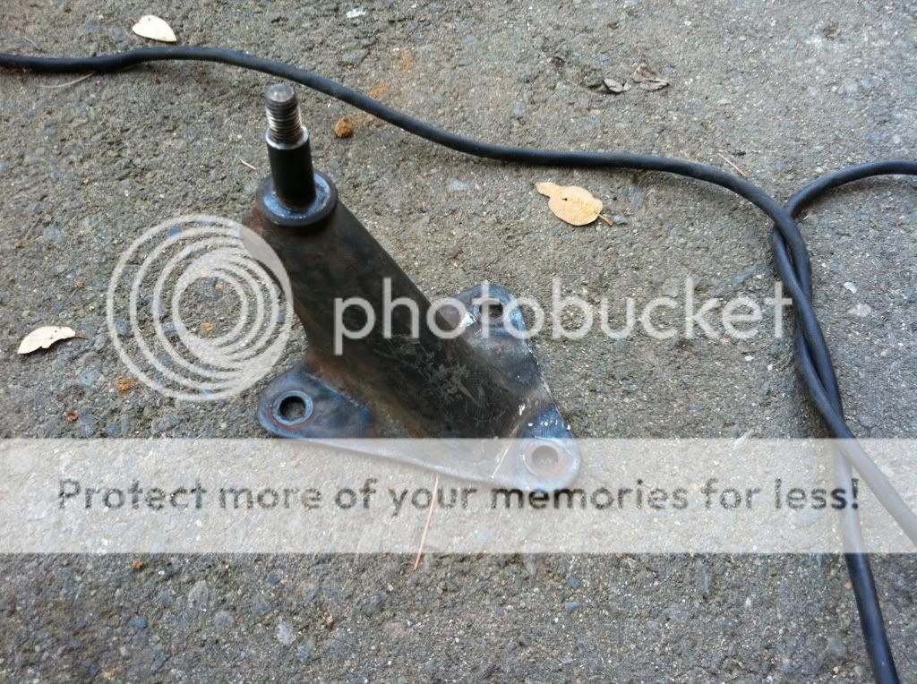

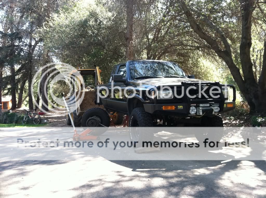

Mostly done. Just need to bolt the shock mount onto the opposite side of the axle, cut the u bolt threads, take the 4wd fuse out (mismatched gears), put the shock on, throw some more paint on it and then call it done!
I like how you used the bucket on the backhoe. Better safe than sorry.

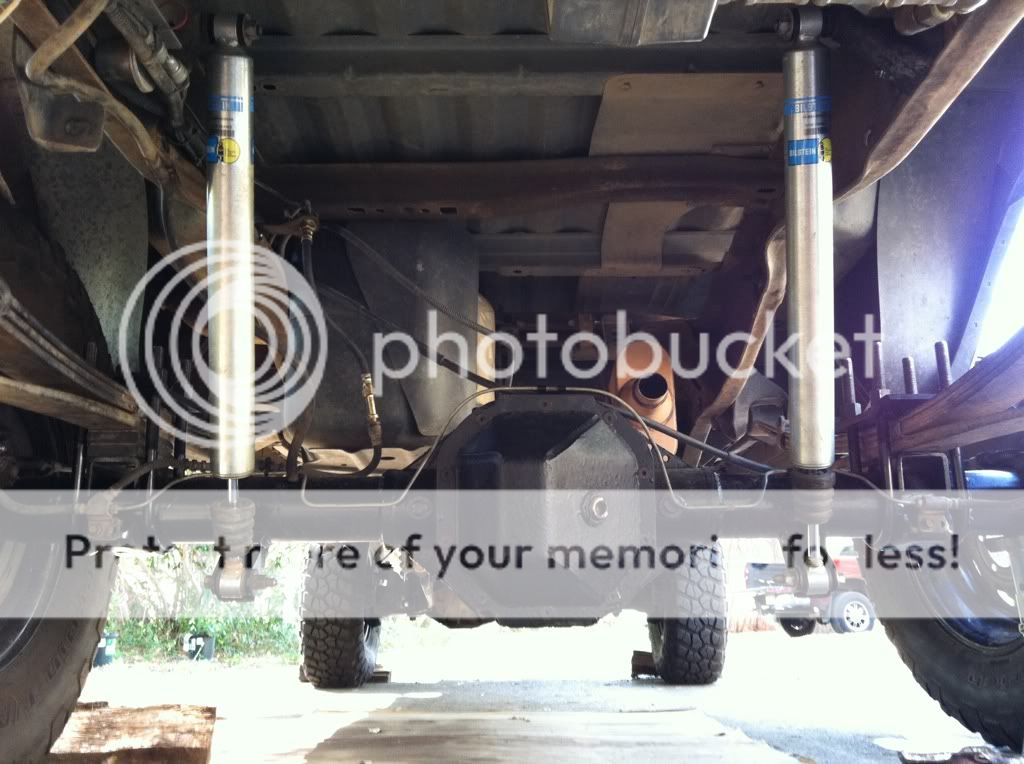

What shocks see those hour using. They are bilsteins but what kind.
Yeah that is what the upside down drop hitch was for...to catch the fall and to fine tune the height for lifting it up.
They are 5125 Bilsteins valved 255/70, in the 14" travel flavor. They are a bit long...

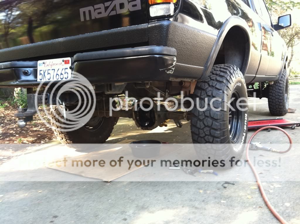

Swap. Is. Done.

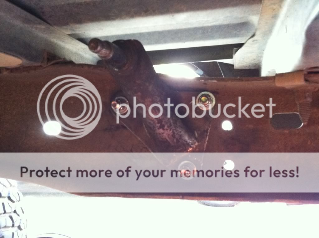

I bled the rear two calipers 3 times, but I couldn't get the pedal to not feel mushy as hell. Tomorrow I will re-bleed them and the fronts as well in hopes of resolving the excessive mushiness. Or is there something else I am forgetting like an ABS controller valve??? Need to drive this Tuesday if I can.
I would build new rear shock mounts higher up on the frame
