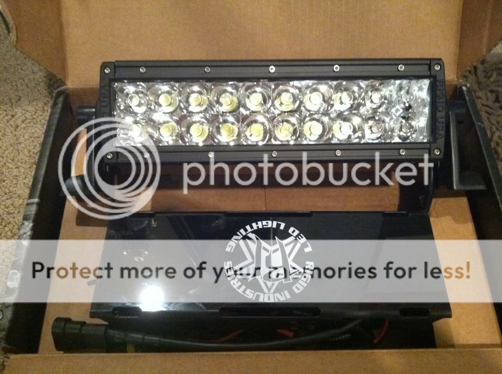

New bar:
Makes my Hellas look like a joke.

Light comparisons for the new 10" bar.
