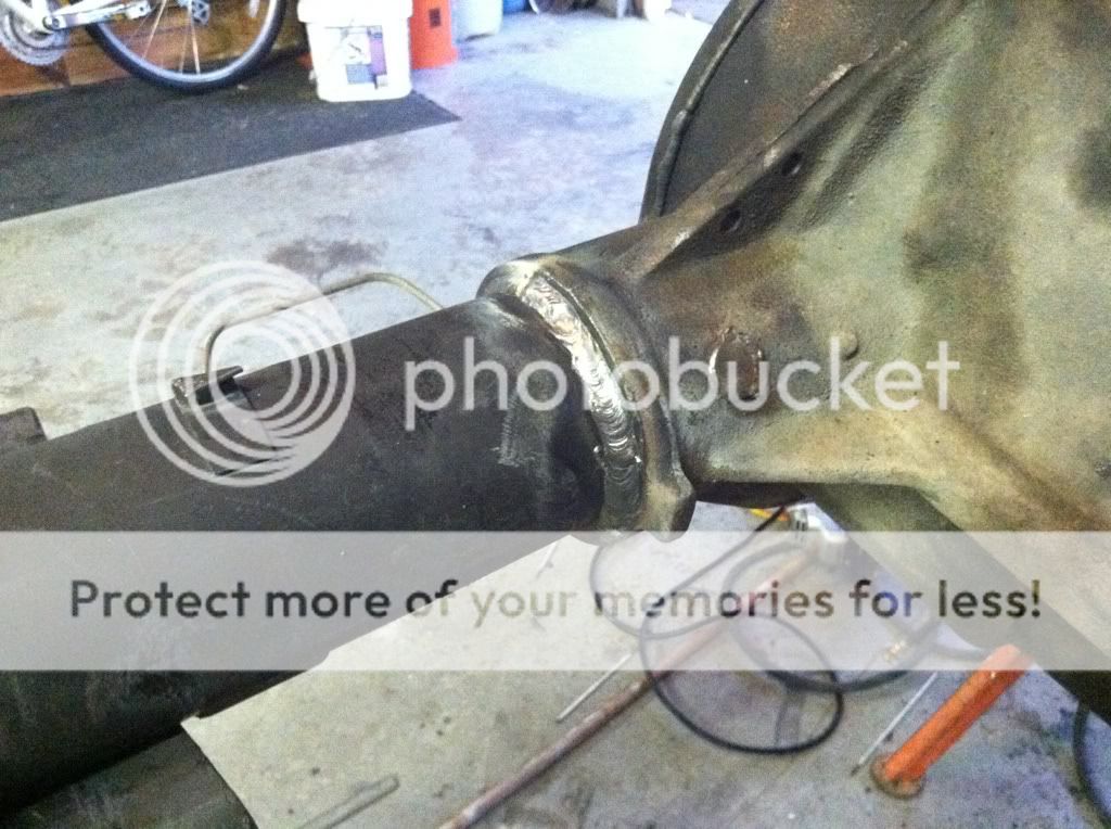

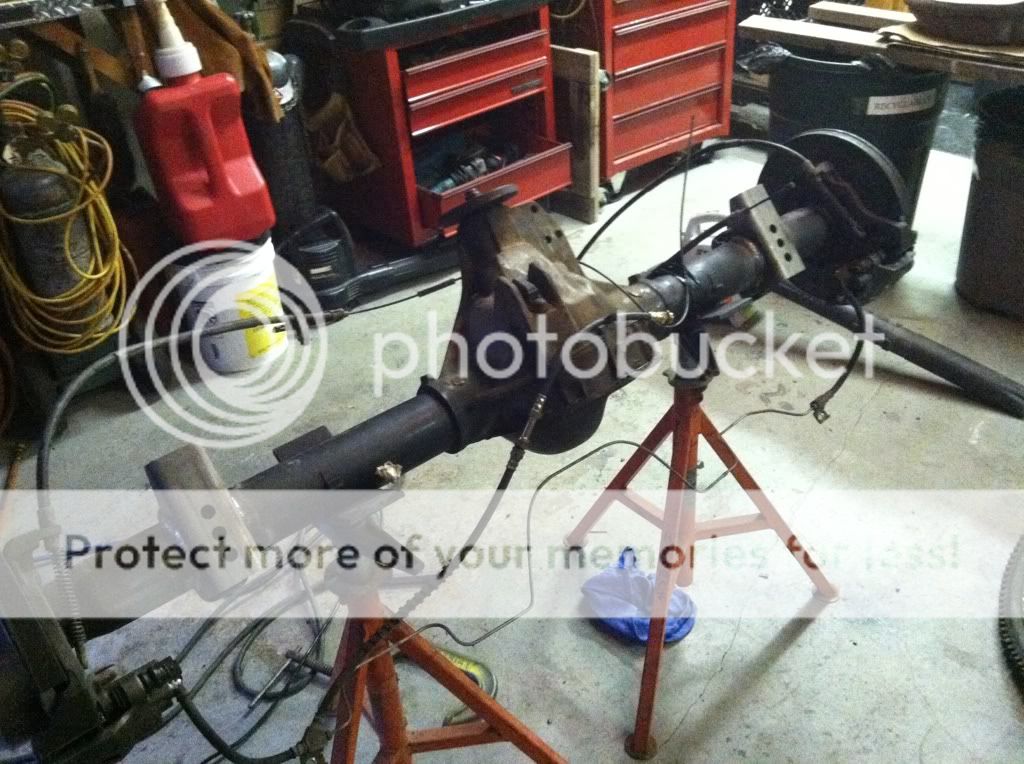

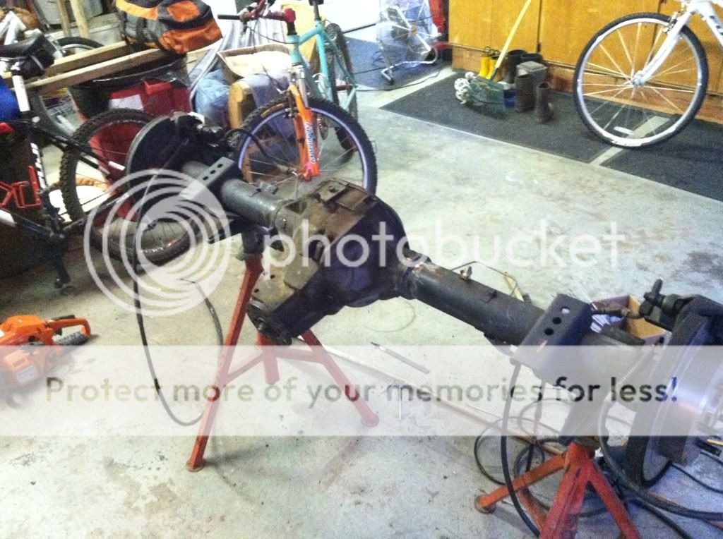

Burned some perches on today. Still need to weld the housing to the tubes, and shock mounts, then paint!

Welded the shock mounts on today:

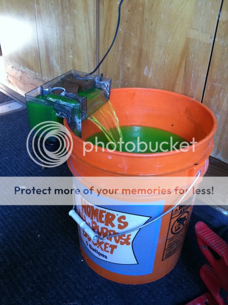

This is what you do with all that perfectly good anti freeze that sprays all over your truck when you take off the lower radiator hose.....I caught it in a 20 gal tupperware....then put it in the 5 gal bucket, with a fish tank filter. In about 3 hrs its pretty damn clean:

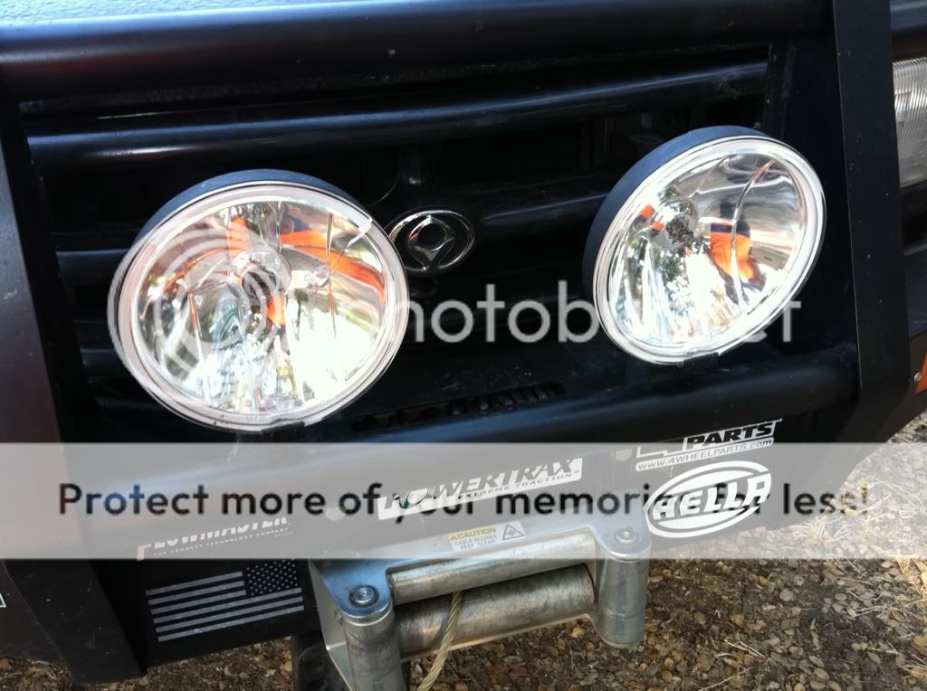

Time for HID's?

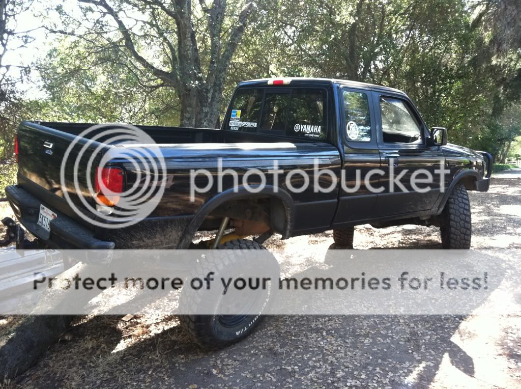

Here are some poser pics on the yard, since I haven't done some of those in a long while:

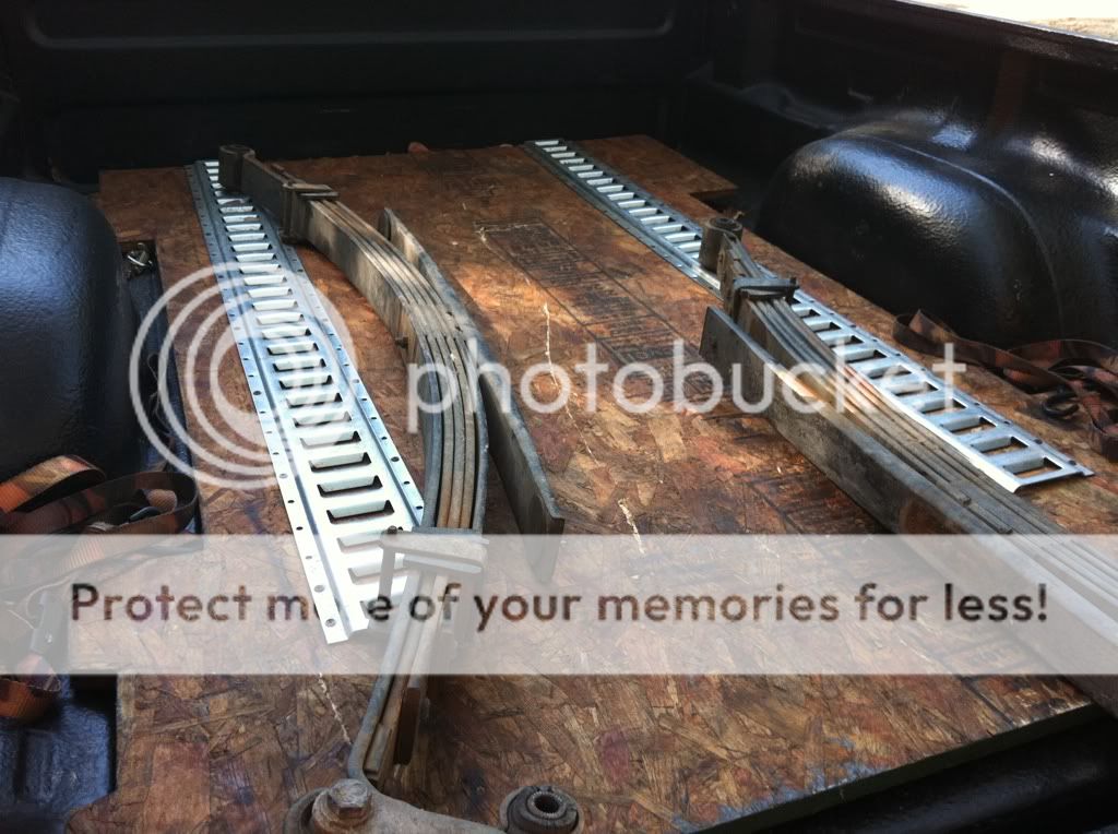

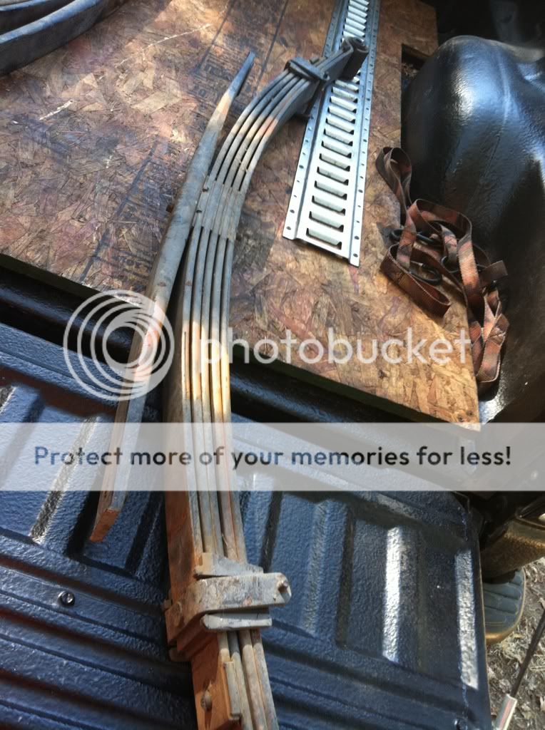

Picked up some 3/4 chevy 63's for $60 on CL! Will need to subtract out some leafs, with the overload its a 6 leaf pack! How many leafs do most ppl run for good flex and good on road ride w/o a crap load of axle wrap?

Probably won't be puttin' them in for a while, but I'll have them for when I do!

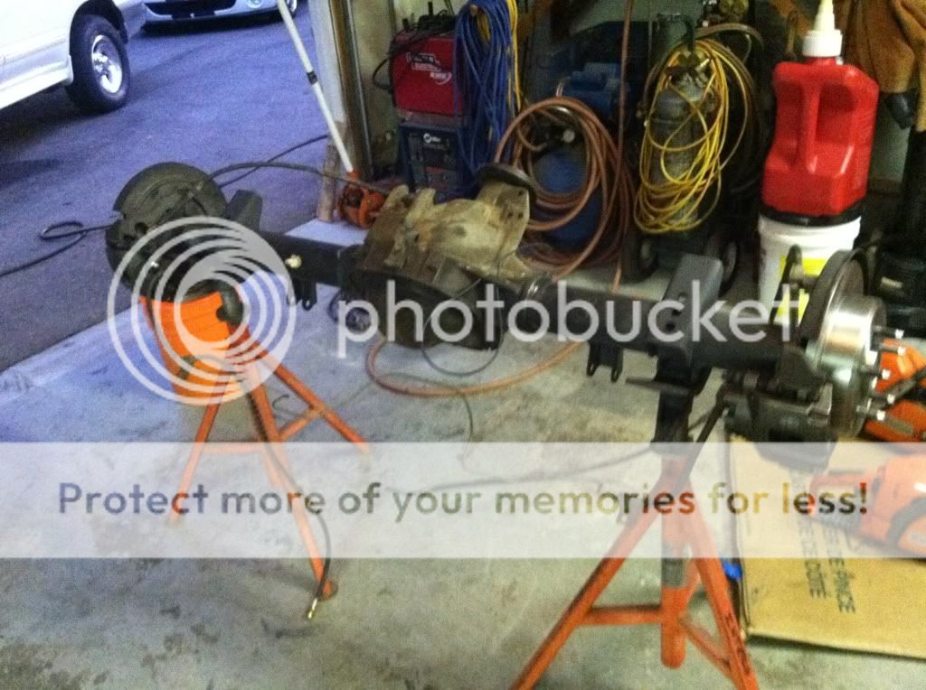

Axle all painted up.

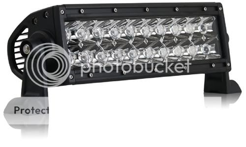

Looking at the D2 2600 lumen LED (a pair of course, so 5200 lumens) or a single E-series 10" 3950 Lumen bar.

Either setup will be right around $400
