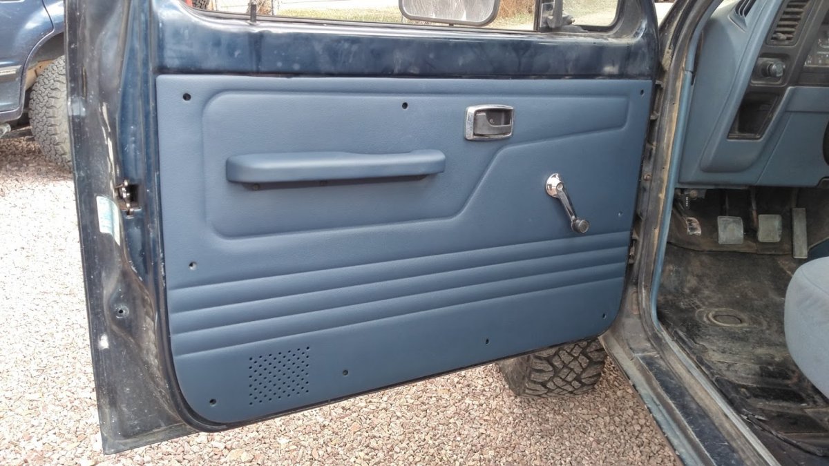

I've seen these before and have been curious about them. Can you show us a complete picture of them installed?
Sure, I'll snap some pics.
They are quite a bit different than the OEM door panels - the main piece is solid plastic and the armrest/door pull appears to be foam covered with vinyl and is screwed to the door panel itself rather than the door as they were from the factory. However you do use the factory armwrest screw mounts for attaching the door panel. They also mount to the door differently - the factory door panels use those slide in trim clips on the back side, these have holes around the edge and come with flat, textured trim clips that go all the way through. So you do see the fasteners but I don't mind. OEM door panels were always peeling up around the edges and look like crap, especially the fancy fabric and carpet covered ones.

I haven't installed the fasteners yet, just a test run... I am waiting to install them until I have time to redo the plastic seal behind the door panel and fill in some mirror holes on the outside of the door which requires some welding. The heads of the trim clips are painted so I imagine they're a one time use item. Hate to have to remove them if I don't have to.
