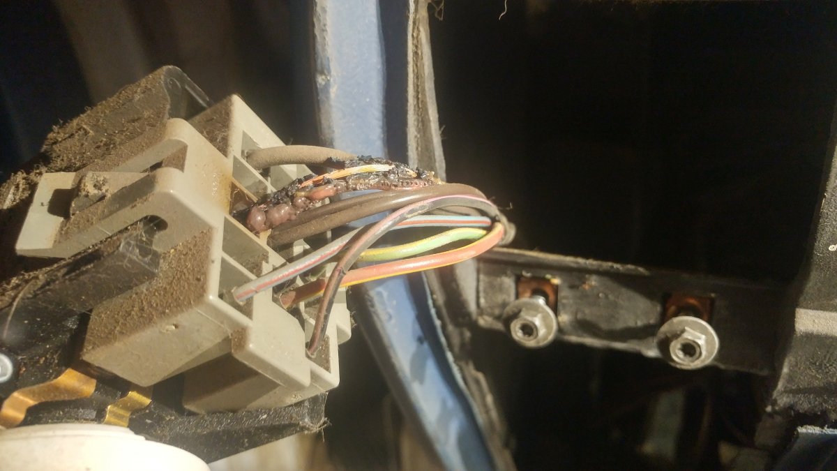

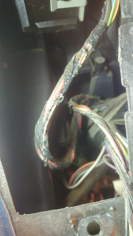

1993 ranger. When the headlights are on the magic smoke escapes from under the dash. I pulled the headlight switch and its obvious which wire it is...but I cannot see a color anymore. I do have a parts ranger of the same year but havnt torn into it yet. Here is a couple pics. Can someone tell me where I should look for a short if there is a common problem area? Or do I just unwrap and replace? It looks to be really tight under there. Is it possible to unplug just the loom I need to replace or is that a pipe dream?

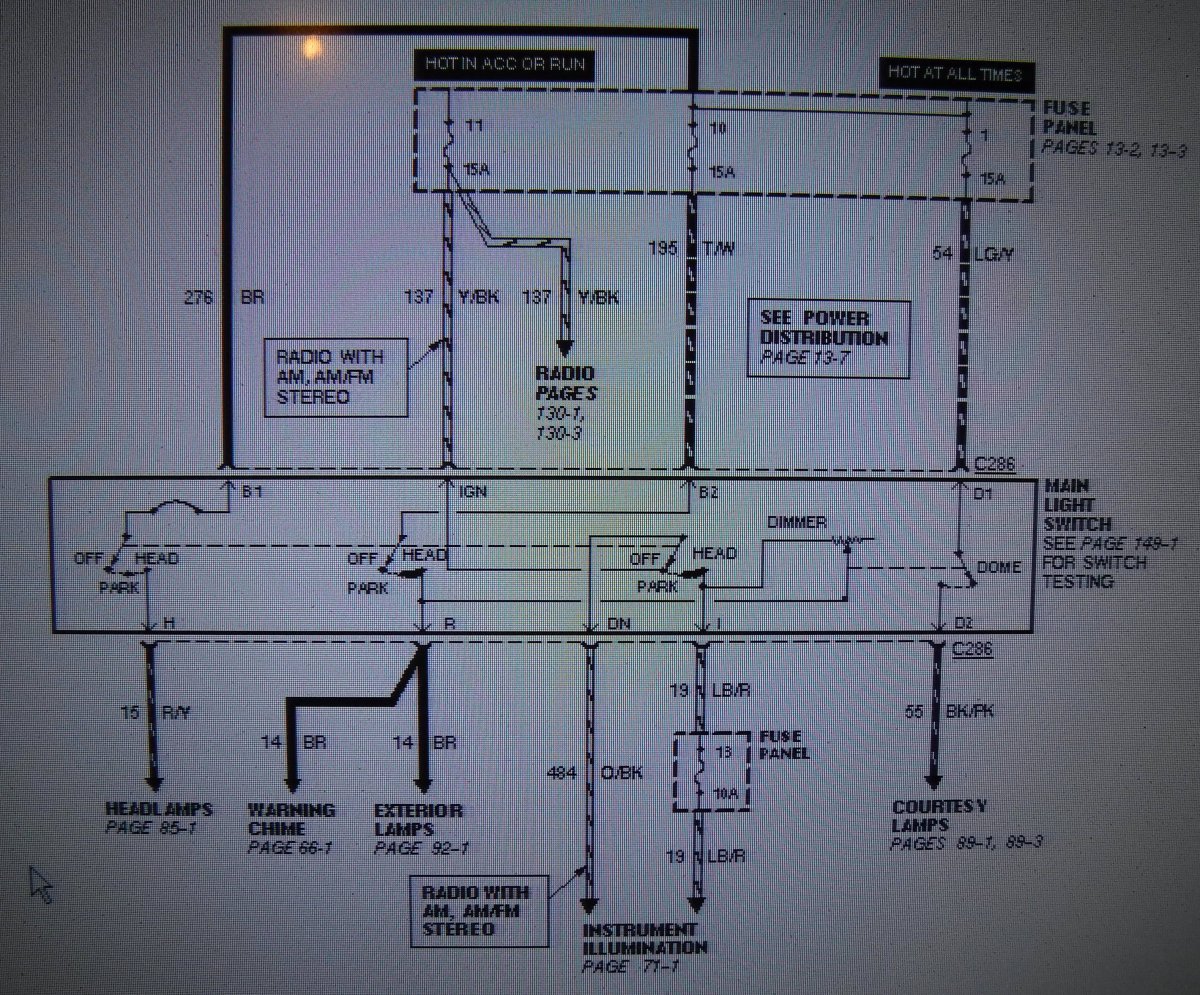

The larger brown wire should come from the engine fuse box, 40amp fuse, #2 maybe
Tan/white stripe is parking light power from fuse #10 15amp, cab fuse box, its also brake light fuse
It should also have a Red wire with it, to ABS
Looks like these are the shorted wires
Two smaller brown wires are OUT to Parking lights
Blue/red stripe is dash lights
Not sure on the Green/yellow and Black/red?
There is no ground wire in that harness as far as I know
This might be the one yall are talking about. I haven't really used that CD much for electrical. It covers 93-94 Fords
35170
The failure is probably in the switch, and not in the harness, and also not a short.
Those switches were pretty robust, but the contacts would carbon up and cause high resistance inside the switch which will burn the feed wire. This is one of the reasons for switching the headlight system to relays instead of having them controlled directly by the switch.

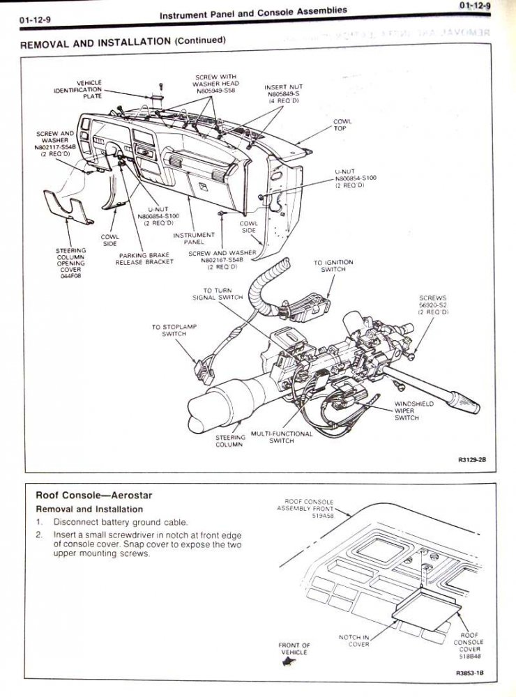

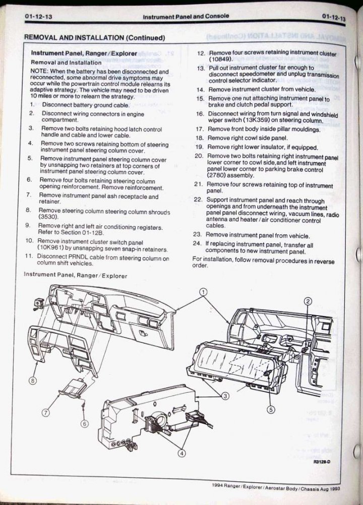

I'm trying to remove the dash from my parts truck so I can see how easy getting at the wiring will be. I have the passenger side loose. the instrement cluster is loose but I cant get my hands in to remove the speedo cable...FML. the hvac controls are loose too. Where the **** is the screw that's holding it in place? It seems to be somewhere in the area of the fuse block but I don't see anything....
Maybe this can help? (perhaps step 15 or 20?)
Thanks....but I did it the hard way. I didn't take the wiring with the dash, I left the wiring while taking out the dash. It will be easier next time now that I see your pics.

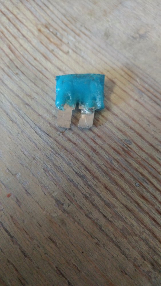

Pic of the fuse that didn't work;
:oops:
Was that a Harbor Freight fuse by chance (if you know)?
I've had a couple HF fuses mess up in different ways. I don't trust them anymore.
