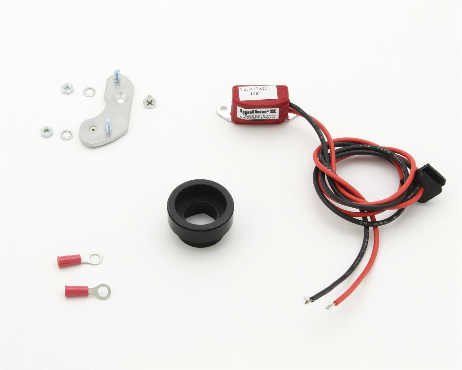

Have you looked into a Pertronix points eliminator module?
I have not, but I would love to know where to get them!
I think if you have a Capri/Mustang II points distributor made by Bosch, this is the kit you need:
My buddy had a Pertronix module in his 302 and it worked great. The only bummer about them is the funky spark plug wire style which can be harder to find locally.
I do have the Bosch distributor. I have placed an order for a dui distributor from performance distributors. This is cheaper so I may order this and cancel my order. So, I would only replace points for the pertronix and keep everything else the same?
That's correct, drop the Pertronix module in and go.
I would not expect to see the DUI distributor anytime soon. From my understanding they are remanufactured ones that come from junkyards or core returns from parts stores...and if they're not getting any cores... they have nothing to rebuild and send out. Sad state of affairs in the 2.8 world. Even if you could round one up, you would then need the Duraspark module and harness for it. Easier to just run what ya got.
