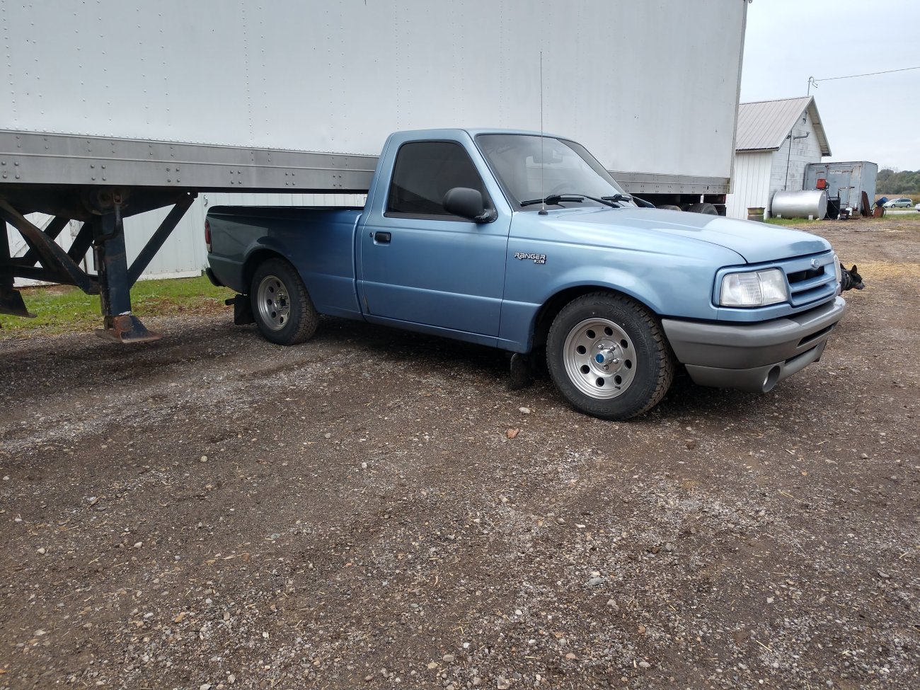

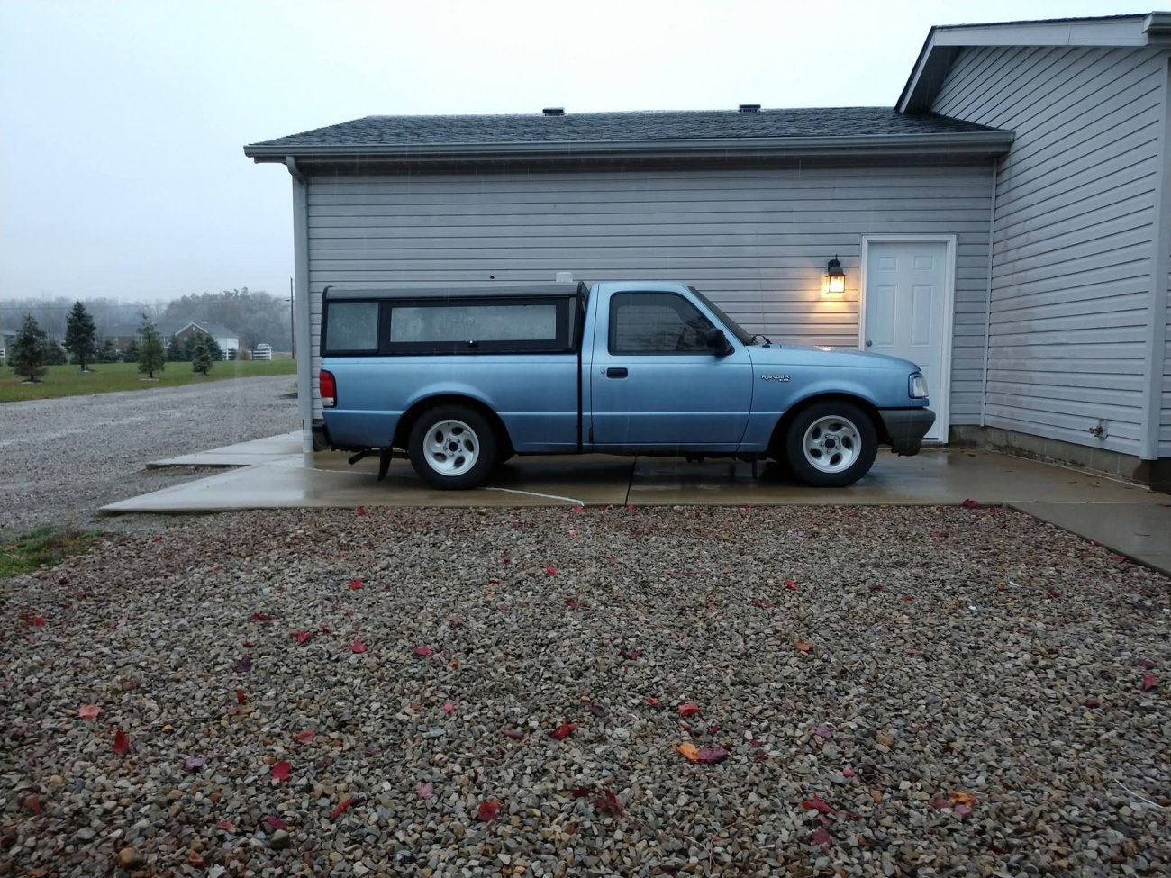

Built this truck during my unintended hiatus from TRS.
Going to rewind a bit and make a thread to document what is already done and continue with future updates.

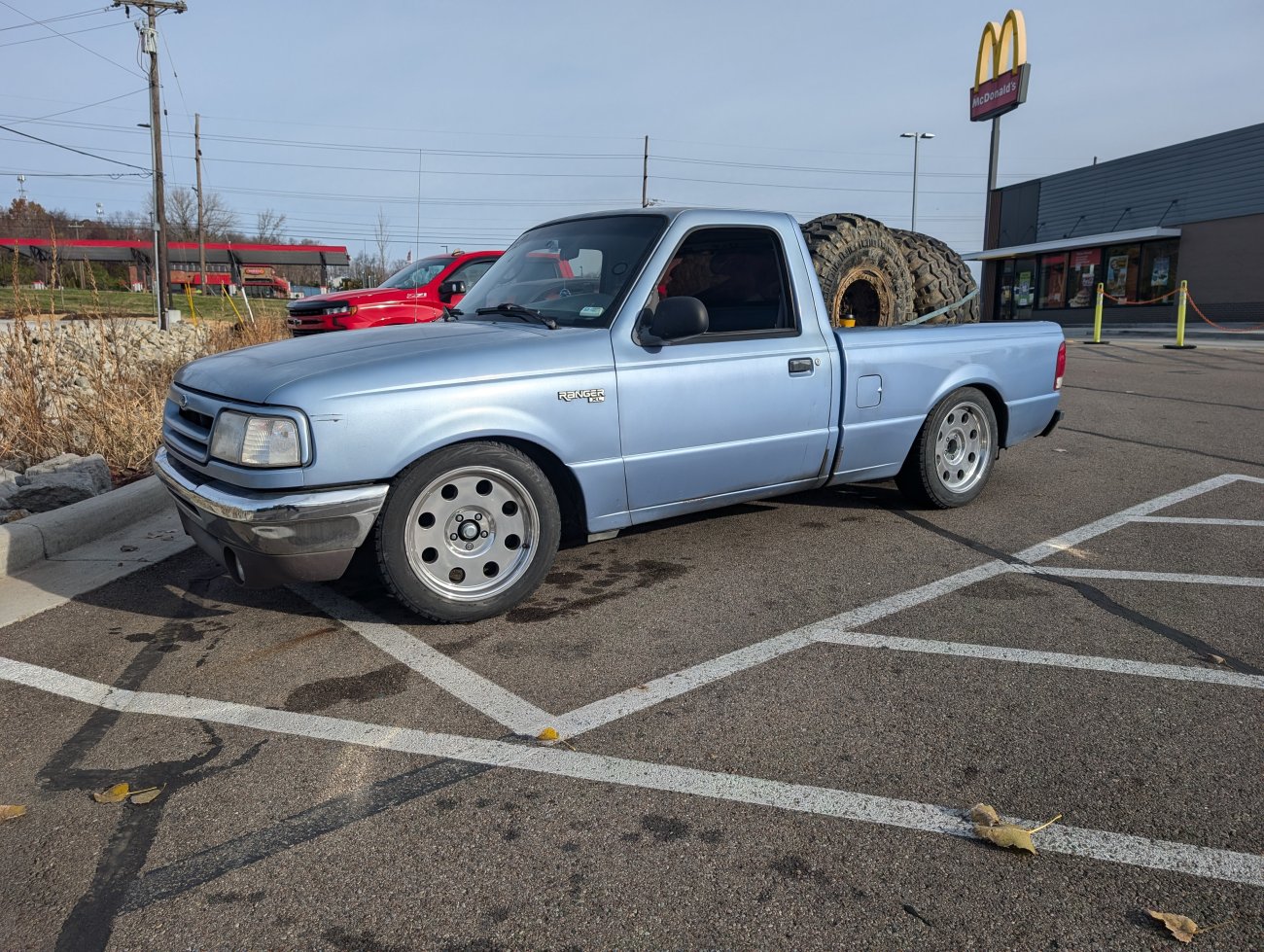

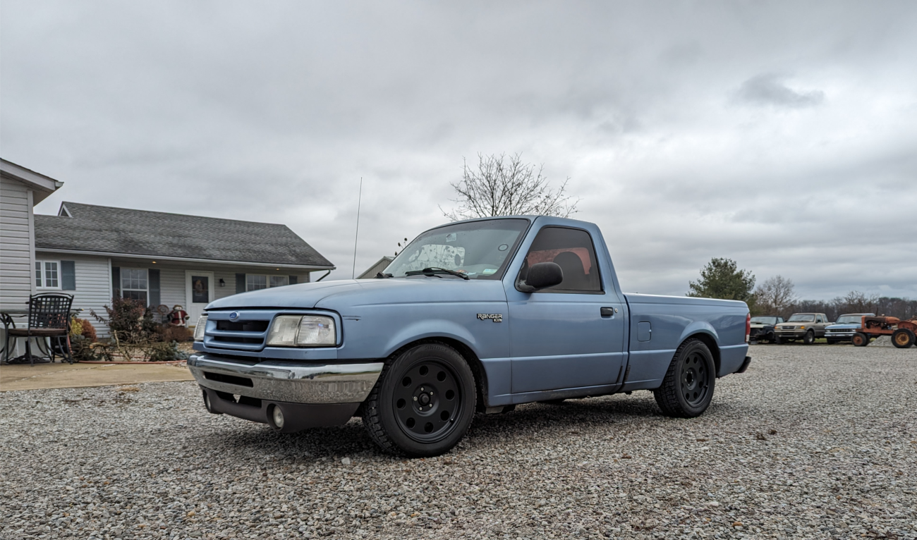

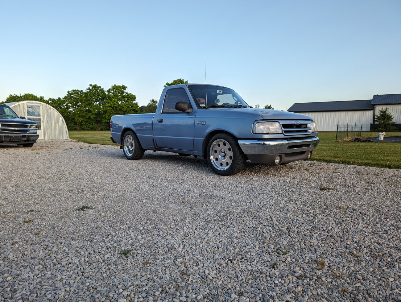

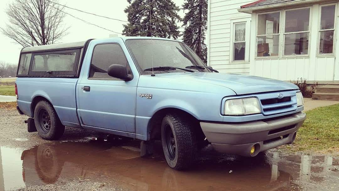

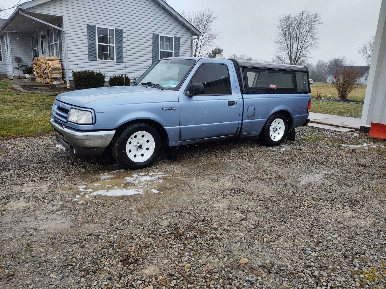

Quick snap shot:

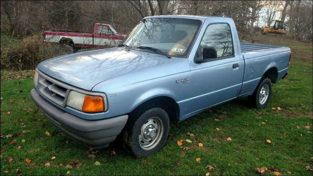

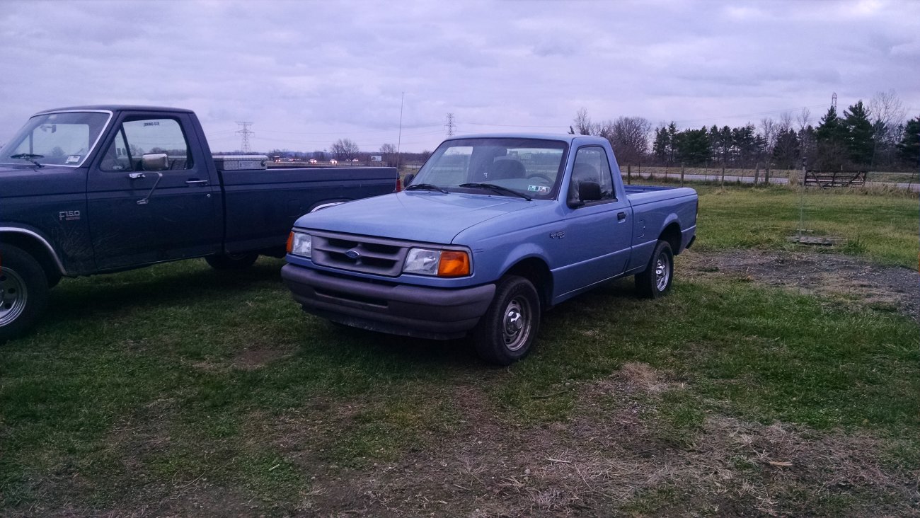

Bought the truck from a good friend that was selling it as quick flip back in 2013ish (peep the F150 in the background that "Lightning" axle under my trail rig came from)
After a dozen wheel/tire combos and adding 4 cylinders under the hood this is how it currently sits
I was working on the truck last night and got to thinking this truck deserves its own thread. I have put over 140k miles on this truck personally and its been on of the most reliable vehicles I have ever owned. I will continue adding / updating these first couple posts as I sift through years of repairs and upgrades.

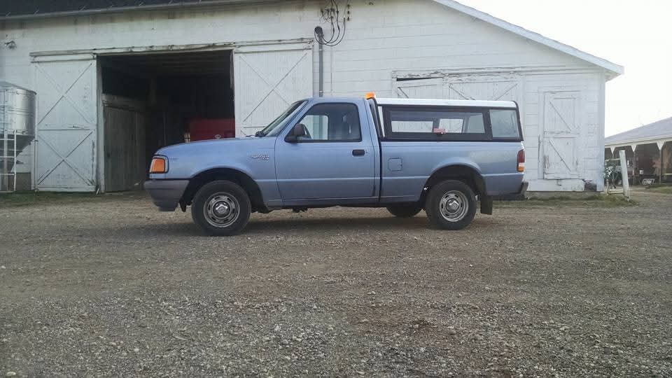

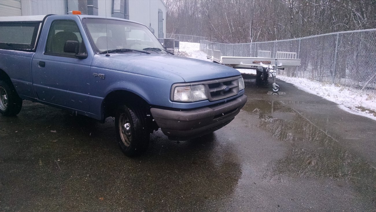

Picked up the truck with 200K on the odometer, but story was that my buddy bought truck as is with the head laying in the bed and the engine all rusted up from sitting for years after a head geasket replacement job was abandoned halfway through. He threw in a fresh-ish 2.3 with right at 100K miles on it from a rolled truck he bought on copart. He had plans to daily the truck for a bit and then build a budget drag truck out of it down the road.....but he is 6'6" or better and gave up on that during the 10 min drive to the BMV. lol He owned it long enough for his wife to name it "Perry" though..and that is its name to this day.

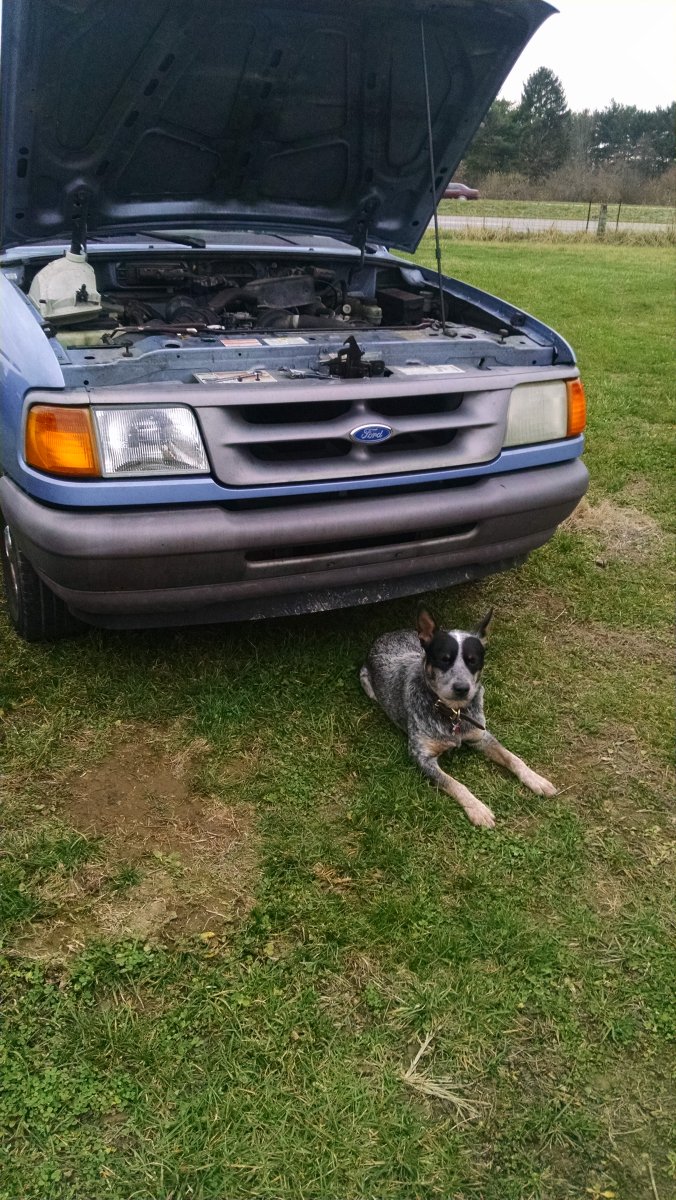

I was in need of a new DD because the CRX I had been driving was using more oil than a 2 stroke dirtbike, so we made a deal.
I drug it home and started going through it little by little as I drove it.

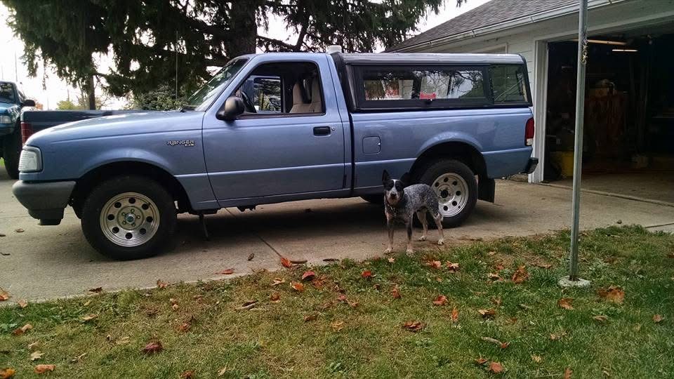

Obligatory Dingo photobomb

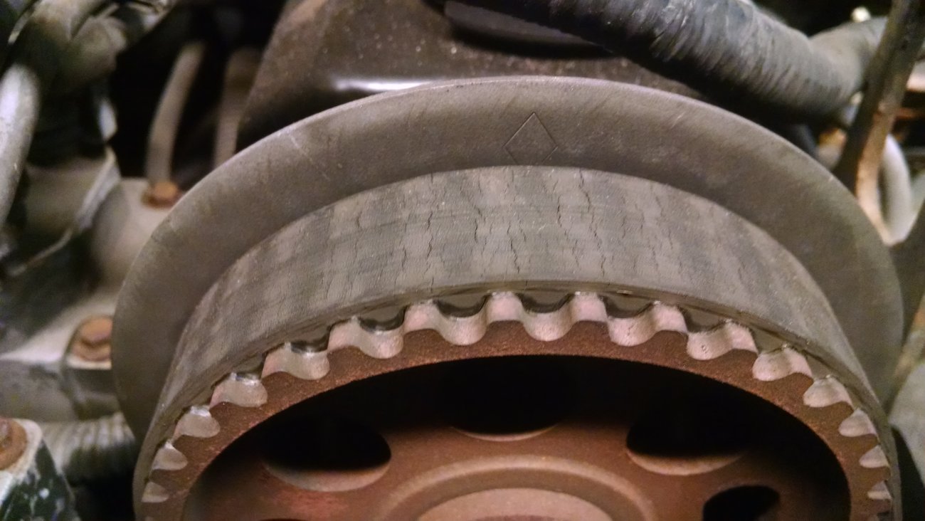

First I put fresh plugs, wires, and a timing belt on it.

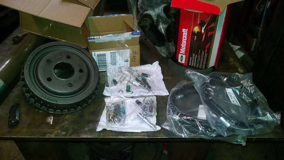

Fresh rear brakes and cables (I need to do them again soon)

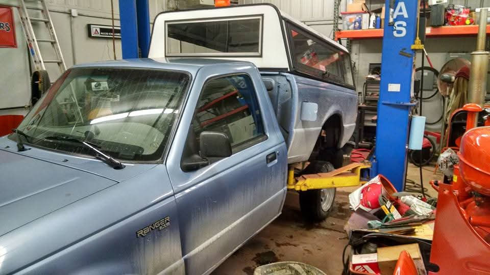

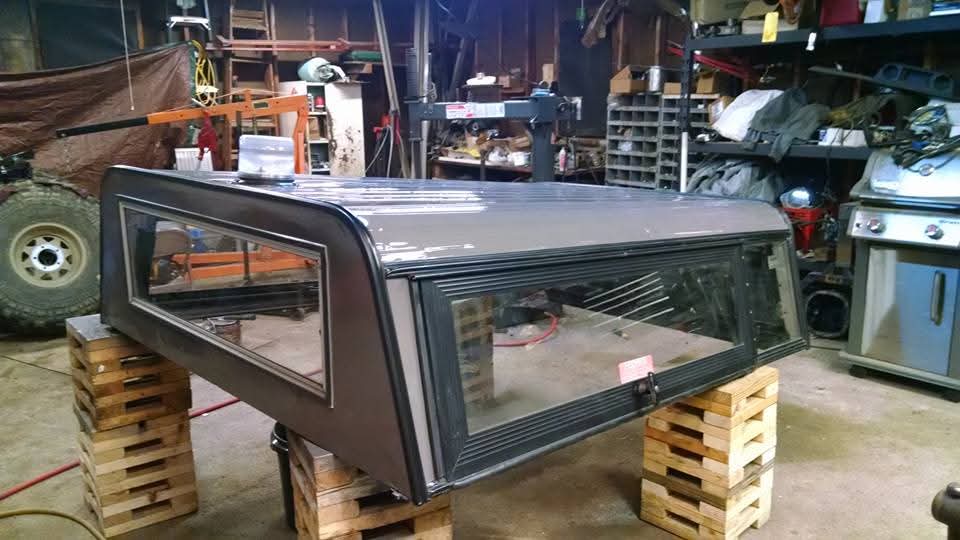

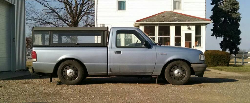

I snagged a cap from a local used car lot that was flipping a truck previously used as an underground utilitly survey truck

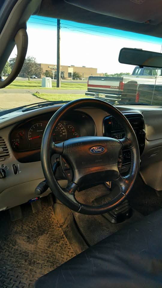

I also added factory cruise (Kind of a PITA for an XL 2wd it truns out due to no factory wiring provisions existing in the harness for it)…also swapped in a minty junkyard special leather steering wheel from an Explorer.
Also added bluetooth to a factory non casette/CD radio and converted all the backlighting to green. I put a tach cluster in around this time (subtle change is the orange FX4 needles on the black cluster)

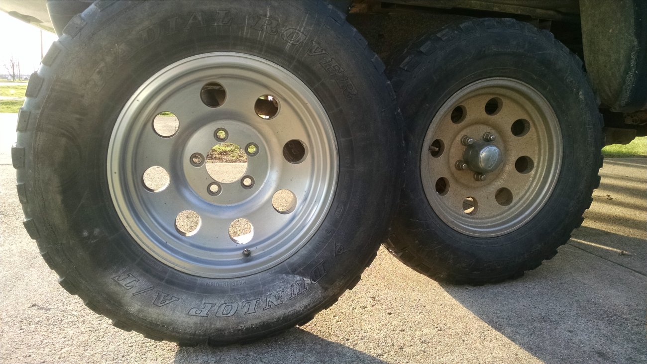

When winter rolled around it was time for snow tires. I still had a pair of WinterForce tires from the CRX that I stretched onto some freebie 14x7s

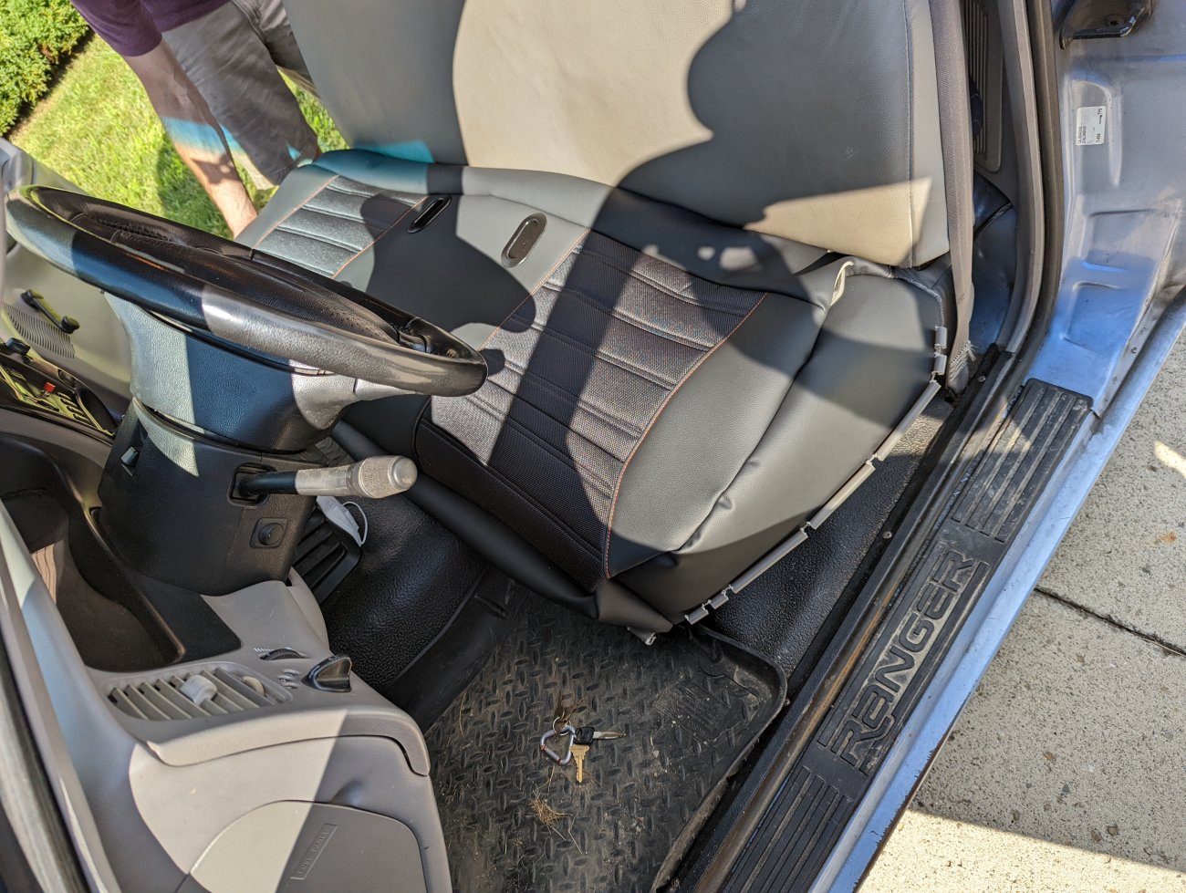

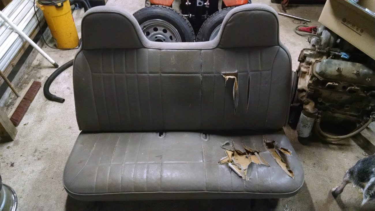

I ditched the explorer buckets my buddy threw in (power seats with out power hooked up) for an XL bench that Lee recovered on the cheap for me.
Ft: Dings as a pupper (Man.....Digging through old photos brings back some memories)
This seat actually cam out of my black SAS truck years before I ended up with the truck....
Dingo probably spent over 75K miles riding shotgun in this truck

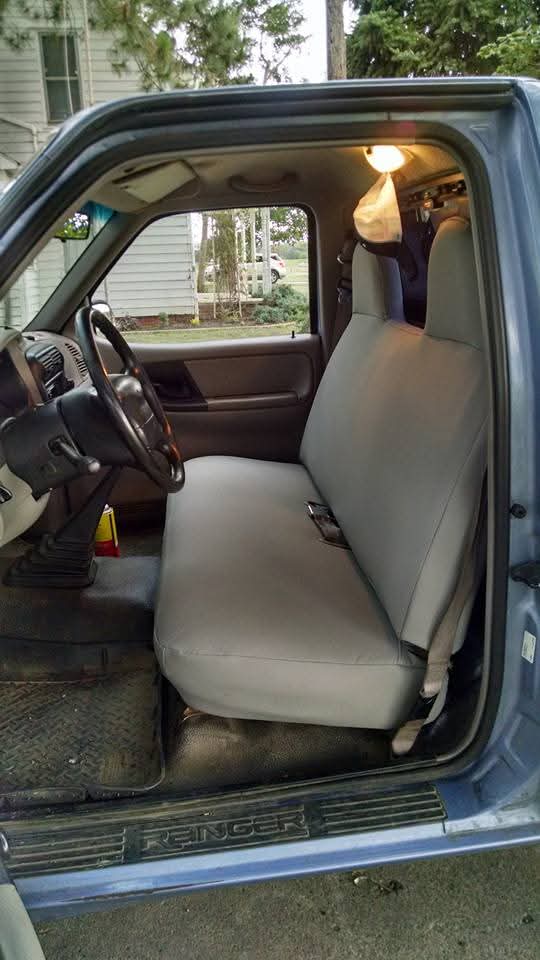

My brother later reupholstered a different low back bench for this truck and the the gray seat went back to the black truck lol

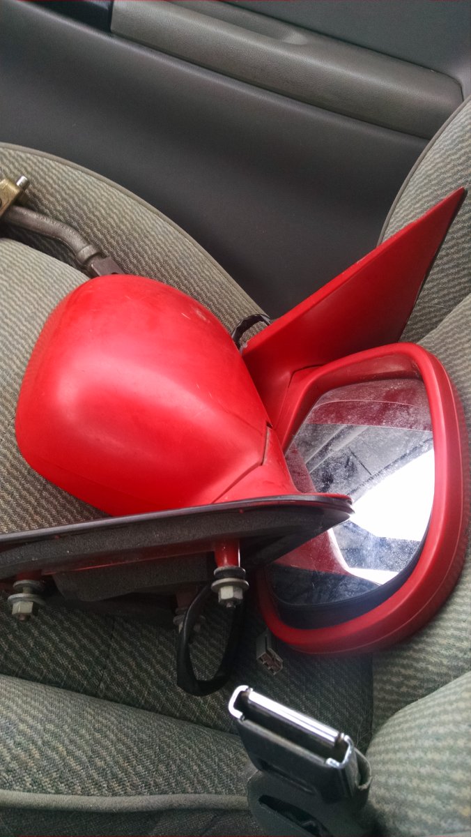

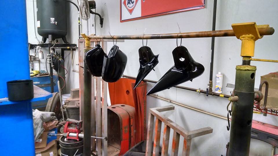

I snagged to 93-94 Splash mirrors and soaked them in satin black

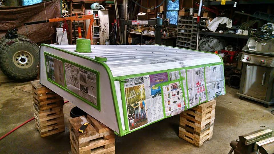

At some point over the years I painted the cap gray (same paint was used to repaint the bumpers too)

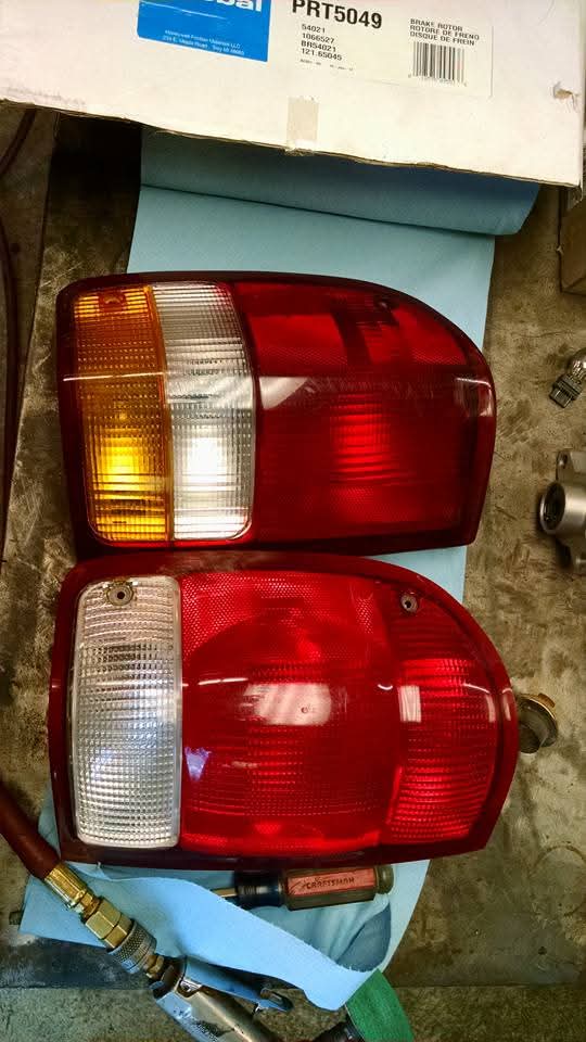

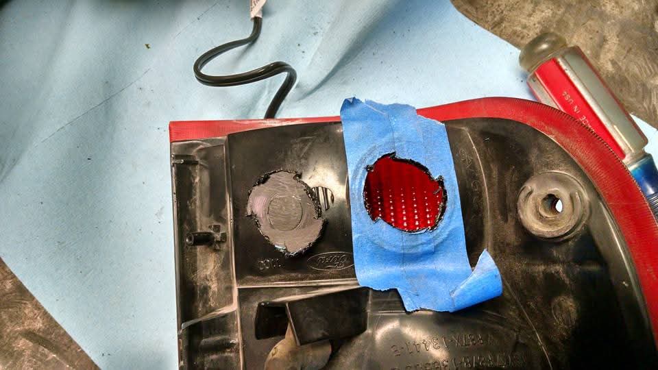

Also went to 99-00 tails. I cut out the turn signal socket to run the extra bulb rather the rewire with a trailer plug like i did on my offroad truck

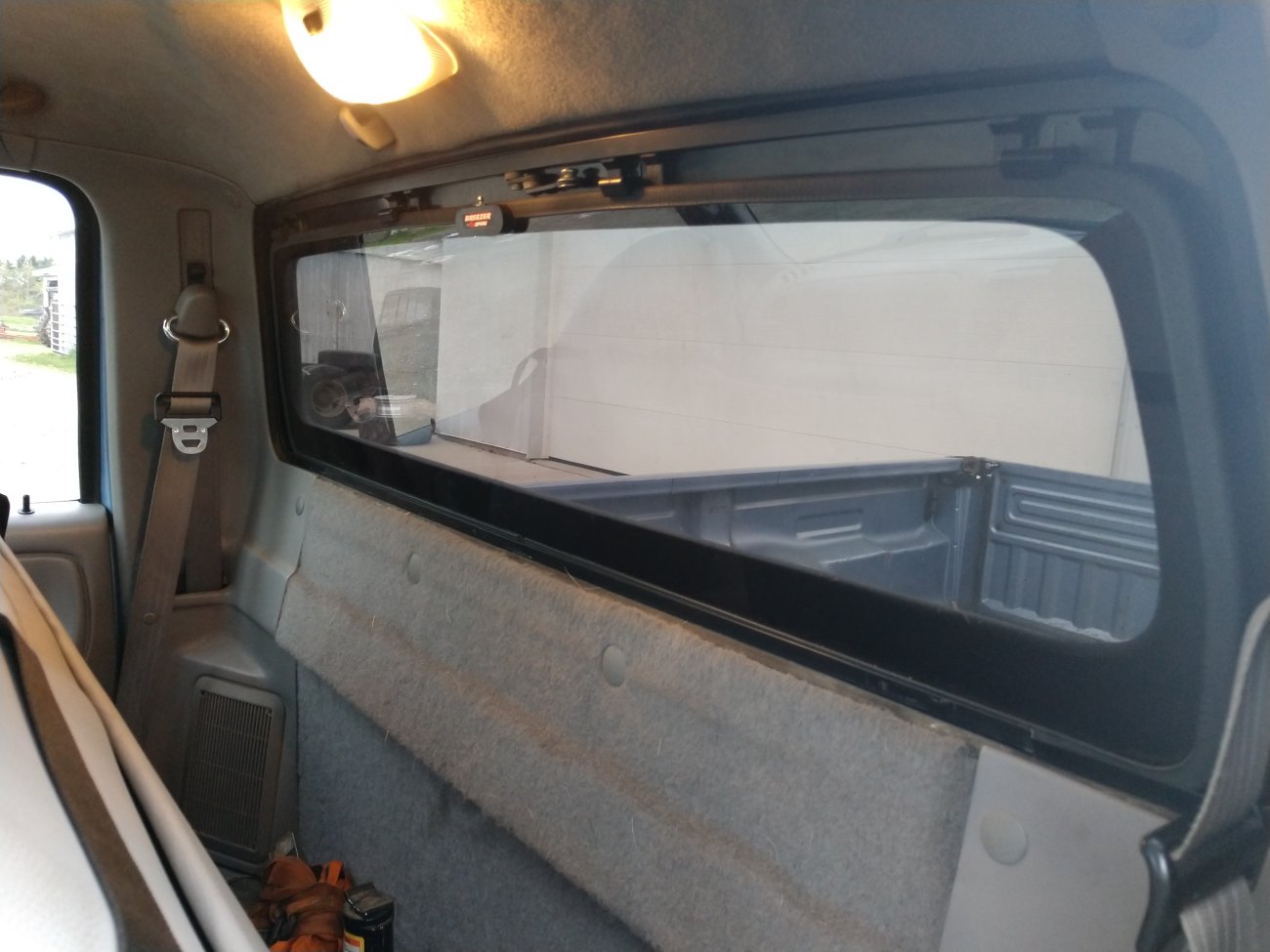

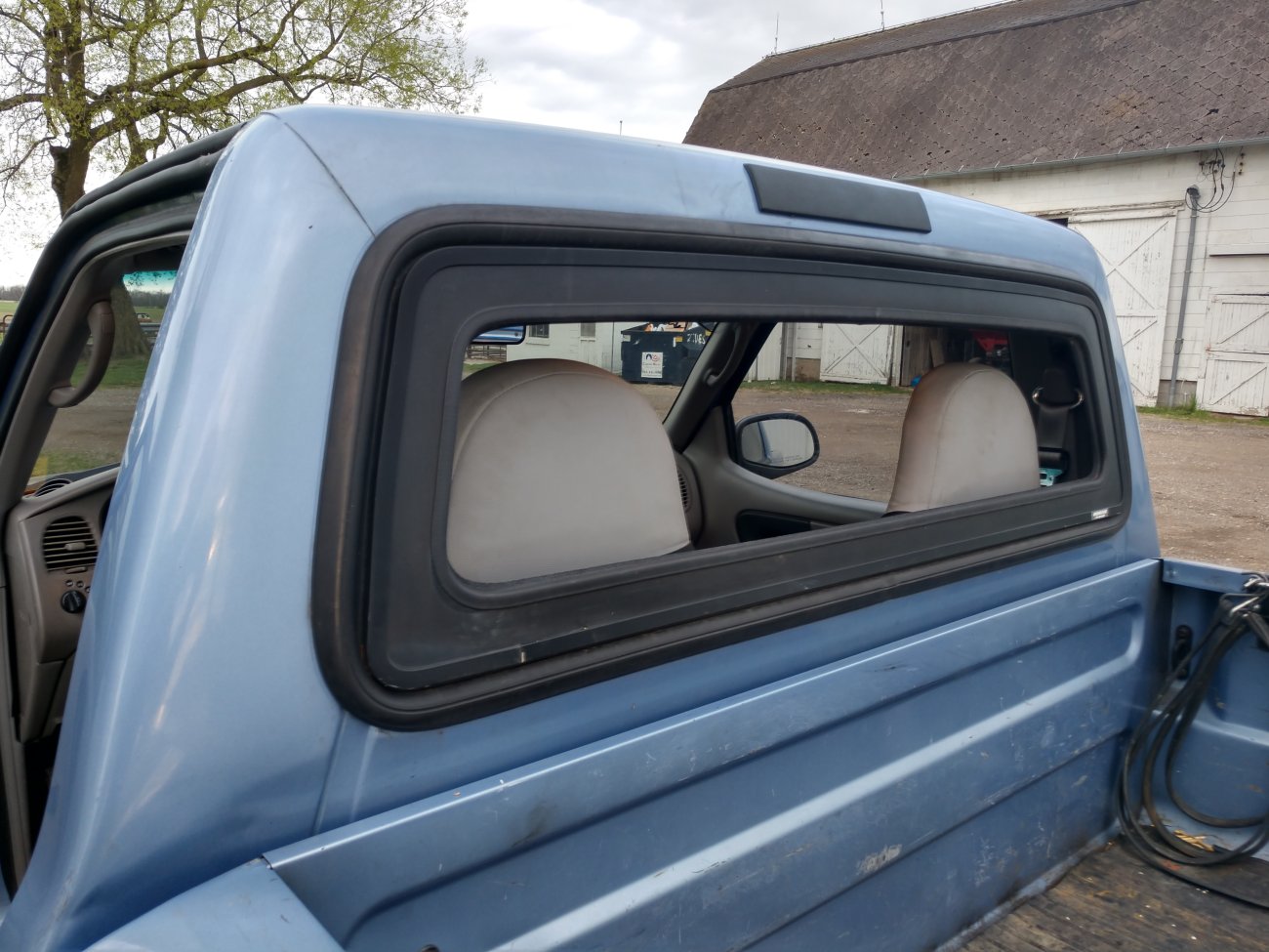

Good friend of mine snagged this rare Breezer window for his SuperCab show truck (never seen another). He found out the hard way that 83-97 reg cab windows are different…so I ended up putting it in Perry

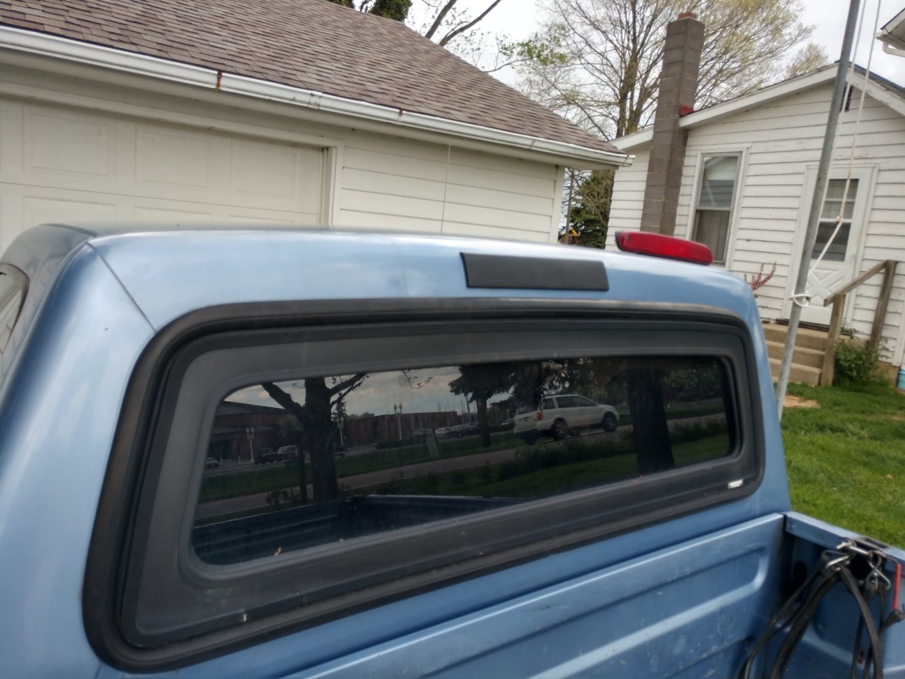

I also rocked a Super Duty third brake light delete for bit (made sense with the cap on 90% of the time)

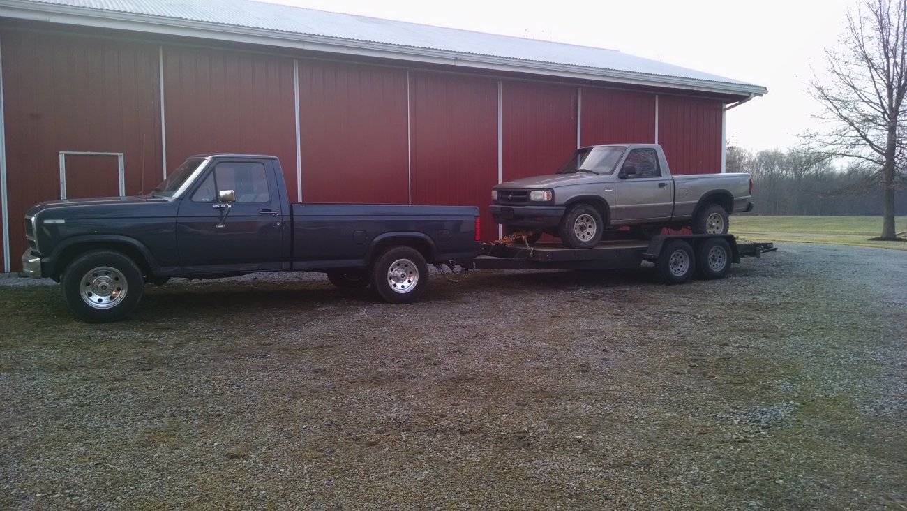

About the same time I aquired a Mazda (later known as "The Mazda") that was abandoned on a buddy's jobsite for a few years and had no title. It became a beater trail rig and eventually donated many parts to my future trucks and many others across the nation. Most importantly were the 15x7 Eagle Alloys that I polished up and swapped onto Perry.

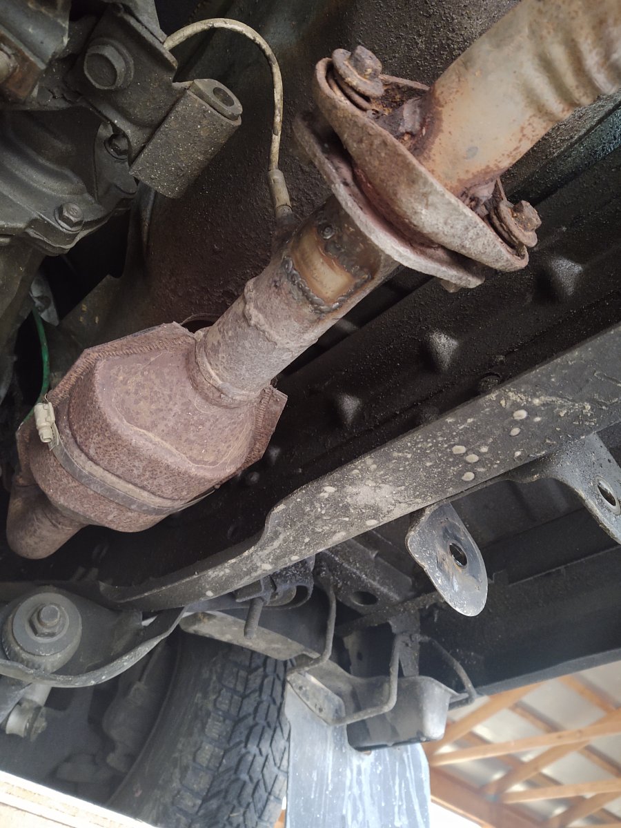

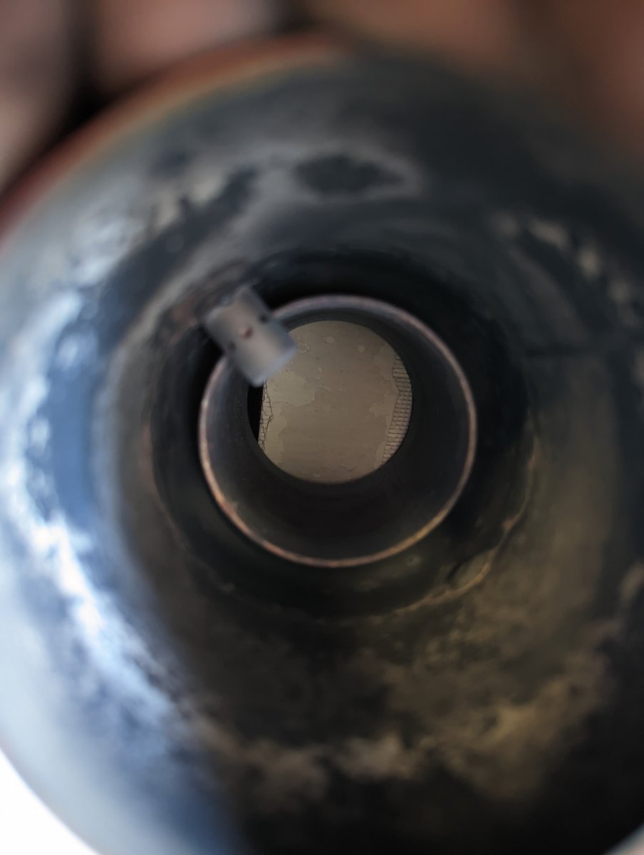

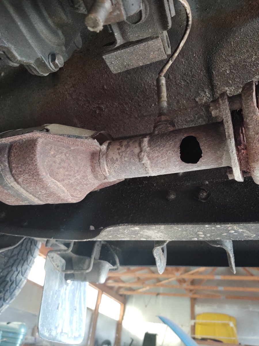

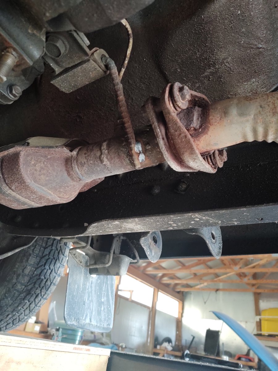

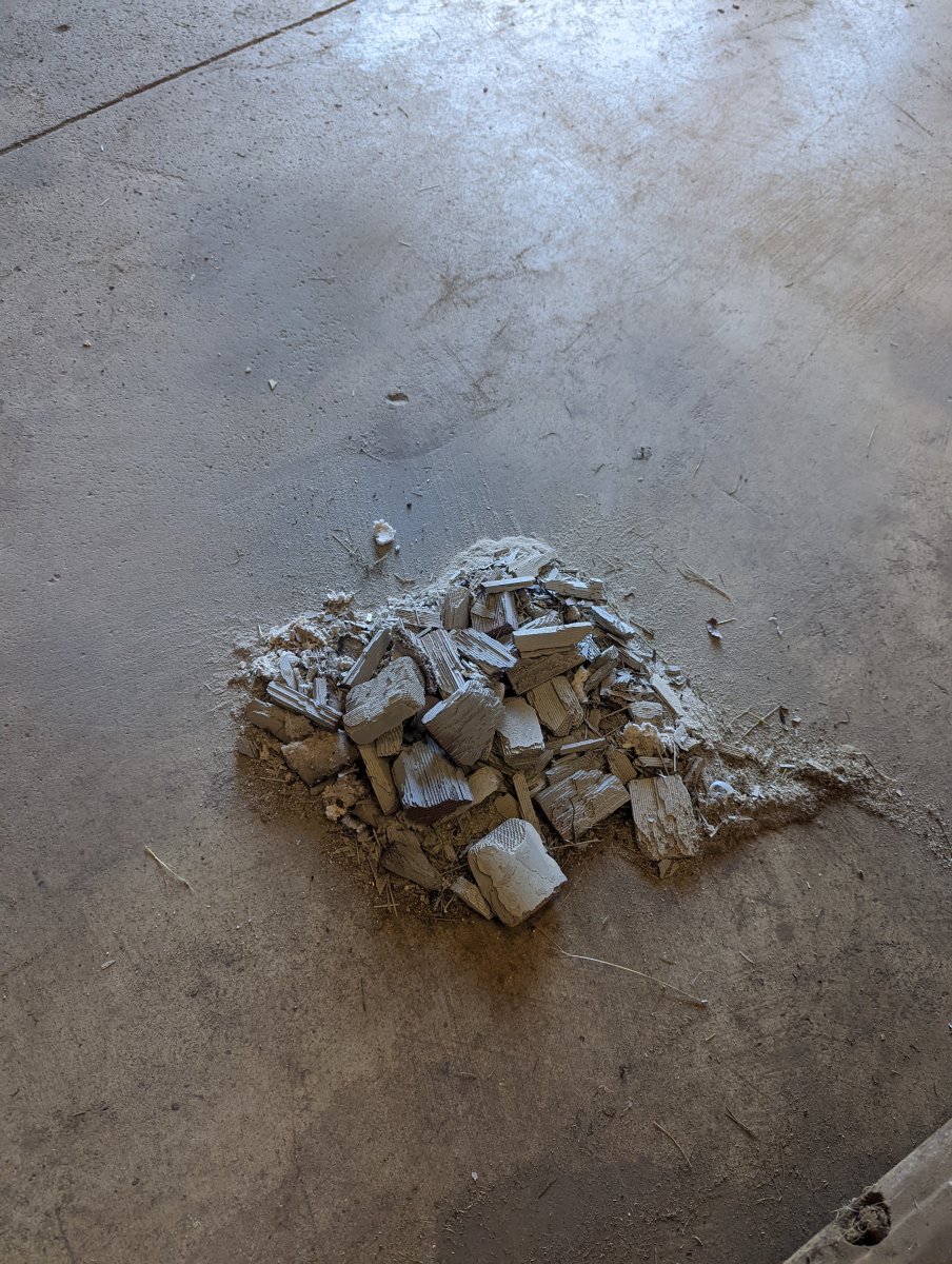

Cat fell apart and clogged the exhaust
So it got deleted on
Cheapo tail pipes only lasted a winter or two, so it got a turn down boogered on for bit
and rebar hanger when the side of the cat ripped out

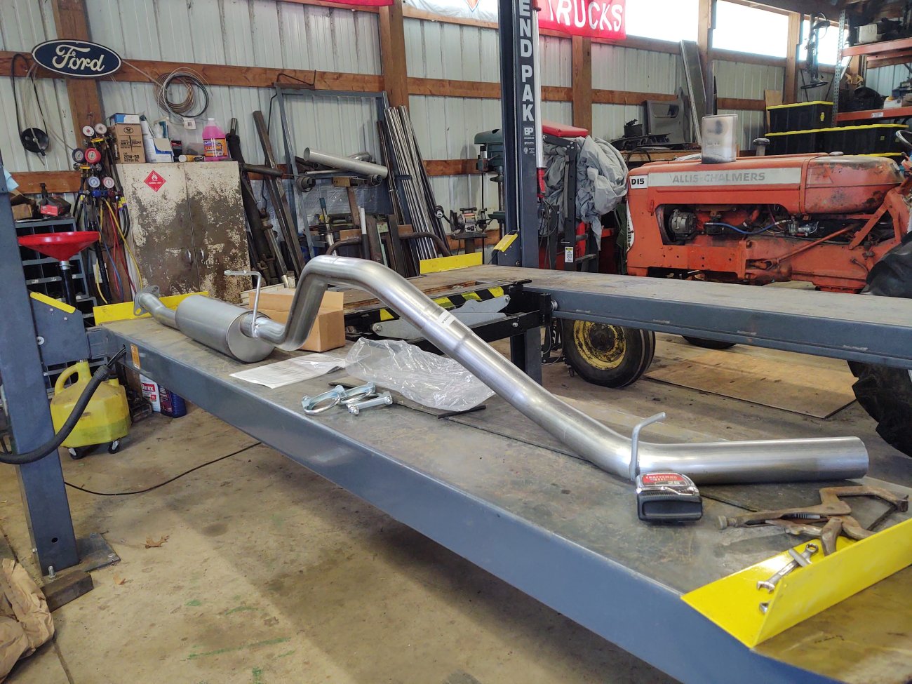

Eventually it got a cat back Gibson stainless exhuast

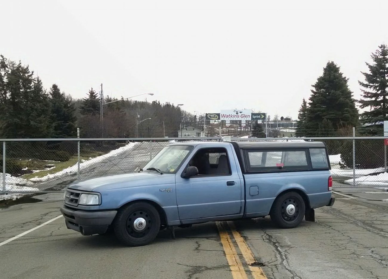

The next winter I rocked some 17" Crown Vic steelies, Ranger dog dishes, and Blizzaks (Photo at Watkins Glen Raceway during a winter trip to the Finger lakes)

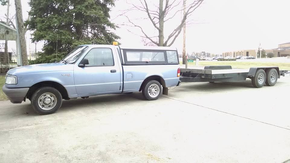

Don’t remember when but at somepoint I bumped into the hitch on a Navigator at a red light...ended up going to a smooth chrome bumper and painted to match Splash grille. Photo taken a the Longaberger HQ
Lil 2.3 powered Perry did a lot of work for a lot years for me

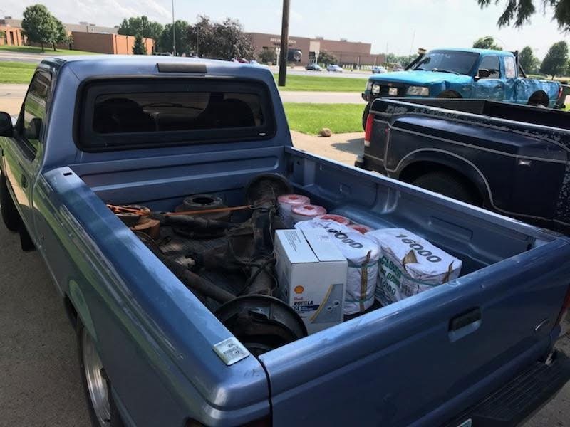

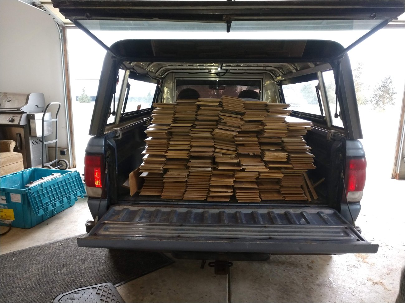

Over 2000lbs of laminate flooring....

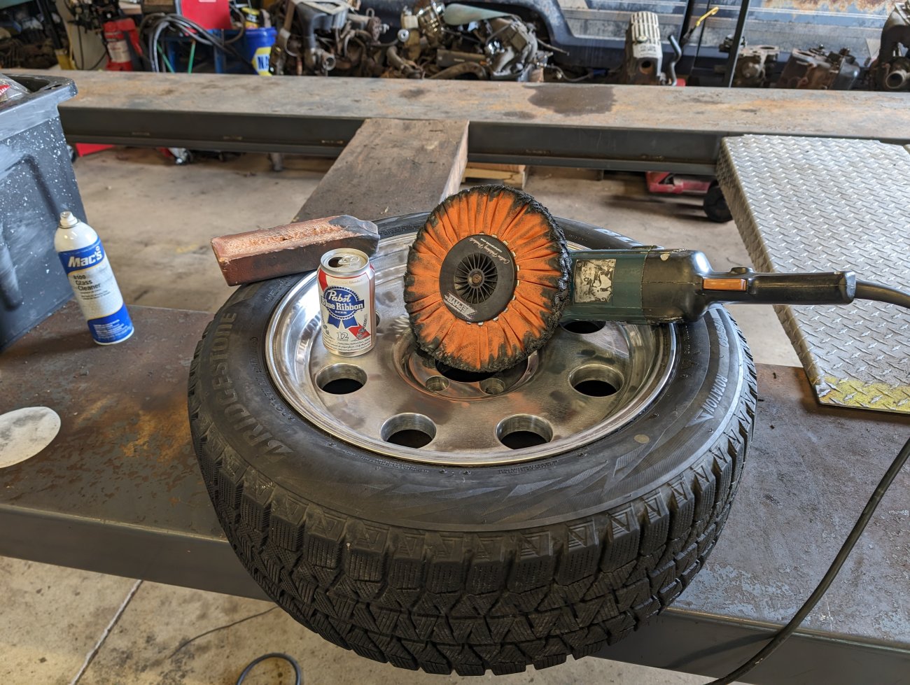

Then I snagged these discontinued 17x8 Amercian Racing wheels...I hate black wheels.
After many hours of stripping and polishing...they look half decent

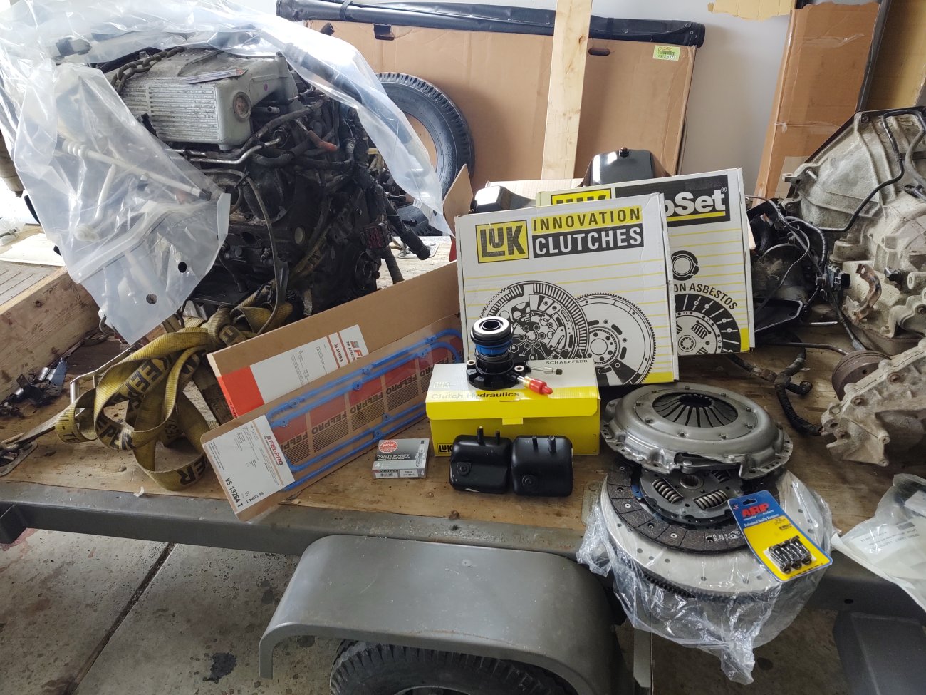

Stock piled some parts for a while

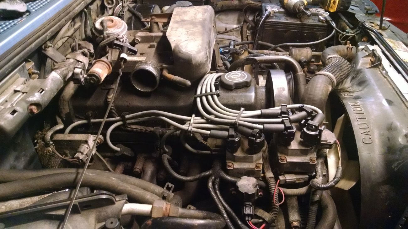

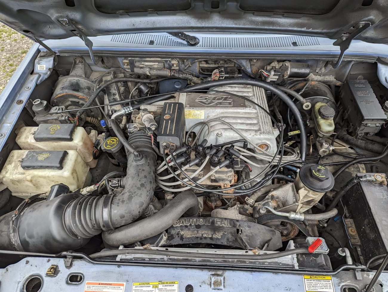

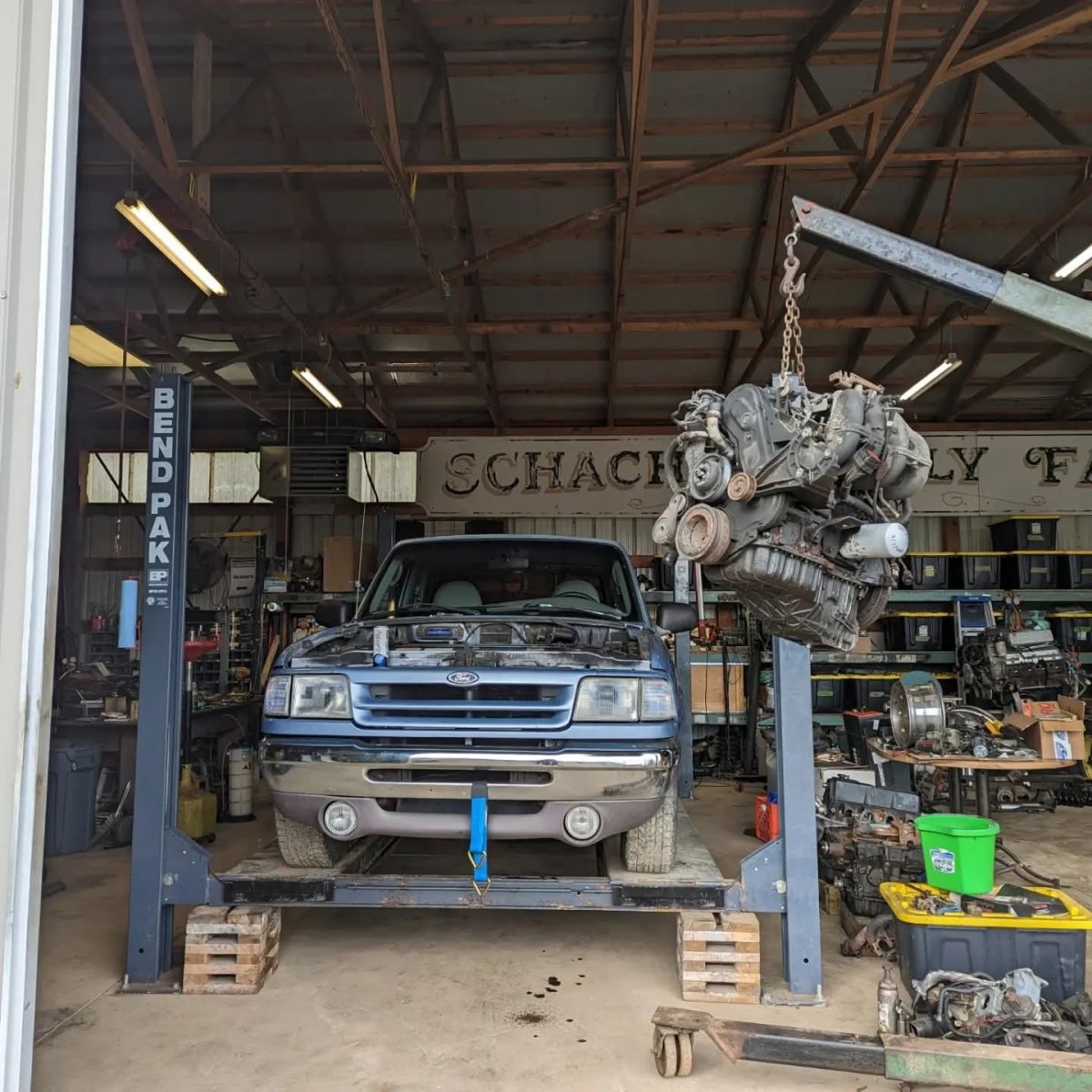

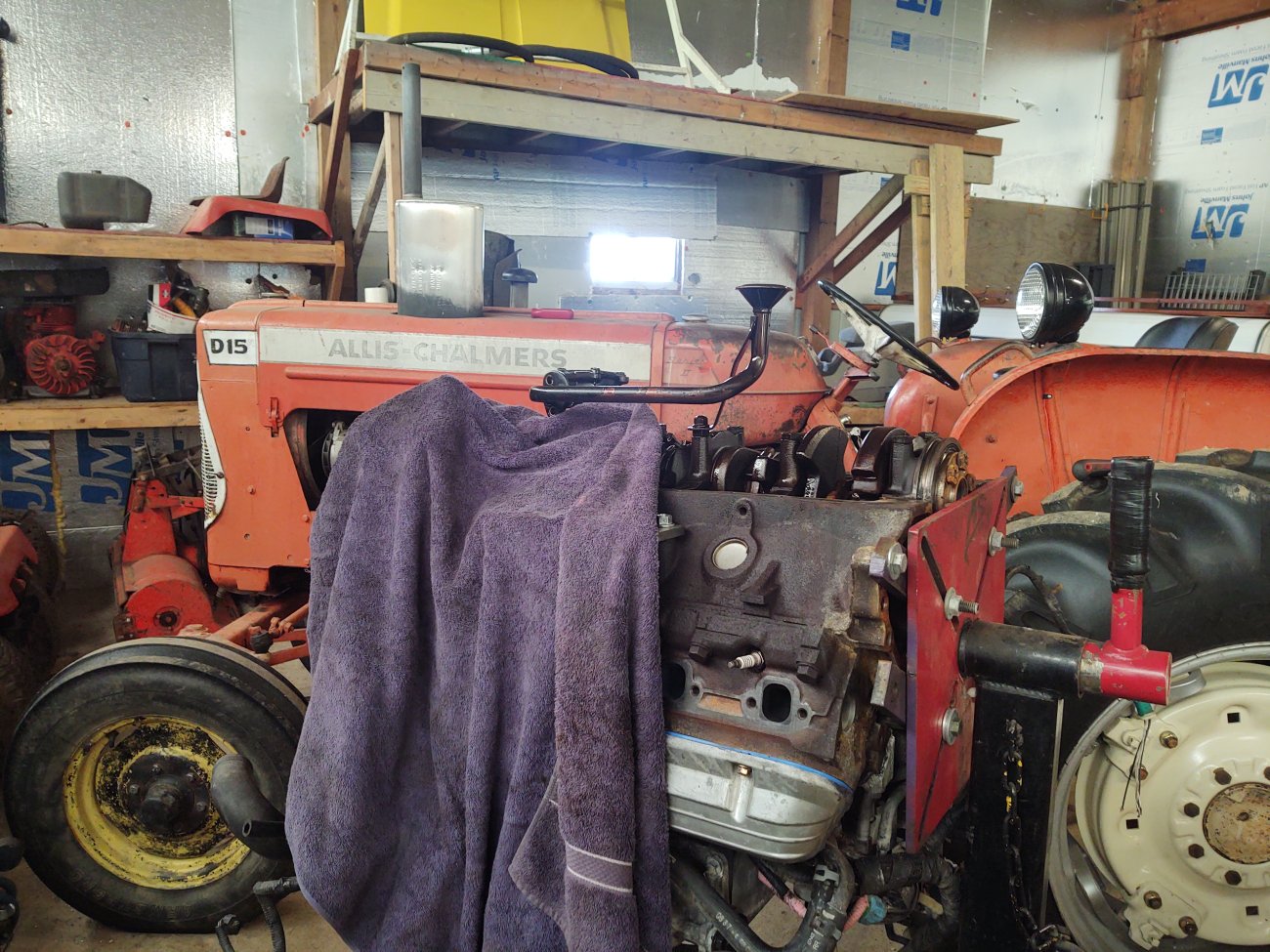

2.3 out
When i did this swap I used the 95 Explorer style intake tube and MAF housing, Ricks swap plates, a single core 95-97 Ranger 4.0 rad, 289 manifolds and a custom Y-pipe, Foxbody dual sump pan, Canton remote oil filter, and 4.2 F-150 M5OD-R2 (gears and shifter tower swapped into OBS M5OD case to get 7/16 bell housing bolts and mechanical speedo drive). I did have to make my own AC hoses because the Explorer stuff just didnt fit well/at all. I also had to swap over to 4.0 Ranger fuel lines from the filter up to mate to the 5.0 rail. (2.3 rail has the lines at the rear of the engine.)

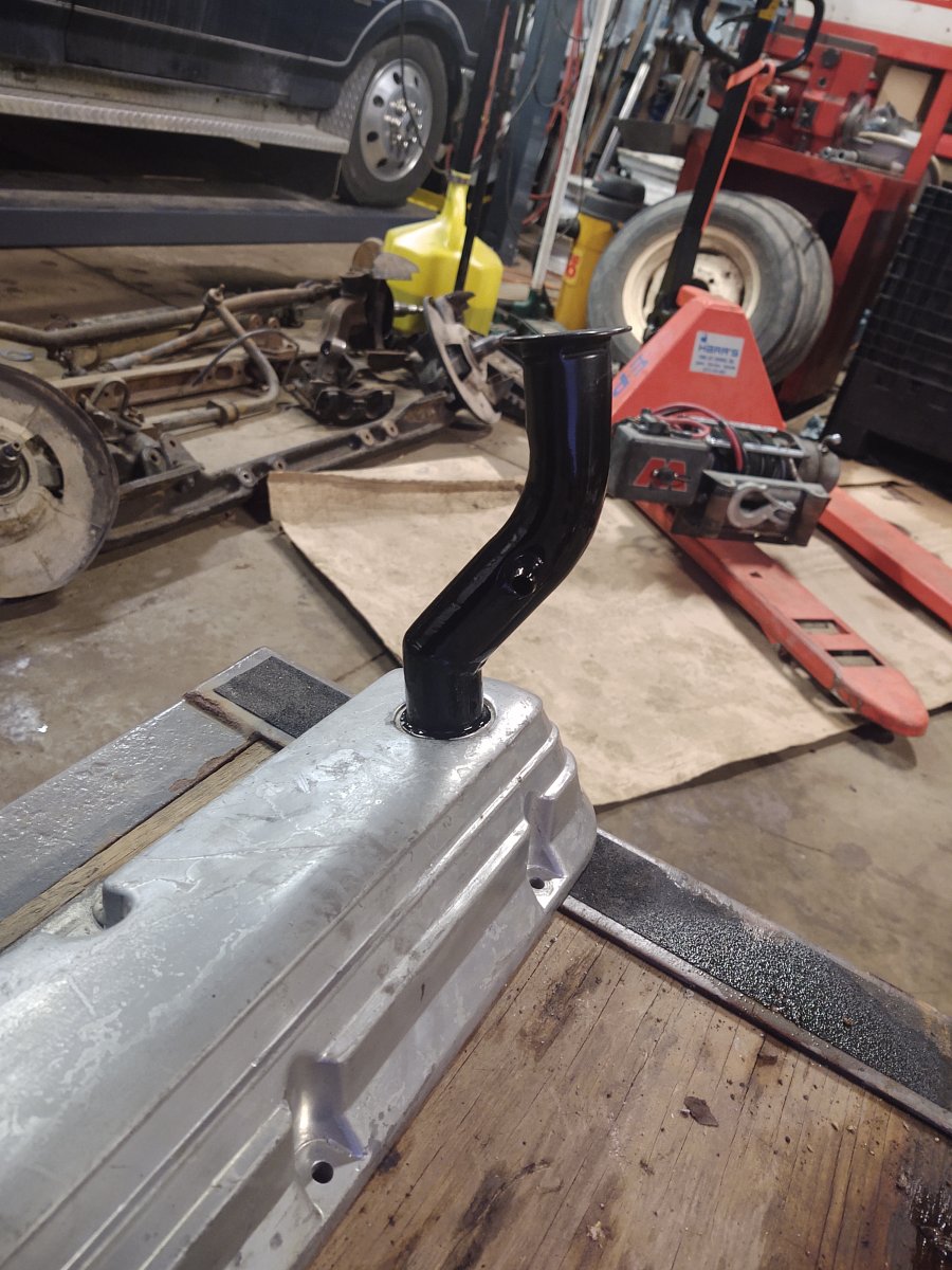

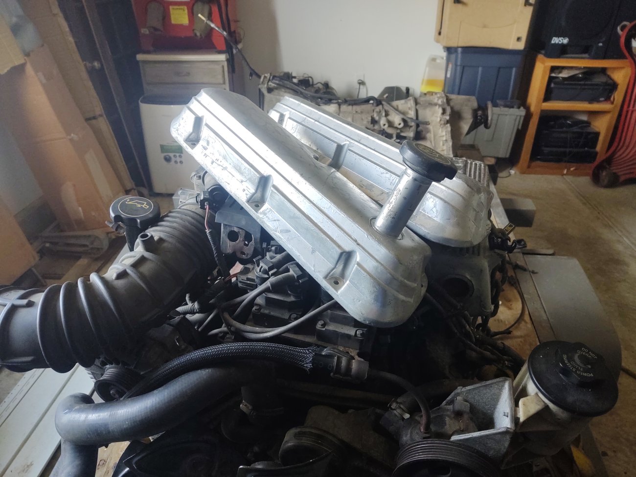

I wanted cast aluminum valve covers because i never have luck with stamped steel. I got some Mustang covers, but the oil fill was directly in the way of the intake, so I welded the explorer filler neck to the stang cover

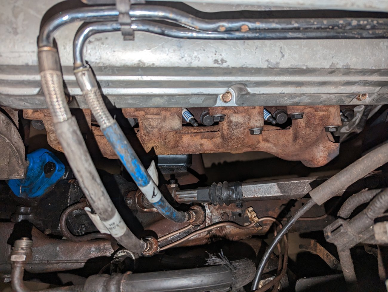

Had to weld a few nuts on a few exhaust studs

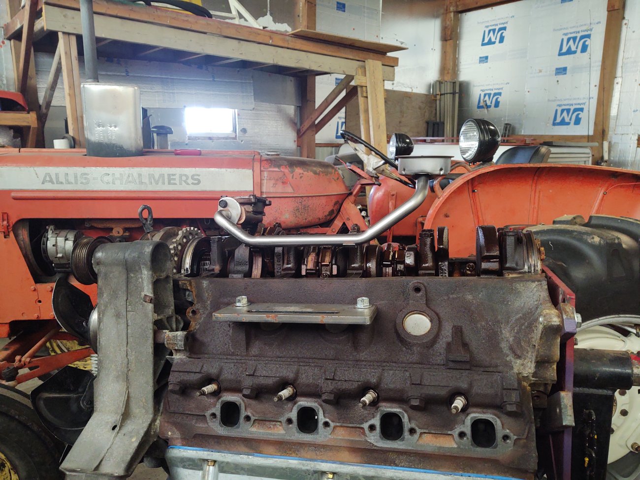

Originally had some OBX (Torque monster knock offs) to use with the GT40P heads, but the two piece driver side fit like poo and i knew would leak in no time

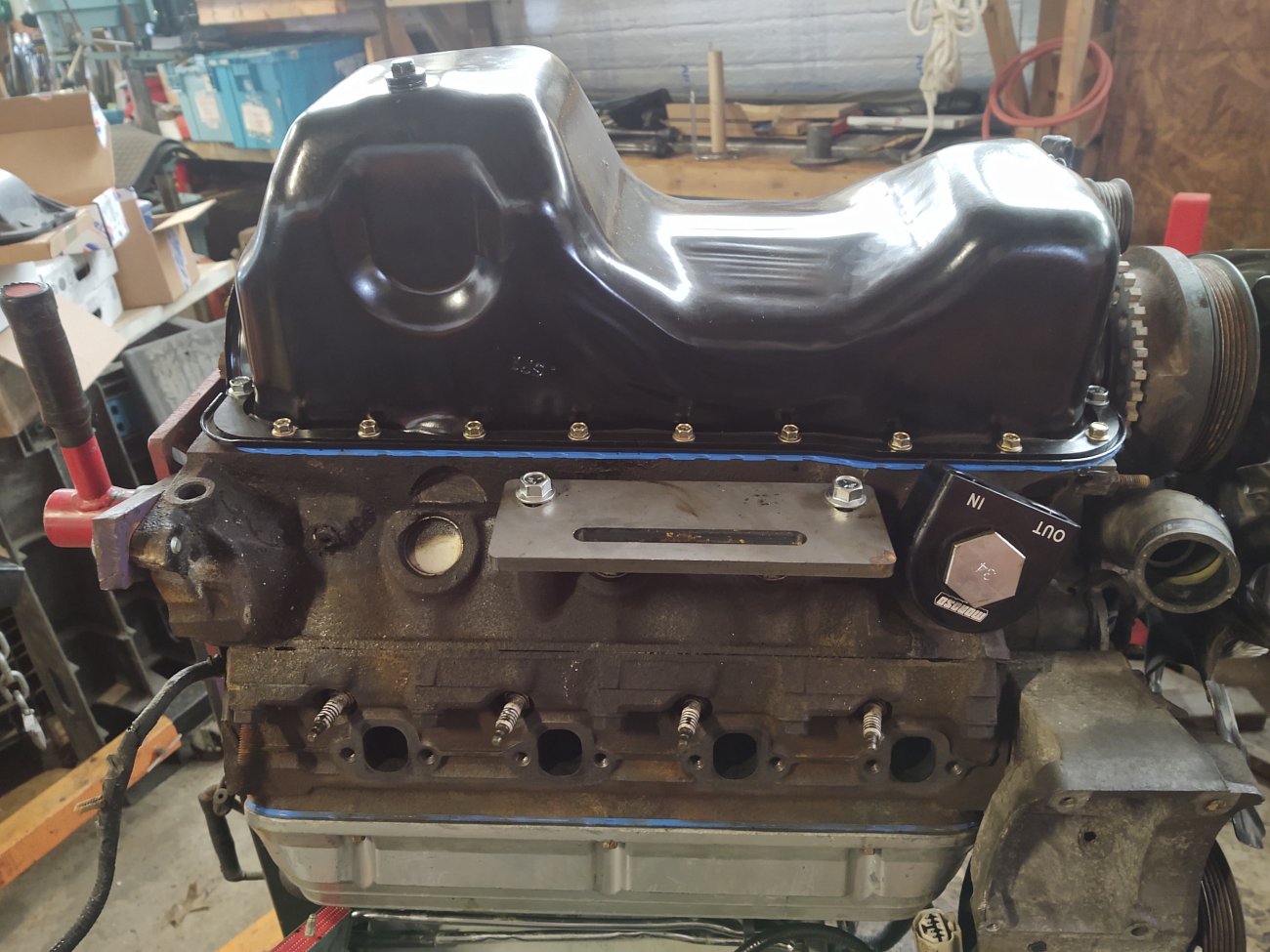

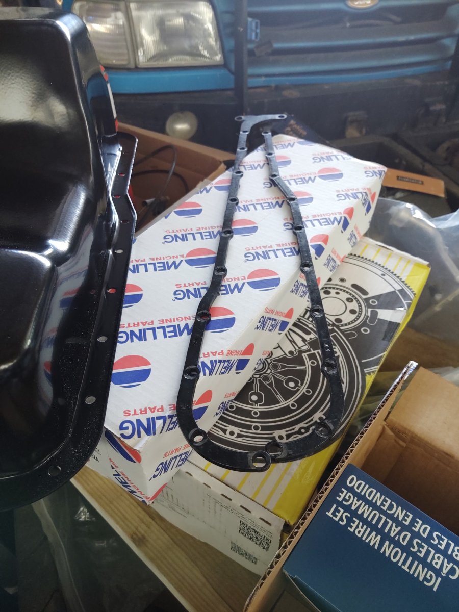

Fox pan, Moroso oil filter adapter, clutch cover bolts and my go to exhaust gaskets
PlumCrazy's V8 Daily Driver Build
support rails for stamped pan

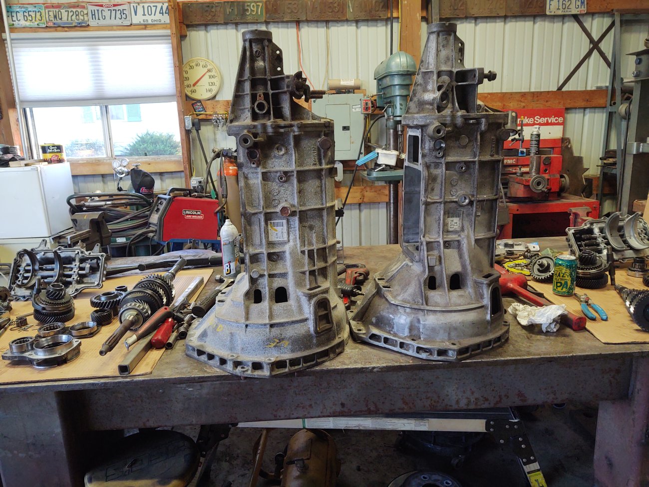

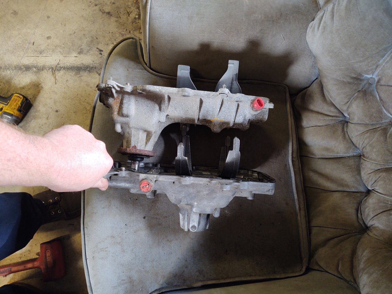

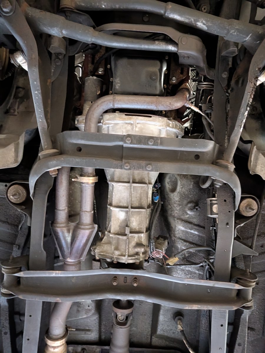

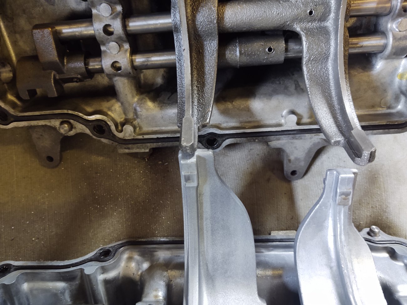

had to swap the whole 4.2 gear set because the aluminum shift forks are wider than the SBF forks
But the shift tower is in way better spot

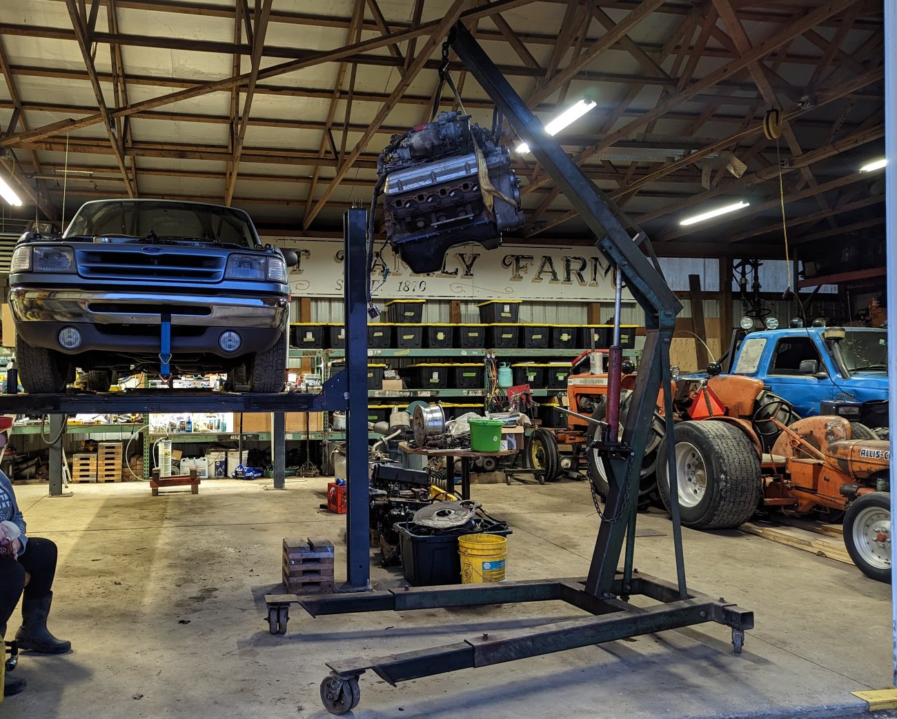

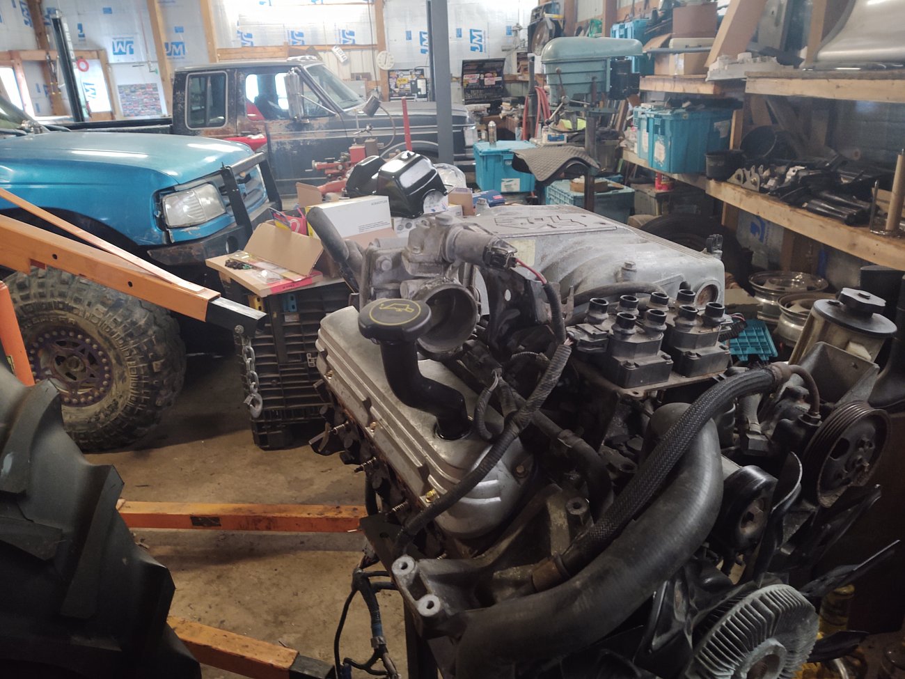

5.0 in (featuring my favorite hoist "The Duece")

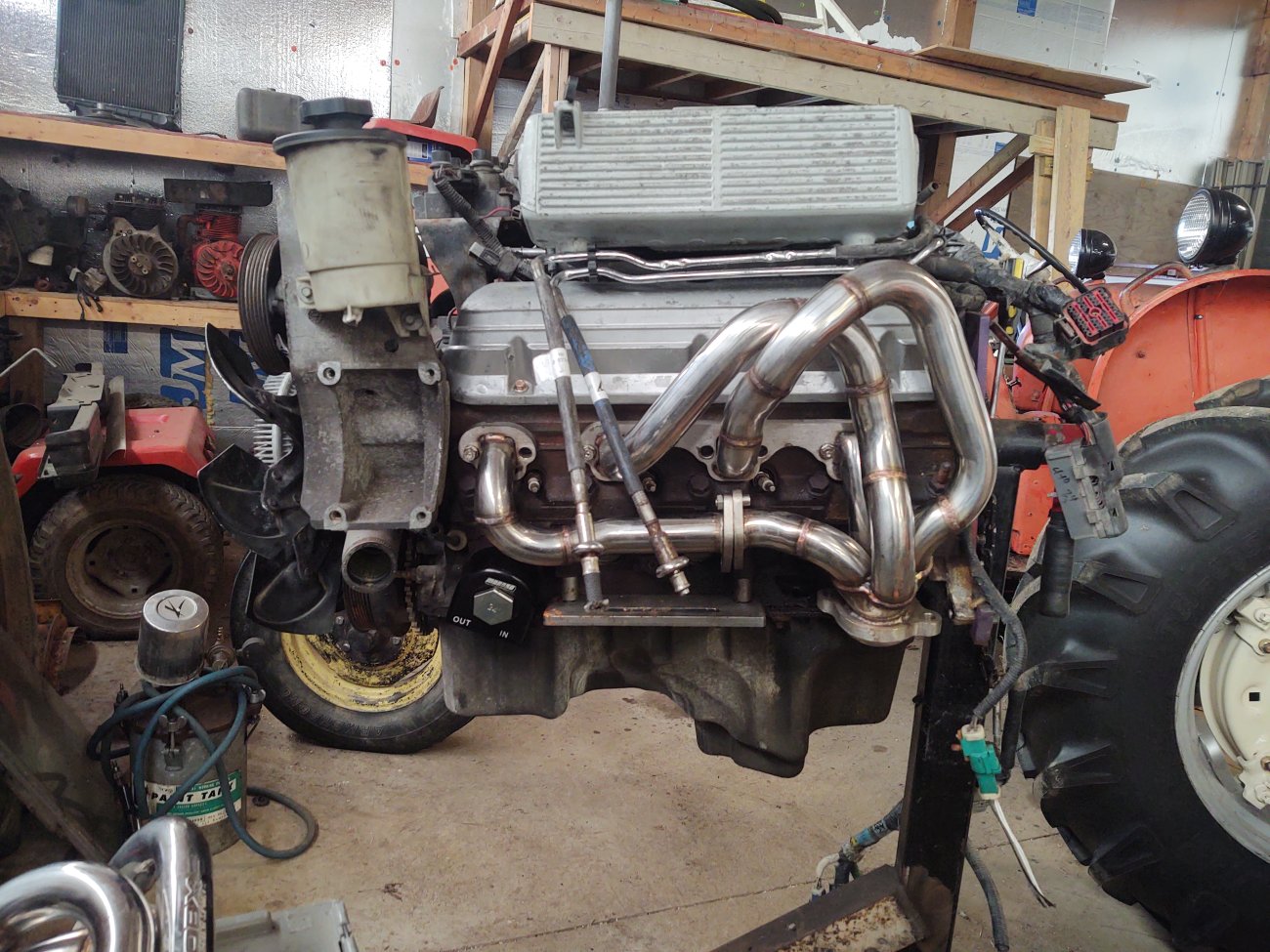

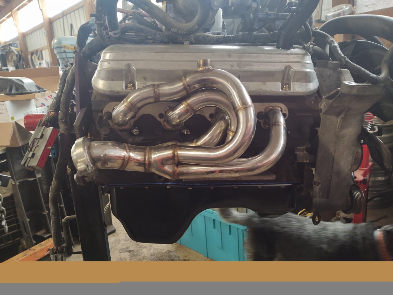

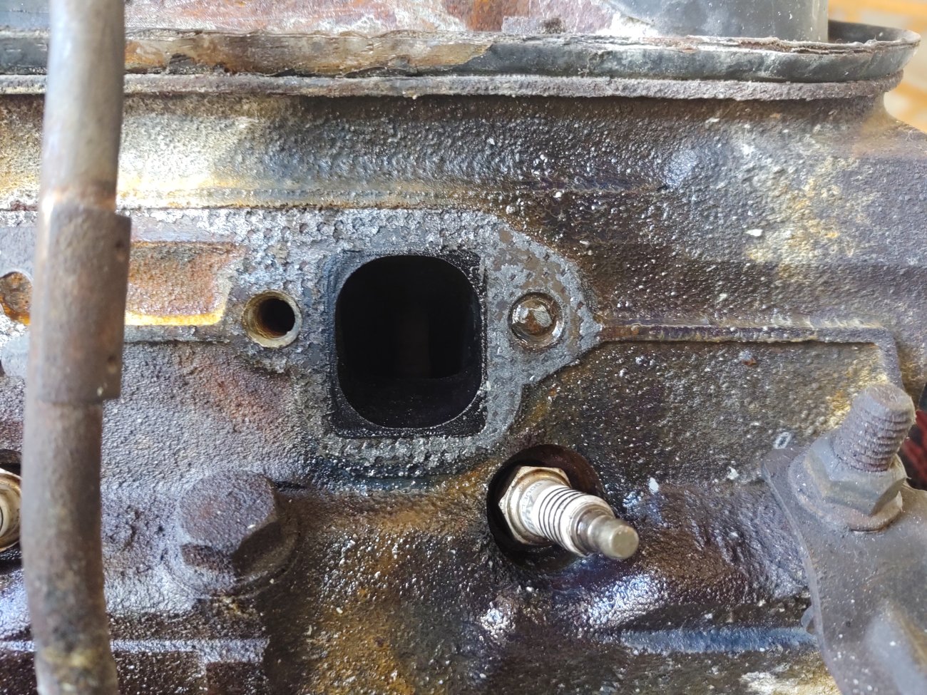

Decided to go to GT40 heads and run 289 manifolds then build the rest of the exhaust

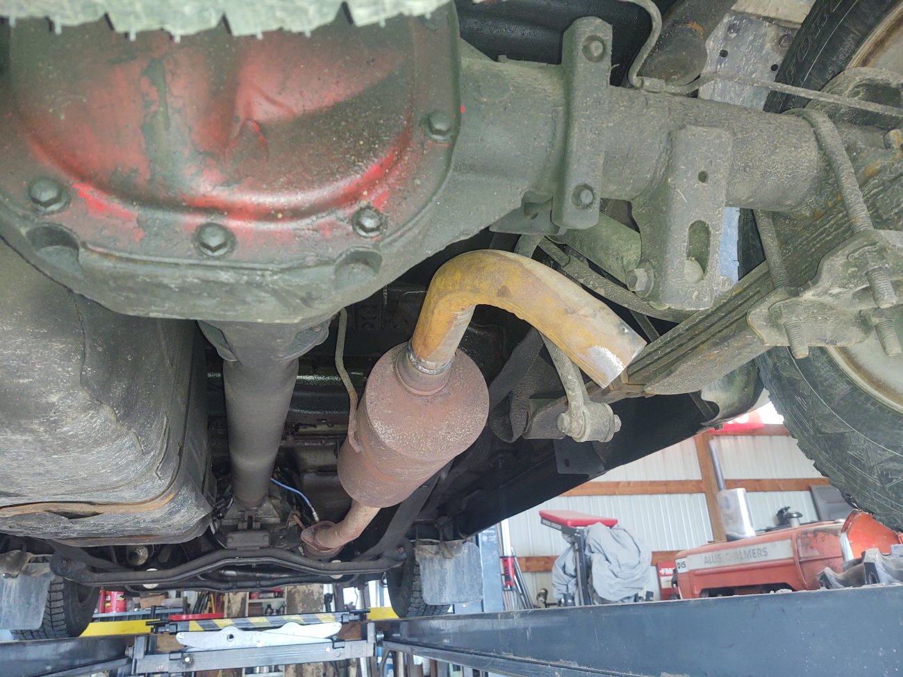

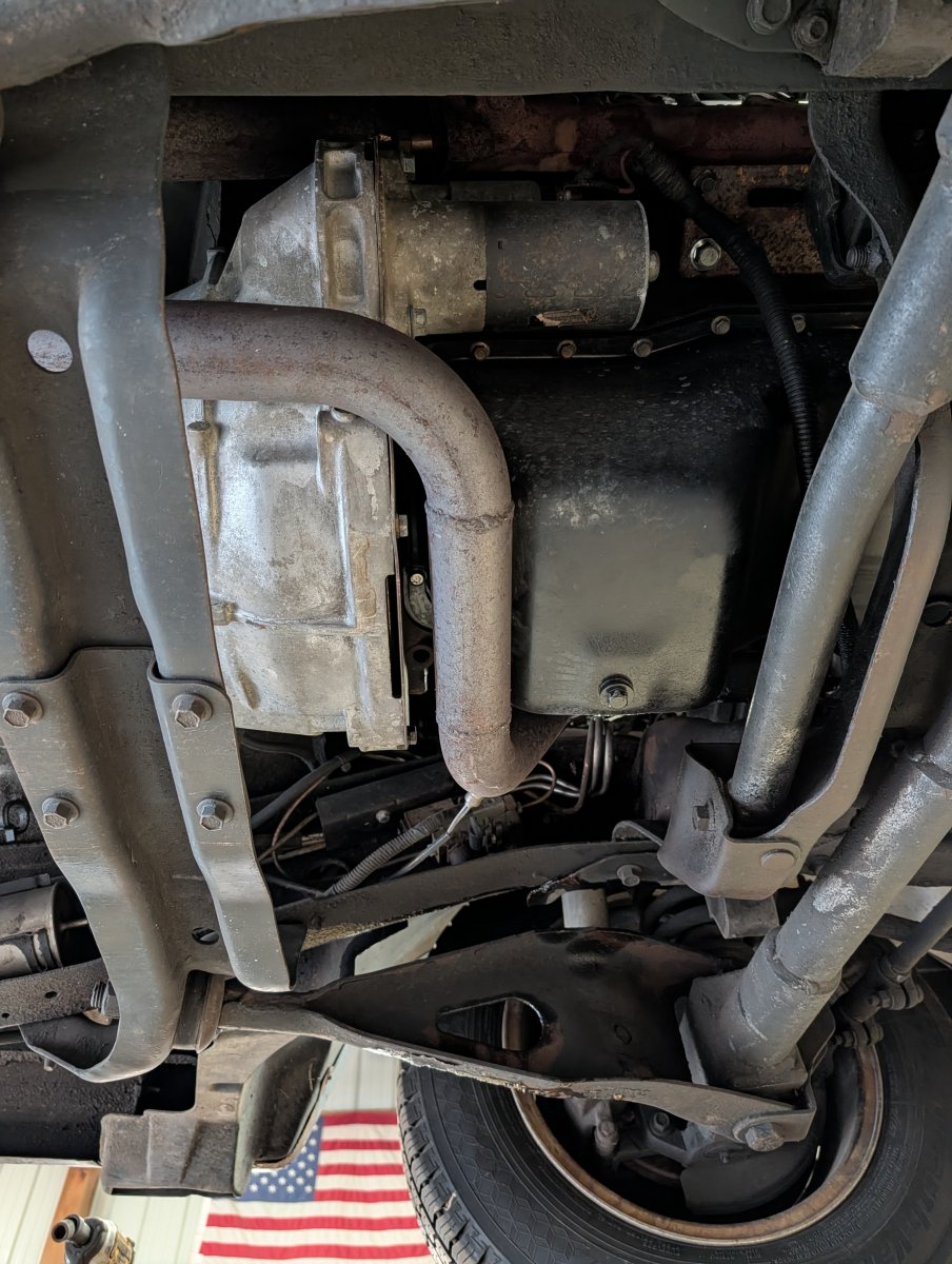

Y-pipe:

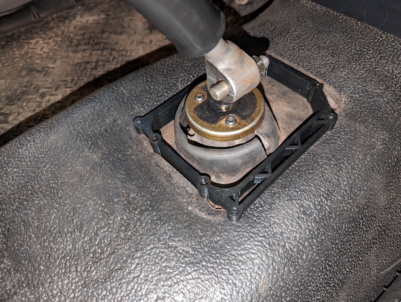

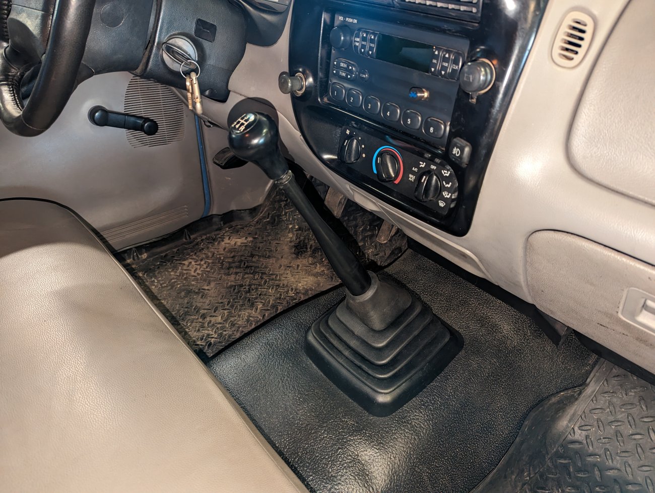

I 3D printed an adapter to use the 97-03 F150 shift boot and bezel over the Ranger carpet cutout

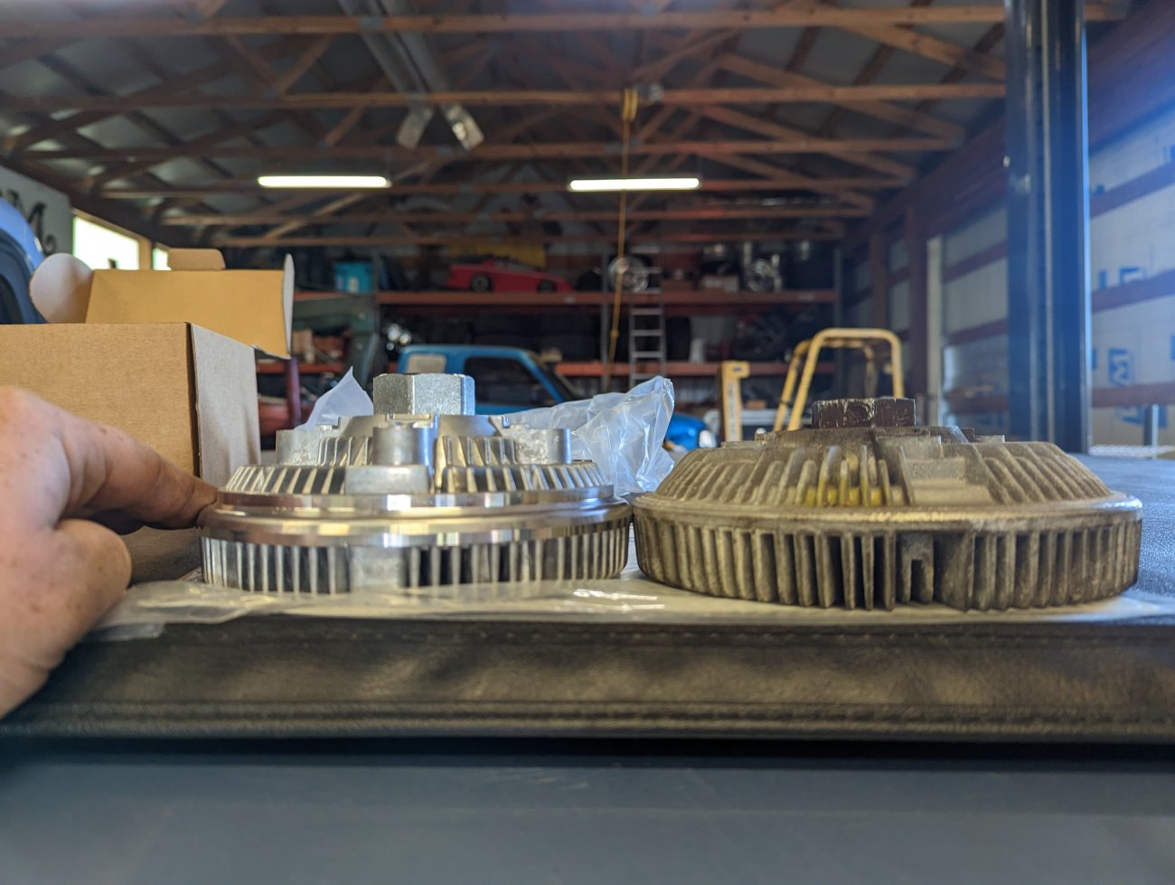

Some things I learned.. The OEM Explorer fan clutch is the most compact (aftermarket Hayden pushes the fan forward too far)

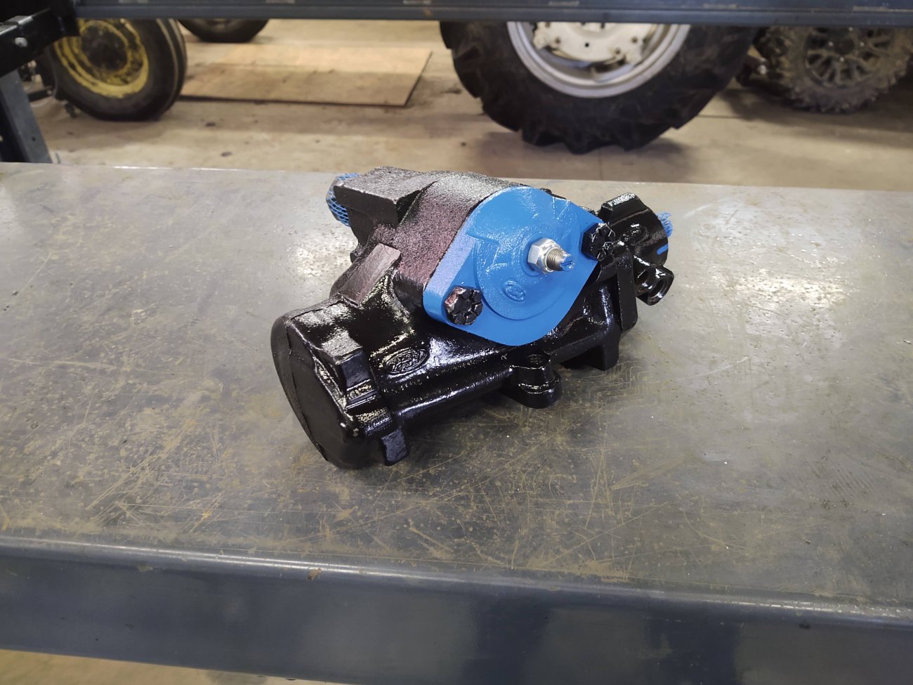

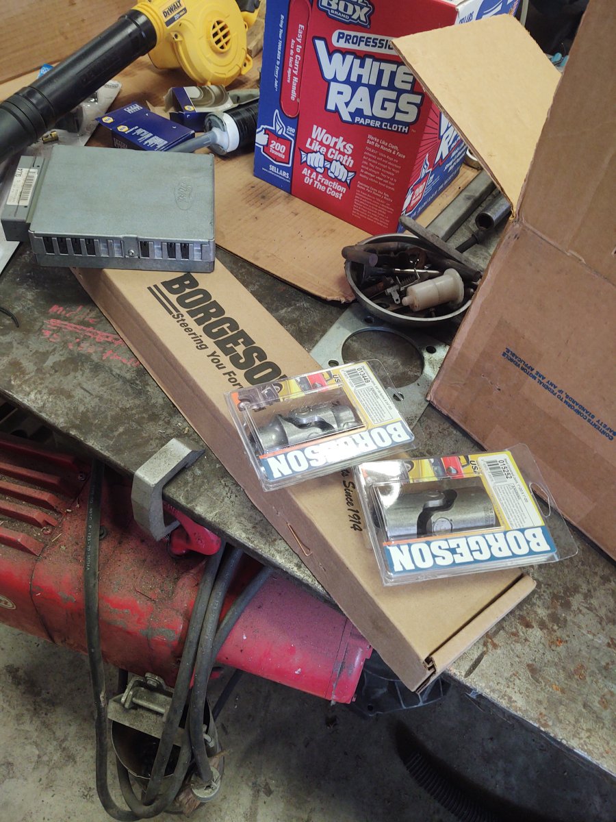

I also upgraded the truck to a bluetop box and borgeson steering shaft at around 300K miles

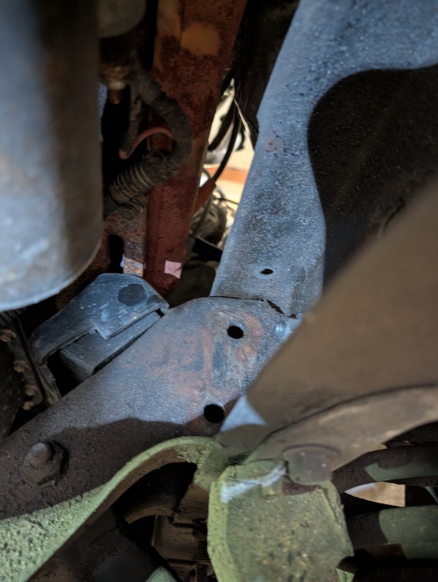

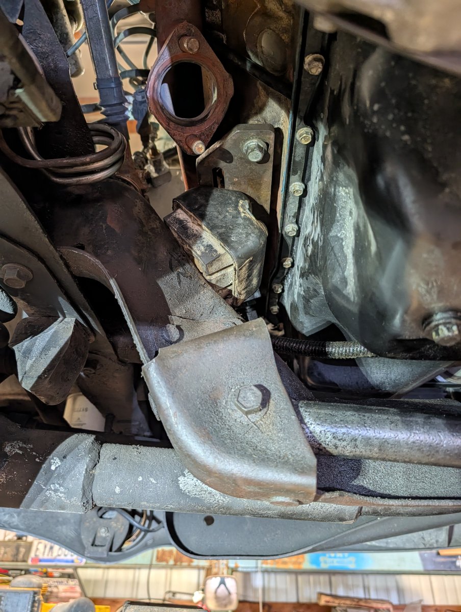

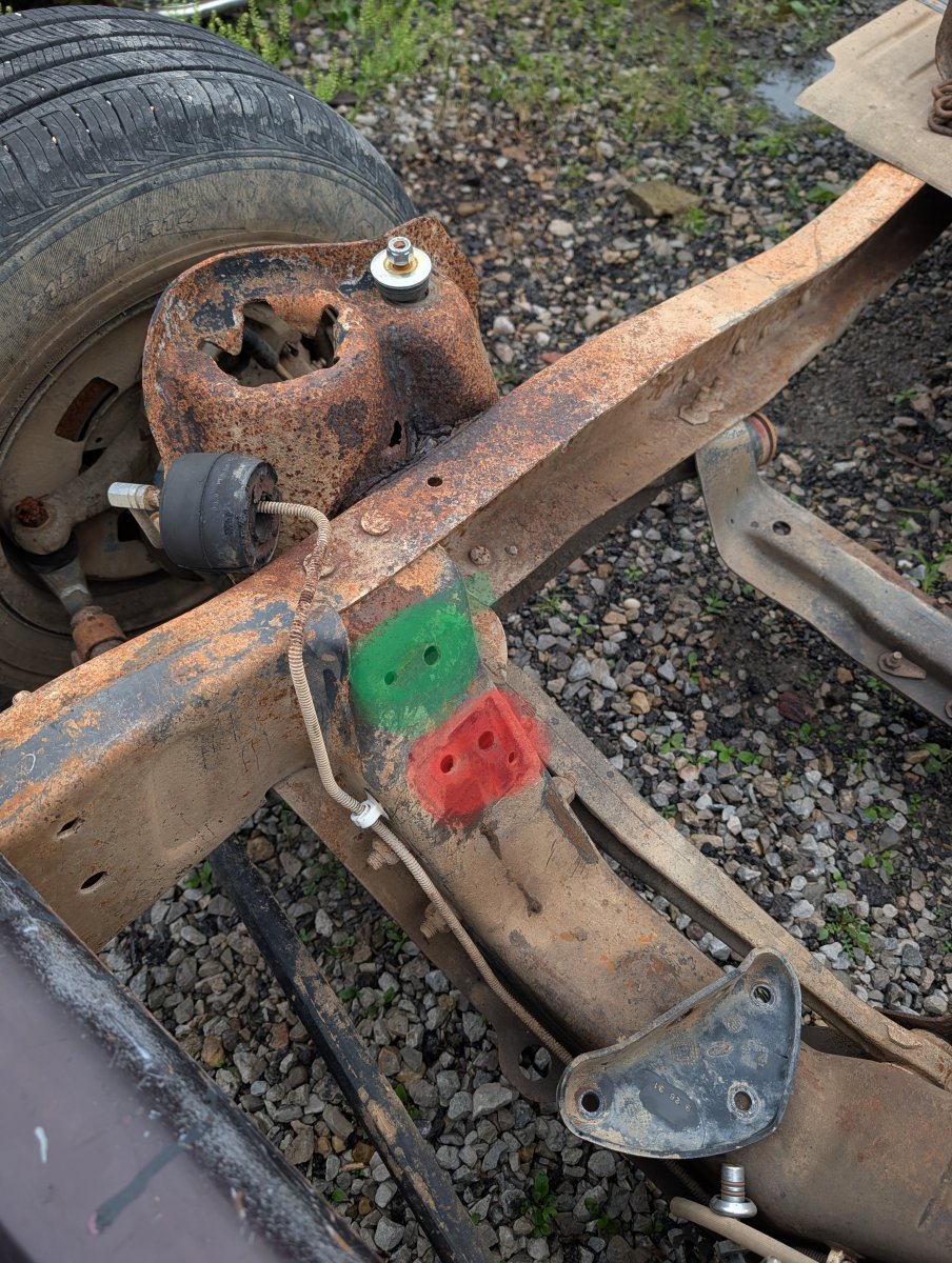

So when I did the 5.0 swap I used Ricks plates and Anchor 4.0 mounts....after a year or so the mounts have sagged probably 3/4".
You can see here the upper half of the mount is nearly bottomed out
I recently-ish drug home a roller frame to donate crossmembers and such to another project. It still had motor mounts (3.0 rwd). I was planning to swap both OEM mounts into this truck, but turns out the 3.0 pass side mount uses the lower holes in the frame in has a different dowel configuration.
You see here how much nicer the OEM mount sits
Green is where a 4.0 mount goes...
I was able to swap the DR mount over and it really made a difference. The upper rad hose stopped rubbing the fan shroud (which caused another issue to be covered later) and the fan clears the rad by a bit more.

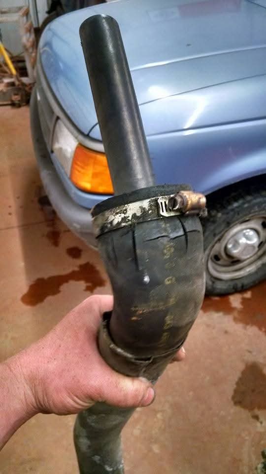

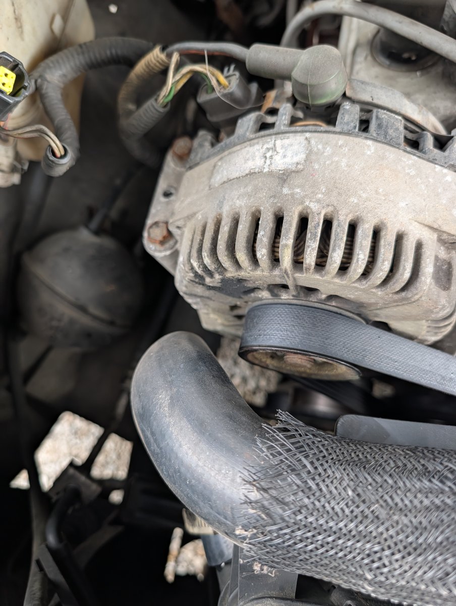

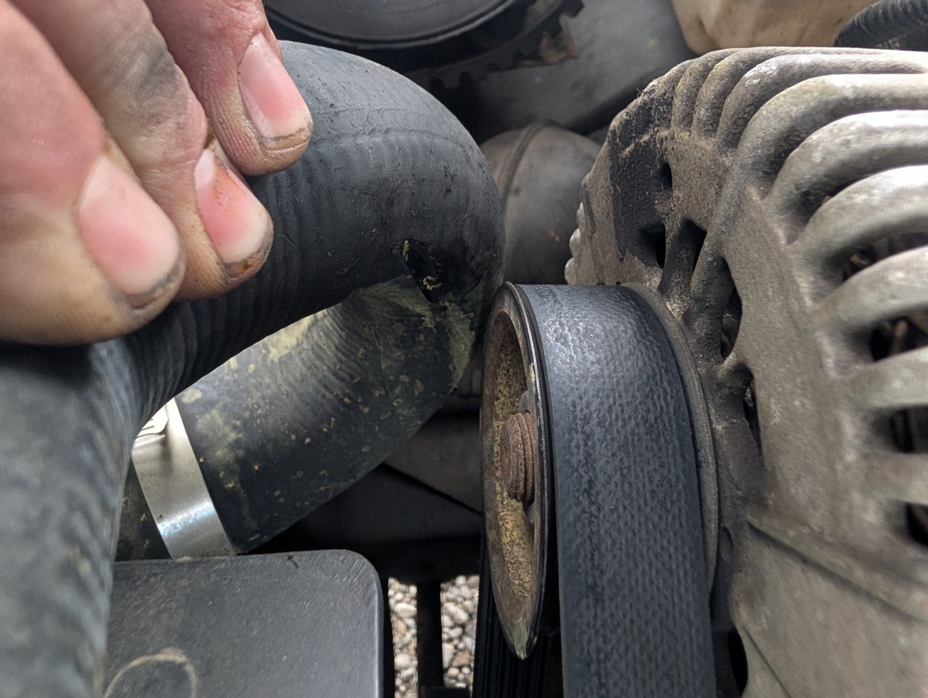

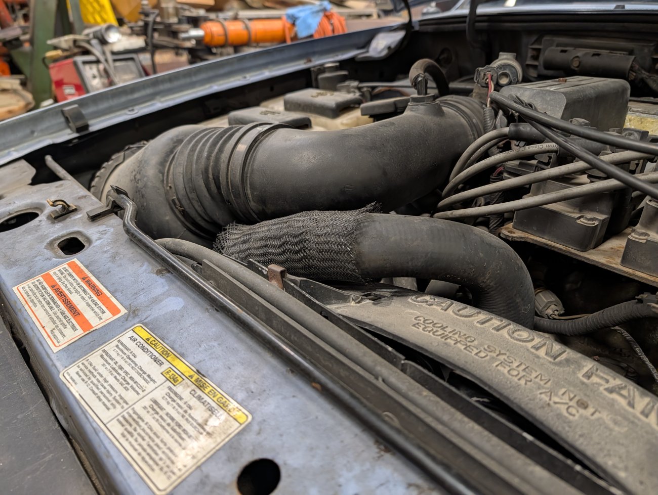

Not long after replacing the driver mount....I started smelling coolant and got a belt squeal.
Turns out I should have looked closer at the new found hose clearance I gained by the shroud.
I was able to replace the hose and just clock it a little differently and gained 1/2" of clearance.
Also the airbox clamp gave up when i moved the intake...so had to snag one from a parts truck.
Fan clears the rad by more than ever now too

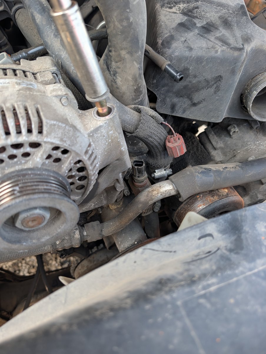

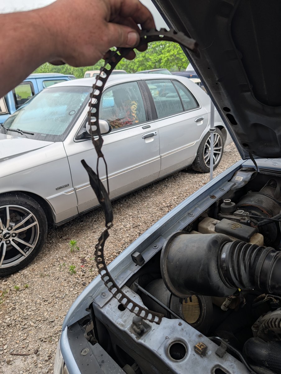

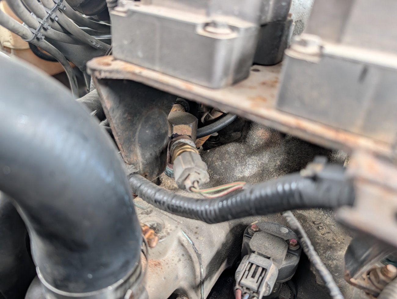

Also while I was digging around at the junkyard getting some 3G wire harness I figured out what my coolant fitting came from lol Clocked just right and using a pipe bushing it fits under the coil mount perfectly
Looked identical to this 4th gen 3.0(?) Ranger

What is the air box? I have need of one exactly like that
Try 4th gen 4.0l. Also, my 96 Explorer box seems to be the same. I can swap the back half (with theMAF mount) onto the 4.0l box I used for my snorkel.
Factory 95-97 Ranger body side and the MAF half/intake tube from a 95-97 5.0 Explorer
Yeah. That's a more eloquent way of saying what I said.
It may be all factory 97 2.3 box with only the 5.0 MAF... I honestly don't remember now. I know I compared MAF part no.'s so it may even be the same MAF from 2.3, 4.0, 5.0 lol
I know I used whatever part no. MAF was correct for a 5.0, but I know I didn't get a MAF with the engine....I either sourced one from my stash of 2.3/3.0/4.0 stuff or got a junkyard special lol
My 4.0 supercharged setup is a second gen Lightning MAF and I hogged out the factory 4.0 housing to fit it
