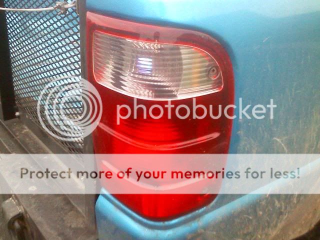

I decided to put the 02 tails on. I didnt like the look of the amber.

Next step is putting LEDs in them.

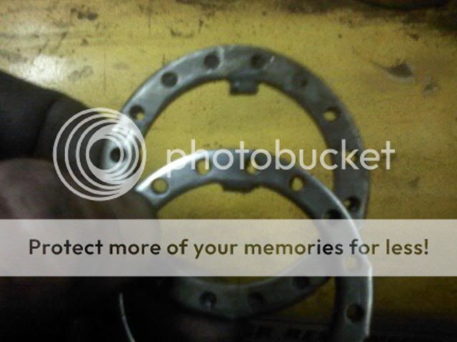

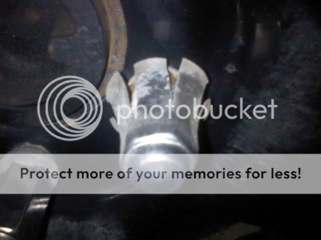

So while I had the lug nuts off to replace them I noticed the front rotors seemed a little loose. I pulled the hubs off to find that the spindle nuts had backed off a little.(no big surprise it has been 10,000 miles since I put the new bearings in). I was tired of fighting the stupid little nub on the lock washer, so I welded a little on the end of the nub and filled it square. Now it sits down in the key-way with no worries of it slipping out when I tighten the outer nut.

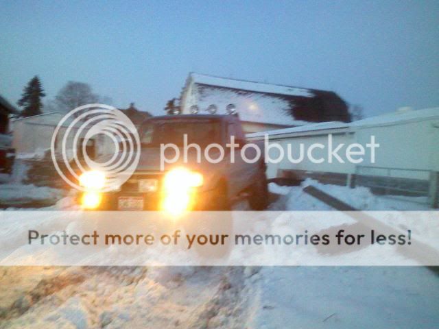

Another fog light burnt out so I decided to go another route this time. They are low wattage yellow bulbs. I like the look, I wish the yellow was deeper but I cant complain since both bulbs were less than 10 bucks.

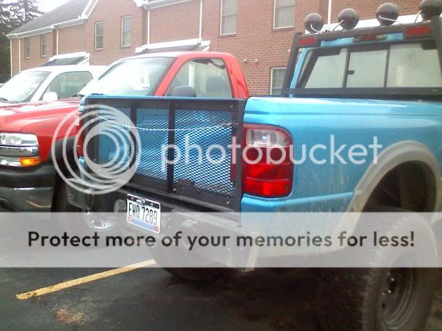

When I fixed the cabmounts a while back it raised the rear of the cab like .25-.50 so I had to shim the front of the bed up to make the body lines match, but I was too lazy to shim the rear of the bed so it looks like it is tilted back a little.lol
