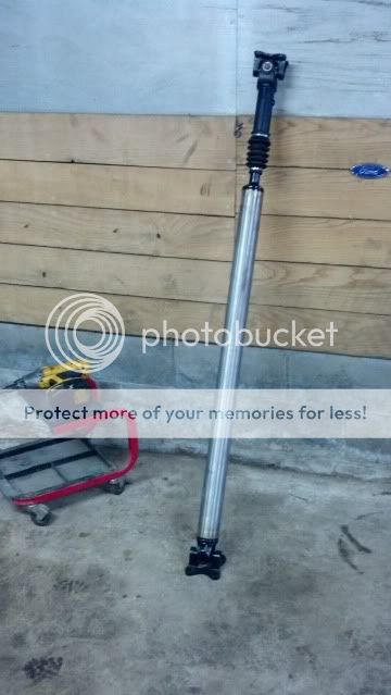

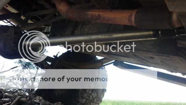

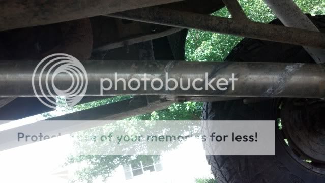

Got the new shaft together, painted the yokes and installed.
Big thanks to Brad (036speed) for getting the machine work and welding done for me. Its straight and true as an arrow. No more vibration/shaking at highway speeds. It looks out of place under my truck.lol

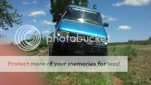

Wheeled at SOR yesterday at Spring Roundup.
My first GoPro experience was a flop. I got a few worthless clips and then lost SD card with the few good videos on it....
Had a blast, but sustained a little damage..
On the way to the park my wires for my temp and pressure senders caught the steering shaft and got wrapped up. I had enough wire to get the temp rigged back up. With the cooling issues I was dealing with last week before I cleaned the rad and condenser I wanted to keep an eye on it. Never got over 195 even in 80+ degree heat.

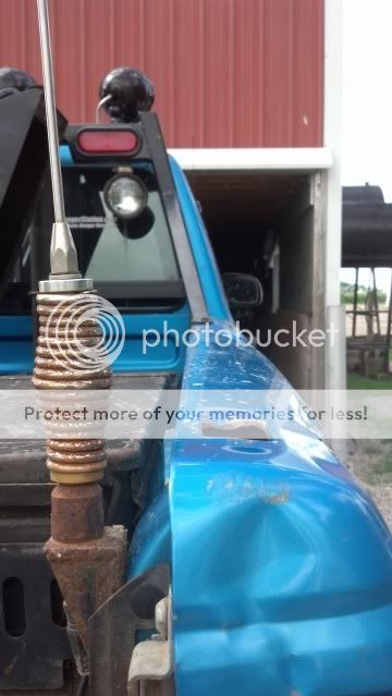

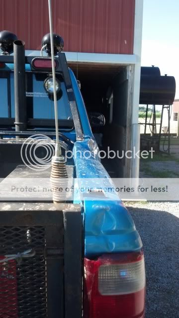

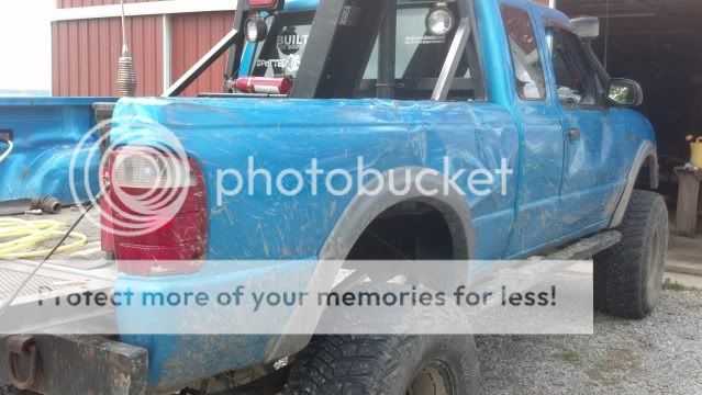

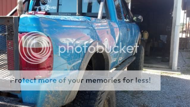

Towards the end of the day we ran a few tight trails..My trail limo rubbed a tree or two
After a little body work with a dead blow and a volley ball.lol

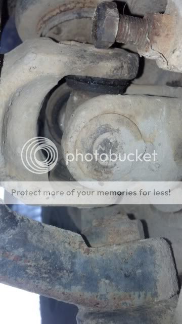

Tweaked my pretty new rear shaft. Had a bit of a vibe over 55 mph.
All the tacks on my wheel joints cracked.

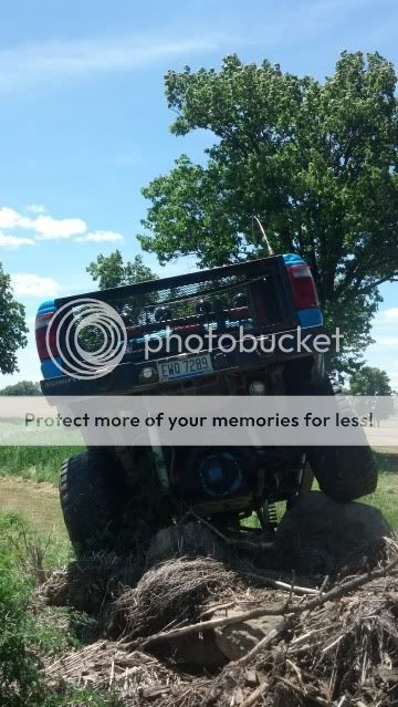

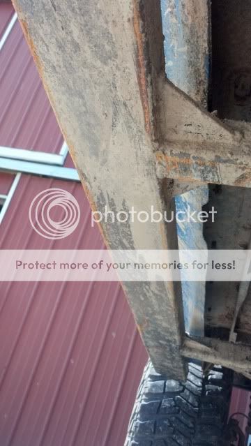

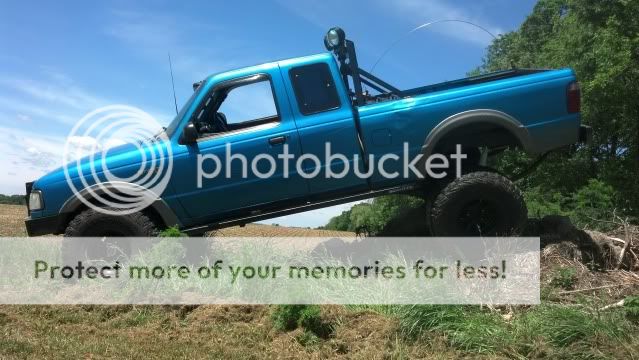

Sliders. Good thing I built those sliders. They got a work out. I would say I landed on them every bit of 100 times.lol They have some burrs kicked up.
