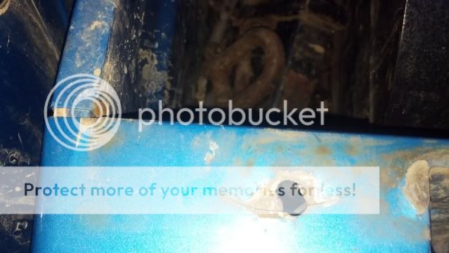

Good thing i pulled it off, fatigue cracks are starting. Looks like when I pushed the bedside in last year I stretched the hole too.
PlumCrazy's Build
I am going to use J bolts through the stake pockets next go around.

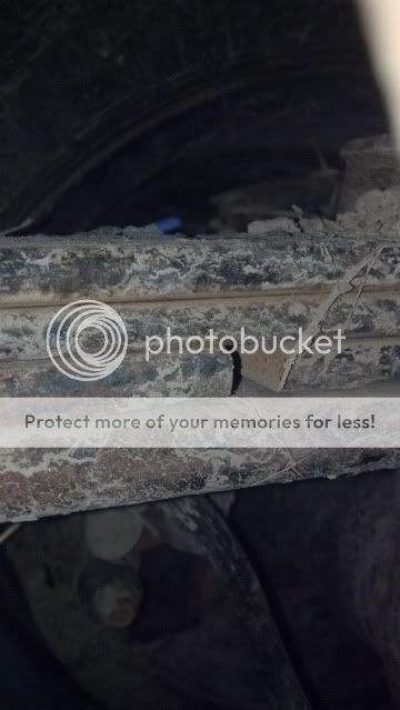

Snapped a leaf on the driver side. I am looking into some Procomp 88-98 Chebby springs. 198 ppi. I wish I knew what I already have...bought them used and they are perfect height and super soft.

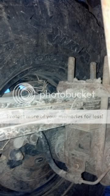

All the leaves on both sides are starting to bend into a W shape. I have a feeling the others are not far behind.
I also noticed from day one that these leaves I lay flat on the full length of the over load. All the lift/arch is towards the end of the spring. Im not sure if that is normal or if these springs are just that beat.
They have worked awesome, but I have a feeling I need to look into new ones altogether.

Did a little measuring last night, the ProComp springs Im looking at are 60" eye to eye unloaded and 66" flat.....
My current springs (found yellow sticker on them indicating Super lift) are 66" at ride height and easily 70" flat. That explains why I had to move my reae hanger back to get decent shackle angle.
For now Im going to replace the broken leaf and its passenger counterpart with a leaf from my old stock 64" pack...
If anyone knows where I can find 6" Superlift Chevy springs, let me know....I dont want to reinvent the wheel to run shorter springs if i don't have too.
