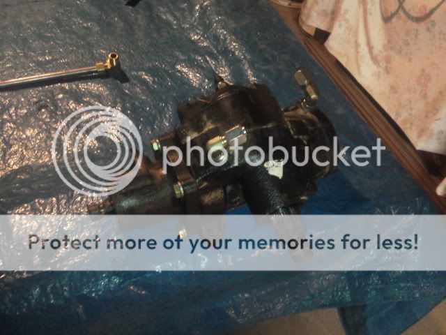

My rebuild kit came in today for the box and it all went together nicely until I went to put the dust seal in for the pitman. It is too small, just kinda falls out. No biggy I am just going to get a pitman seal kit and use just the dust seal since everything else was fine. I swap boxes this weekend hopefully.

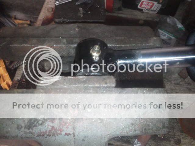

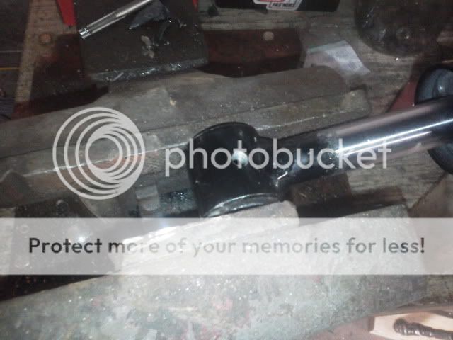

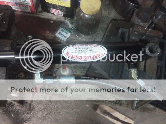

Added grease zerks on the cylinder ends.
Also swapped the 45* fitting for a 90* to tuck the hose back further.

Well.. I picked up another seal kit for the pitman arm. Same story. Fits the shaft fine, but the OD is too small. If I turn the shaft the seal turns with it.
I decided to put a small bead of JB weld in the outer rim of the seal and it seams to be fine now. Its just a dust seal.
I think this box has either been apart before, or was remanned. Its like the only box I have ever seen that didn't have the little metal tag under the bolt, but it does have Ford seals, do IDK.

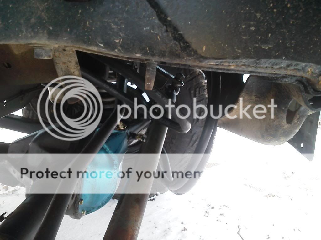

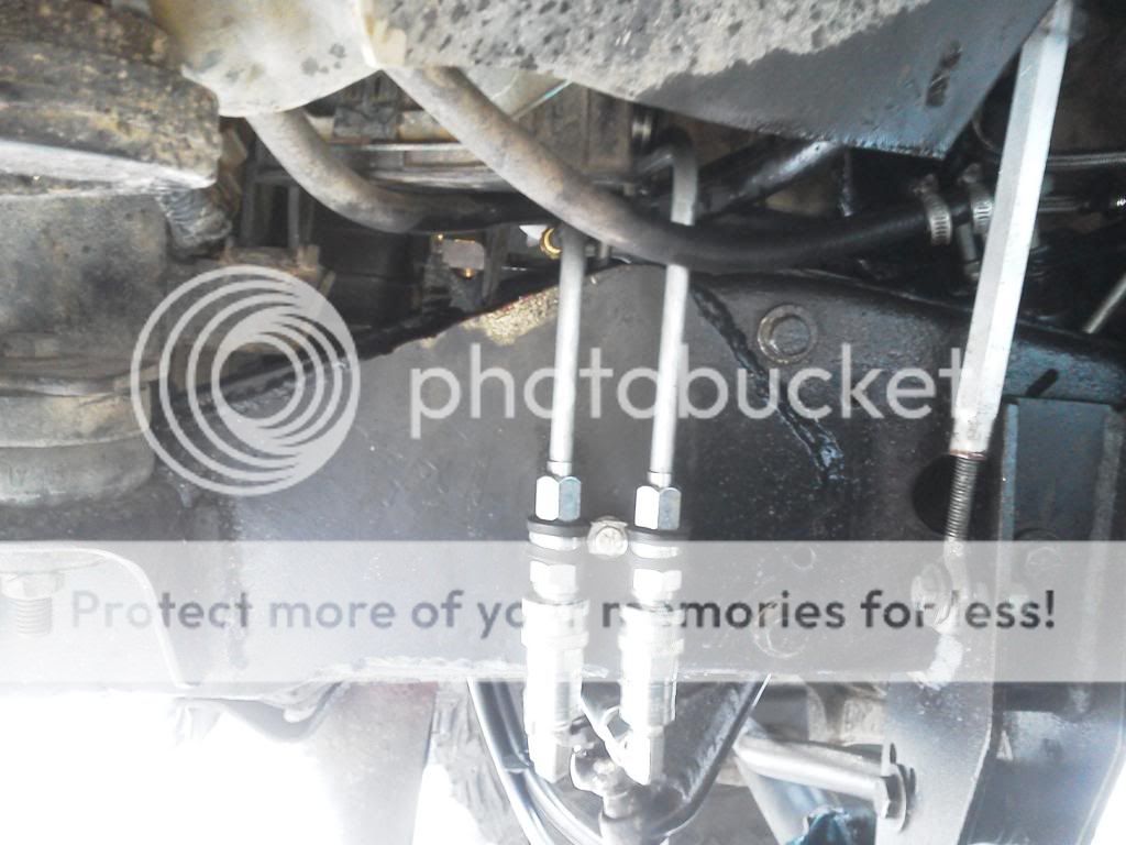

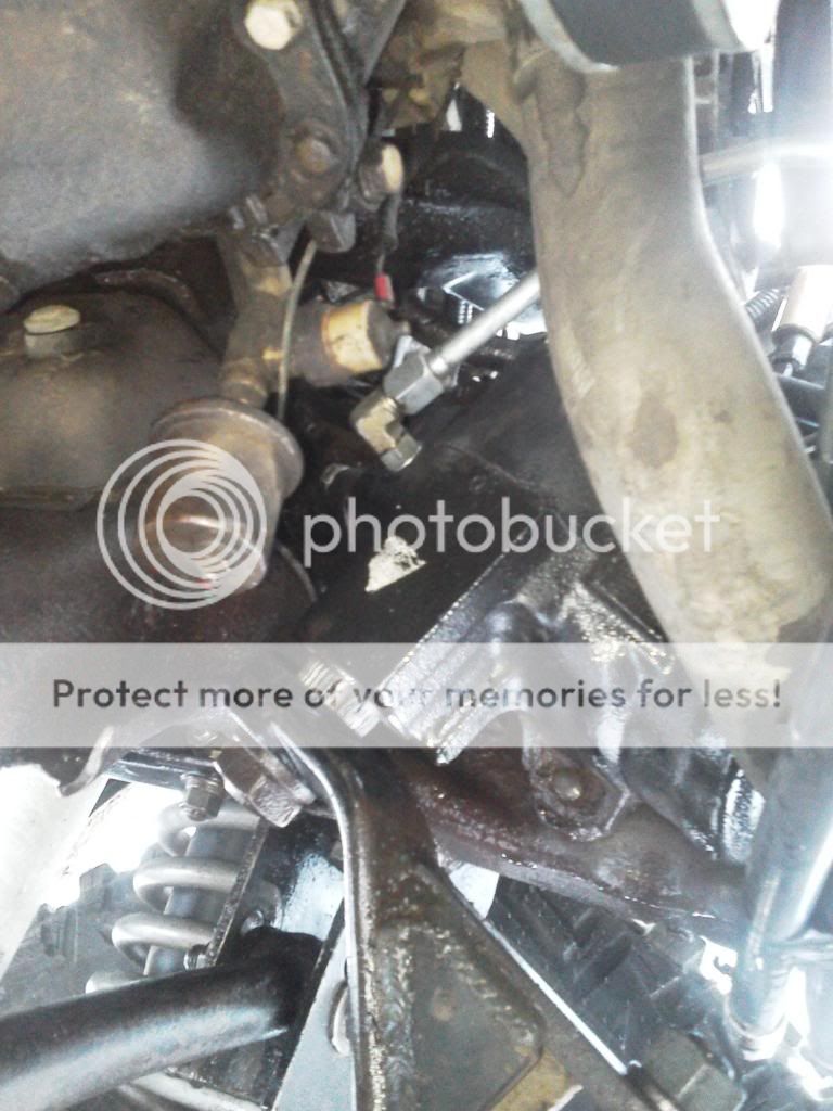

PICTURES!!

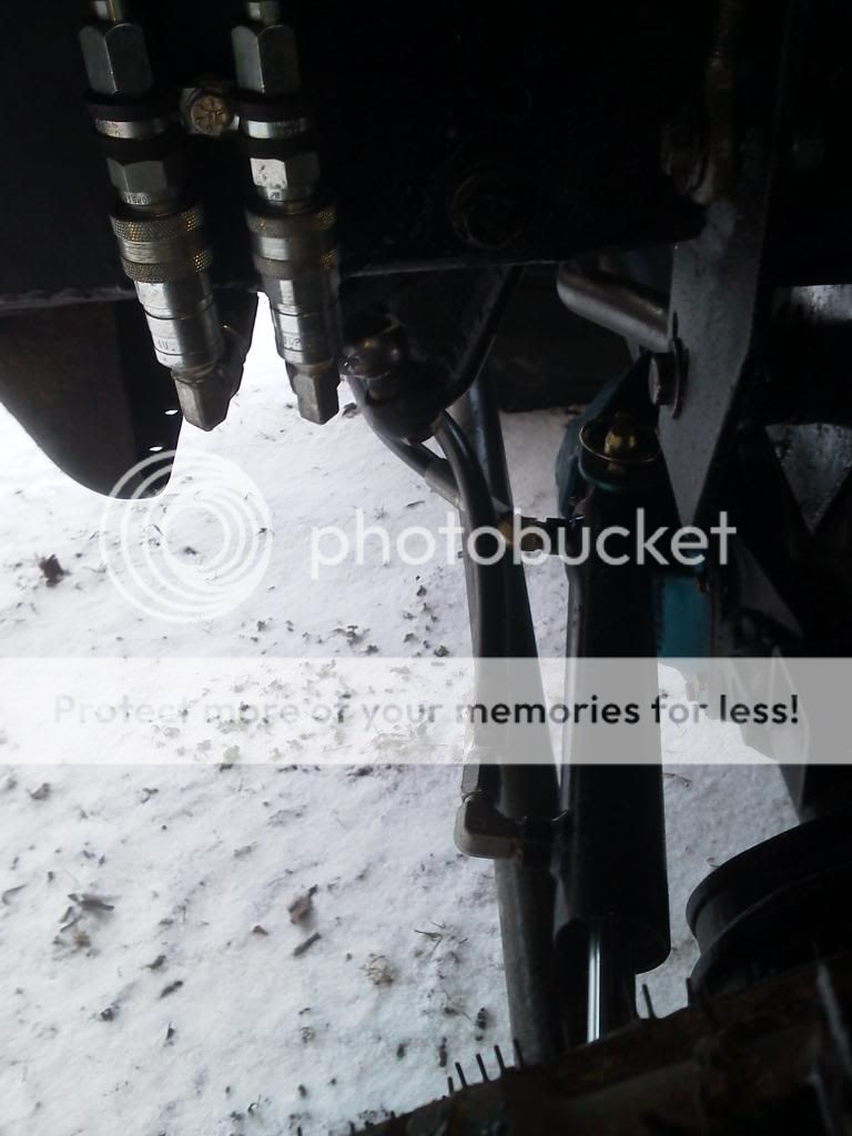

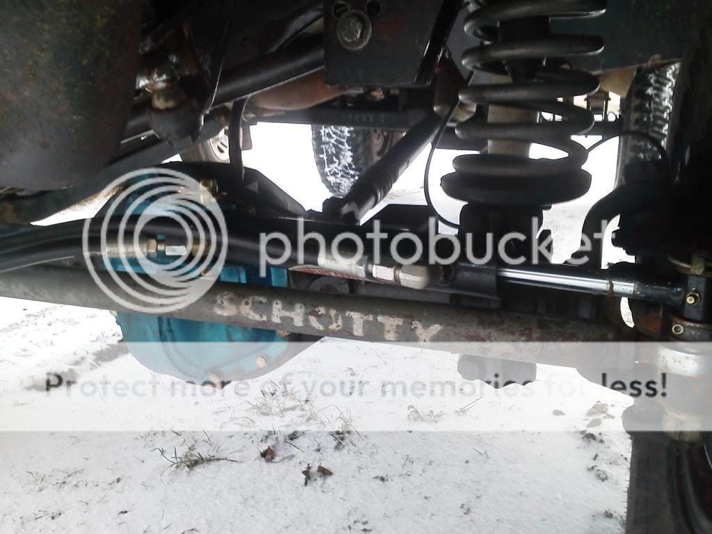

Not 100% done, but just a few little tweaks left.
I need to weld tabs on to mount the male quick disconnects to replace the temporary bolt on loops. I think over the time the stress from the weight of the hoses will bend and stress the lines unless I make a more rigid mount on the frame.
I also want to weld a small tab on the pass frame rail to attach a spring or bungy cord to for supporting the hoses.

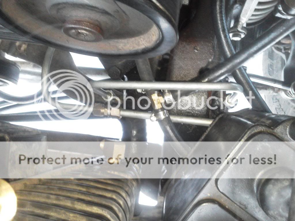

Also ignore the random hose loop hanging down.lol It is part of my unfinished engine oil cooler lines. My hard lines need some tweaking before they are ready to go on, so I just looped the hose for the time being.
I also want to replace the compression union with a JIC union, but I didnt have one on hand when I put it all together,
