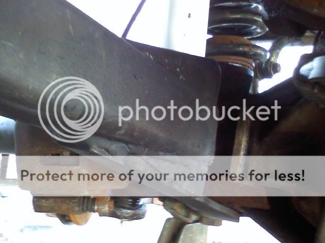

Thanks, I was originally planning on fixing some wheel bearings and spring hangers and running it stock for a while. Then I decided that since the rotors were off I might as well fix the sloppy ball joints and frozen u joints. And there is no point in replacing the ball joints and not replacing the worn out RA bushings. And if I am going to take it all apart anyway I might as well throw some drop brakets and lift coils in there, and since the RA cross member has to come off to put the lift on, I might as well pitch it and make a new that is 12 inches farther back. And if the spring hangers have to come off, Imight as well move them foward 6 inches, and why fight with the leafspring buhings when I have a set of 64" leaves with good bushings? I decided that I couldn't live with 3.27's so rather than regear my drum braked 8.8, I decided to throw a 31 spline l/s disc braked exploder rear with 3.73's under there. Lift shackles were cheaper than stock ones so it only made since to put those back there.lol

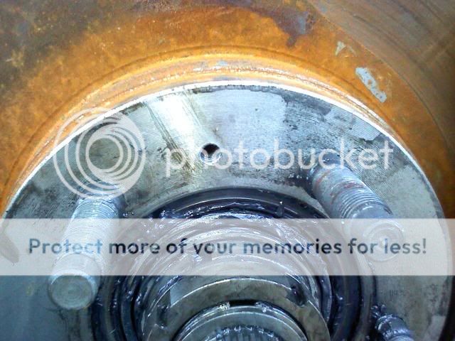

I drilled and tapped out a hole in the rotors,and counter sumk the hole in the hub for a countersunk 1/4" stainless bolt. I was tired of the hubs sliding off with the wheel.

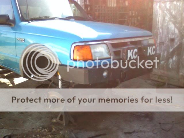

I swapped bumpers with my 2wd DD. I kinda like the look of the chrome bumper w/o valance on my 2wd. I cut the corners of the bumper to clear some bigger tires (some thing I should have done when I made the bumper originally, but I gues I didn't know I would ever have a 4x4 with 33's:icon_twisted:)

I also snapped some random pics of the Extended RA's and the almost completed front end.

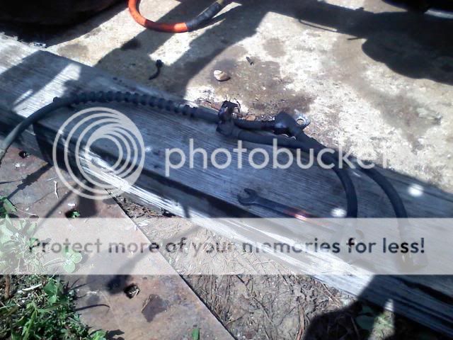

Ok, so I got my brake lines. I ordered lines for a lifted Ranger, but I wasn't thinking about the fact that I have an Exploder rear. On a Ranger the rear brake line tee's on top of the rear diff, and on a an Exploder (w/ disc) the tee is biult into the DS caliper hose.
PlumCrazy's Build
So I decided to put a PS caliper hose on both sides that way I could put my tee in the Ranger location. I hope this makes sense.

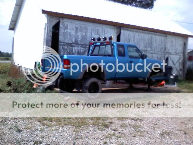

Nobody was around to help me lift bed up and put it on, so I got creative:icon_twisted:
PlumCrazy's Build
PlumCrazy's Build
Now she has to sit until I get my wheels and tires.:annoyed:

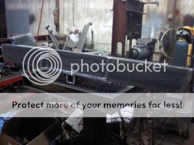

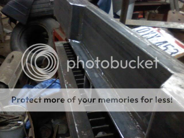

Welp, I made my bumper last night, I still have to paint it and drill the holes for the plate, light plugs, and plate light.and I need to weld something on the bottom for trailer safety chains to hok on.
PlumCrazy's Build
PlumCrazy's Build
PlumCrazy's Build
PlumCrazy's Build
PlumCrazy's Build
It is made out of 6" channel, 2"x1/4" flat, 3"x1/4" flat, and 3"x3"x1/4" angle. It weighs a good 80 lbs., Now it matches the front that weighs about 110 lbs.
