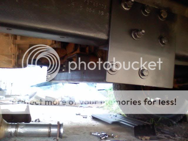

I finally got a few pics of the tranny crossmember and RA mounts.

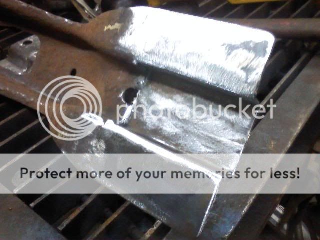

I started on my cross member, I decide to us the old one, but the hump that clears the exhuast didn't line up right. So I cut 4 inches off the driverside and added 4 inches on the pass side to shift the hump over. I had a random peice of stamped steel channel that worked out perfect for the middle peice.

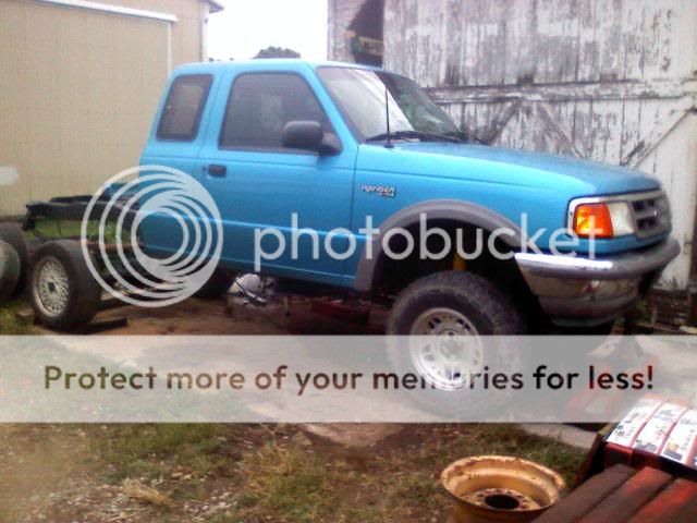

I got a couple pics of the truck with 30"s on the front and some random pontiac wheels in the back. The truck will sit almost level, it will lean slightly foward when its done.

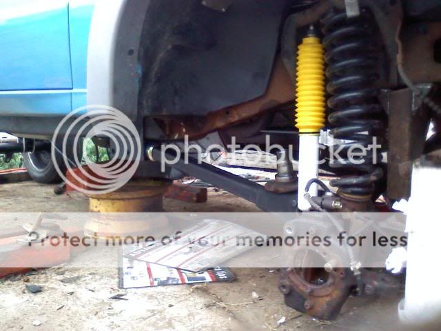

I got a pic of the coils in and the shocks sitting in place, the front is basically done. I just have to put my new sway bar on and swap out my pitman arm and brake lines.

love what youve done with the from suspension :icon_cheers: !!!!! definatly alot stronger then stock ! keep the pixx comin !!!
