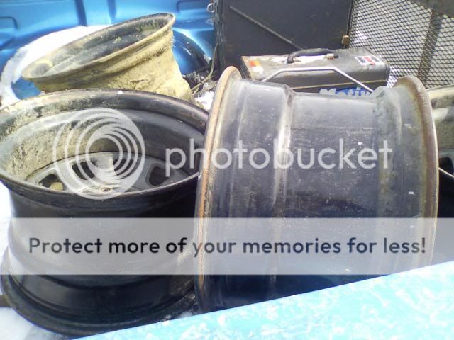

Anyways. I did pickup some 5x5.5 15x10s for dirt cheap. They need a good cleaning.

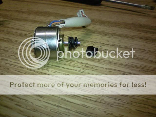

I also got around to fixing the odometer.

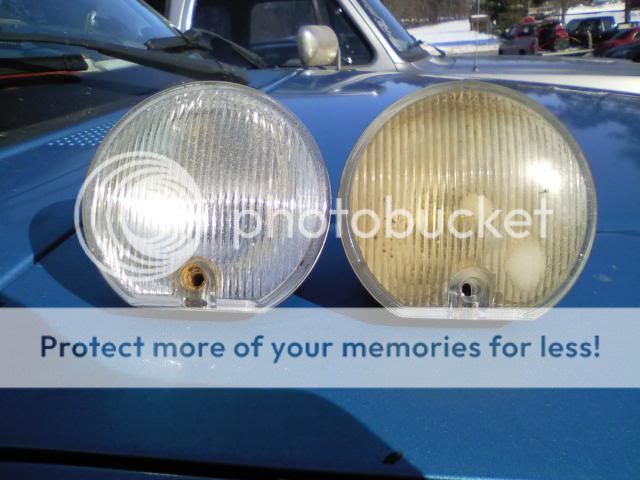

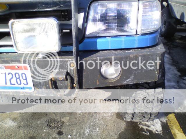

Small amount of progress made on truck. New (new to me) fog lights. I ran 50w bulbs in the last set and kind of melted them and then they got full of water and turned all nasty.
So I switched back to the 27w yellow fog bulbs. and used some newer housings.
new vs old

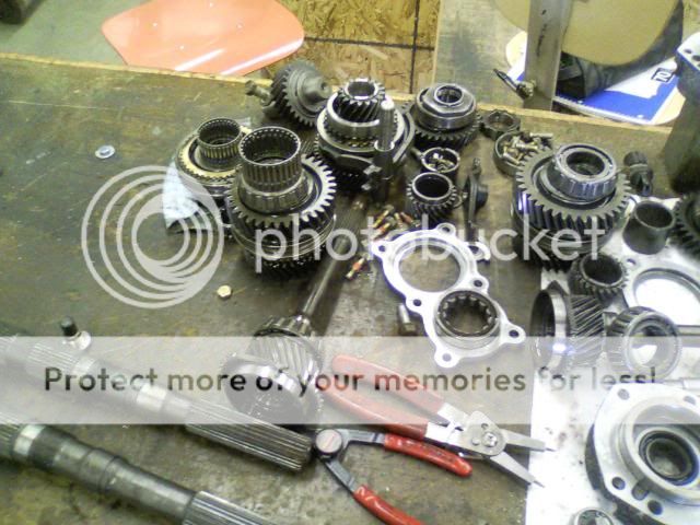

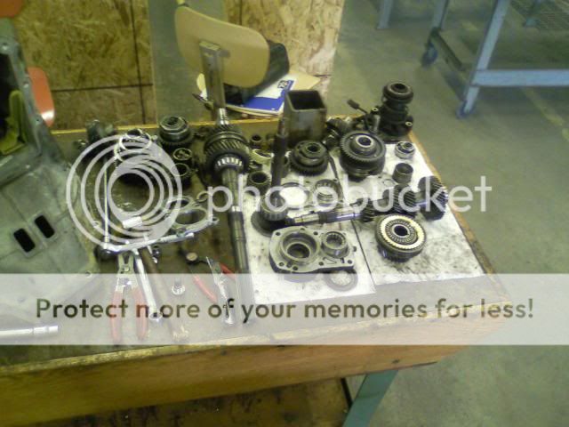

I finished putting my second M50D hybrid together.
I used a M50D-R1HD 4x4 for the housing and output shaft and a 2.3 2wd M50D-R1 for the gears, input, and countershaft. I also replaced all the synchros, tapered roller, and ball bearings as well as the seals and shifter bushings.
The first Hybrid trans I threw together was just to see if it was even possible, so I didnt replace anything but one bearing that I messed up taking it apart. I have been running that trans for over a year no with no issues. But the synchro for first gear is worn and the input bearing is a little noisy since I didnt replace them while it was apart. Not to mention I rebuilt it on my tailgate which was nowhere near as clean of an environment as I should have built a trans in.lol
I also came to the conclusion that the only thing special about the HD trans is the extra bellhousing bolt hole for the SOHC and the speed sensor on the tailhousing, which are both worthless to me.lol

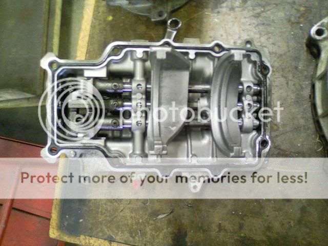

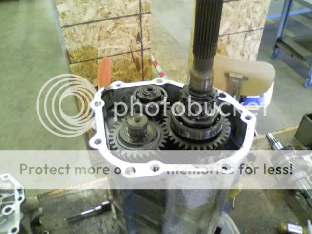

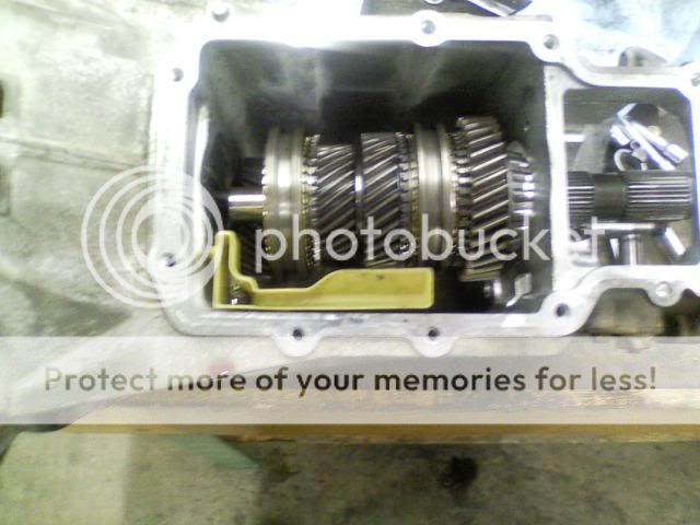

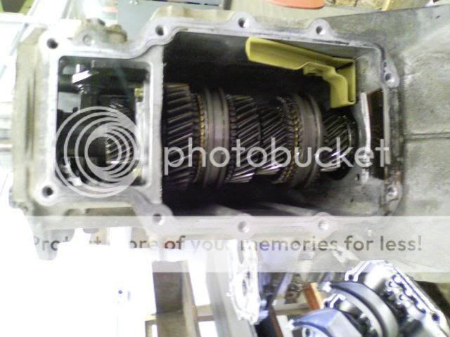

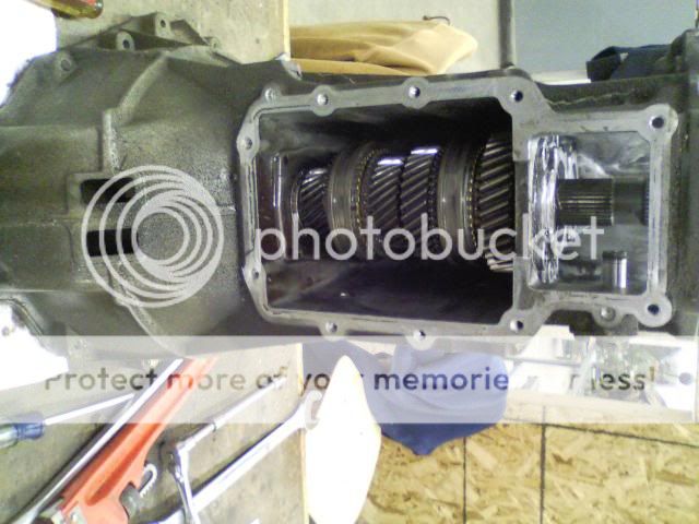

I started by pulling the tail housing and top cover off.

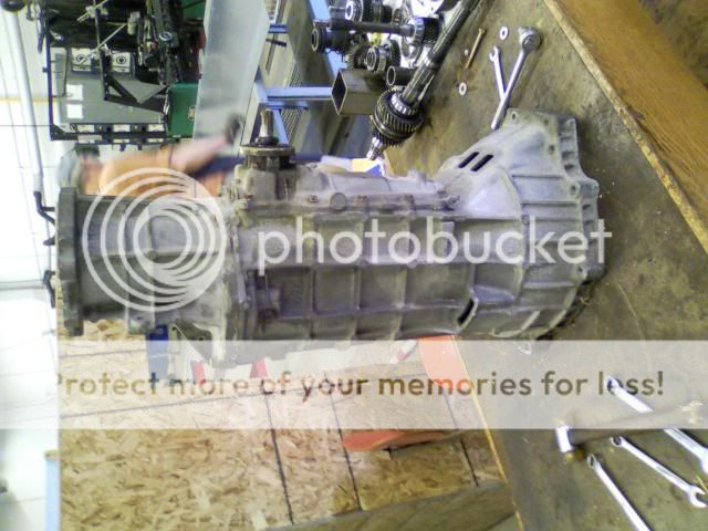

Then I bolted the trans to the table and pushed both shift collars down to engage it in two gears at once and lock it up.

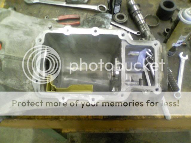

With the trans bolted down and locked up I broke the nuts loose on the output shaft and countershaft. And pulled everything for 5th and reverse out. I was careful to take out the whole shift shaft and fork together this time so the detent didnt pop out.

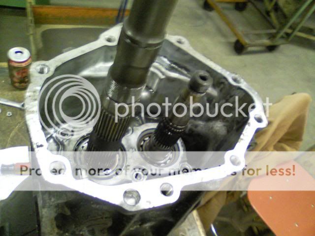

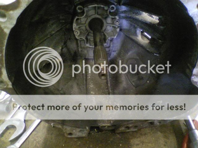

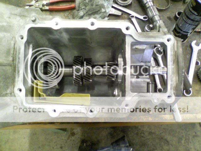

Next thing to do was take off the front cover, and midbearing retaining plate. Then work out the countershaft bearings and input/output shaft races. The countershaft bearing MUST come out in order for the countershaft to drop low enough to allow for the input shaft to be worked out of the front hole.

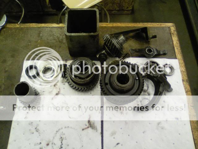

Then I lifted out the outputshaft and countershaft. To get bearing midway up the shaft to let loose and allow for the gears and synchros I simply stood the shaft up on end and lightly tapped it against a sold table and the weight from the gears above pushed the bearing right off with not heat needed. same went foe getting the bearing off the input shaft.

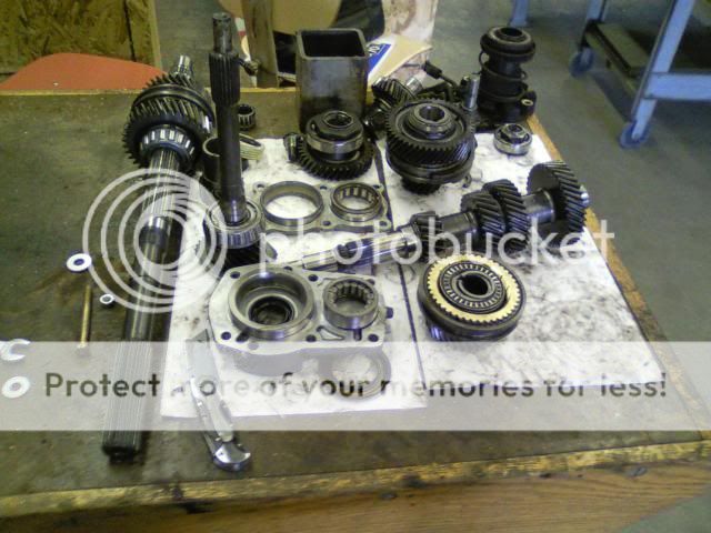

I fully disassembled both trannies, and then to clean up my work area and reduce the confusion I assembled the 2.3 trans with the 4.0 guts.
I slid all the 2.3 gears and new sychros and bearings on the 4x4 shaft and reassembled the 4.0 trans. I made sure I lubed all the needlebearings and synchros with ATF when I put it together to eliminate a dry start.
Alot of headache could be avioded if I started with a 4x4 2.3 or 3.0 trans and didnt need to do synchros. The shafts would be the same, so it would just be a matter of swapping the whole assembly, but 2wd 2.3 5 spds and everywhere and cheap.lol

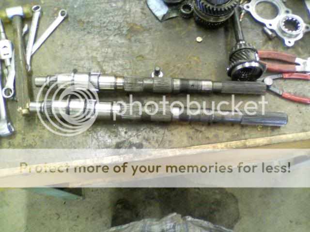

Here is comparison of the 2wd and 4x4 output shafts
4x4 is the top one, notice it is shorter and smaller in diameter since it doesnt have to support a slip yoke.

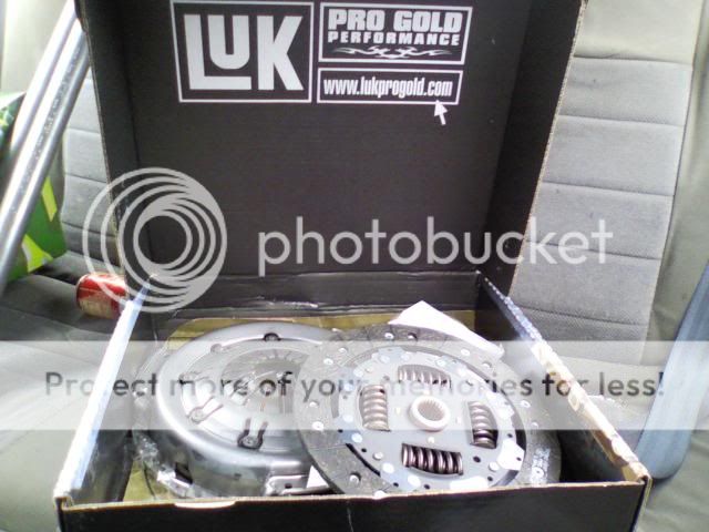

I will be picking up my new LUK clutch soon and swapping out trannies soon.

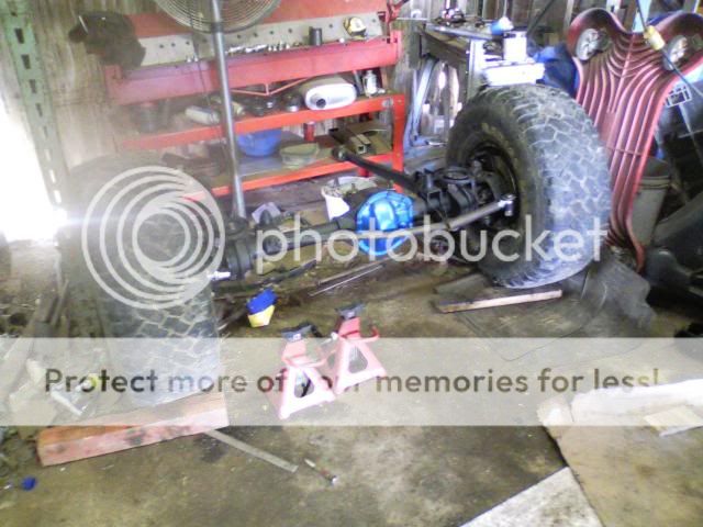

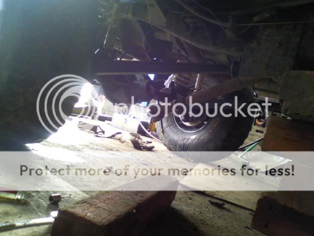

The Dana 44 is under the truck.
Its just sitting under the truck now with the TTB springs, steering, and my RA brackets from my TTB setup.
I am going to remake the RA mounts to push the axle forward 2" and down and 1" to help with caster. If I used my current mounts the axle would be in the same place it was with the TTB which put the tires too close to the fenders for comfort. I still need to make a track bar mount, and steering linkage. I think the stock EB track bar is going to be perfect length, too.

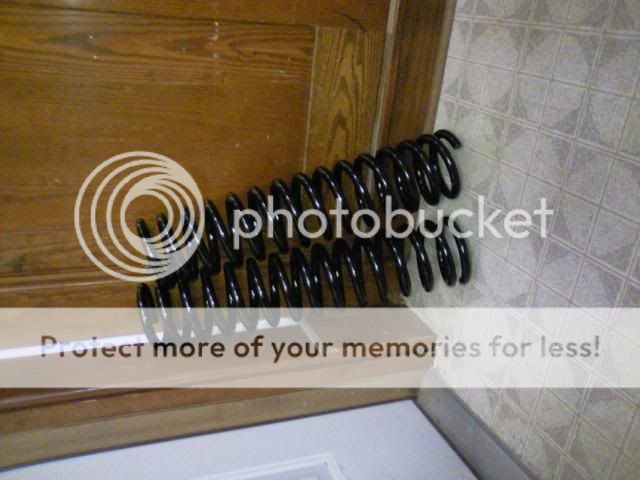

Found a set of Chevy 5.5" rear lift springs for dirt cheap. they look brand new.

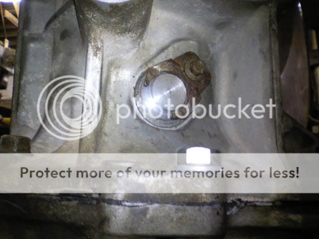

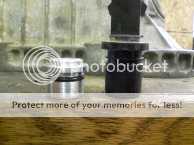

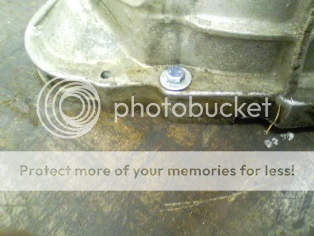

First off. Here is a pic of the plug I made to fill the hole from the unneeded speed sensor in the HD trans. I made it out of some aluminum round stock. it uses the stock o-ring and retaining clip.

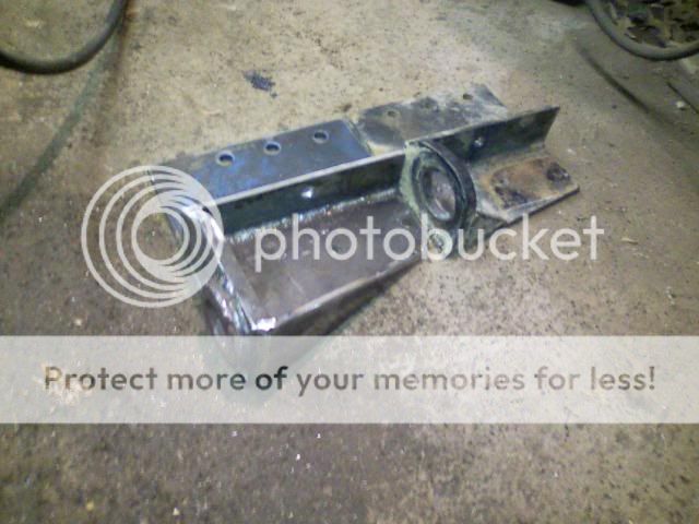

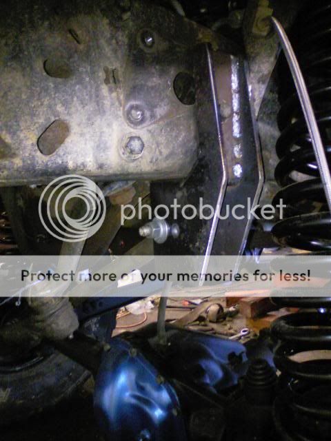

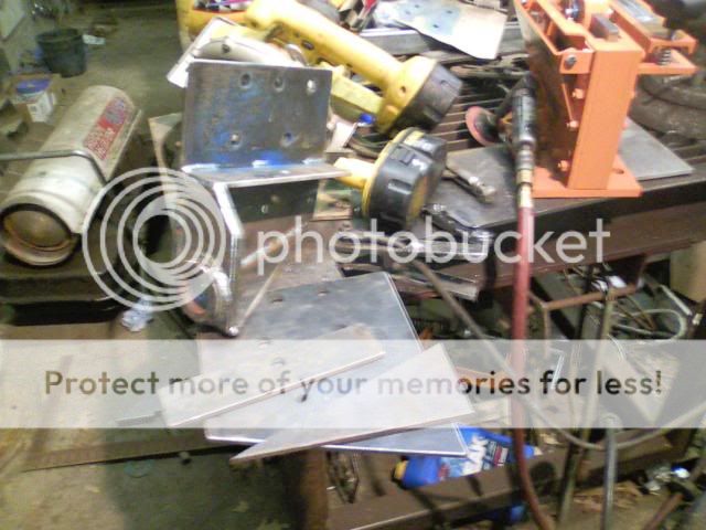

I made new RA brackets to push the axle forward a bit and lower the RA's for better caster angle.

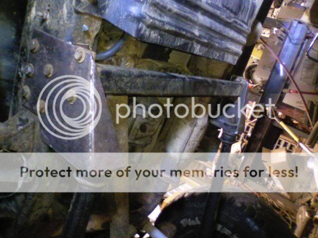

I made a track bar bracket that uses the rear steering box bolt and a grade 8 1/2" bolt through the bottom of the frame. I am going to use the stock EB track bar for now. I made the bracket with plenty of room for a longer track bar. I ran a string from the pitman arm to about where the drag link will mount on the tie rod, and its only about .75" longer than my track bar and I ran the track bar parallel to that.
I had an issue with my coils bowing really bad at first, but it turns out the lower coil seats were bent. I put them in the press and straightened them back out and then some to help keep the coil straight as the axle drops.

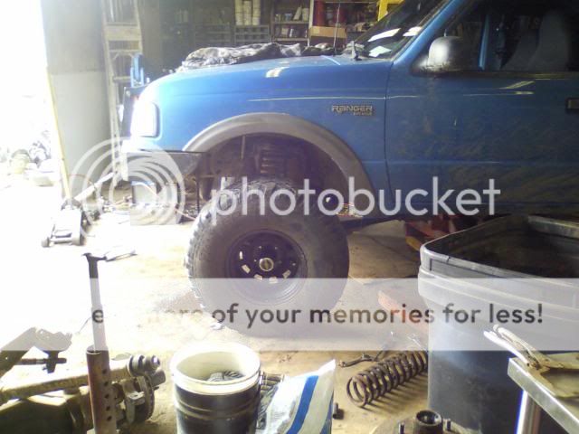

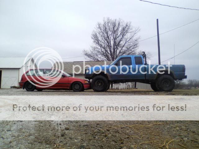

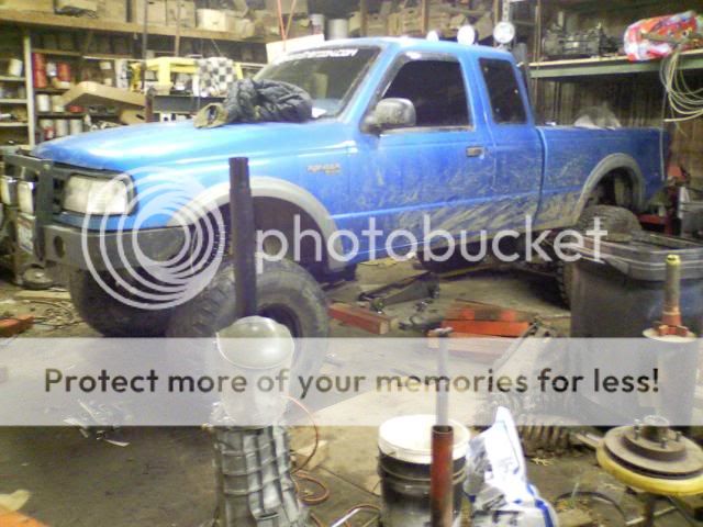

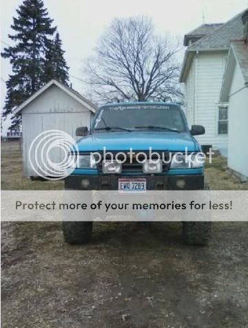

I forgot to grab a picture of the truck out in the open, so here is the best pic of the truck sitting at ride height I have. It will sit higher up front when I get the new tires back on. The worn out DC's are about 2" smaller overall than my Kevlars.

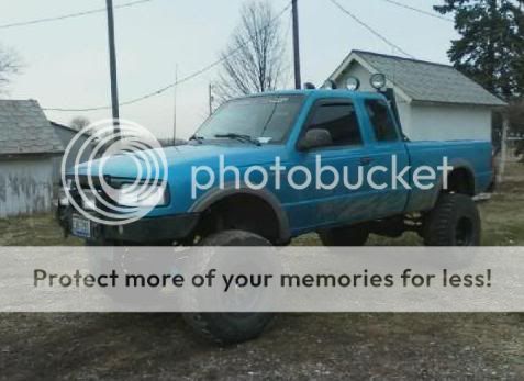

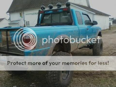

am a long time lurker here but man that truck looks identical to mine! i have a 94 ranger supercab same color as yours sasd with an ebd44 on 33 inch kevlars lol am gonna see if i can git a pic up here! your truck looks really good tho just a little taller than mine :icon_hornsup:

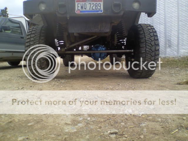

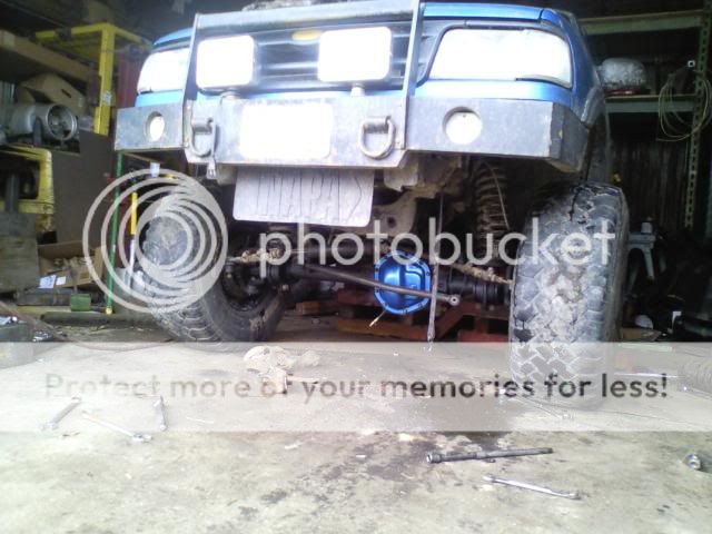

Steering is done..
I used 1.5" diameter .25" wall DOM for the tierod and draglink. I put the tierod on top of the knuckle and used 3/4 rodends. Everything is 3/4" grade 8 bolts except at the pitman arm. It is 5/8" grade 8 with misalignments, but the bolt is in double shear so its just as strong if not stronger than everything else.
35's look small now.haha Maybe I will look into some 4.56's and 37's next time.
