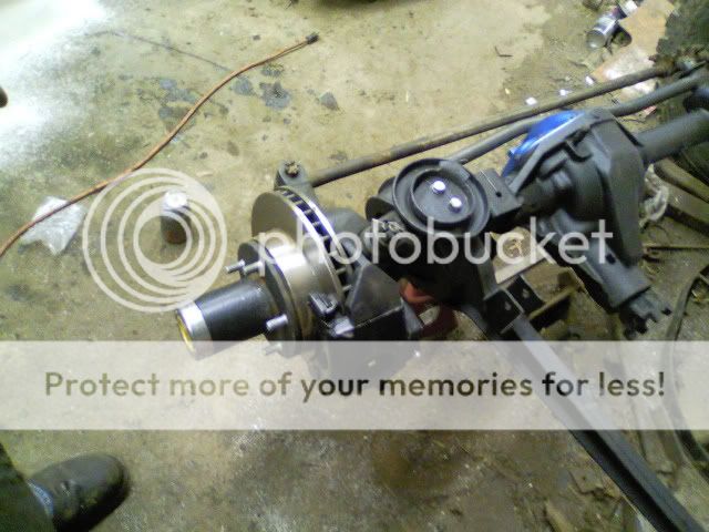

I wasnt planning on even touching it until summer.lol But as soon as I unloaded it I started cleaning it up and picking up parts. It will probably sit for a little while now. I have a few jobs to finish up before I will have the funds to pick up tubing and rodends for the steering linkage and wheels and coil springs.
I may get it under the truck by the end of the year, but I really doubt it.
I got the brakes on today, and man are they a tight fit on a 15" rim.

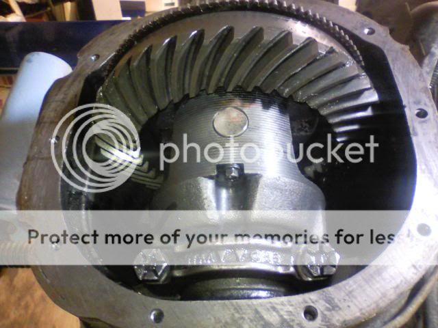

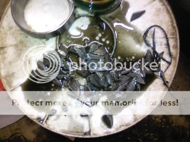

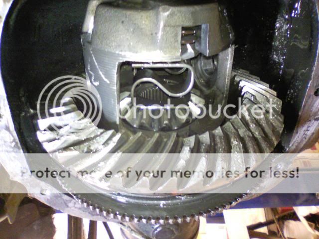

Turns out I should have put locktite on the bearing cap bolts.
Not too big of a set back. I picked up a lset of 4.10s from the JY for 25 bucks.:icon_twisted: The debri trashed every single bearing and seal in the rear end, so that wasnt cheap.
PlumCrazy's Build
I backed the truck in the shop and had it back on the road with new gears in less than 4 hours.

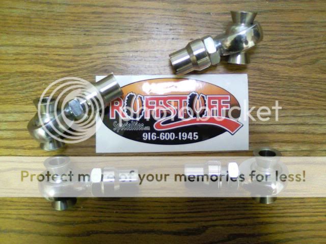

On a brighter note. The UPS man brought me these today. 3/4" rod ends for steering linkage on the D44. I will be running 1.50" DOM .250 wall. Going over the knuckle with the tierod.
