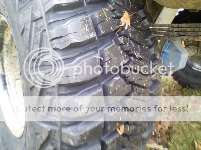

NEW MEATS!!
35" Goodyear Kevlars
-PlumCrazy
WOW....massive tire envy just set in......:icon_thumby:
the more i hear about/see them, the more i want them.....
l8r, John
Only put 500 miles on them so far, but I like them. They ride really nice for an aggressive tire. We just got our first snow, and they did awesome. I am hoping to get out and do some winter wheelin this week, bit idk yet. I am picking my axles today finally.

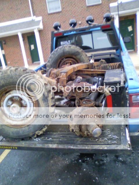

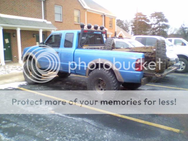

Christmas came a little early for me.
It was a little bit of a load on the poor Ranger.lol
Brought home my EB D44 and a full width 1/2 ton D44 to use for brakes and larger shafts. I was able to keep the RAs for both axles, and both drag link and the track bar for he EB.
They even let me have the mint pizza cutters and rims.lol
I also picked up some 8.8 F150 backing plates and new shoes to put on when I get my 5x5.5 axle shafts. I believe the F150 drums will provide more stopping power than the tiny Explorer calipers did anyway, not to mention a stronger p-brake.lol I think I will be able to run the 150 p-brake cables if I move the mount forward a few inches and take off the extension that added to the main cable to make the Expo p-brake work before. Im still waiting for my buddy to dig them out at his shop so I can a good measurement off of them.

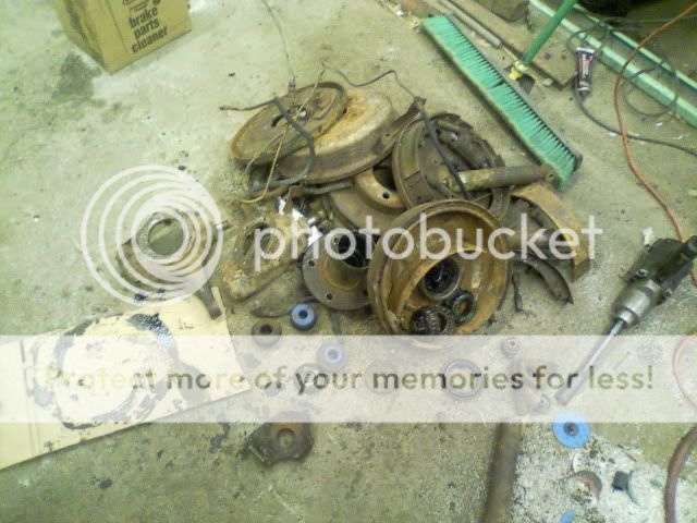

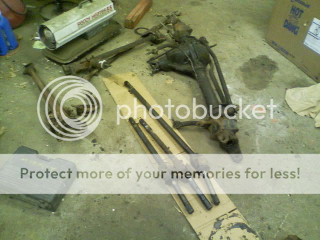

Made some progress on the axle today.
I pulled all the old drum drake crap, radius arms, steering, and shafts. the I cleaned it all up and sanded it down.
Ready for paint
I also stripped down the the full width and cleaned up/ inspected the hubs, spindles and radius arms.
I found out that one of the RA's from the EB D44 was tweaked, but luckily I got extras with the full width.
Looks like the bearings were replaced/repacked right before the Bronco went to the JY.lol The lockouts appear to be like new as well.
I plan on running the stock 66-75 EB steering for now since the tie rod appears to be almost new and straight. I ordered a set of bushings to adapt the F150 taper to the smaller EB tie rod ends. When I bend it or it wears out I will probably build a drag link and tie rod with something beefier. I also ordered some Caster correction C-bushings and track bar bushings. This way I dont have to have the RA mounts hanging way down to keep a decent caster angle.
Got the D44 all primed and painted. New balljoints are in, new Cbushings and track bar bushings are in, new bearings, seals and rotors are on. Calipers and pads should be on tomorrow. I am going to order some 3/4" rod ends here soon and some .25" wall DOM to make an over the knuckle steering setup. I was going to run the stock EB steering setup, but after getting averything bolted up it just looks so low. I would hate to see my tierod get wasted on the first run out.lol All I need to do is find a set of wheels and some coils springs to get this thing under the truck. I will worry about getting the rear switched over after I get all the kinks worked out up front. Still not sure if my current RA mounts are going to push the axle far enough forward to clear the fenders the way I would like.
Here is a pic before the knuckles went on.
