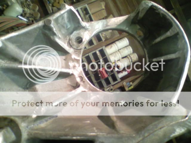

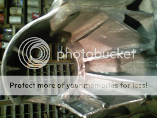

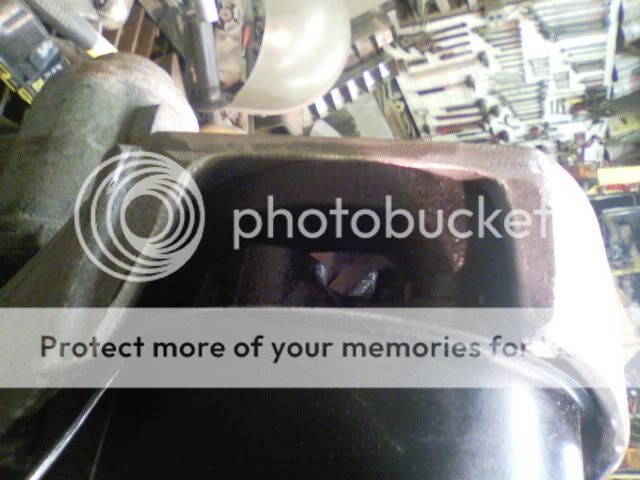

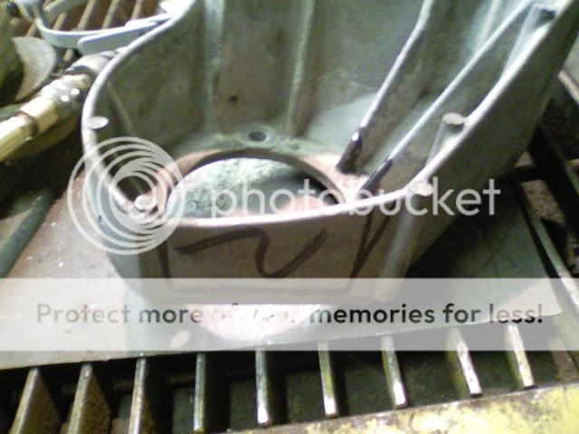

I beleive the only difference is the extra hole in the bell housing that allows for it to be bolted to the OHV or SOHC 4.0. The SOHC 4.0 doesnt use the top passenger hole because there is and oil passage or something (might be the timing chain) where the bolt hole needs to be, so they moved it down 3" or so.
If you look at the picture of the bellhousing you can see there are two holes close together on the top left, the regular 4.0 M50D doesnt have the lower hole.
I have only pulled the top cover off the HD so far and it appears to be the sam internals and gearing as the reguler 4.0 M50D.

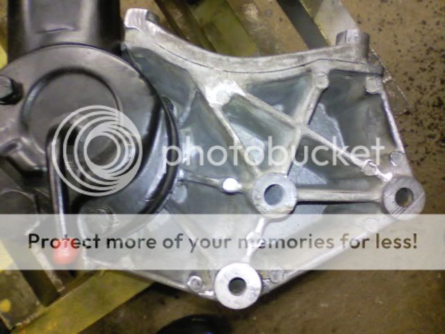

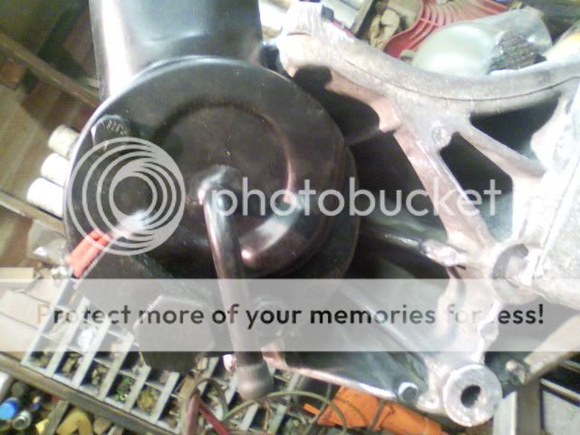

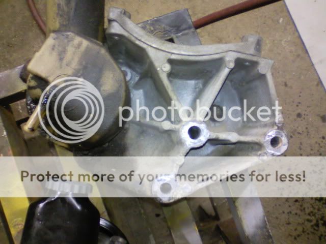

I replaced my PS pump with a saginaw pump.

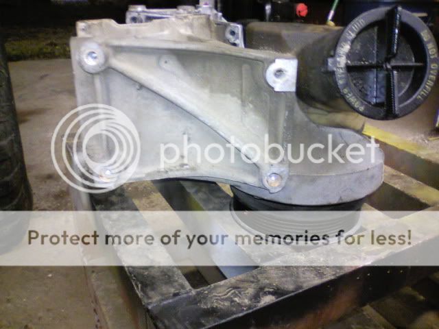

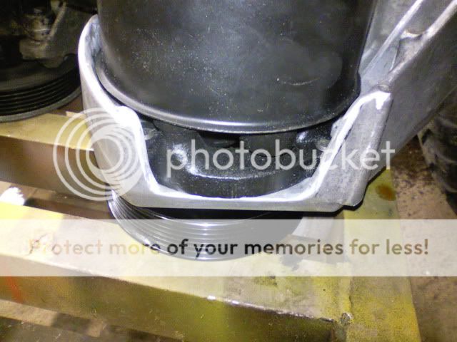

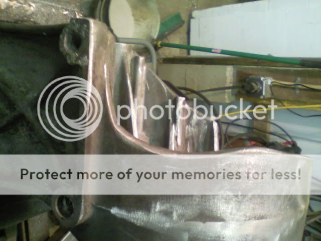

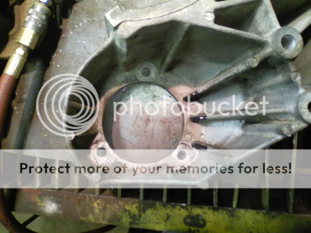

The full circle 4.0 bracket requires a bit more clearancing than the 2.3 and 3.0 brackets. The part that actually bridges the gap must be trimmed down so only the "face" of it remains, then you have to nip the end off of a few ribs and trim the top edge to clear the reservoir.
Here are some comparison pics
The full circle bracket also has alot more webs in it that were deleted on the newer bracket:dunno:.

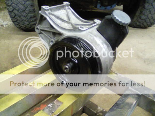

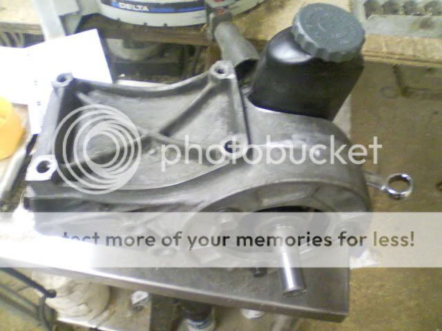

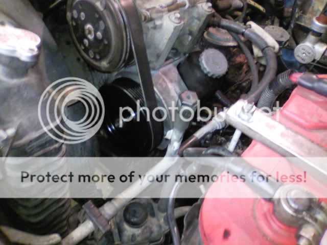

After I bolted the pump to the bracket and installed the pulley and them bolted the whole thing on the truck. It worked out pretty well.
After I got the pump on and filled it up I discovered that I should have taken a closer look at the hose fittings. Apparently the Saginaw pump is made to recieve a line with a straight end and oring and the newer Rangers use a goofy line that is made to seal using a nylon ring on the tube nut. The threads are the same, but it wont seal.lol To make it work on the newer Ranger, all you have to do is pick up a High side line for an older Ranger. I bought a new one for an 85.
Here is a comparison. The new line is style you need. The block above the fittings is where the hose goes into the pump (it is held to pump with a Banjo bolt ans sealed with copper washers)

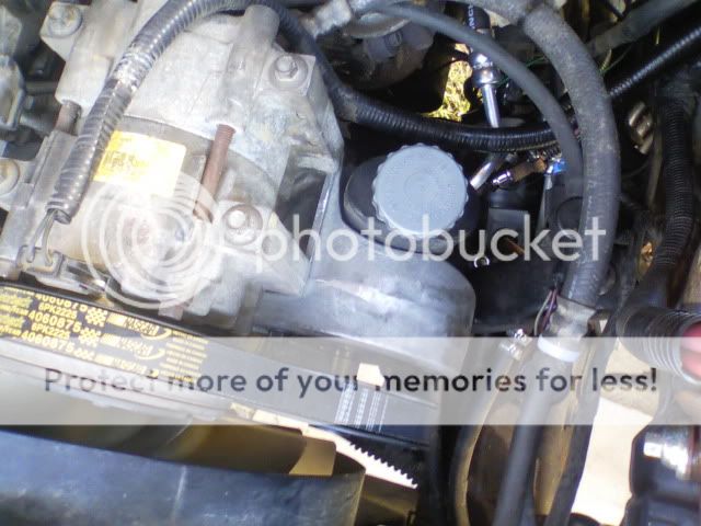

Here is the finished product.

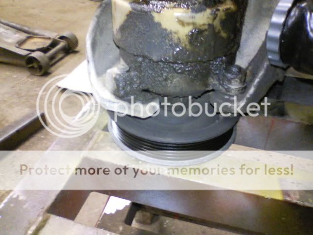

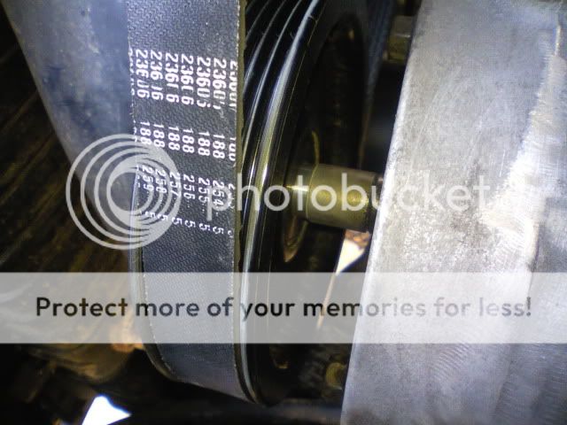

Also. When installing the pulley on the Saginaw pump, dont press the pulley on all the way the the "step" on the shaft. Leave about a 3/16 gap. If you push it too far back it will throw the belt out of alignment and sqeal like a MFer.

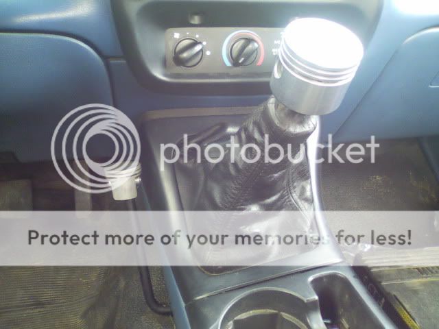

I just realized that never posted apic of my S10 shiftboot. I pu it on like 8 months ago.lol I used a boot from a late 80's early 90's S10. It looks leather, but is actually rubber just molded to look that way. It really looks like leather too, my dad has had an S10 with the same boot for 3 years and I always thought it was actually leather or vinyl.lol
I just trimmed the lower section of the boot off and stretched it over the top flange of the original Expo cubby hole that was cut off when I made my first boot.

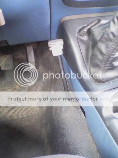

And here is one of the tcase knob.
