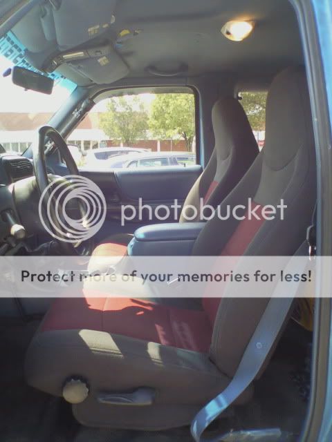

I finished putting in the seats and gave them a good cleaning. I love the lumbar support. IMO these are a major improvement over stock Gen III seats. My back feels better and I have only had them in for 2 days.lol They really dont match, but the comfort out weighs the looks. The red seats are kind of growing on me, but I would still trade for blue or black in heart beat.

I finished putting in the seats and gave them a good cleaning. I love the lumbar support. IMO these are a major improvement over stock Gen III seats. My back feels better and I have only had them in for 2 days.lol They really dont match, but the comfort out ways the looks. The red seats are kind of growing on me, but I would still trade for blue or black in heart beat.
-PlumCrazy
Those seats are really sick. Do you sit with the seat that far forward lol?
Not quite that far, but close. Im only like 5' 5" .lol

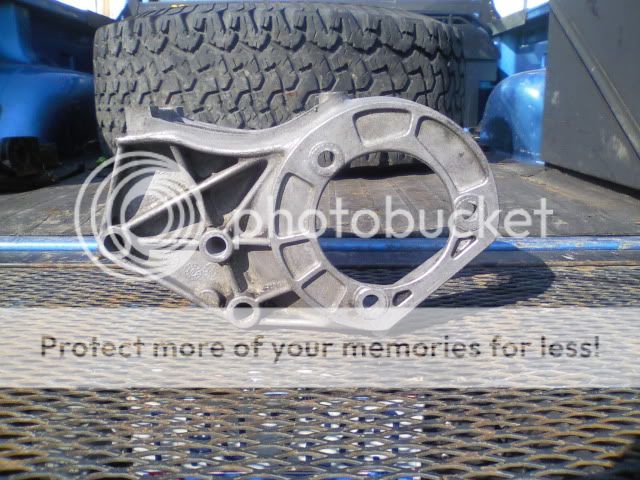

I picked up this today.
Full circle power steering pump bracket in preparation for a Saginaw pump.

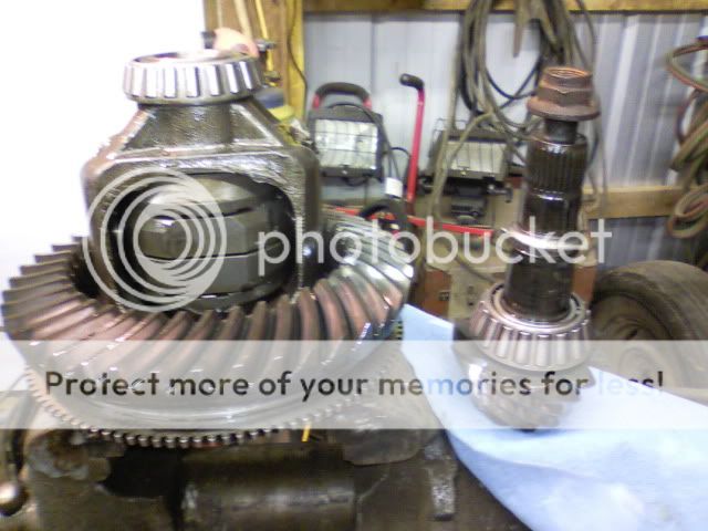

I got my 4.10 ring gear bolted on the open carrier with red loctite and I got all the new bearings pressed on and ready to go. Heres a pic with the locker sitting in it.
Hopefully I will have time to get them in before I head back to school.

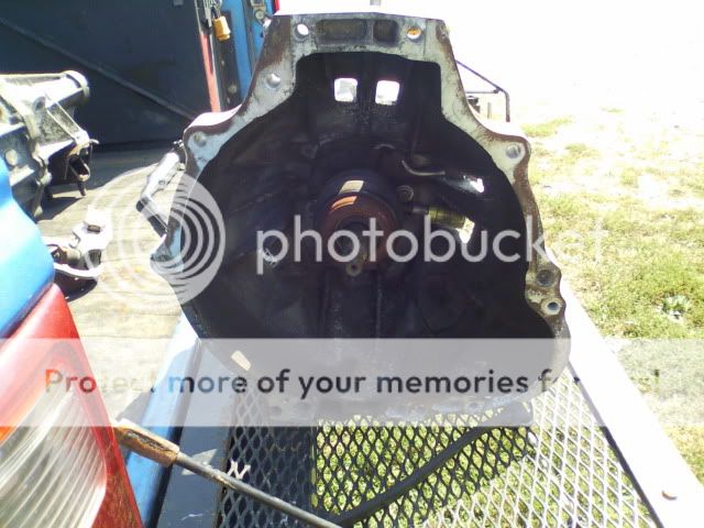

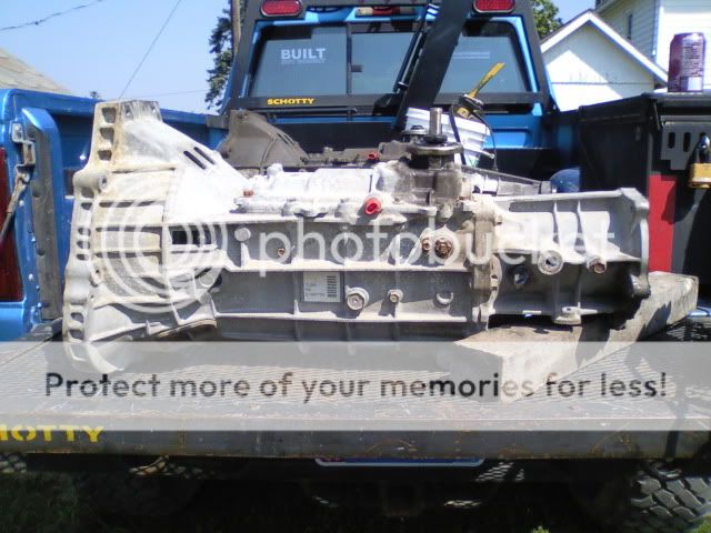

I picked this up today at the JY.
Yea. Thats an HD. I pulled the top cover off, and from what I can tell its the same internals as any 4.0 M50D. I counted teeth on the input shaft and its the same tooth count as my old 4.0 input. I dont really need the HD case, but I needed a good low mileage 4x4 mainshaft for my rebuild, and it just so happened to be from an HD. I will probably rebuild it with lower gears that way I can just swap out my noisy trans with little down time and not have rebuild my only trans. I will probably stick the HD guts back into my old 4.0 case if so anybody needs a 4x4 4.0 tranny. Ill have one soon. I still need to find some low mileage internals from a 2.3/2.5/3.0 tranny though.
