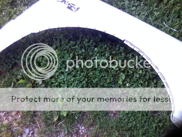

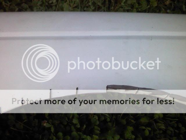

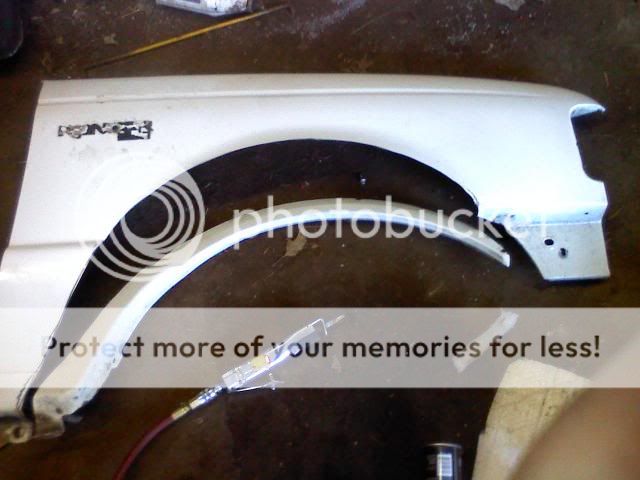

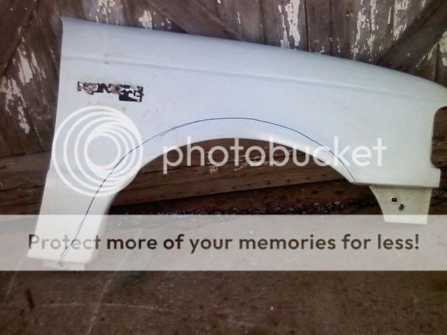

I decided to try my hand a cutting fenders. I just used an extra fender I had laying around. I cut out about a 1/2 smaller than what I wanted to end with, then I cut reliefs all the way around and bent them in and welded them up. I plan to bolt on some Pacer flexy flares.

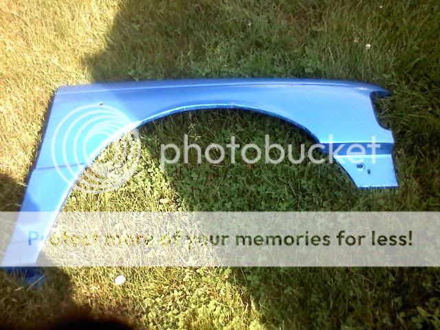

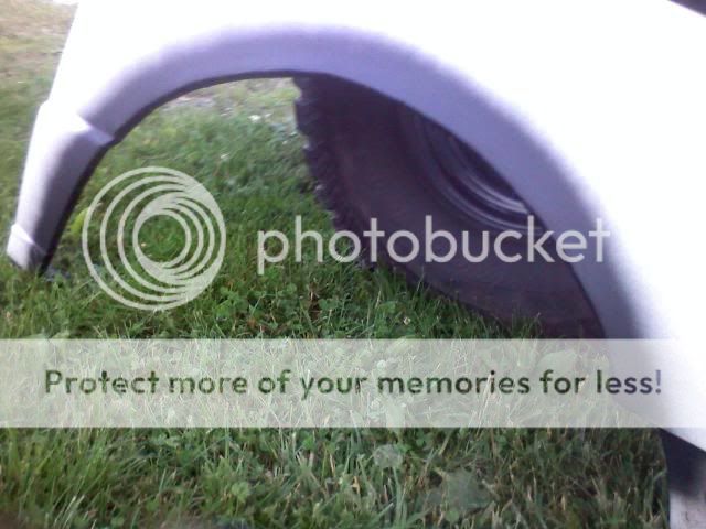

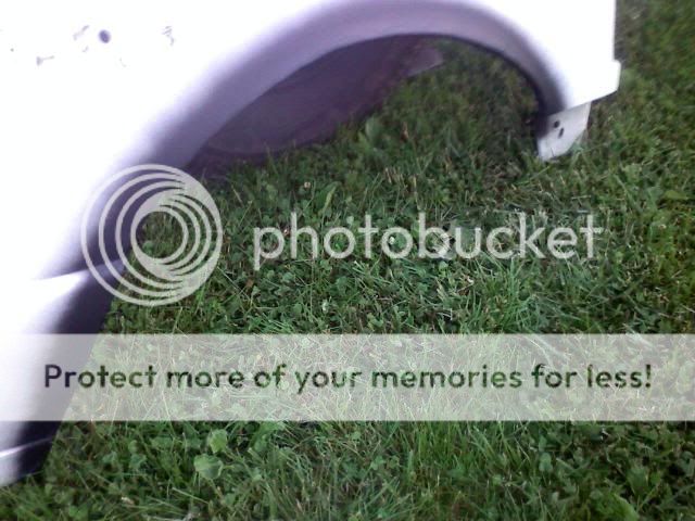

I rattle canned it with some paint I bought off the clearance rack at Advance, and it matches almost perfect and it looks like about like factory. I am going to throw some clear coat on it so hopefully it doesnt fade to bad in the sun. I havnt bolted it up yet, so I am not 100% sure what I am doing with the inner fender yet. I cut enough out to clear the 35's with my current lift. I know I could clear 35's now, but when I put a tire on I want it actually clear when the truck isnt on level ground.

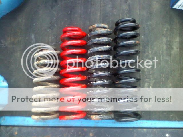

I finally got a set of 6" SkyJacker Softride coils. I put them on with the 2" spacers. I think with the added wieght of the SuperCab and bumper I have about 7" of lift. The coils were used, so I think they have already settled.

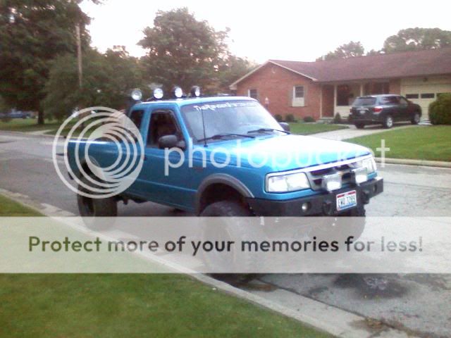

Heres a crappt pic of the new lift and 35's. There is a load of folding chairs in the bed, so it leaning back a little. It sets with a little rake when its empty on level ground:headbang:.

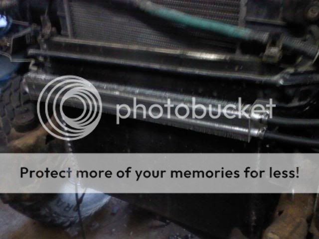

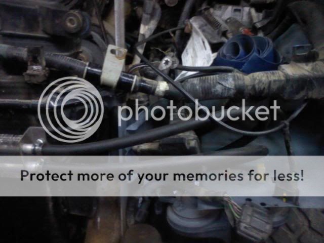

I picked a power steering cooler for dirt cheap (10 bucks) so I figured I would give my stock pump a fighting chance.

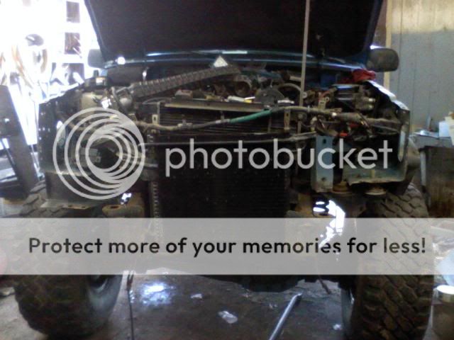

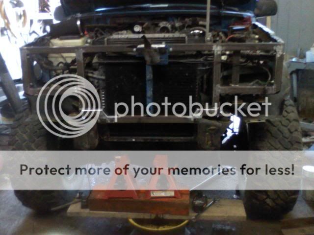

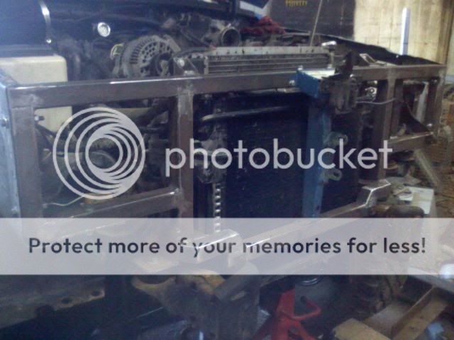

I was going to just mount it behind the grille and be done, but we all know how my 30 min jobs turn out. I knew my front body mounts were in bad shape since the bottom bushings were missing when I bought the truck and the core support had some cancer around the mounts like most Gen III Rangers do. So I figured that since I had the grille out it would make since to go ahead and pull the fenders, header panel, and cut the old core support out.:icon_twisted: I priced out a new core support and it wasnt too terrible (100 bucks), but it would take two days to get. Then I found a whole stick of 1.5x1.5 box tubing I bought a while back (to make sliders.lol)
Cancer. Im sure I could have just cut out and fixed it, but my way looks way cooler.:D

Halfway there.

Cooler.

I just cut the metal part of the low pressure line and cleaned it up with emery cloth and double clamped some transmission cooler line on.

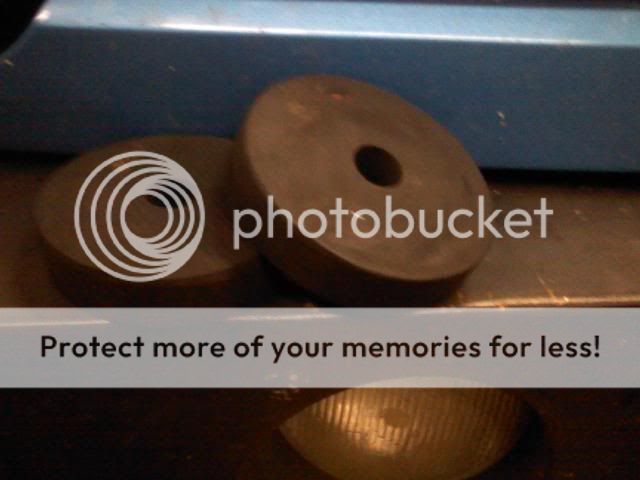

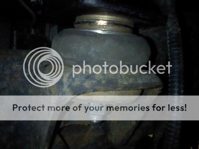

When I welded on the lower mounts I didnt take into acount how much the rubber bushings would settle, so I had to shim it up. I used 5/8 washers for a temp fix, but they looked cheesy.
PlumCrazy's Build
My solution.:icon_twisted:
PlumCrazy's Build
I cut about a 1/3 off a hockey puck to get the thickness I wanted and then drilled a hole it the middle. They turned out looking OEM.lol

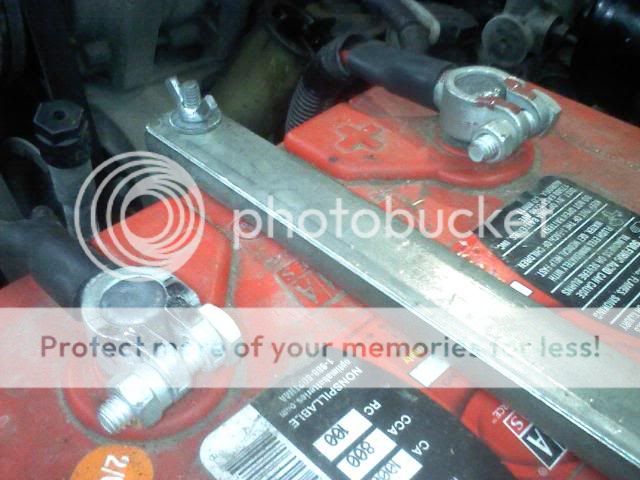

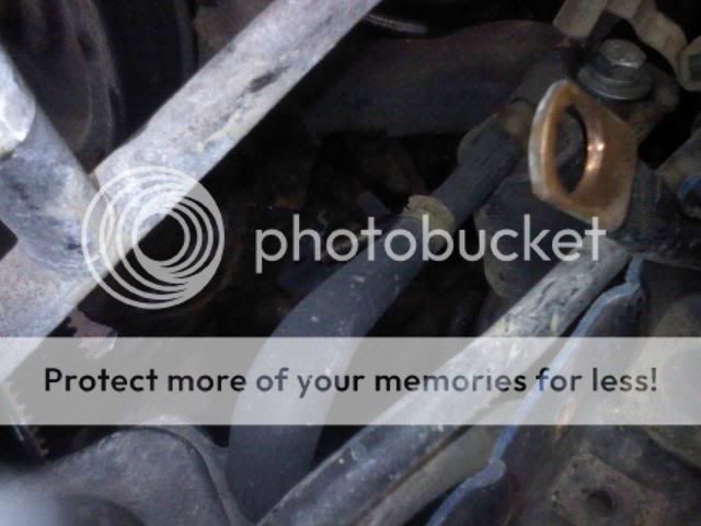

My battery light has been flickering every now and again for a while and I couldnt figure out what it was for long time. It turned out the stupid zinc coated flimsy battery cable ends were damn near corroded in two under the insulation. I picked up new bimetal ends and crimped them on and used some badass heat strink tubing that has some sort of glue built in that seals everything up when it gets hot. They look better than stock imo.
