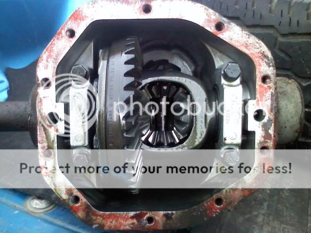

Just noticed something though, am I reading that ring stamp right? Does it say 41 11? That's ring and pinion teeth numbers. 41/11= 3.727 rounding up to 3.73. I hope I'm wrong. Trying to save you major trouble.
A 4.10 chunk would have a 41 10 on it.
That's a true D35. Trust me, they are obviously different.
A 4.10 chunk would have a 40 10 on it.
It says 41 10, the 0 isnt stamped fully into the gear. Its hard to see in the pic. Look at the axle tag. and I know the rear axle deff had 4.10s.

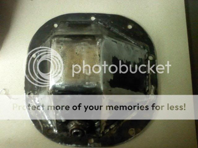

I welded it all up tonight. I still have to nip a little out of the welds around the holes to ensure that bolt seats correctly. With all the heat from welding the 1/4" plate the flange/mating surface warped a bit, so I still have to work on getting that straightened out or I will find a spare 8.8 axle and see if it will draw down on when its bolted up. I filled it up with gasoline and let sit for a few hours to see if I got it all sealed up. It seems to be good to go.
-PlumCrazy

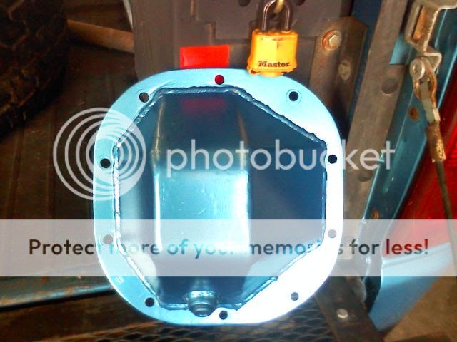

I finished my diff cover too, but I didnt get any pics of it. It wont be going on until I get the 4.10's in and buy the 60 bucks worth of fluid.

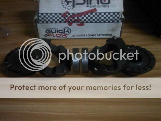

Well. I was planning on rebuilding my Trac-Lok when I drop the 4.10's in and put the new cover, but I was looking around a rebuild kits and they seem to run 75 bucks or more, not to mention they require Synthetic fluid which is a bit pricy. Soooo I went another route and picked this up. The 4.10's came with an open carrier, so all I need to pick up are some new bearings.
This way I can run a synblend fluid and dont have to worry about those silly clutch discs.:icon_twisted:
I finished up my cover too and shot some paint on it to match the front skid. I also picked up some longer grade 8 bolts. They use a T45 torx.
-PlumCrazy

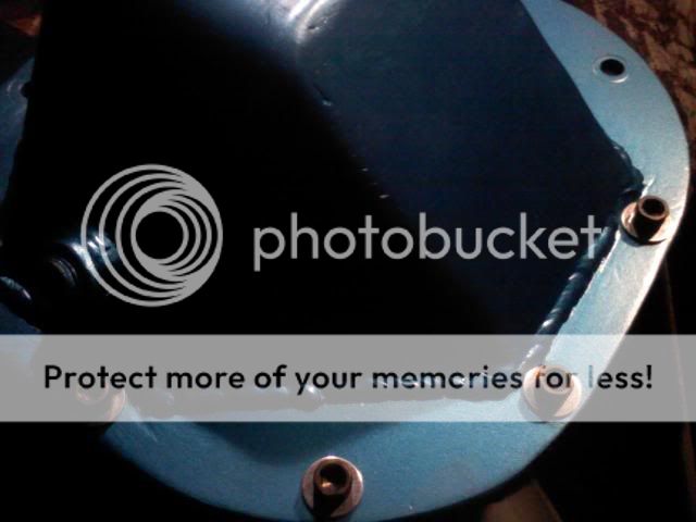

Where on earth are you finding the weld in bungs?
I've been almost everywhere and nobody seems to know what i'm talking about.
They just look at me like I don't know what I'm talking about.
I just settled for an actual drainplug that I could weld in.
I cut a pipe coupler in half and welded the cut end on.
Trac-Locks don't require synthetic. You can run conventional, just be sure to put the additive in.
There is a reason Ford put that tag on there. The clutch discs will last a lot longer with full synthetic. I could run the conventional oil and the let the clutches wear out prematurely and become an open diff again, but there is a reason a put the the L/S axle in there.:icon_twisted:
-PlumCrazy
-PlumCrazy
that is weird , because both my Trac-Lok's call for 80W-90 with additive , where as the Zexel-Torsen in my Level II calls for 75W-140 Synthetic ( which is harder than hell to find ) :icon_confused: :icon_confused:
