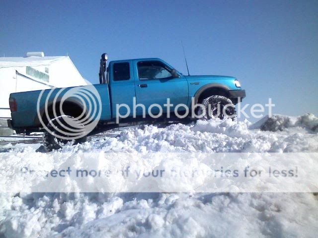

I played around a little more in the snow

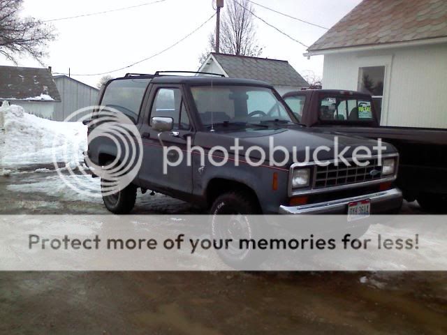

And my bosses BII that I putting new pans in. He offered it to me last year for 800 bucks, but I didnt want a BII then. Its actually in good shape there is no rust on the wheel wells or in the door jambs. Kinda want to buy in now.lol unfortunately it has a D28 and a tired 2.9/A4LD.

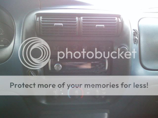

I finally got around to installing my new radio bezel with dual 12v outlets. *When I found it at the JY I was so excited it took me forever to find a decent one outlet 2wd bezel with no extra buttons/switches. *This one is flawlass and the vents dont flop down like my old one and the rubber coating/paint isnt all scuffed up. *I pulled power from on of the extra mini fuse slots in the fuse box I added above the glove box.

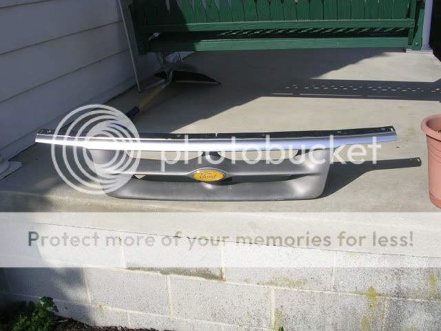

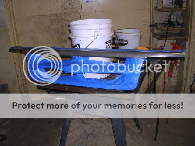

I also decided to sand down the fading chrome above my grille and shoot it with some spray on chrome. *I picked the paint up cheap and I honestly doubted that it would turn out any brighter than silver spray paint. *But it didnt turn out to bad. *I sprayed it down with adhesion promoter prior to the chrome paint, then I plan to spray some clear over it when it is good and dry.
Before
PlumCrazy's Build
After
PlumCrazy's Build

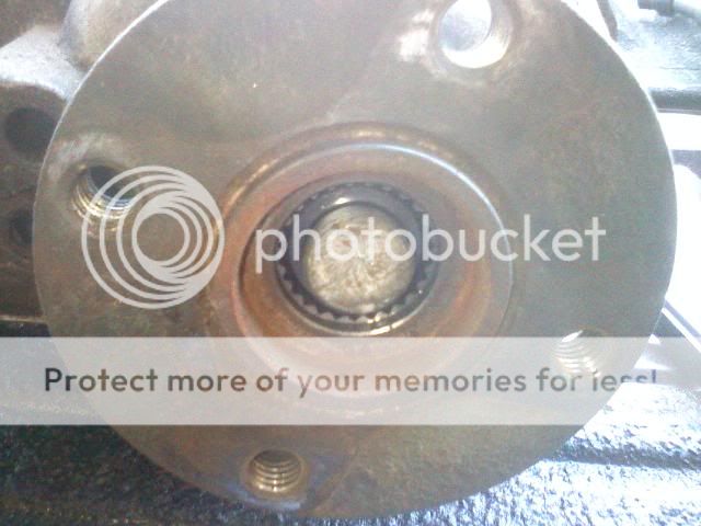

When I grabbed the shaft, this fell off. I just got back from a 2hr trip that I was hitting 75 mph+.:shok: Yes, that is the rear output shaft on the Tcase that is snapped off.
PlumCrazy's Build
PlumCrazy's Build
The only thing keeping the flange on the shaft was the springiness of the slip yoke boot.

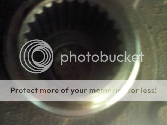

Here is a pic of the break.

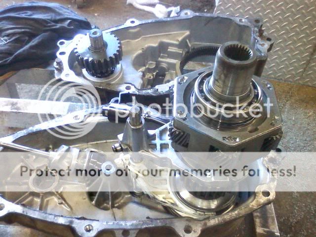

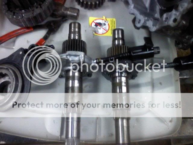

I pulled my 1354M apart and swapped the planetary and output shaft from my 1354E.

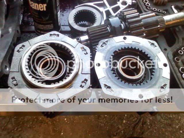

I found out after I got the whole case back together that when swapping a 6 gear planetary into a case that had a 4 you also have to swap the first shift collar and shift fork. The one from the 6 gear is longer. So in the end I had to swap the planetary, first shift fork (the hi-low), the first shift collar, and the output shaft (w/ the oil pump) from the 1354 electric. The ring gear for a the 4 and 6 gear are also the same.
I kinda got excited and didnt take any pictures of the 1354M apart. But dod snap one of the electric case.
PlumCrazy's Build
here are the two output shaft/oil pumps.The 1354E on the left, the 1354M on the right.
PlumCrazy's Build
Here is a pic of the 6 and 4 gear planetary side by side.
PlumCrazy's Build

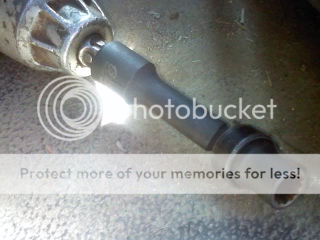

I finally broke down and bought a Ford driveline socket. its is a 12 point 12mm impact socket on a 1/2" wobble extension. For anyone who has ever had to take the 12 point bolts out on a Ford will appreciate this. It was the best 15 bucks I ever spent.

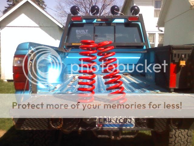

Oh and the UPS man brought me some goodies today.:yahoo: SJ 6" coils. Now I can swap out the stiff 4" coils/ 2" spacers. I think I will run a 1.25" spacer under the 6" coils.

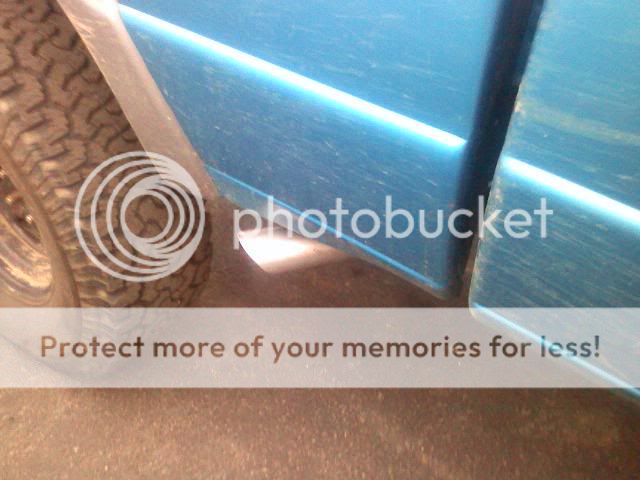

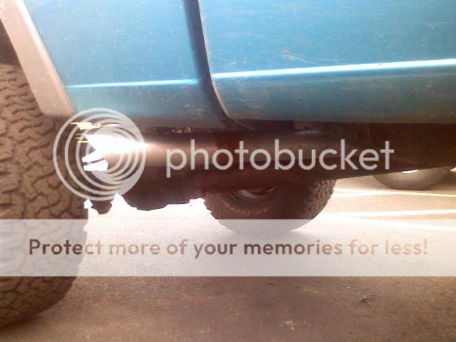

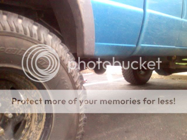

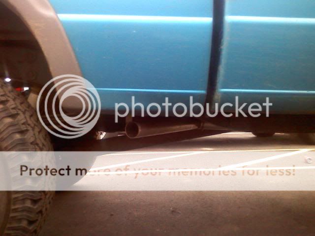

I had a little extra time on my hands, so I fired up one of the welders at school and welded up a new exhaust. 2 1/2" pipe with a 45* that brings the pipe out in front of the rear wheel. It comes out in the same place as before, but now it lacks a muffler:icon_twisted:. It is actually really quiet for a straight pipe, I can hardly hear it at idle and when I get on the skinny pedal it has a nice deep tone.
PlumCrazy's Build
PlumCrazy's Build
Here is a mock up of how the 3" tip will look. It will extend from the 45* to the edge of the body. I think I will shorten it up a squeak so it sits flush.
