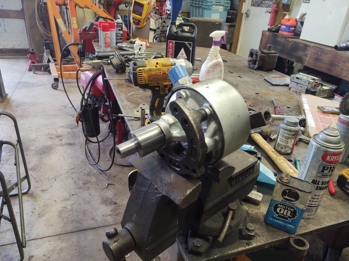

Was using the Ranger to tug stumps out this summer when something I have feared for a long time finally happened.....damage to the discontinued "Severe Duty" bolt in Ford application Saginaw pump. It sheared the shaft off in the pump.
It sat for a while before I drew up an adapter and had a buddy 036Speed machine it for me. Got me back in business and now I can use an off the shelf PSC Saginaw pump and simply press the adapter on and swap the rear fitting.

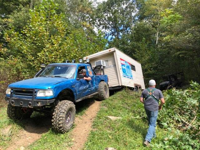

Got it back together just in time to drag an old office trailer down some old logging trails for a buddy to use as a temporary cabin on his new property.

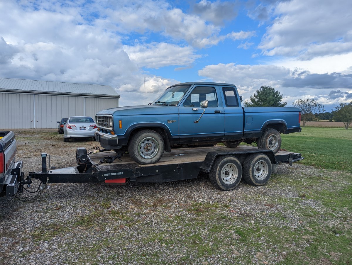

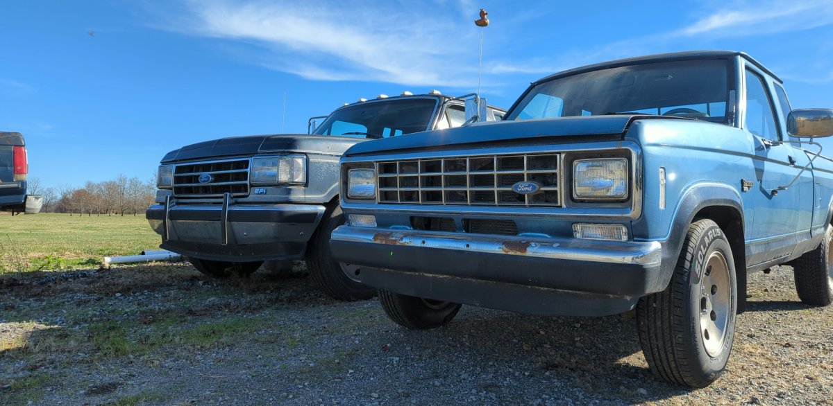

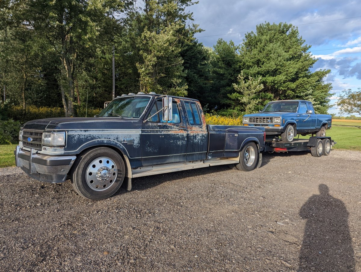

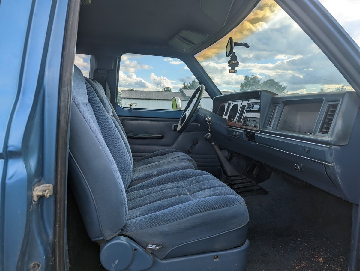

No updates on the 4x4....but I did drag home another Ranger. Plan is to throw drop beams under it and flip the rear axle once I get a good running 2.3 back into it.....maybe play with a TurboCoupe setup down the road.

No updates on the 4x4....but I did drag home another Ranger. Plan is to throw drop beams under it and flip the rear axle once I get a good running 2.3 back into it.....maybe play with a TurboCoupe setup down the road.View attachment 85194View attachment 85195View attachment 85196View attachment 85197
The turbo coupe 2.3 has been a dream of mine for quite some time! That sounds like such a fun engine. If youwereon the west coast I have seen one on CL for a while.
