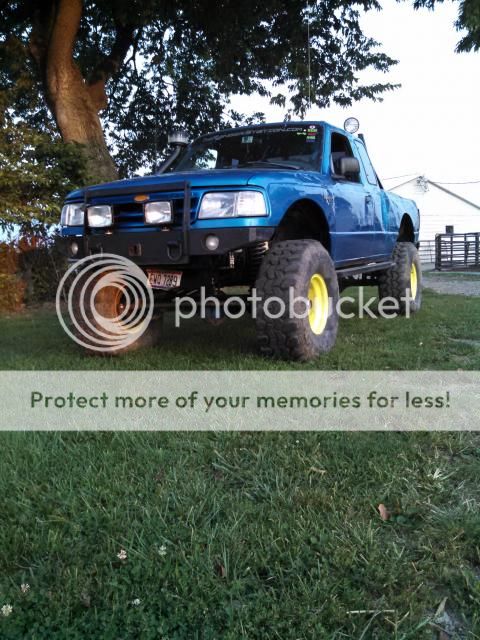

I'm diggin the black on green wheels! Lookin good man!

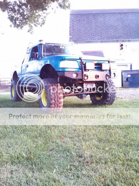

Basically no progress on the Ranger in the last couple weeks...my focus switched over to the OneFiddy after seeing so many clean OBS trucks at the Carlisle show and hardly any 80-86 trucks...

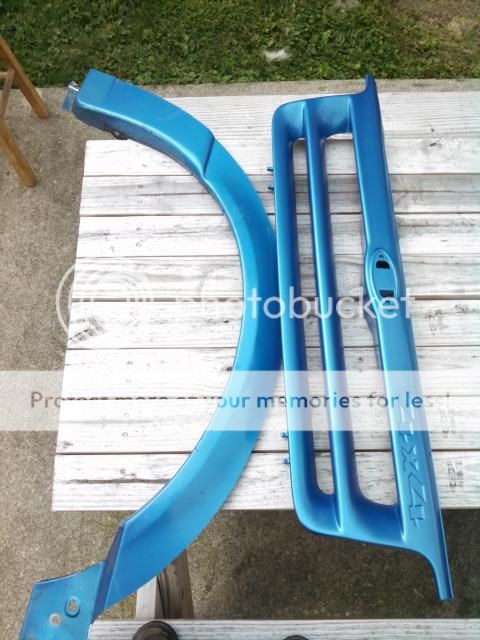

I did paint my extra grille..
Spray bombed with some GM touchup paint. It matched my OEM paint pretty well...
There is a paint store here in Newport that if you take them the paint code off the door, they can mix up a spray bomb of your paint color. it cost 20.00 for a can unless it's Red, then it's 25.00.

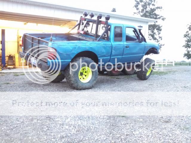

Did my best with the ole volley ball to get the bedsides popped out and stuck a new tail light in the driver side, then I ripped off the flares and hacked the fenders out. I did bother to roll the lip under since I plan on ditching this bed before too long. Also with the rust I found and the inner bed side would have made it hard to do anyways.
I was able to just re-drill the corners and tweak the old bed supports over enough to brace it back like stock.

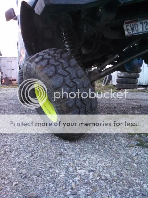

I had ordered some Long field solid joints for my 44, but they kept getting put on back order week after week, so I canceled the order a while back and bought the RCVs with the money and planned on just rocking the 760X joints and chromos until the HP44 was done.....
But...then I bought the 38.5s and REALLY wanted to wheel on them...so I bought some OX super joints last night in hopes of getting a few runs out of the EB 44 with the 38.5s...
I am planning on wheeling PA with Onebadexpo Labor day and would love to test out the new joints and tires if they show up in time...but only time will tell.

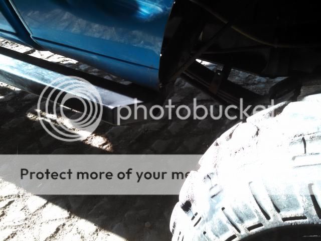

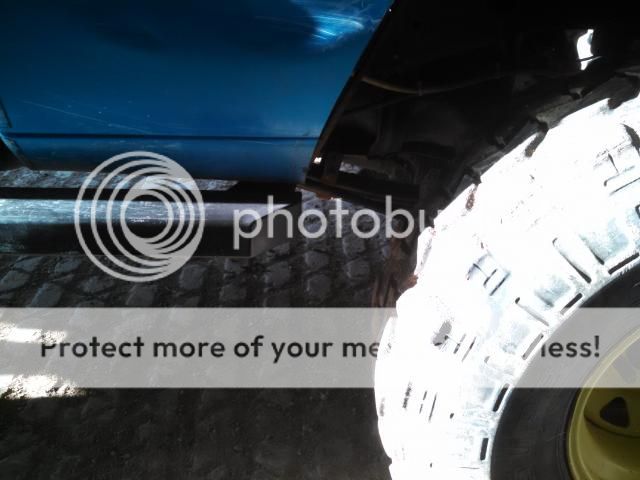

Trimmed back the sliders to match the wheel well and capped them back off. I wish I could have trimmed more, but the rear most mount limits me...
Should be plenty of room for 39s..Hopefully my OX joints show up in time to install before Labor day weekend. I am itching to try these 38.5s

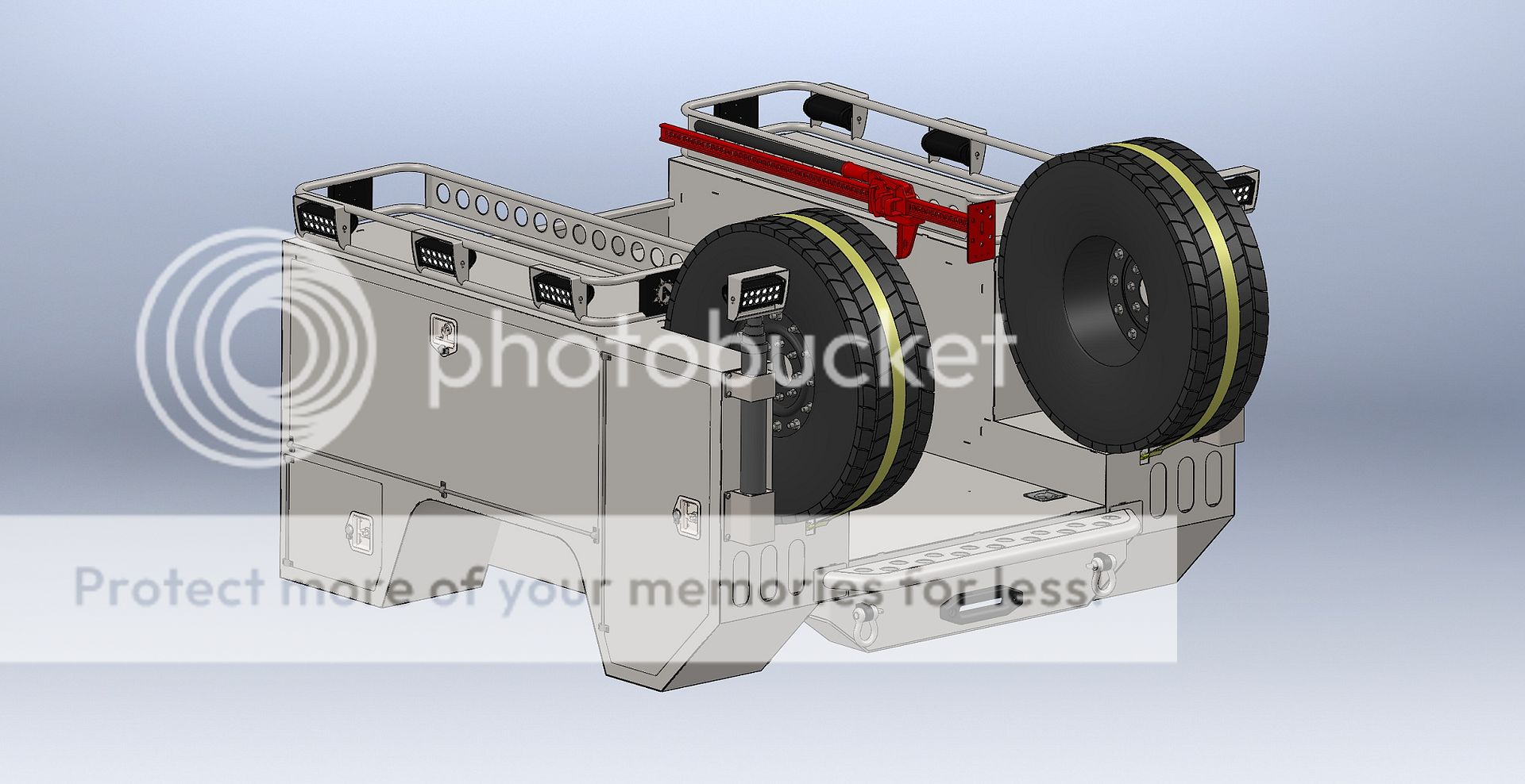

The more I look around.. the more I want to find a compact truck service body for the Ranger...I can bump up to 3/4 ton Chevy leaves to compensate for the weight and carry all my spare parts and tools that I normally have to strap down in the bed anyway.
Basically a mini of this setup..
Stolen from this Pirate tread...(Damn Brad giving me expensive ideas all the time.....lol)
A Minnie service body would be sweet! But how long would those door stay on? Unless u put some kind of tubing to protect the body of it.
There is a second gen Ranger down the road from me that is sitting in the weeds with a small service body on it.
