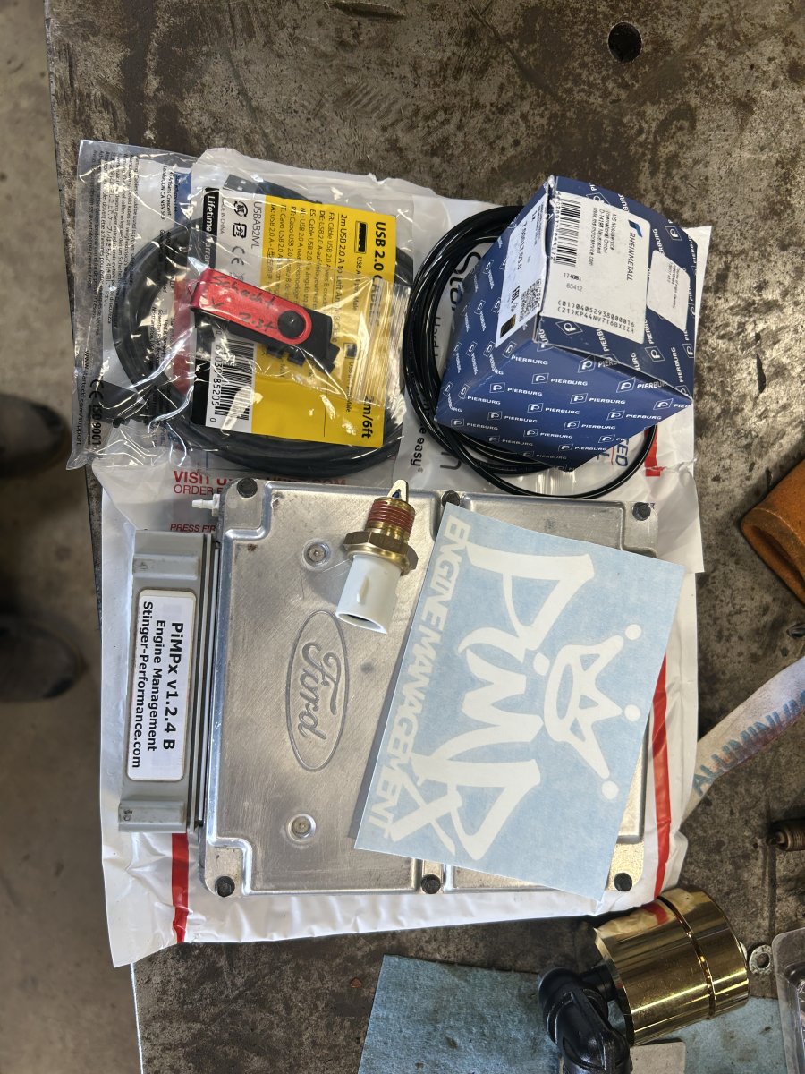

Most important piece to the puzzle arrived today!

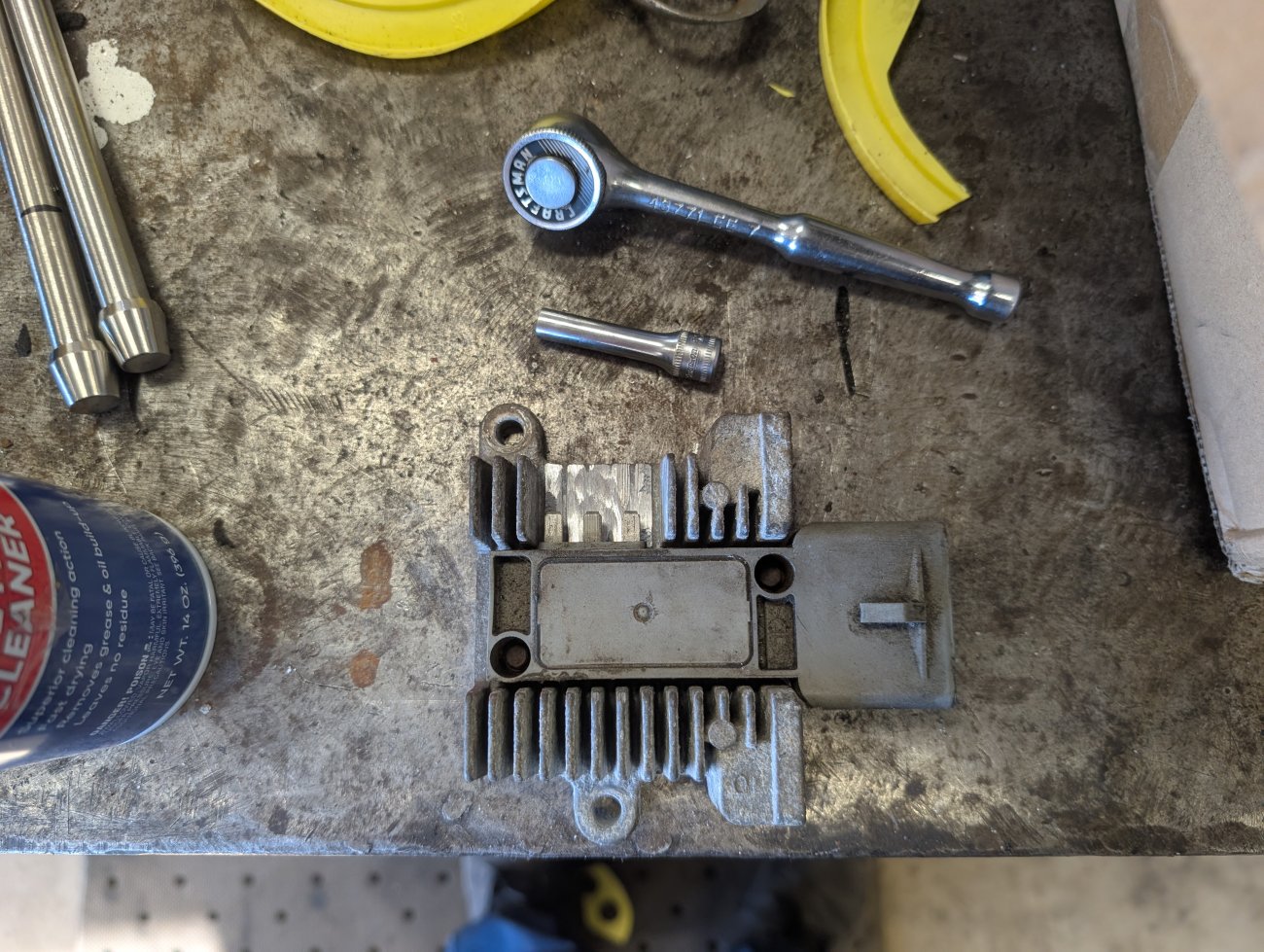

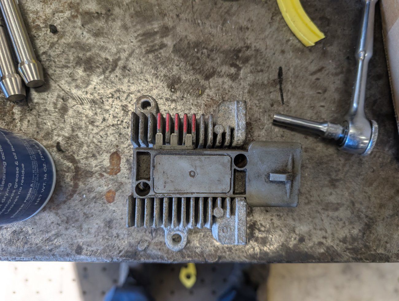

Well....I fell behind on this project, but it'll back on it soon. Was driving it on the night of 4th of July and the TFI bit the dust on our way home from dinner. Thought it ate another distributor gear, but that was not the case. I haven't had a distributor mounted TFI fail on a 2.3 before, normally just an issue on the V8s in my experience. Drug it on the trailer at 1am after watching fireworks from our prime roadside spot and then let it sit in the driveway in timeout for a few weeks before I diagnosed it.
Picked up a TFI heat sink from an OBS truck and removed a few fins for the Hall effect sensor wires.
I was going to extend the wires and get this mounted up ASAP....but decided to wait until I gut the harness and rearrange it for the PimpX install. Which will hopefully start this fall. I have an 8.8 to build for the car and a frame to patch up on my winter beater first.

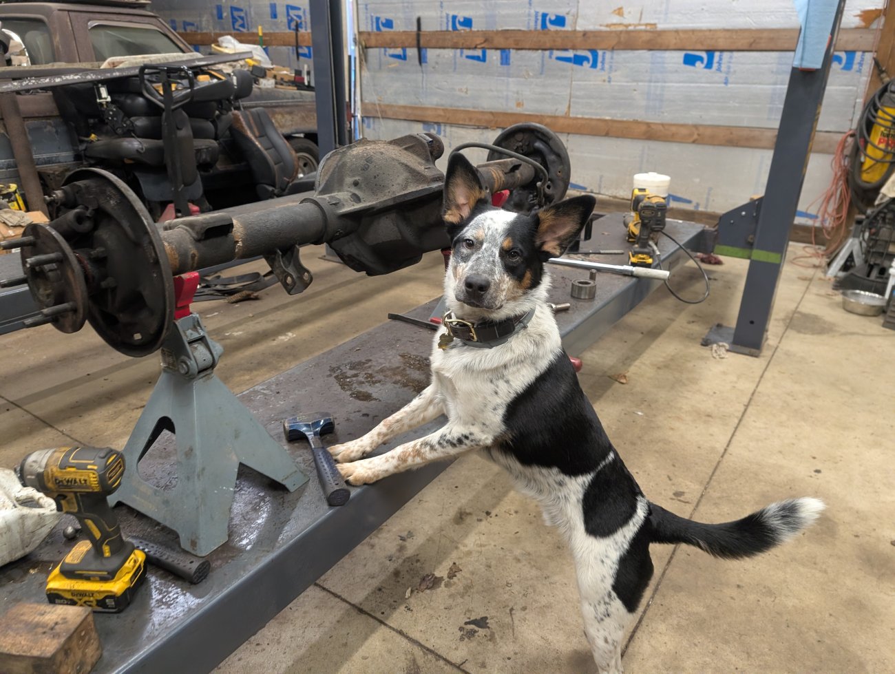

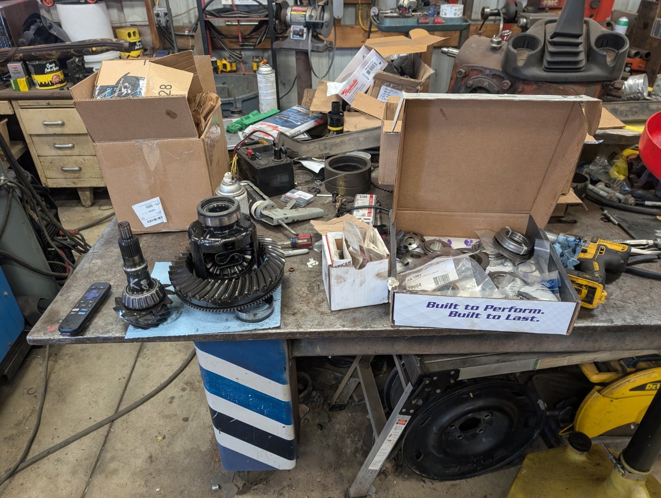

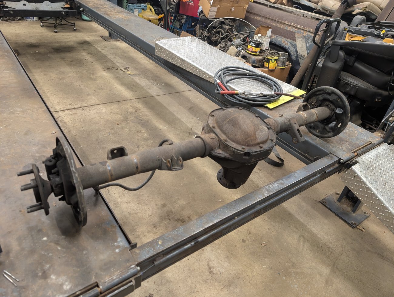

Stumbled across a deal on a 3.55 Trac Lok Ranger 8.8 with 10" backing plates....dirt cheap, low miles...but a trashed pinion bearing literally on my way home from work.

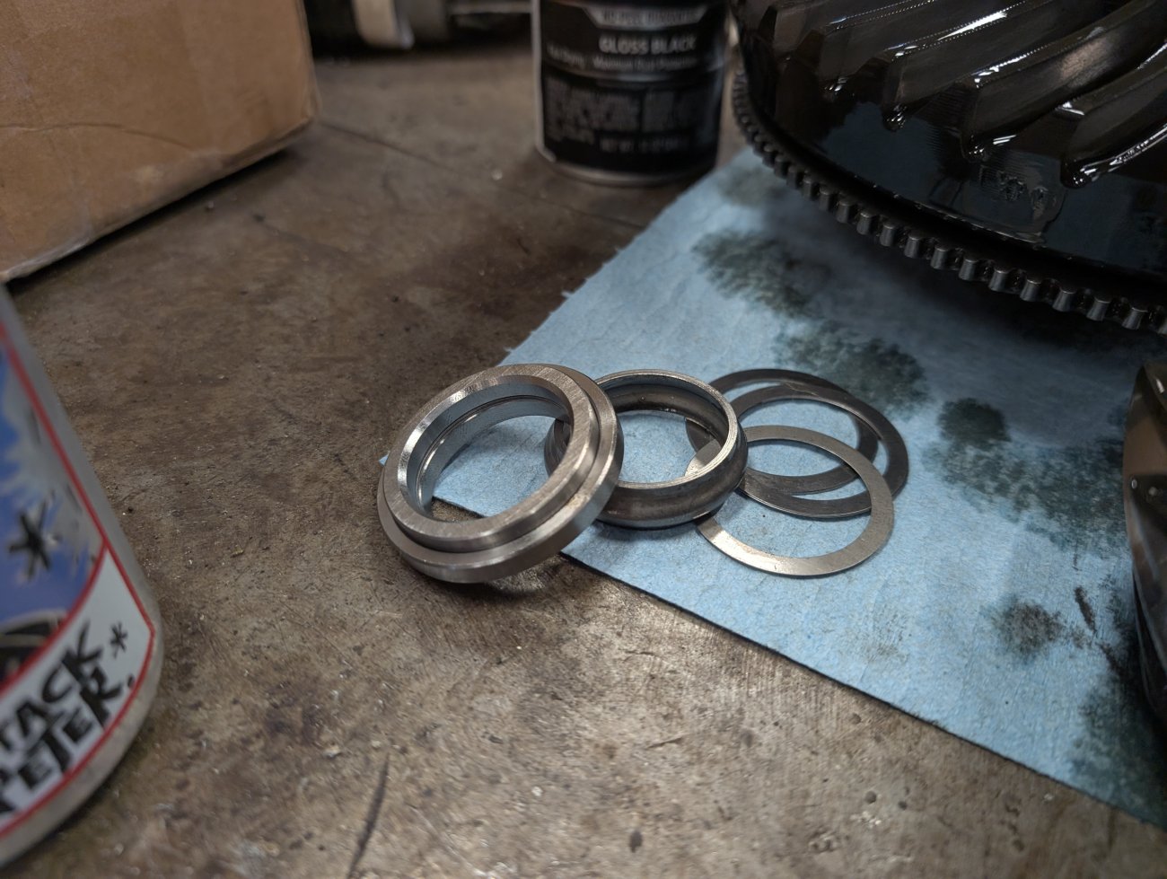

Common issue I have had with 8.8s that sit awhile, moisture gets in and small amount of corrosion pits the outer race and eat eats itself alive if you drive it.
Had seals already, but had to steal the bearing and crush sleeve eliminator from my V8 truck parts pile. Had Rip throw it back together for me.

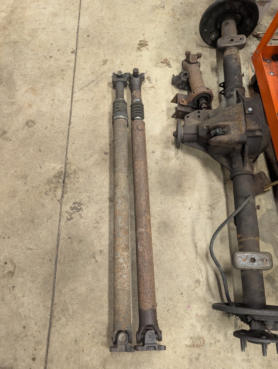

Truck currently has an open 3.73 7.5 so I was pretty stoked to find this unit. I'll have to upgrade the driveshaft to 1330 or 1310 as well, which honestly probably needed for any way with anything over 100hp
LSD rear end is a new addition to my list of add on parts. Id be happy with a 7.5 inch rear with LSD though. can you reuse the stock drive shaft when you put a 8.8 in?

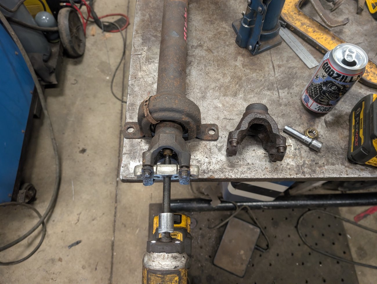

Not on this Ranger. It has a the tiny u-joints (I don't recall what series, but smaller than 1310). I already ditched the giubo and upgraded to 1310 at the transmission. I am hoping I can use the shaft from the carrier bearing back from my STX parts truck. Or.....Ill track down a 98+ one piece shaft and ditch the carrier bearing all together (sometimes an issue on a lowered truck though)
Didn't early trucks use a 1210 joint?

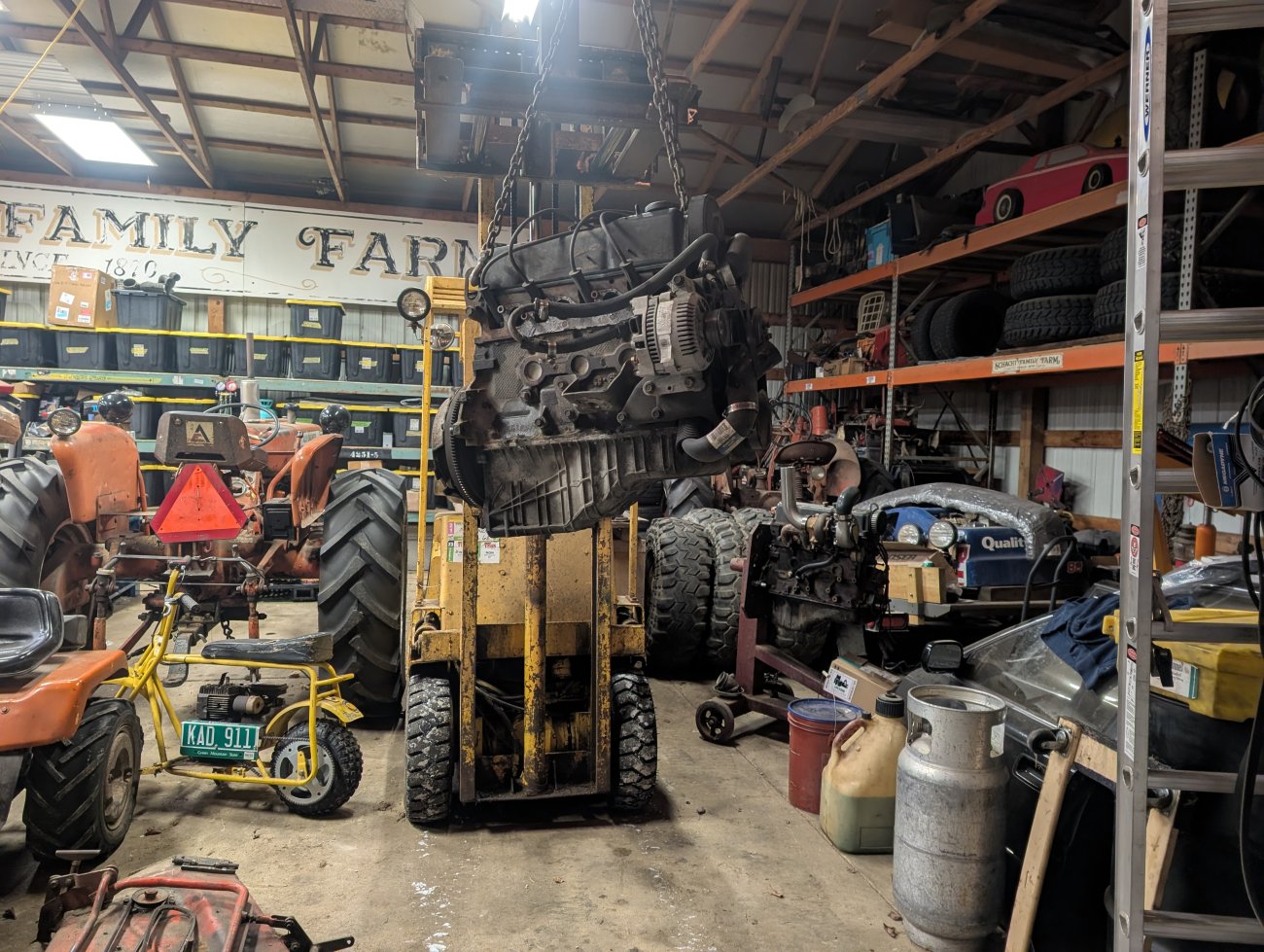

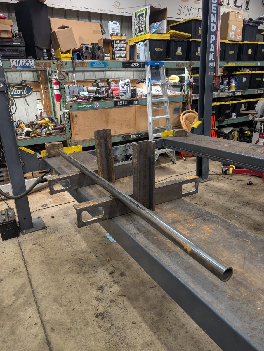

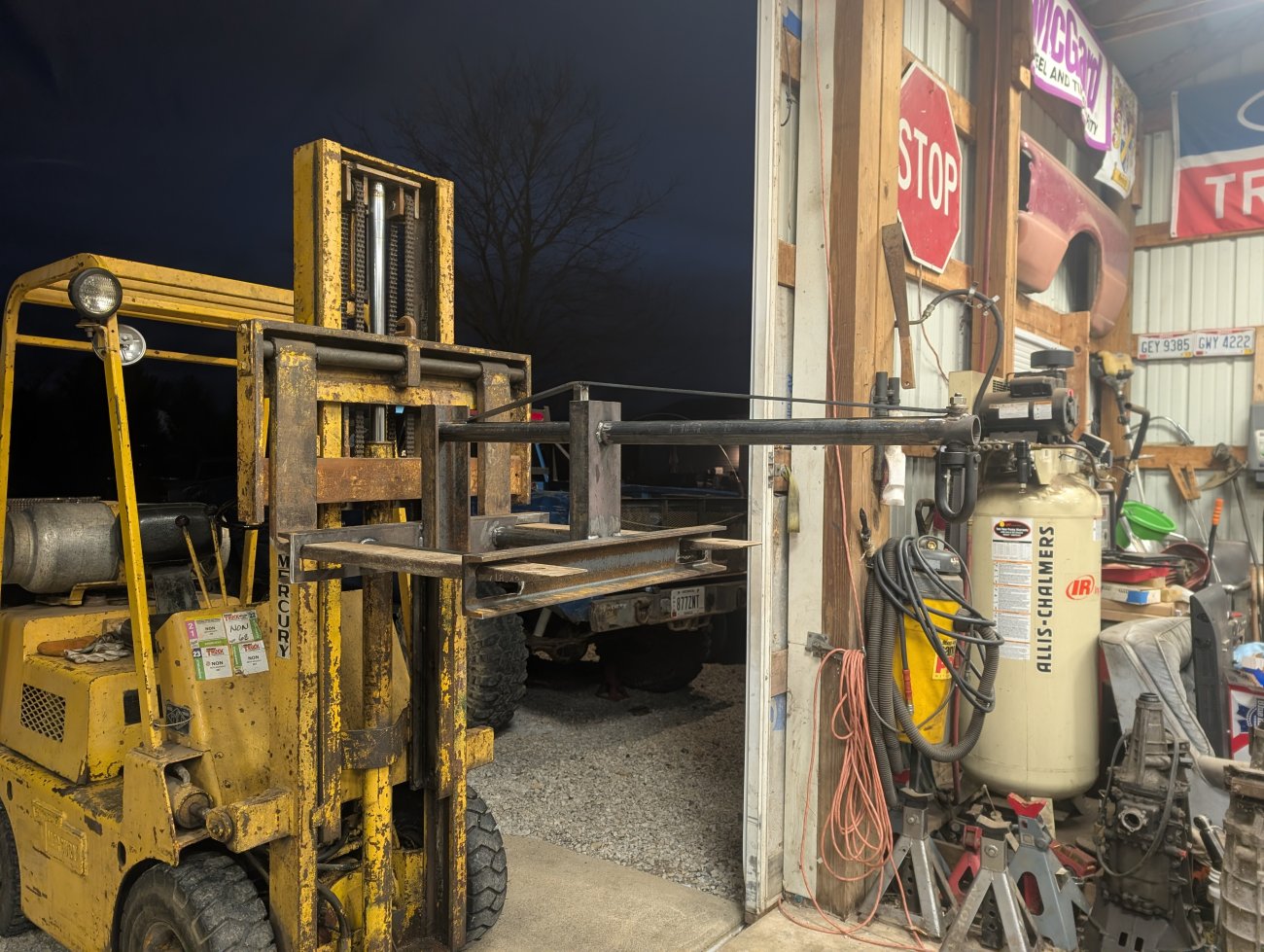

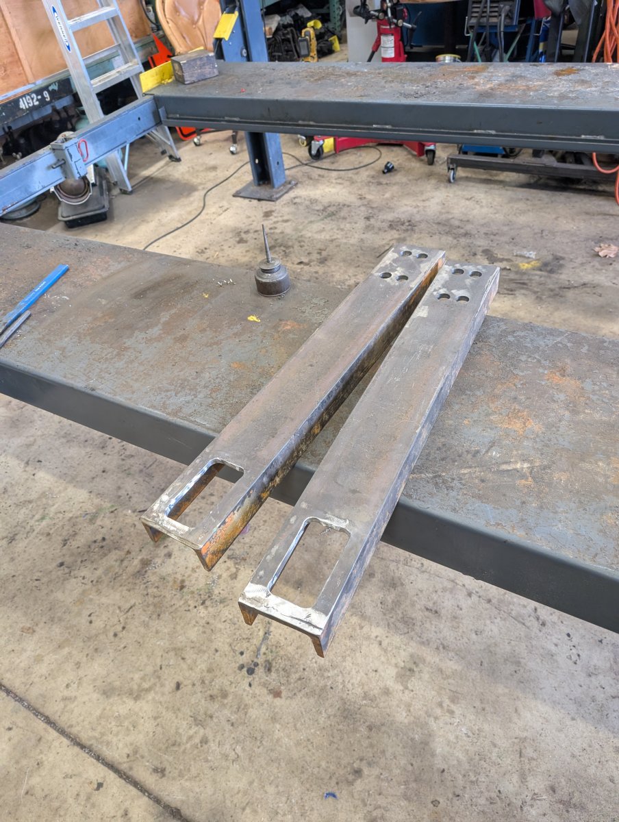

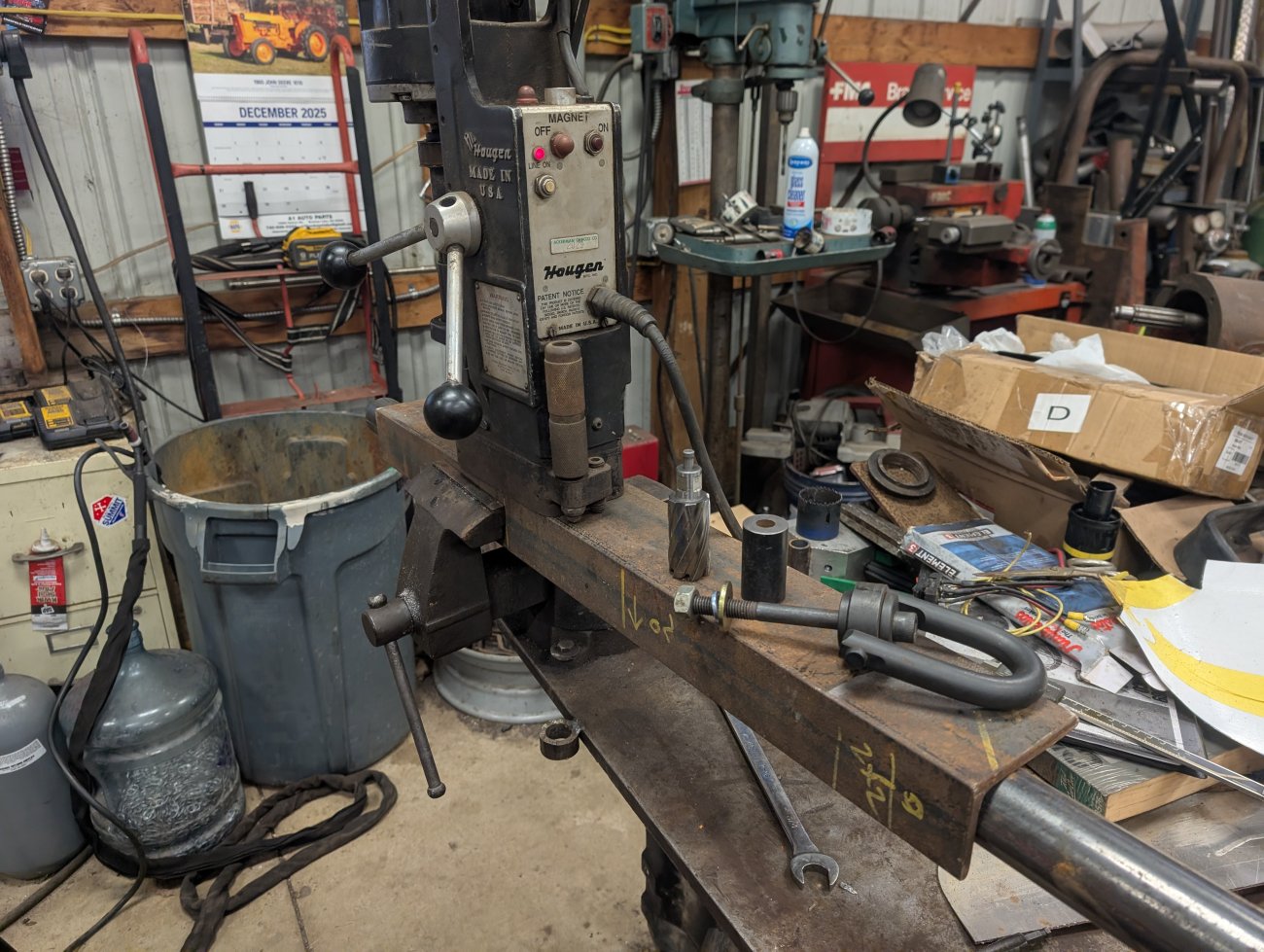

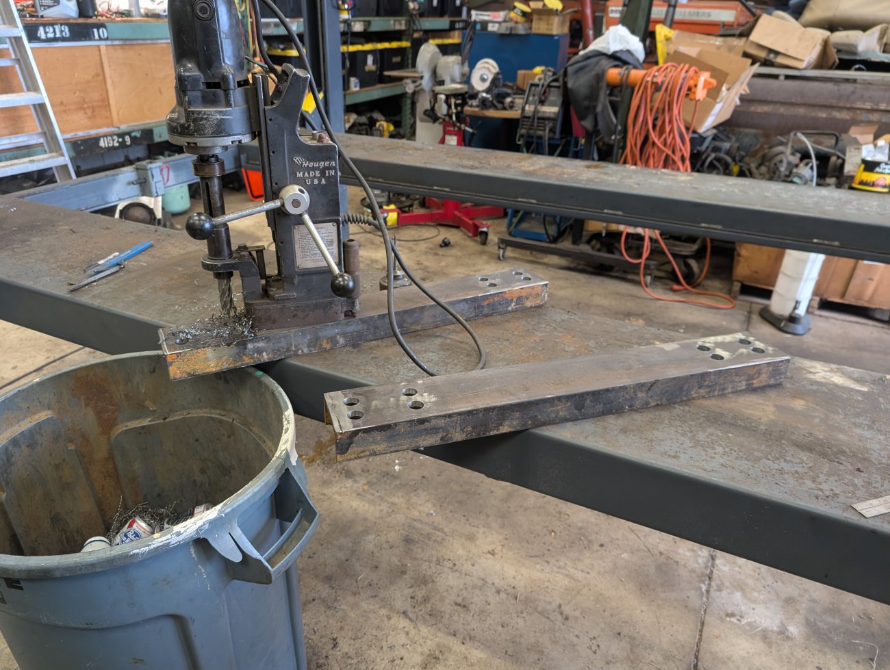

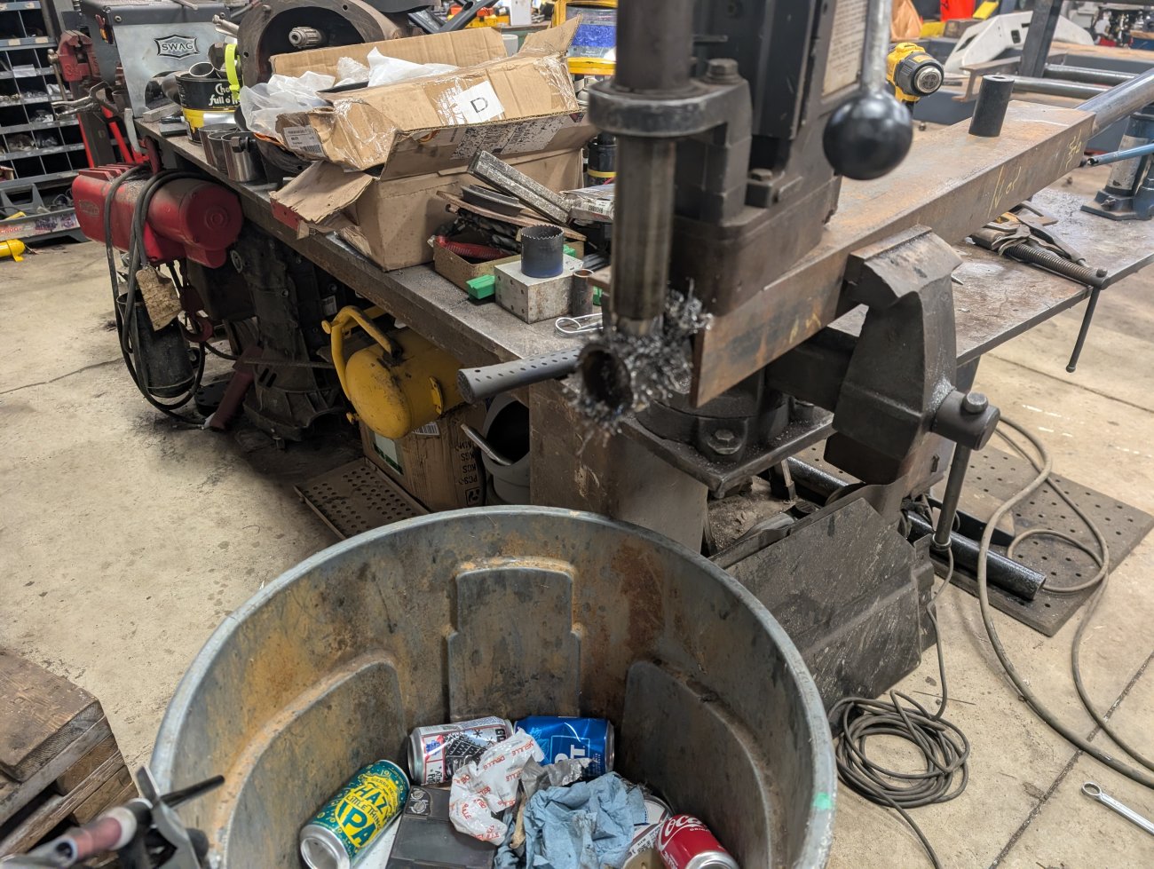

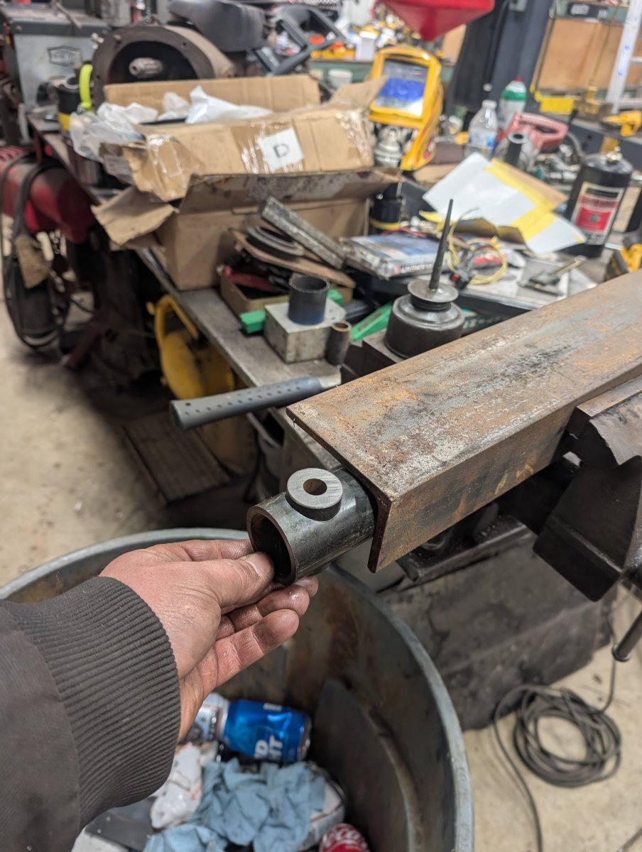

Decided to whip up a jib(?) for the forklift first to make life easier. Seems like the forks are always a hair too short reach where I need.
Made from free drops and scrap

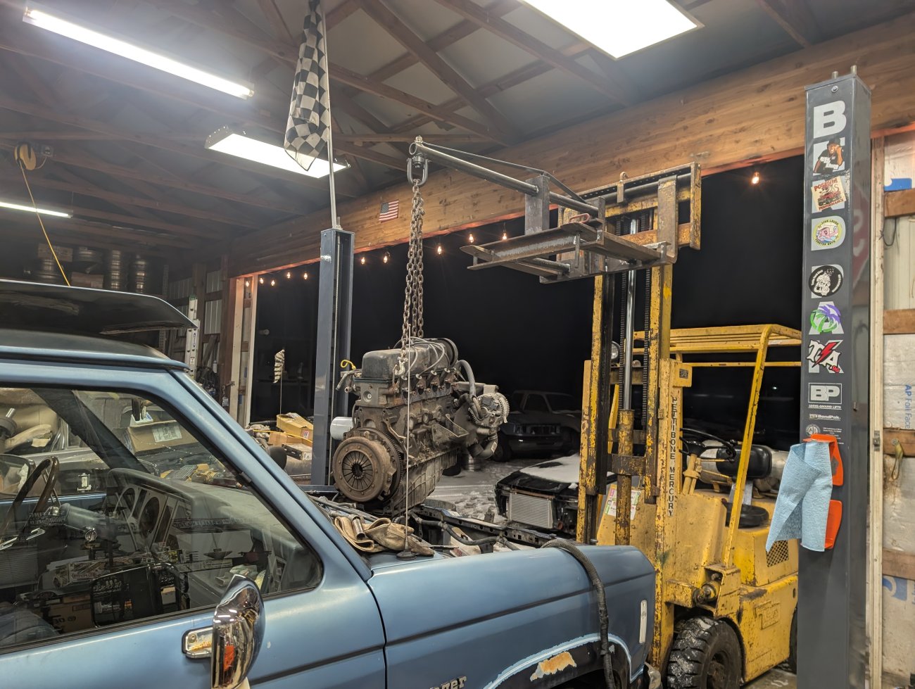

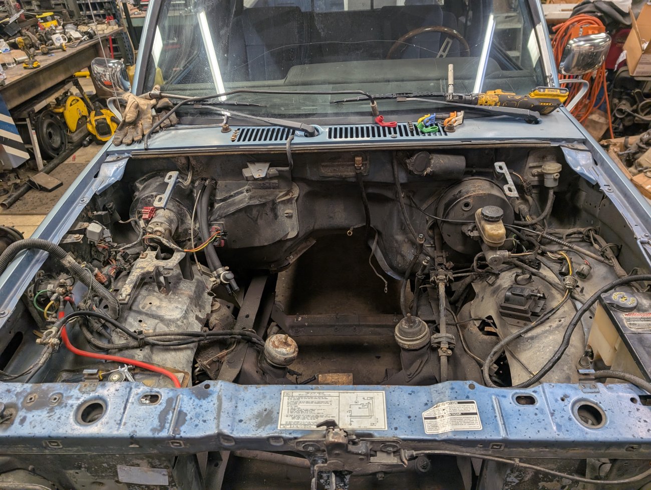

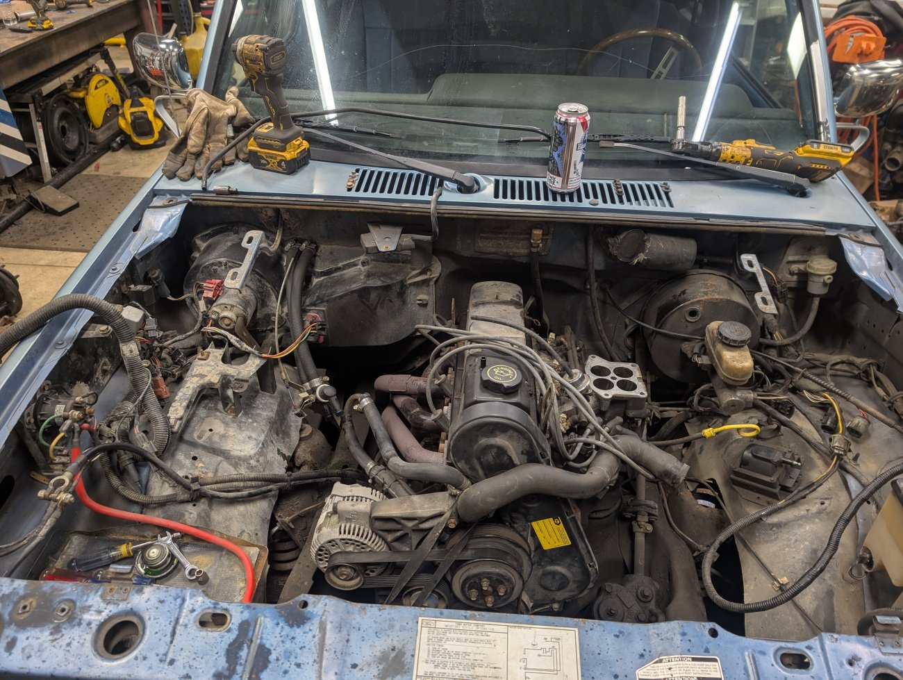

Disassembly has begun!
Motor and trans out.

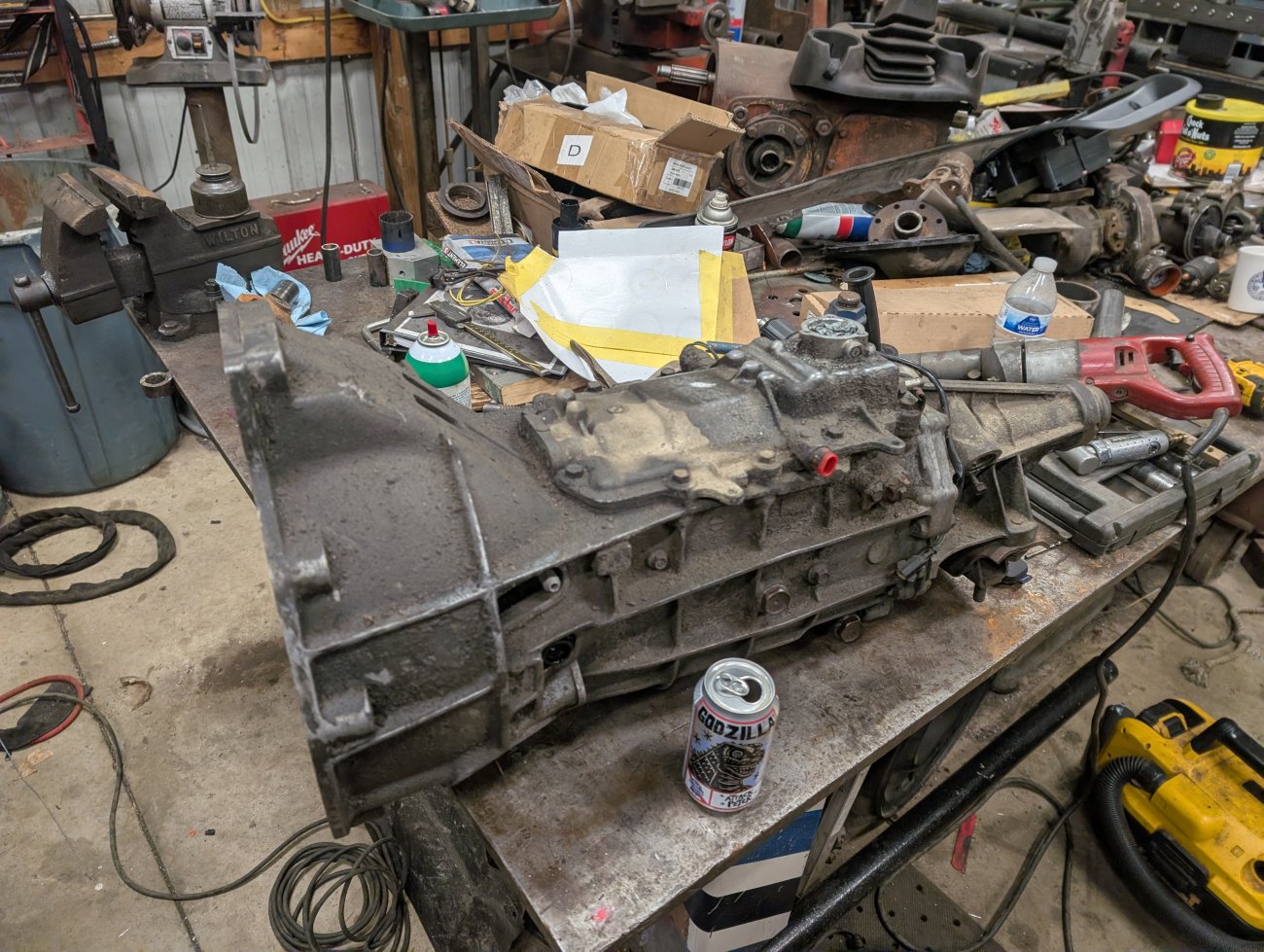

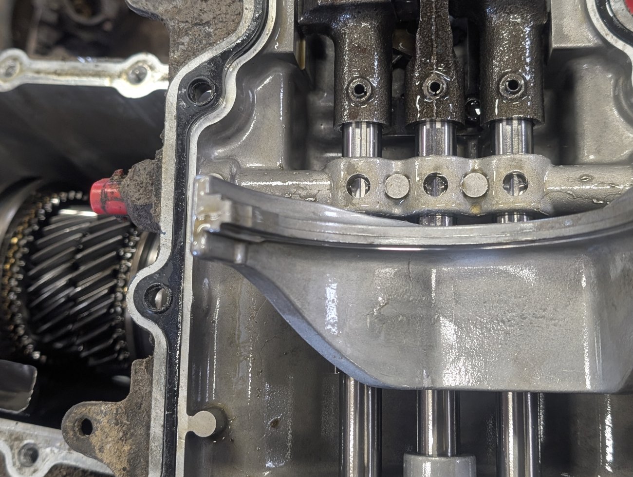

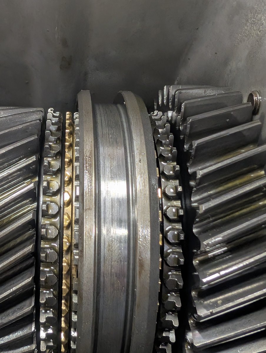

Pulled the top cover off of the trans to find exactly what I had expected. Truck has popped out of first gear 50% of the time since I got it going unless I hold the shifter.
It had a very poorly bled clutch and I suspect that it was forced into gear for a while before it blew up....the first/2nd fork was severely worn and the nubs worn off pretty good on the gears too.

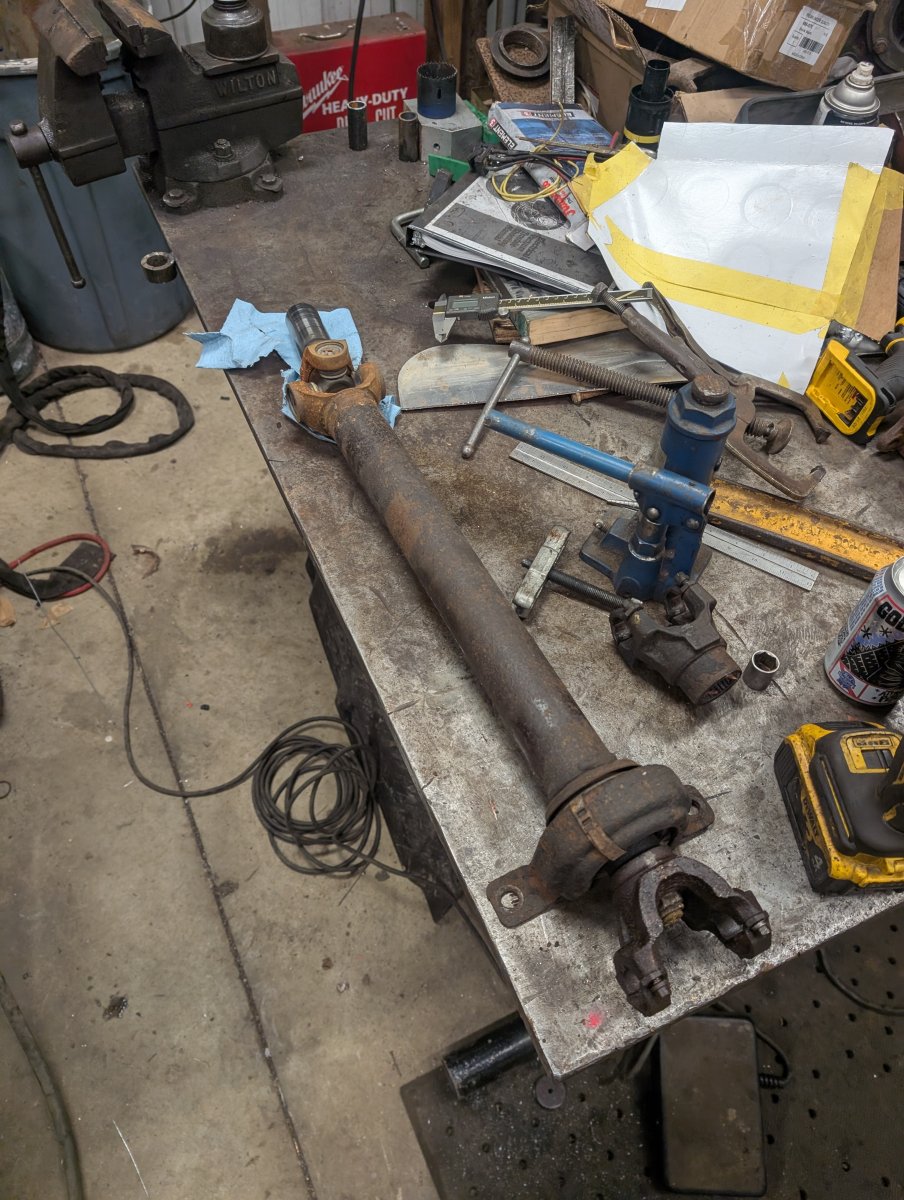

Also was able to confirm the 1310 yoke from my 96 4x4 STX parts truck bolts up to the front half of the shaft on the 88...and the rear section is the same length. So the 8.8 swap should be a bolt in swap.

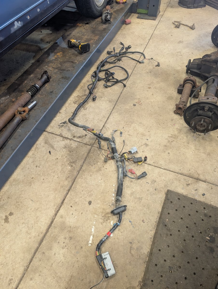

Pulled the harness out so I can go through it and make sure the pinout matches the PimpX diagram as well as remove/repurpose any unneeded OEM wires.

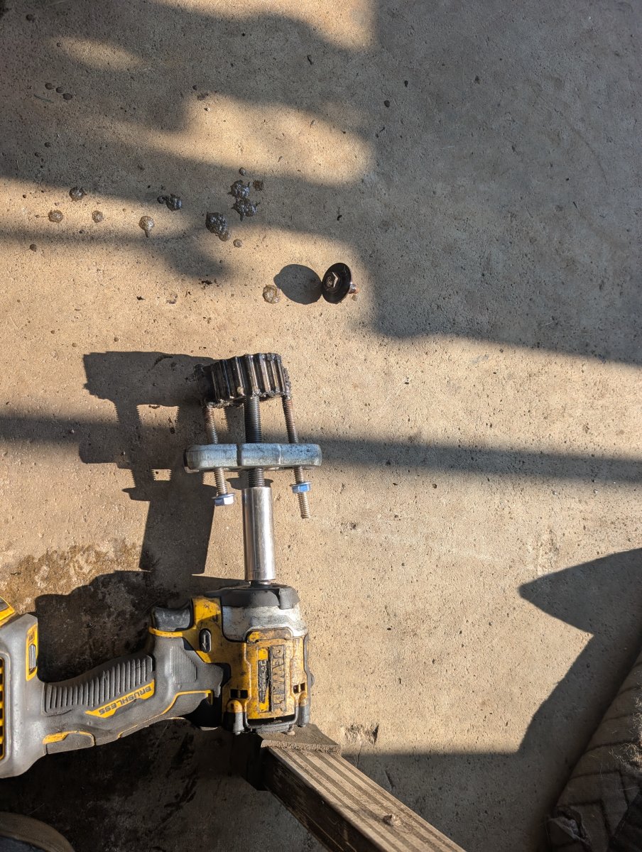

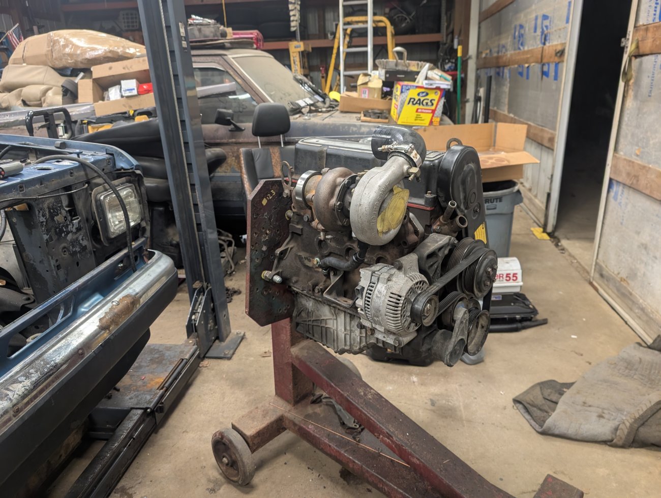

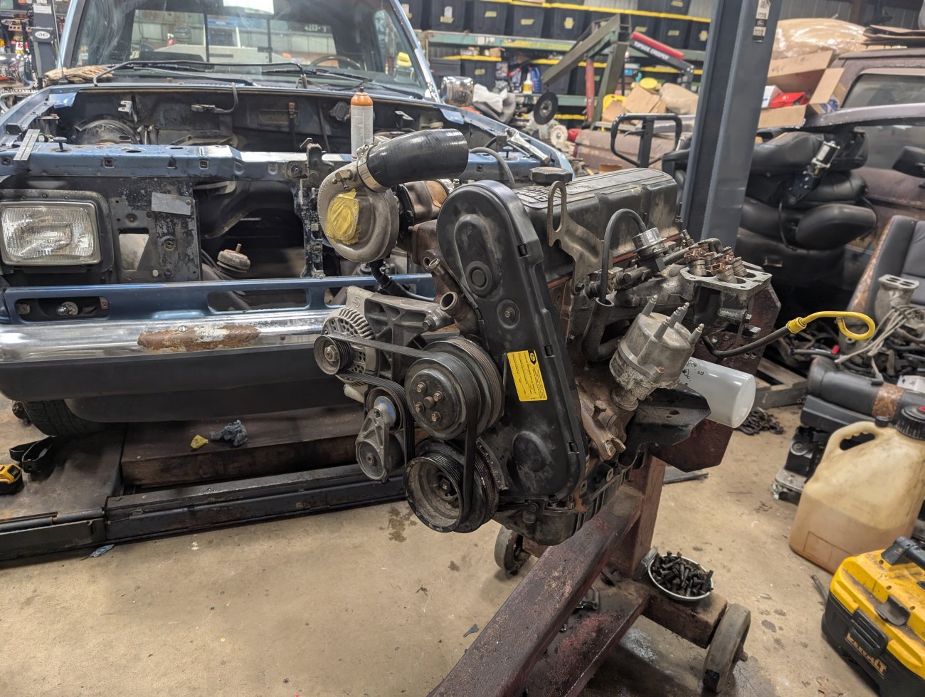

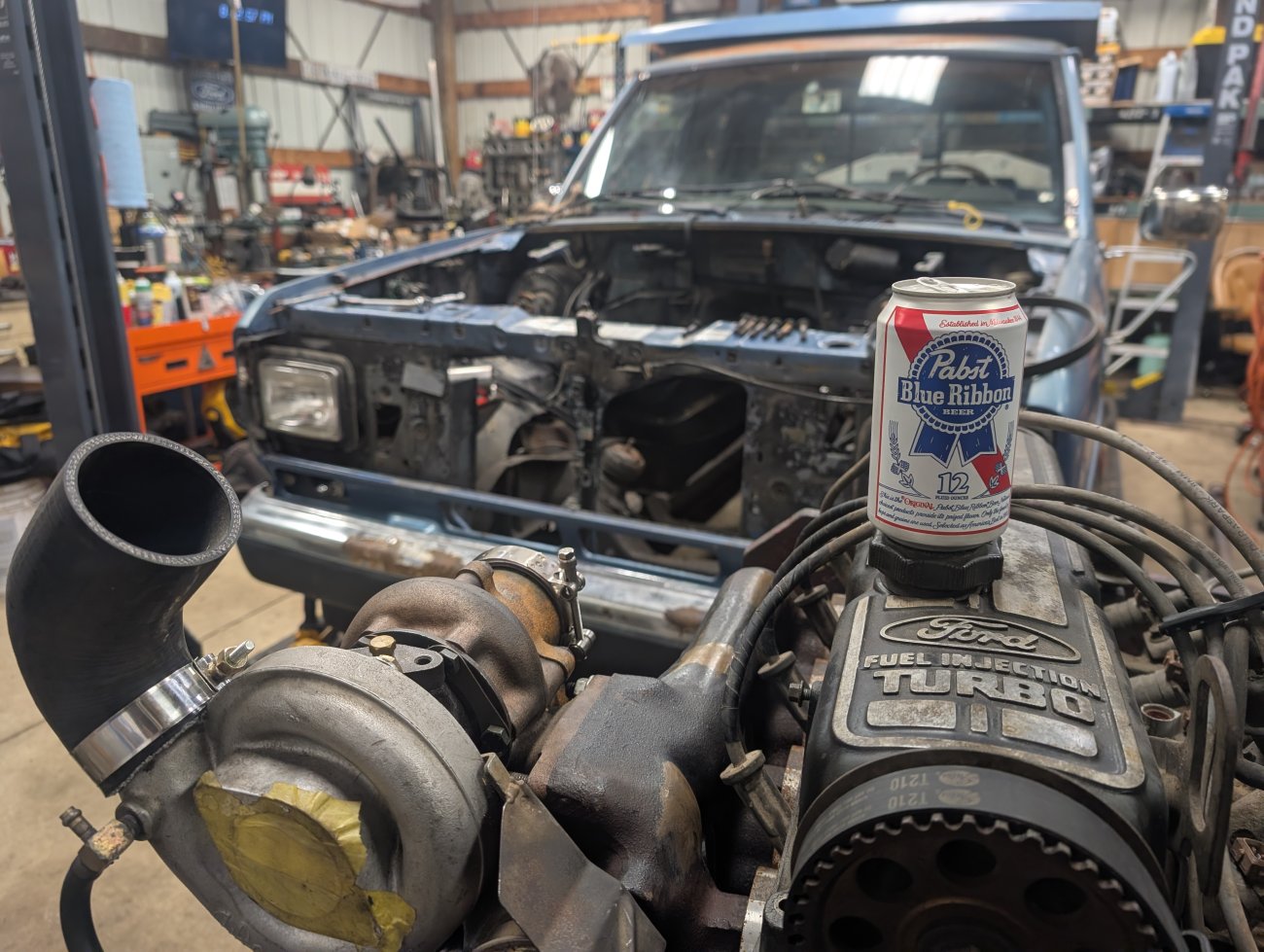

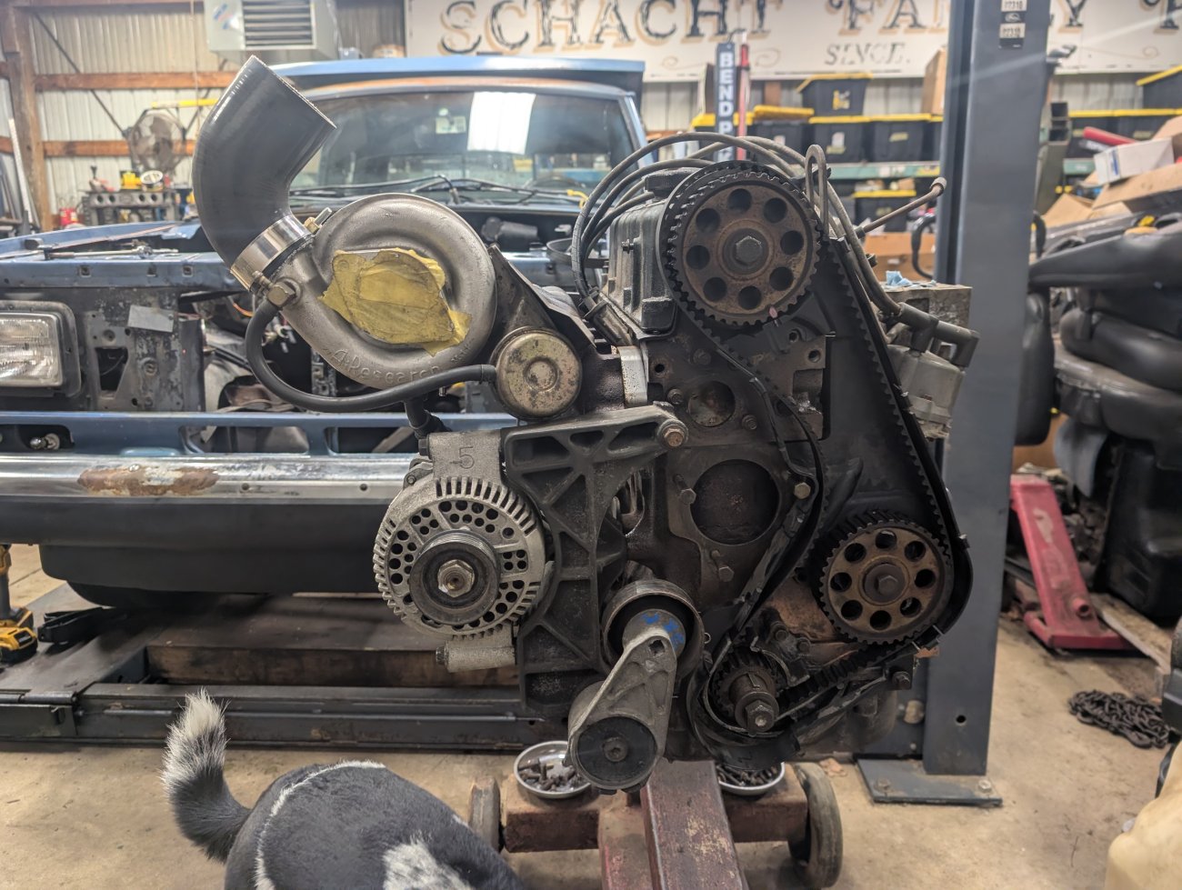

Pulled what I needed off of the NA motor (alternator bracket, motor mounts, timing gears, etc) I wanted to put the NA motor back together enough to sell, so I put a square tooth timing set I had back on it, but man did the crank gear fight me. I ended up having to weld studs to it and use a puller. Luckily I had one extra round tooth for the turbo motor.

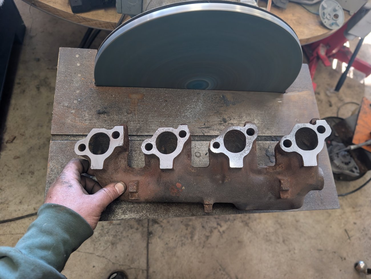

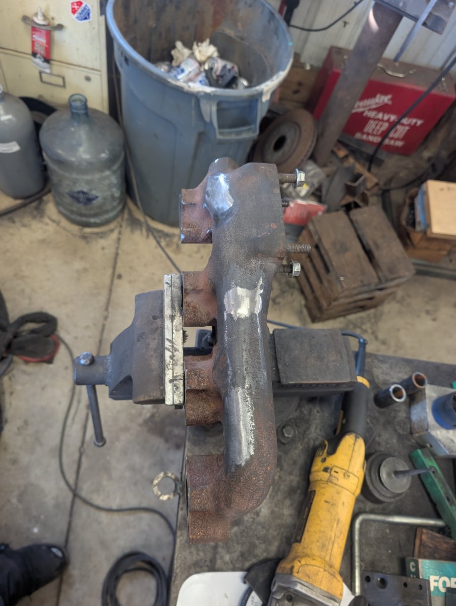

Gave the turbo manifold a quick surface job and removed the extra casting bits that would rub on the plug wires.

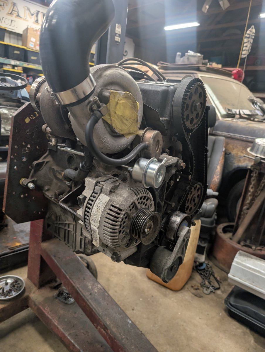

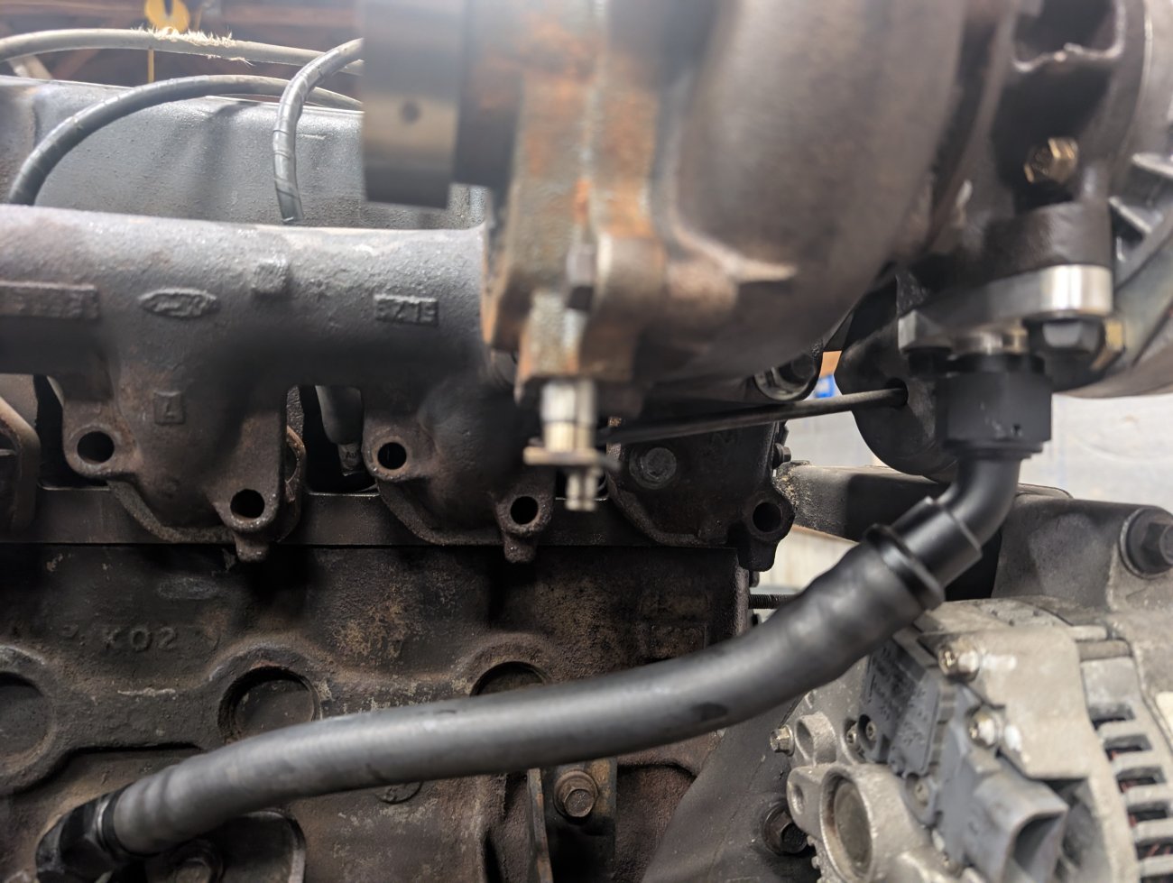

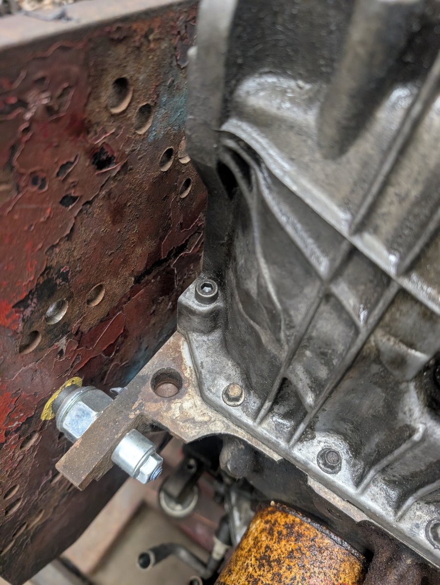

Mocked everything up and the only issue I see is the wastegate actuator hits the alternator bracket and cant be clocked to a location that will work.
I have an aftermarket actuator that came with the v-band outlet, but i will have to make my own bracket to get it out enough to clear the alternator and align with the wastegate lever.

Round tooth timing set installed:

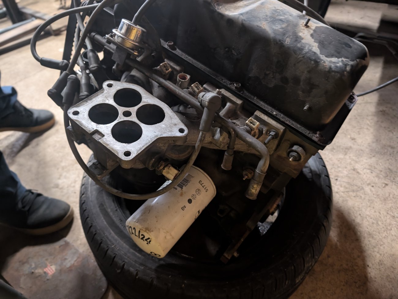

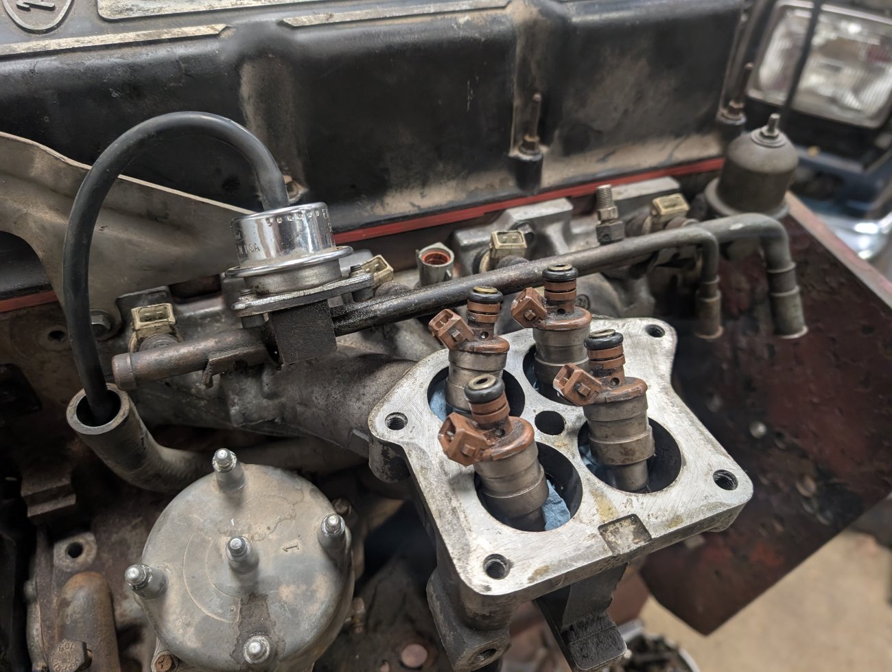

Decided to swap intakes since the Ranger already had provisions for an IAT and one less coolant port to block off...I'll swap fuel rails too since the Rangers point down vs straight out. (I'll toss the injectors in the ultrasonic too)
Mustang intake:
Ranger:

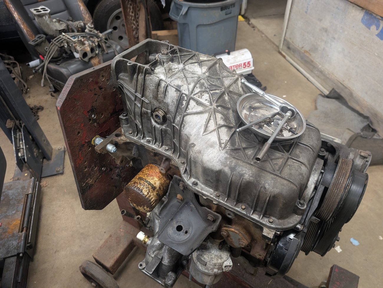

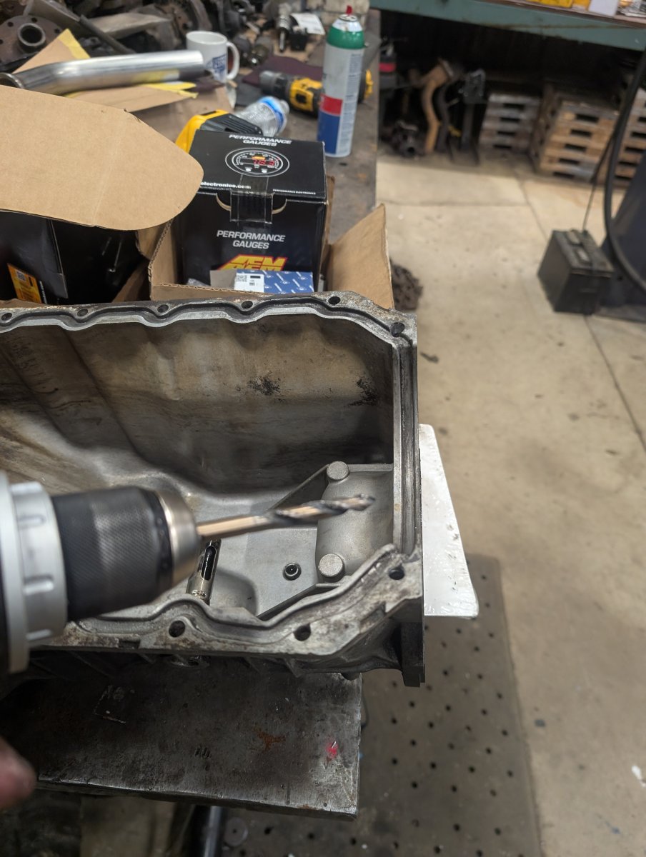

Oil pan is on, had to open up the rear two holes to sneak an 8mm bolt in since the steel pan originally had bigger bolts by the main seals.

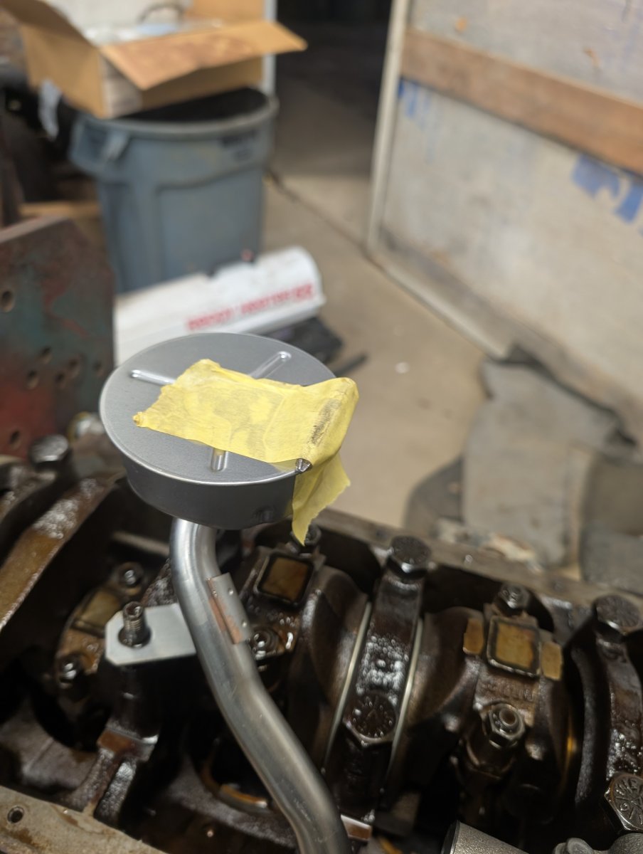

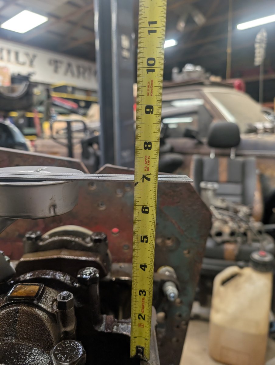

Also measured clearance from the pickup to the bottom of the pan. Measurements seemed a little iffy with the shape of the pan. So I taped a quarter inch drive bit to the pickup to confirm I had at least that much clearance. It barely touched so I tweaked the pickup a hair.
Accessory drive installed for now so that I can continue mocking up wastegate and hoses.

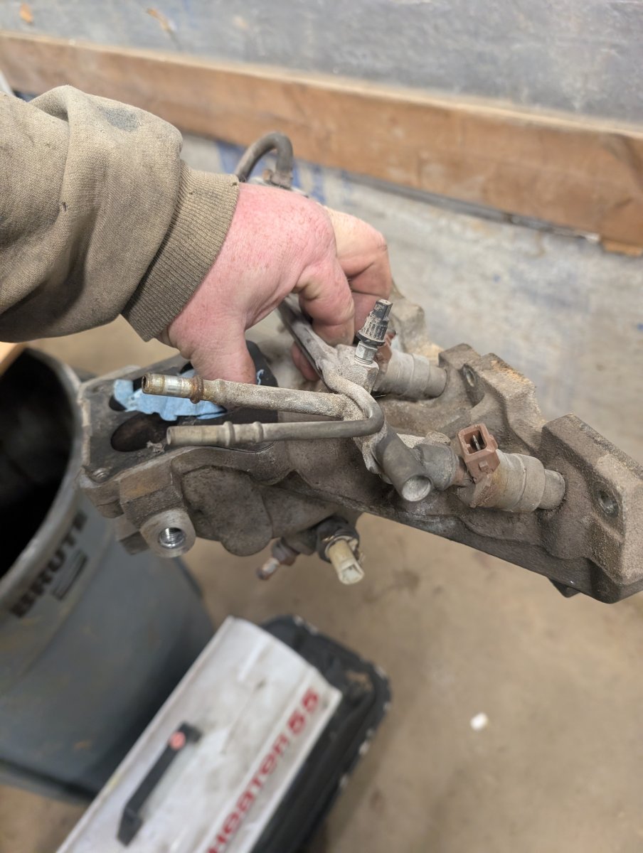

Intake manifold installed and valve cover installed for good. Need to clean the brown top injectors before I swap them over.

I don't recommend using the brown top injectors. They are low impedance and are known for leaking with age. Racetronix is where I buy mine.
