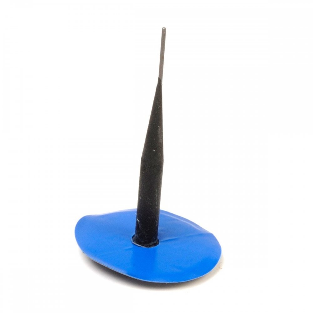

I always pull the tire and use these...
61509

I keep an air compressor and a plug kit cause it will get me home. I don't deny the patch/plugs that sno showed are better, they are. But plugs work on the side of the road and here's my argument against sno's fancy patches...
I've never had a plug fail and I've done dozens. Plug can be done anywhere, a patch can't. So why... no plug of mine has ever failed, so what benefit does taking the tire off for that goofy thing provide besides shops are not allowed to use plugs?
Well the plugs have got better over the years... can't say I've had any fail either.
On my expensive tires... I just hate making the hole bigger and further damaging the cords. I usually ask for just a patch and not one with a plug for the same reasons.
Trust me... if it came right down to it... I would plug my tires and still sleep at night.
I started using the fancy plug/patches on my ATV tires. It’s easy to rip a plug out offroad. It’s not so easy to rip a plug/patch out.
