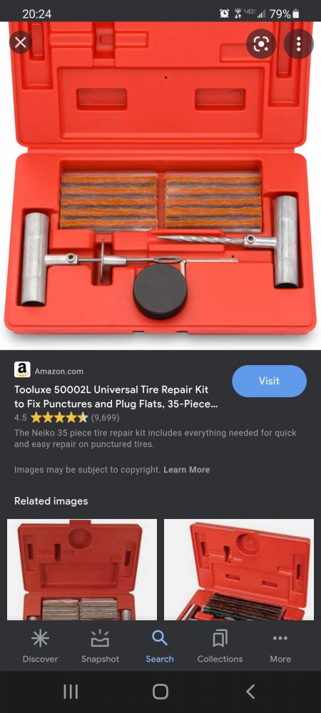

This is the kit we used at the overlanding competition back in September. Seemed to be a good kit. Easy to use. I saw it get used about 14 times over 2 days.
See this is helpful... On the insertion tool, does that little slidey thing matter?
The slidey thing is depth control... so you don't push the plug all the way through.
Word of caution... the slidey thing will pinch your fingers if you aren't careful. I just take it off and use care not to push the plug through.
