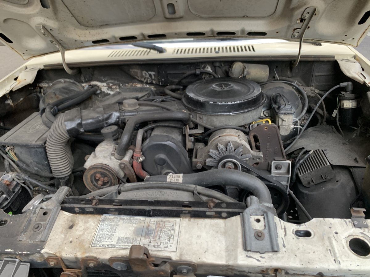

I’ll try to get photos of my engine bay in case anyone recognizes the bolting pattern or engine size my frame can accommodate..

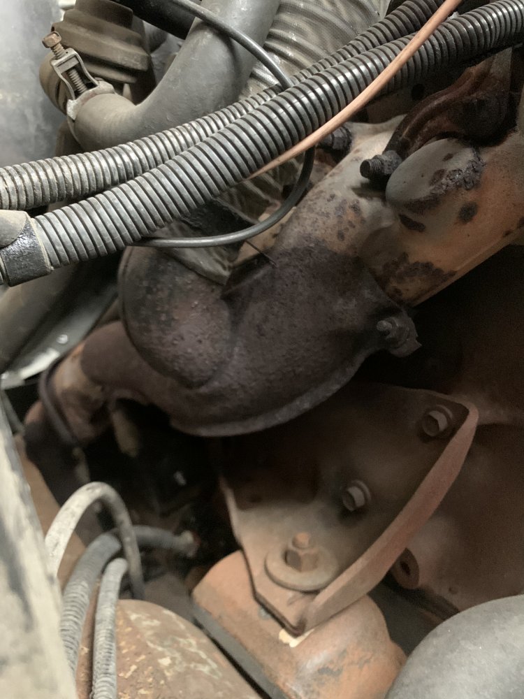

and just for the hell of it, photos of my dusty 2.0 and.. the passenger side engine mount!
42377
42379
42380
