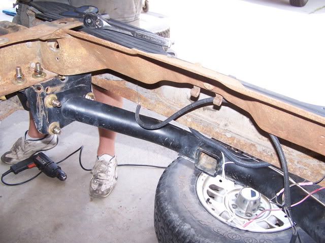

To clear up one item with the wiring harness. The Explorer wiring harness didn't have taillights out through the firewall. So, I had to alter the Explorer harness to pull the taillights out. I used a couple of door connectors to create a harness that easily connects to the Ranger's harness to the taillights.
The gray connectors go to the taillights down the frame. The blue goes to the fuel pump and sending unit. The only connectors underhood that aren't used were the ABS pump connectors.
