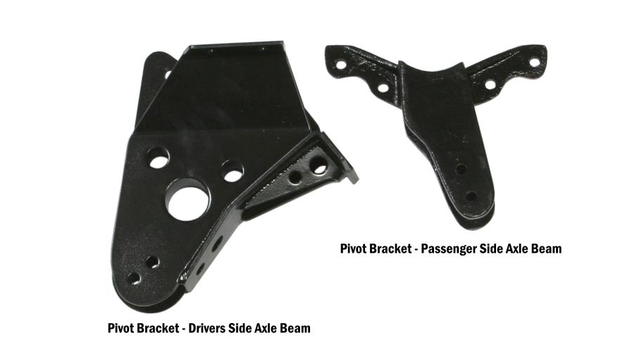

Hello everyone, I'm struggling to find a good lift kit ideal for about a grand. I found this BDS lift kit that does not seem terrible, it comes with everything I need but it uses the drop bracket style brackets that poke holes in the front diff. I do not want that, would it be fine if i bought the lift and then also bought the 2 brackets that I need which are the pivot bracket style ones that come from like skyjacker or tuff country and just replace those rather than the drop brackets? I ideally do not wanna spend like more than 1500 on a lift and this BDS one does not seem terrible but its just the drop brackets I am worried about. I also would like ideal alignment too lol. Seems like these trucks are complicated to lift or I am just too stubborn.

That driver's side drop bracket (for passenger side beam) looks VERY similar. And I've heard about the Rough Country kit poking holes in D35s as long as I've been here. I swear I remember it being in the tech library at one point, but I can't find anything now but a couple posts...
I have seen them knock holes through the diff with the passenger beam drop bracket. Im sure you can grind it a little or something. If you have the Dana28 you may not have a problem cause its smaller.
And this one claiming to be from a Rough Country employee that it was redesigned around the same time to fix that problem. Soo:dntknw:

Supposedly the drop plate for the passenger side beam was redesigned not to poke holes in the D-35. I still don’t like the drop plate design.

The radius arm brackets are not what poke the holes. Those are the axle beam pivot brackets.

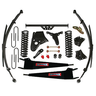

For example; in the Skyjacker kits, the new radius arms brackets are incorporated into a new transmission crossmember. Because that is how far back the new radius arms mount to the frame.

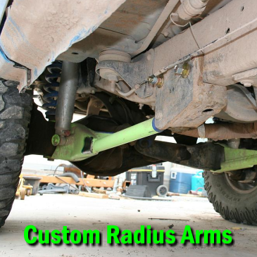

Both of the sets of extended arms that I built were extended to the transmission crossmember area. Unfortunately the company I bought my joints and stuff is no longer in business, so I can’t recommend there. But I cut the factory radius arm to fit a 2x2x0.250“ bit of tube. The second set I got some 1/4” plate bent in a 90* to wrap the outside and under the frame and in far enough to attach something for a trans crossmember. I used factory holes in the side of the frame rails (may not be there for everyone, this is an 88 B2). Welded a bracket for the joint to that L plate on the bottom, got my front axle positioned how I wanted it, and connected the dots. I’ll have to look around for photos or video.
Yeah, the picture with the two brackets on my original question is what I was referring to. I understand that the drop brackets used can poke holes, I was asking if I buy the lift kit, then buy the two brackets separately in the picture and just swap them out could that work out?
