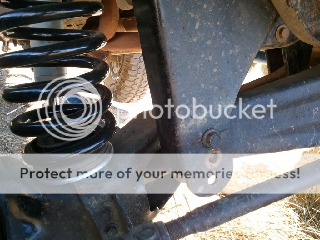

Got the coils today , hope to finish putting them in tomorrow .Did work on the passenger side for awhile .
Here are some measurements .
BDS coil started with 13.5 coils , 12.25 active coils , free length 21.75 , free length with spring pads( isolator and npt plate ) 22.625 . spring rate 240.
Cut 1 coil off 21.5 free with pads , 16.5 with weight of the truck but didn't drive it .
Cut another 1/2 coil off 20.5 free with pads , 14.75 with weight after driving around the block and flexing in the yard . Coil at 12" while flexed was 13 with the sj coils . But that is with the front tire only about 1.5 feet off the ground .
Spring rate should be about 270 now . No more high speed corners :D
Still need to drill the hole in the drop bracket and get some hooks for the top of the coils ( using hose clamps now ) .

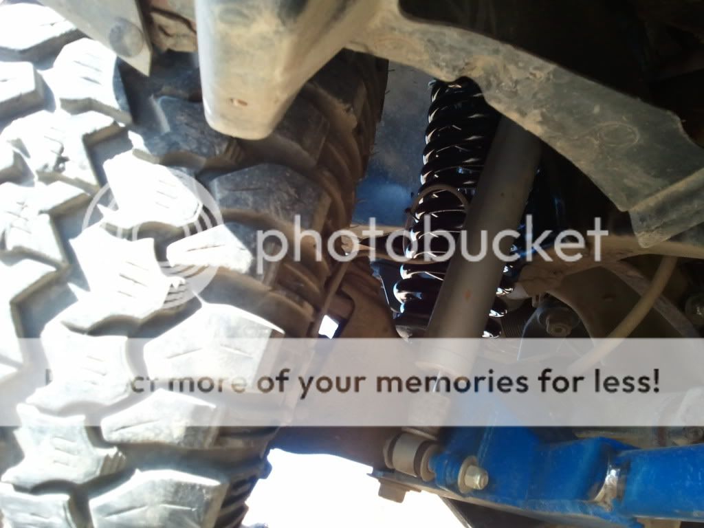

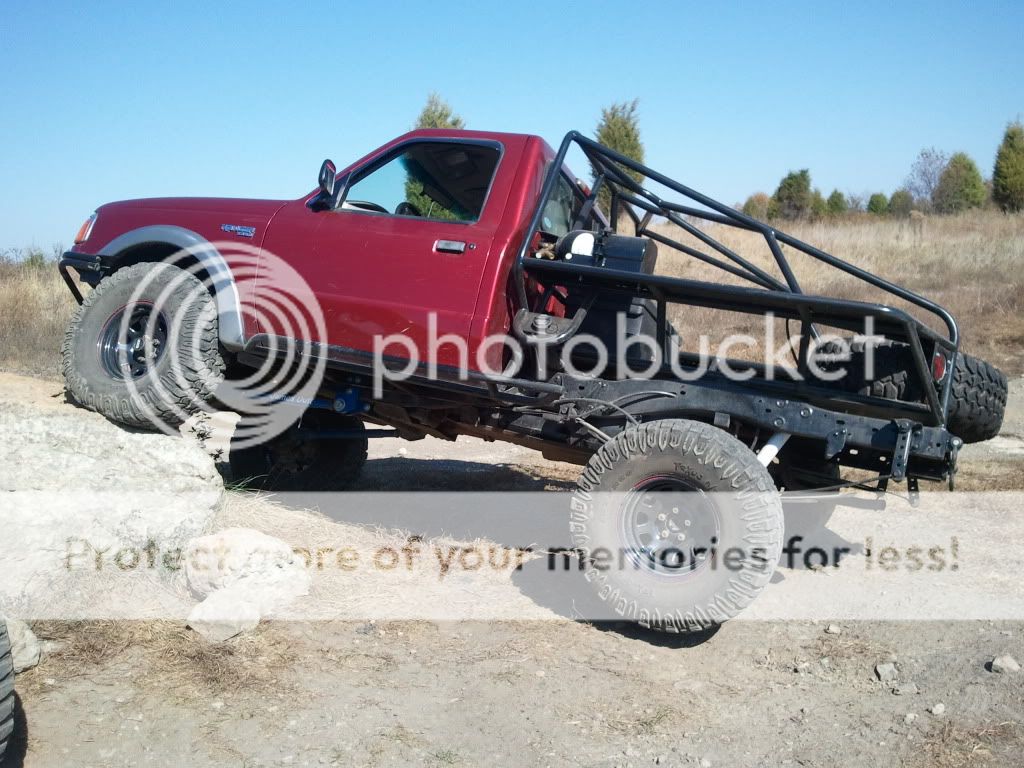

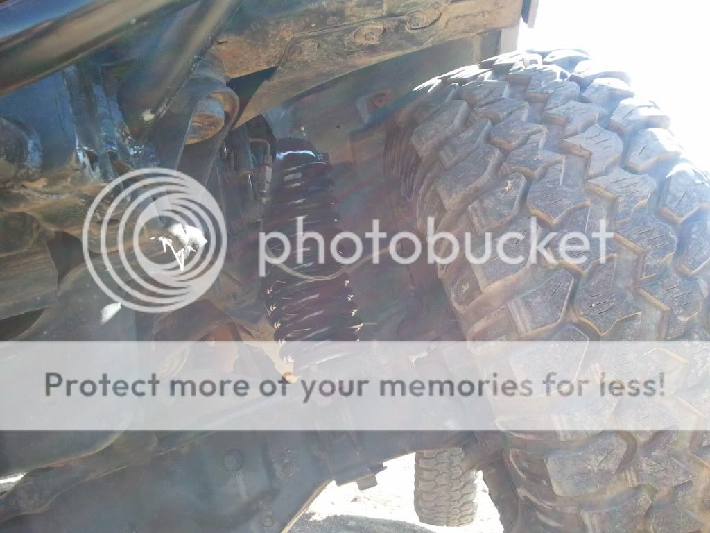

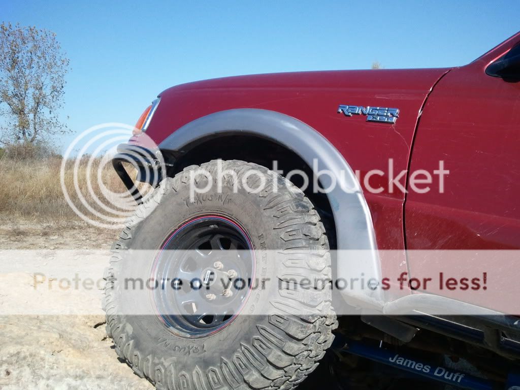

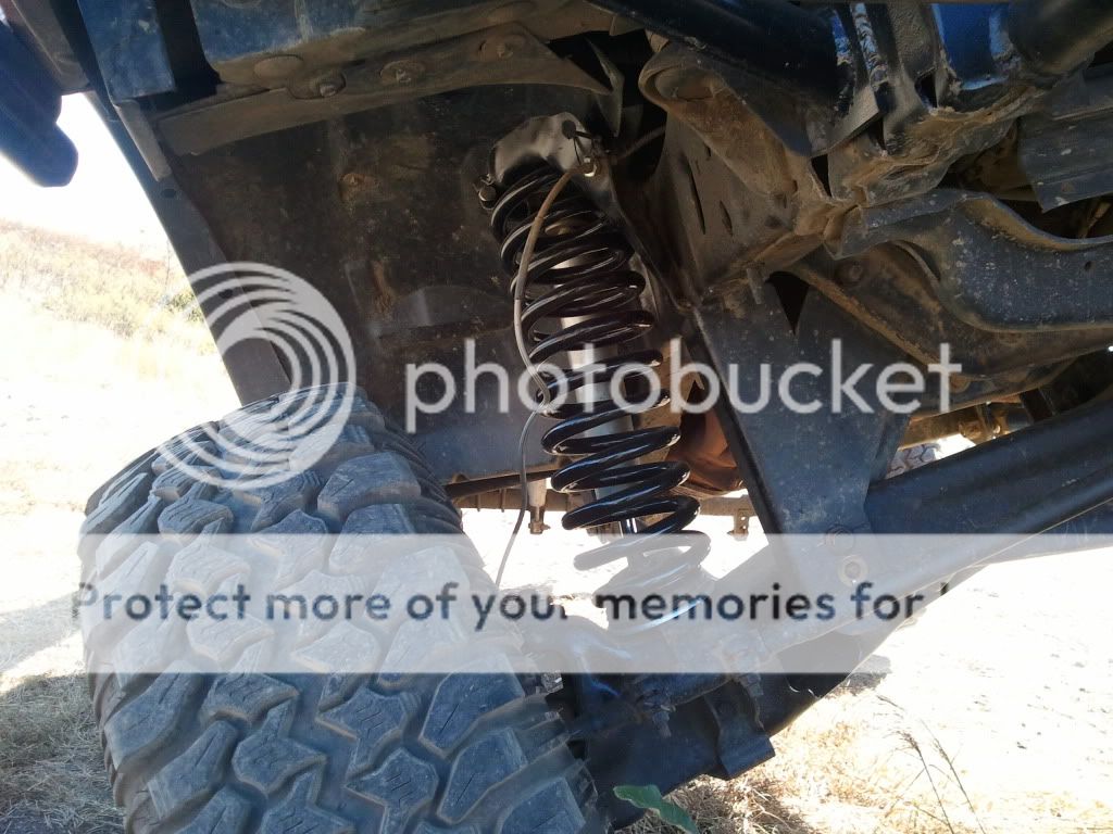

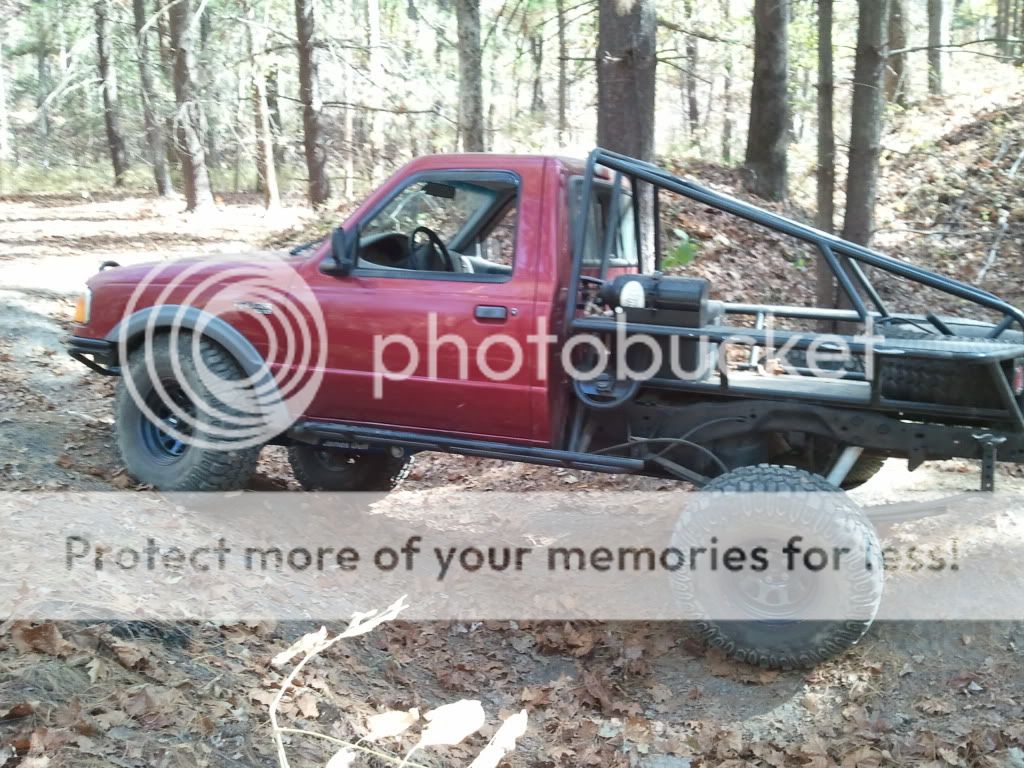

Here are some pics with the bds coils with 1 1/2 coils cut off . And drilled a new hole in the drop bracket .
Nice. They seem to have worked out well for ya. Did you hack off a coil or not?
Think you're gonna need that sway bar? Its just sitting in my shed and I have the drop brackets too.
