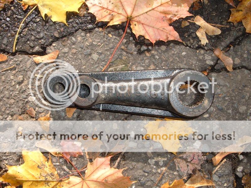

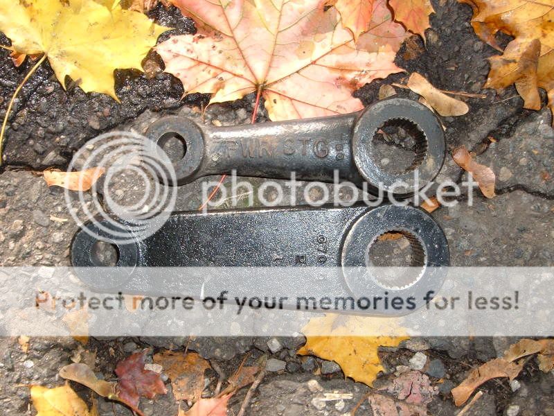

Ok, this it whats what. 2wd or 4wd doesnt matter, but I just picked up a pitman arm for a 2000 (99-04?) F250 superduty and be sure it has 32 splines!!! they are made in 32 and 36 and are identical except for the splines. The ranger and explorer boxes use the 32 spline arms. The superduty arm is 6 5/8th inches from center of hole to center of hole and my factory ranger 2wd arm was 5 1/4 inch hole to hole.
Remember that it will change the speed of the steering and the total angle of steering, you want to try and match up the pitman arm to the steering knuckles as close as possible, the factory is about a 1:1 ratio, so this will get me closer at least. The dodge knuckles I'm using are 8 inches from center of balljoint to center of steering hole which is pretty damn large.
Oh yea, the ford part number for the correct pitman arm is F81Z*3590*BA
This is my 2wd ranger arm with the superduty arm (the 36 spline arm is in the pictures, but the correct 32 spline arm is identical in everything but the splines)
I got the superduty arm in tonight and yay, I got my steering range back! I can actually reach the steering stops at the axle now and have a good ratio where I dont have to make 30 point turns to get in and out of parking spaces.
