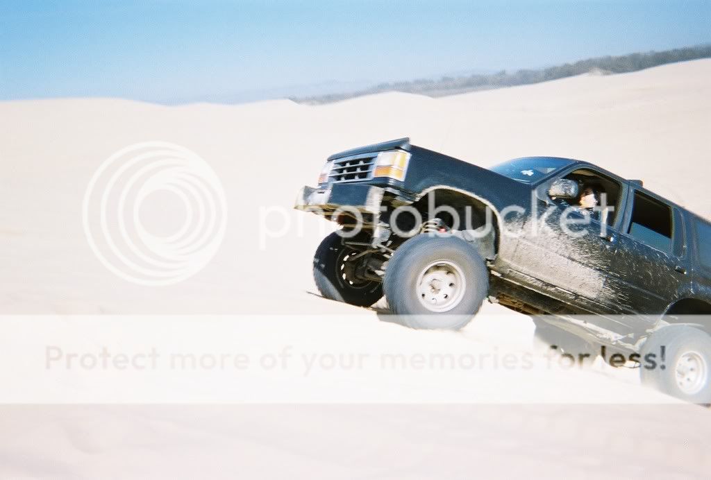

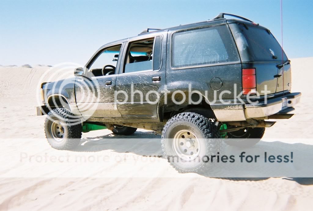

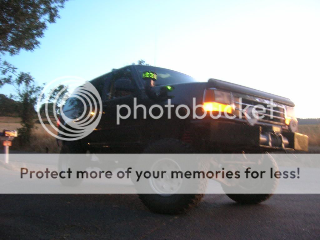

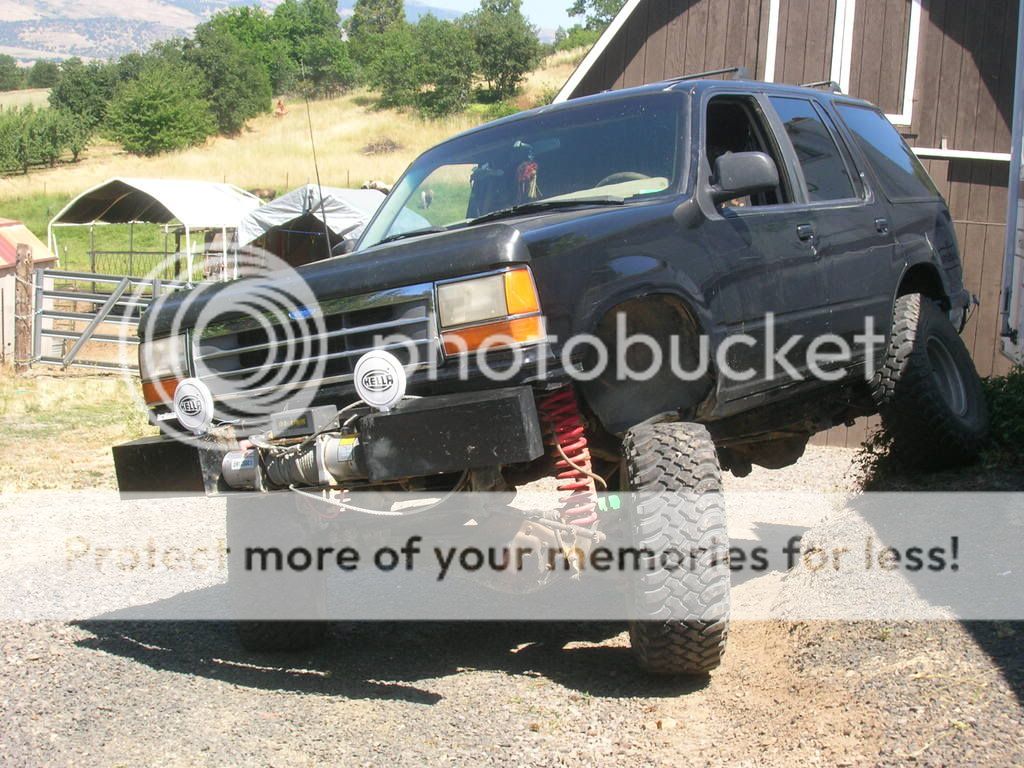

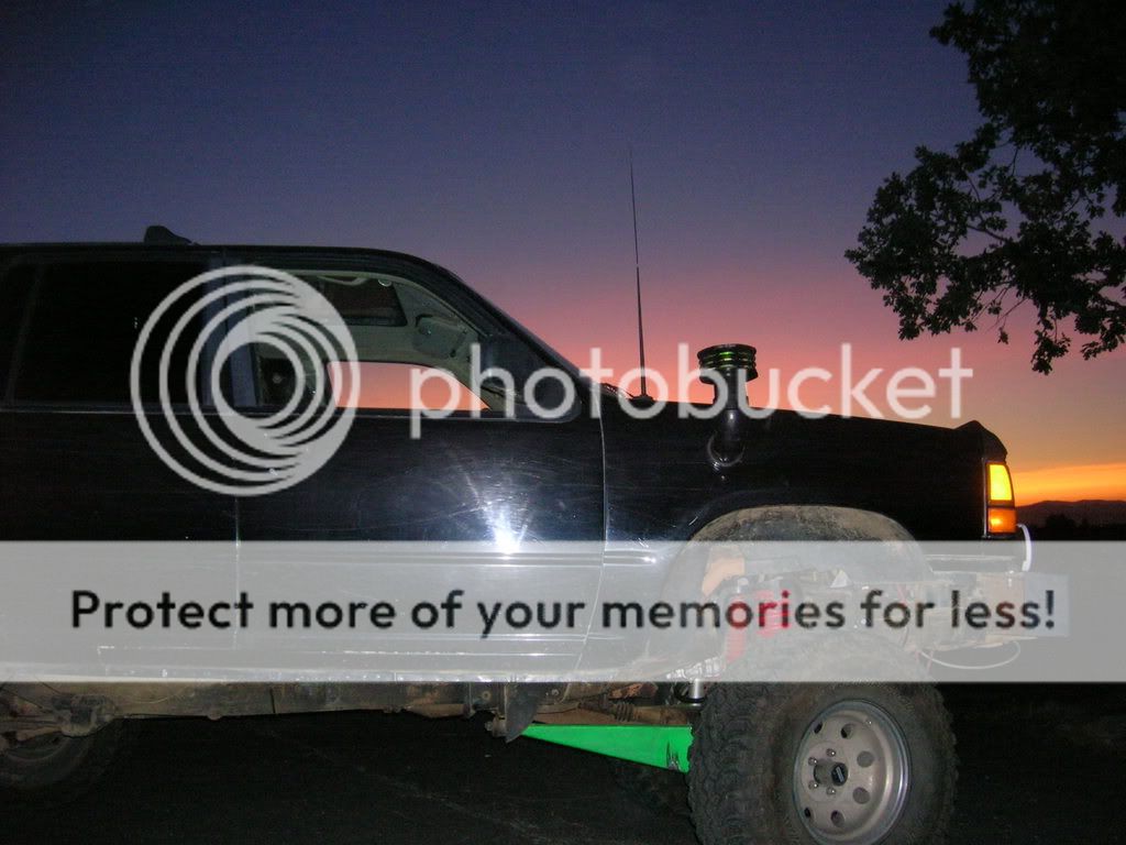

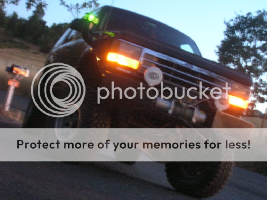

92 X, 5.5" superlift w/ext. radius arms(green), 3" body lift sitting on 33-12.5" bfg muds...now i had rubbing when at a full turn along both my sway bar and my radius arms...and when i jumped her at the sand dunes i crunched my front fenders a little bit. i took a sawzall to the inside of the fender , and im not having any problems now, but i havent jumped her again. hope ya like!
don't know if anyone notices, but installed the homemade snorkel using the explorer snorkel tech thread...with minor changes...
