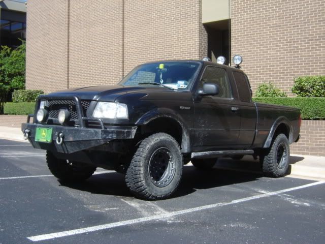

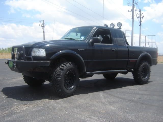

As posted before, it is has about 2" of lift overall. Explorer leaves out back (2-3"), and about 1.5" of spacer in the front. Other than that it's all stock and I fit 33x12.5x15's on 15x8 with 3.75 backspacing wheels. I only had to do very minor fender/ bumper trimming, in the front only, the rear was just fine. The fender, I actually just used a sledge hammer and drove the fender opening at the bottom back a bit, it is all still hidden by the flare, so it looks stock from the side. Now they have no rubbing issues that I have found.
I'll get a better side pic sooner or later

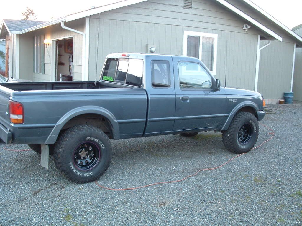

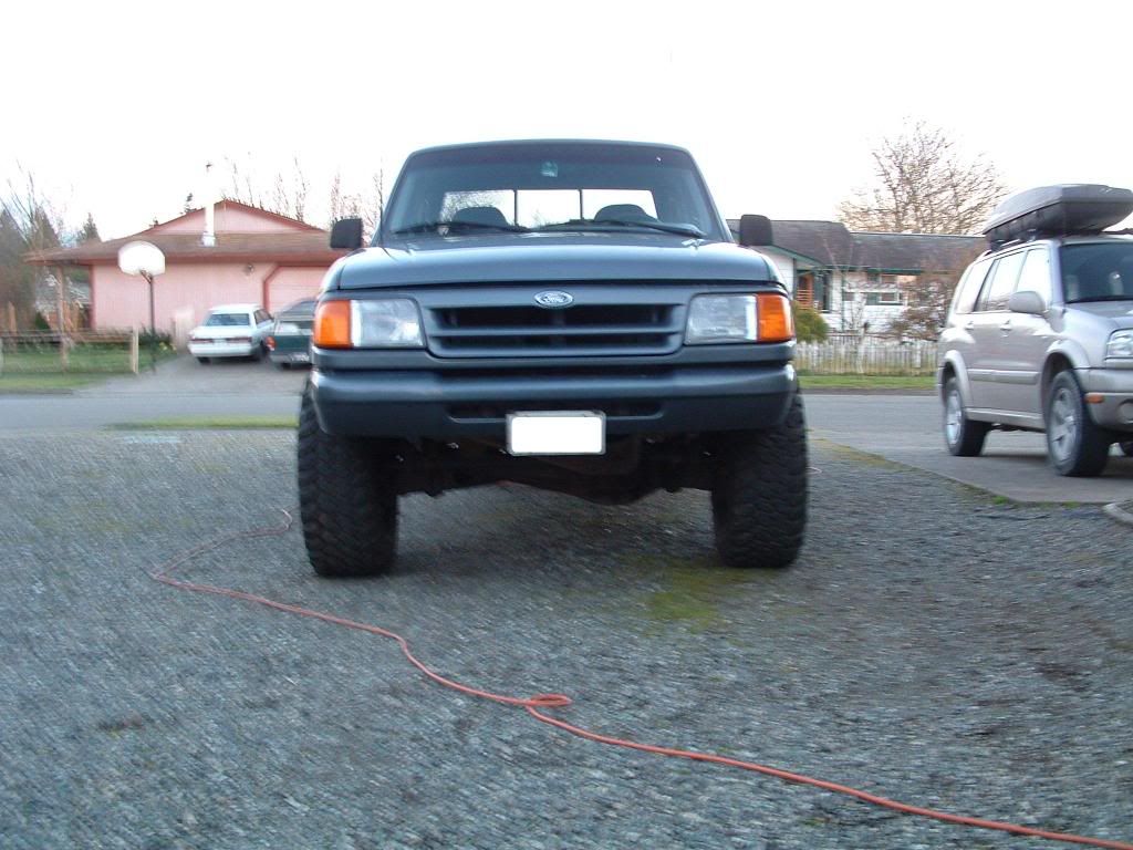

94 ranger x/cab
6" Skyjacker Class II w/ 1.5 F150 Spacers
2" Body Lift
35" Procomp X-Terrains on 8" wide Rims 12.5 wide Tires
No fender Trimming, But rubs on radius arm at full lock (but while in 4x4 it'll never get that far:dntknw:)
Same truck w/o 2" body lift (1" Spacers homemade) 33" michelle A/T 10" Wide Rims 12.5 Wide Tires
No Problems
