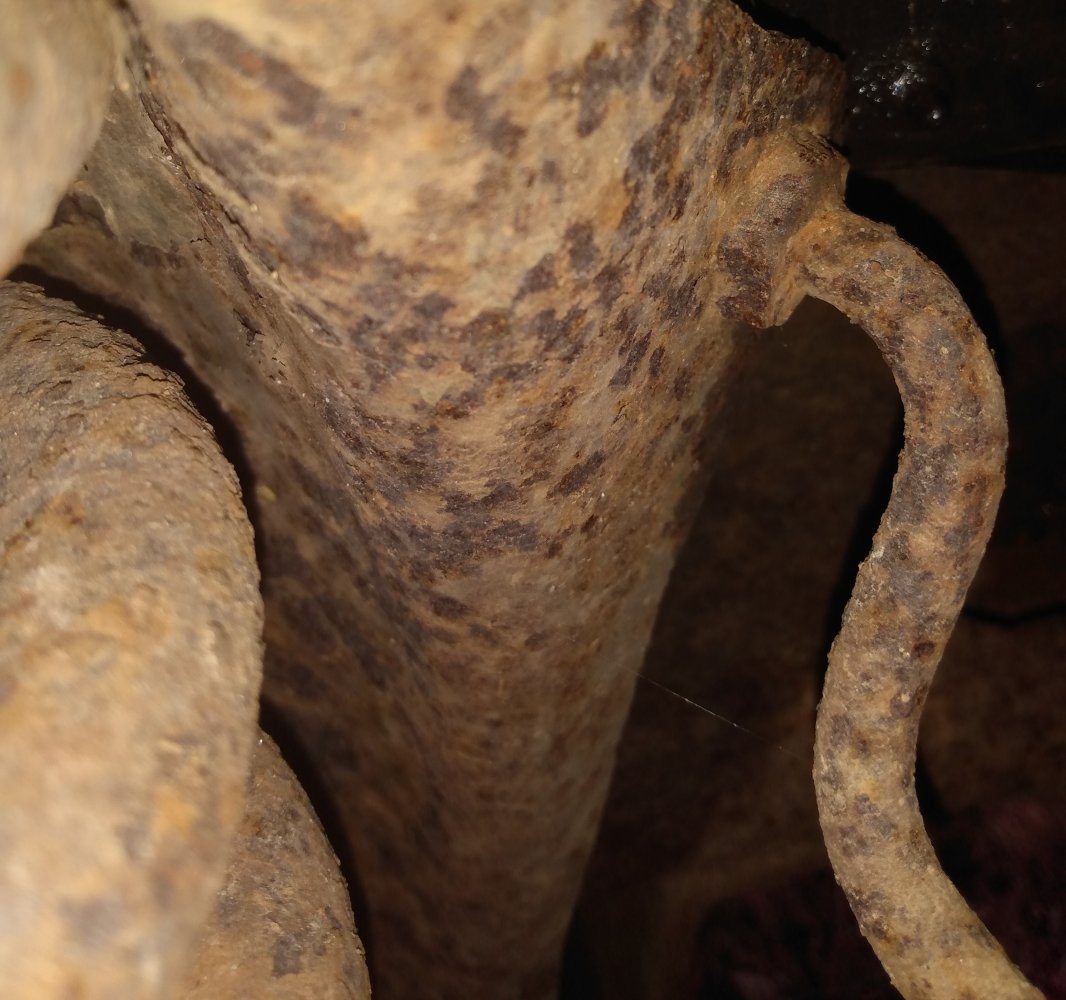

Here are some images of the brake line connection.

Oh. You got it bad. In my humble opinion, replace hose and hard line. I believe you need to loosen the nut where the hard line joins the hose fitting on the back side of the spring bucket. The hose fitting is held in the bucket by a clip in a groove. But there’s so much rust there that it’s hard to see all that. Soak it with penetrating oil for a few days to loosen up the rust and be prepared to use tools like; hammer, chisel, sawzall, wrench and cheater bar, swear words, bandaids (rag and electrical tape is best) and bigger hammer.
After seeing those...
I'll stand by what I said... replace ALL the front lines all the way to the master cylinder.
Without a doubt you need to replace the driver rubber hose... and those steel lines will have the same issues as the passenger side.
It's not a super hard job... but I recommend getting a flaring tool to make your steel lines.
Whatever you choose to do... DO NOT attempt to splice line together with compression fittings.
You should also prepare yourself to replace all the lines (steel and rubber) on the rear of the vehicle. This is very common repair in the rust belt.
Would it be taboo to cut a section out of the plastic inner fender skirting for access to the nut? I can get a 12mm line wrench on the nut as is, but there is no room to turn it.
Inboard of the bracket, the steel line looks good--hardly even discolored. As for the rear lines, I have replaced the left and right branches, but I'll have to look at the front-to-back line.
It’s your truck. Cut anything you want. On the passenger side, it’s not too difficult to just remove the plastic inner fender temporarily. I think there is more stuff attached to the driver side.
I wouldn't worry about trying to loosen anything on those old lines.
I would remove all of it with nothing more then a pair of side cutters... a screw driver and a hammer.
Don't waste any time with any of that old shit...
