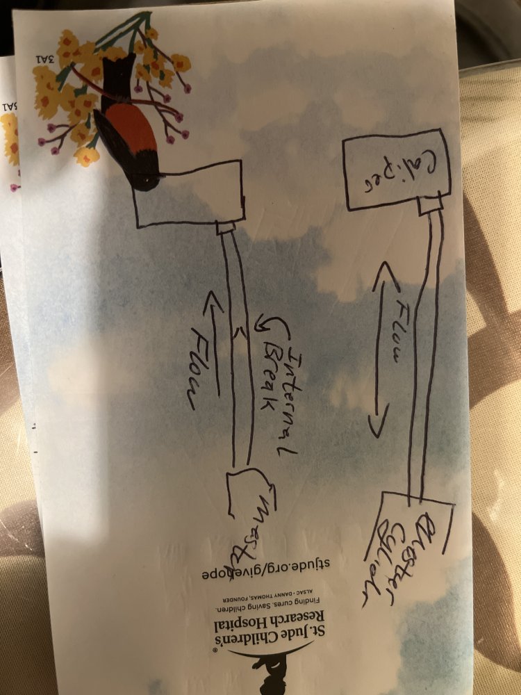

Picture is upside down.
But the idea is there is a break inside the hose. When you push down on the pedal, the pressure will force fluid past the break and activate the brakes. When you release the brake pedal, the messed up spot inside the hose causes the fluid to flow back extremely slow.
So, even after you release the brake pedal, the calipers still have pressure on them like you are pushing on the pedal.
this commonly happens if someone is doing a brake job, after removing the caliper from the bracket, the caliper gets dropping and hangs from the line.

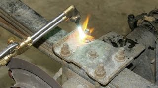

I cant seem to get the radius arm nuts loose at the pivot arm, so thinking just grind off the crossmember rivets and replace w bolts/nuts after.
I'm in rust free CA and still using liberal amounts of Pblaster and other penetrants to get nuts and bolts loose. How do you guys living in rust prone regions do this? Hats off.

I ended up just grinding off the crossmember rivets, it wasn't too bad....I buzzed a lil plastic off the fenders for better access. Unbolted and moved the fuel filter cage outta the way. Hoping to get it all back together today.
Will probably hold off on the axle/spindle bearing for now, they don't seem worn and apparently some play is normal.
7/16" bolt/nuts fit the rivet holes perfect. Hopefully downhill from here.
